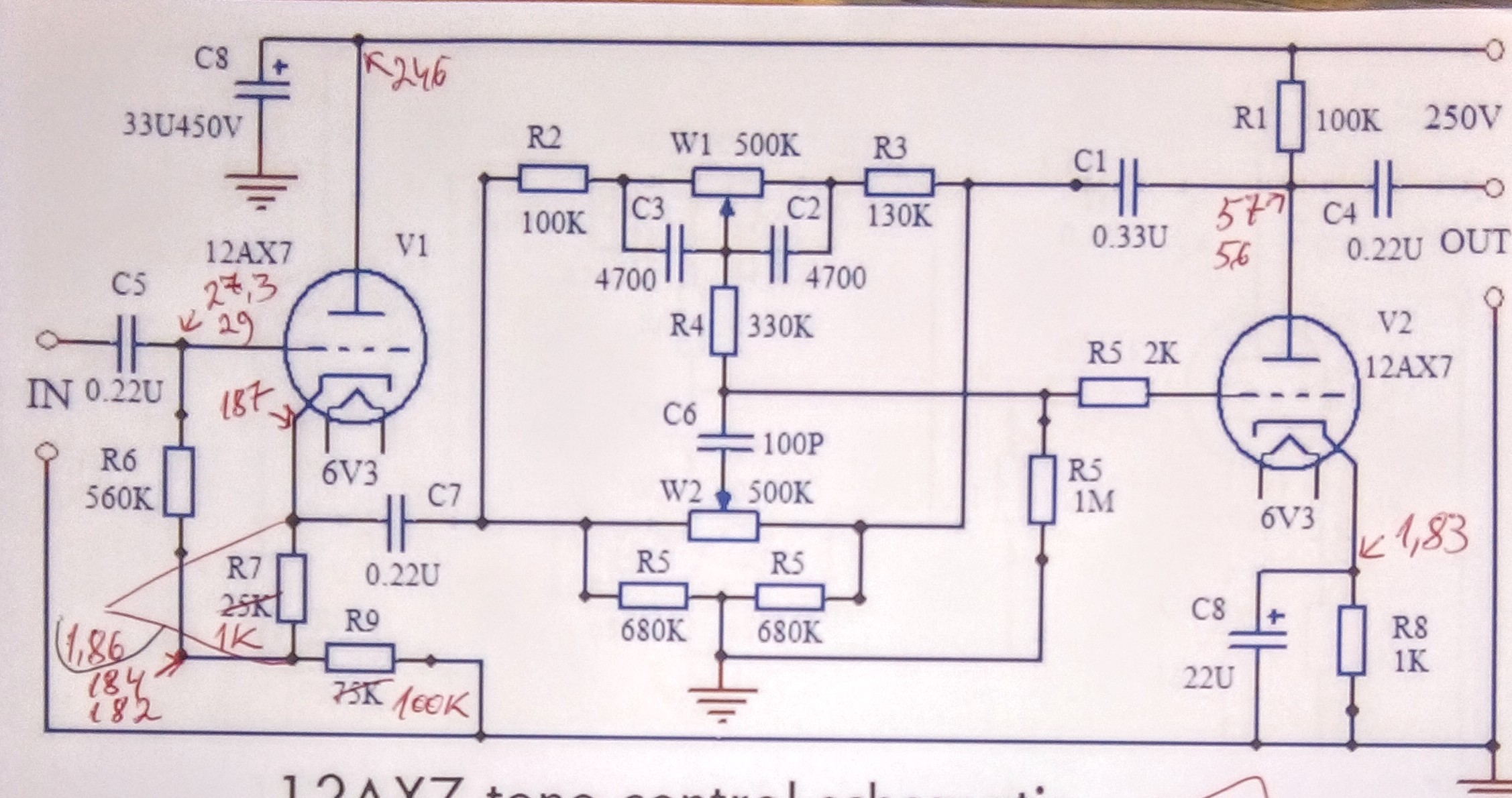

Everything seems OK except the grid of the first triode. For the given Vg, Vp and Vk should measure different also. I assume it's not the tubes since both channels measure the same. Check the pcb for any flaws. What type of voltmeter do you use? Some of them do not measure accurately at high impedance.

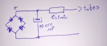

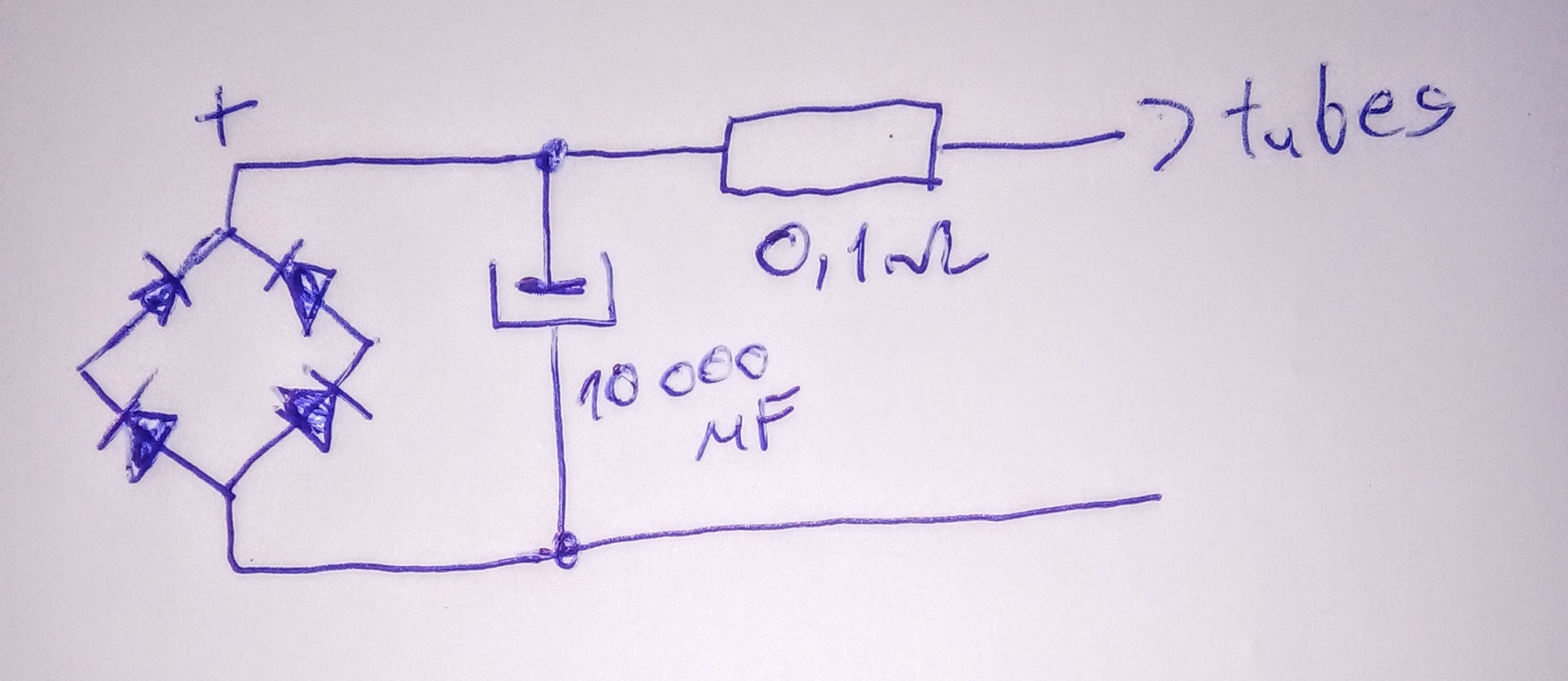

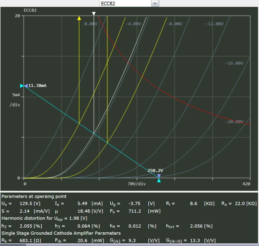

If you are willing to stay with ECC82 , then I would suggest to change R1-R9 to 22k and R7-R8 to 680 ohm for higher headroom and driving ability. See pic. In this case though, you may have to tweak C1. I can't help you much on this.

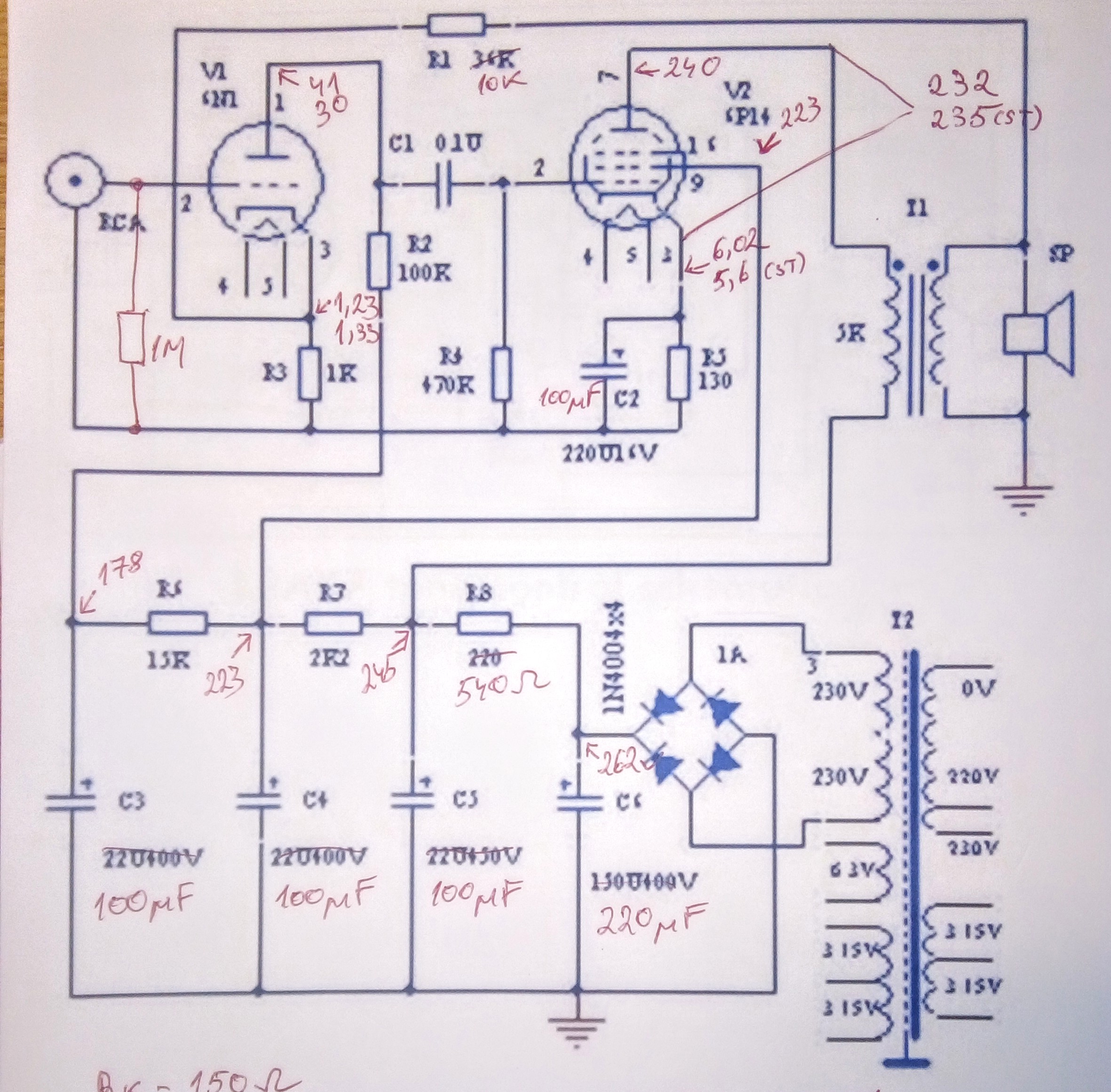

These are the other values i have measured with hot tubes:
6P14P:
Vp (pin 3-7): 232v, 235v;
Vp (pin 7 - GND): 240v;
Rs: 2K2
Vs: 22v;
Rk: 150 ohms;
Vk: 6,02v, 5,6v.
Ik= Vk/Rk= 40mA

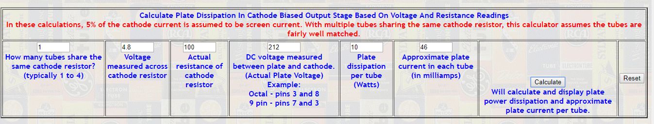

According to site http://www.tedweber....s1/calcbias.htm those values account for 38mA plate current and plate dissipation of 9W.
I think there is room for more power. According to datasheet, the maximum plate voltage is 48mA.
2. In the final stage i changed the soviet 6N1P with E88CC (Zaerix) for reasons of filament current: 600mA 6N1P vs 300mA E88CC. I don't see any diffrences in the quality of sound.
But i have very low anode voltage:41v and 30v ?!
Cathode: 1,23v, 1,33v (Rk: 1K)

I guess Vs is the voltage drop accross the screen resistor. From this we can find the current for each screen which in your amp seems correct. The screen voltage is between screen and cathode.
The max power for 6p14p is 14W. Usually we stay bellow 80% and this is 11W. For plate voltage 235V you can bias up to 48mA.
The load resistor 100k was already heavy for 6n1p. For ecc88 better decrease to 50k or at least increase the cathode resistor to 2,2k. Even better Ra=33k and Rk=560 ohm. Try to learn how to draw load lines. Perhaps this could help you to start with Triode / Pentode Loadline Simulator v.1.0 (20161216 [url]www.trioda.com)[/URL]

1. Because i had different voltages on the anodes of the ECC88 i changed the tube with a NOS ECC88. This time i measure the same voltage: 73v on both plates. Is this not still low? In the datasheet i see the standard is 250v.
I have Ra-22k (i didn't find a 33k) and Rk-560 ohm.
2. For final stage:
- I removed the 2K2 screen resistor, as i have seen it is omitted in other schematics.
- I changed the cathode resistor to 100 ohm

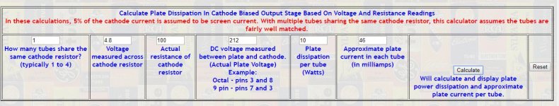

- According to Weber Bias Calculator i have 46mA plate current.

Ra=22k and Rk=560 ohm is fine for ecc88. You could increase B+ (and plate voltage) by lowering the value of the last resistor in the psu (15k?). It drops too much voltage now that the current has been increased in the first stage.
I wouldn't suggest to remove the screen resistor. Keep at least 1k there for safety reasons.

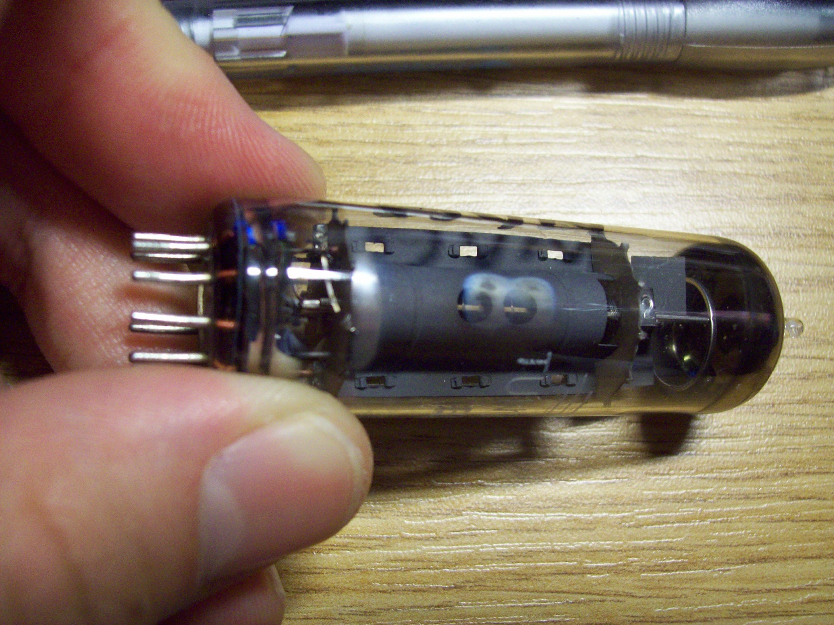

1. I have this EL84 tube (Tungsram) which i took from a radio that was thrown at the garbage. It has shiny parts on both sides. Does this mean it was heavily used? In my amplifier i don't see any sound diffrences.

It is somewhere here that my limited knowledge proves insufficient. Actualy, all the answers that I gave so far can be found to websites like this for example How to design valve guitar amplifiers . His book is also very good.

And a query: Where do you put the voltmeters' leads to measure that 27,3V at the line stage input?

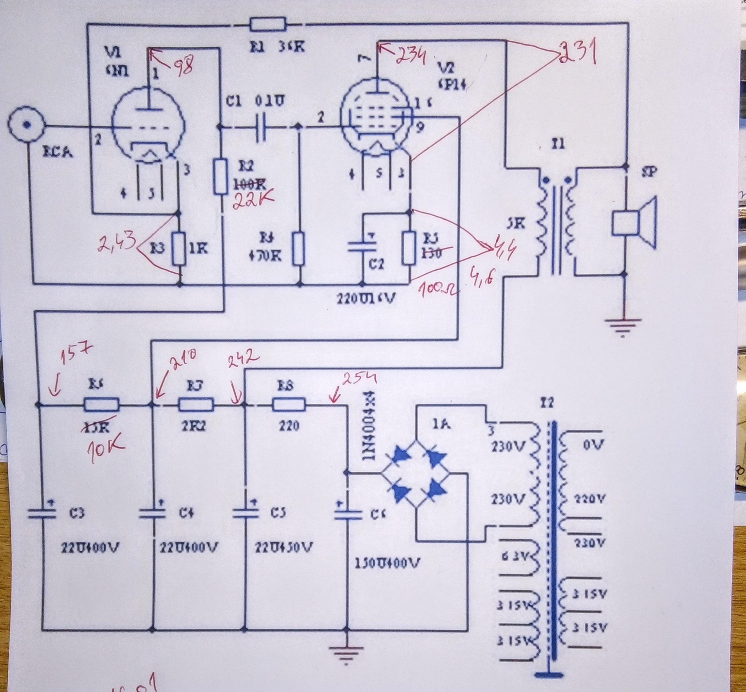

For the final stage
1. To ECC82 i changed Rk back to 1K and kept R2-22K. Now the bias voltage is -2,43v. R6 changed to 10K.
2. To EL84 I left the parts as i changed them before: Rk - 100ohm. Rs (2K2) gets quite hot (it didn't get black after 3 hours of listening). I can change it with 5W one if getting hot it's not a big problem. With these values i have 10W plate dissipation and 42mA current.
Looking at the picture, how do these values seem ? I think that here are a lot of people that such a simple amp is like a game and understand in an instant what it is about
Preamp stage
I measured the line stage input (27,3v) connecting the voltmeter leads between grid and GND. At the intersection of R6, R7 and R9 i have 184v.

At the amp input I believe you have ECC88(?) not ECC82. Electricaly seems OK. I hope it sounds good for your taste. If you practice with load lines you will be able to play a lot with operating points. Changing the parameters of this stage you also change the current demant. This will affect the resistors at the psu. The screen resistor is part of this. Increasing the current to ECC88 increased the voltage drop at the screen resistor. That's why you had to oversize it. Again, using simple Ohm's law you can adjust all voltages and calculate power ratings.
The "27,3V" is a mystery to me... There shouldn't be any voltage drop (or current flow if you wish) across the grid resistor R6=560k. You should measure 184/182V at both ends of it.
