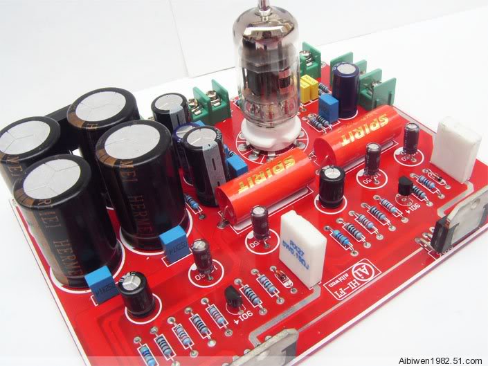

Hi. Just got my amp from eBay and theres no schematic included. Ive mailed the seller repetedly but to no avail. Can any of u fellas help? Planning to mod the feedback loop and too Im thick to find it the right resistors? Need a schematic?
The logo on the board says: Ai HI-FI, aibiwen

Just draw the circuit from looking at the board. Take a sheet of paper, a pencil and an eraser, draw the chips and the tube first, and then fill in the blanks. The capacitors usually have their value written on them in plain text, the resistors as a color code: 5 Band Resistor Color Codes.
For chips' and tube's pinout see:
http://www.national.com/ds/LM/LM3886.pdf
12AX7 - Wikipedia, the free encyclopedia
And please post your schematic, I'm sure there are more than a few people interested. 🙂

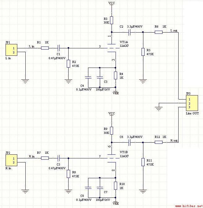

check if your circuit matches the posted schematic.
The posted schematic has problems.
Does your circuit work properly?
The feedback of the inverting chipamps is 200k & 10k.
The input bias currents flow through the 10k into each other. This will upset the input offset voltages and the output offset voltages.
The three 10k are in parallel to the 47k giving an input impedance of ~3k11
The gain is 20times (+26dB)
Your source must be able to drive that 3k11.
A valve at the input used as a buffer to drive that 3k11 is in the wrong place. The buffer should be back at the output of the source.
Rodeodave: Upon further inspection ur right. Theyre different. Ive mailed hifibar.net regarding the schematic. The amp was bought off some dude on eBay. If theres no reply from them I'll reverse engineer it.
That PCB-board looks spot on. Any further info on it? The transistors says: S9014, C331

Hey Bo,
Sorry to disappoint you, but the tube buffer is really bad engineered and will as is give high distortion. It might be possible to make something out of it though. Probably
best to bypass the tubestage as as long as it is in it´s present form.
Why do you want to modify the feedback loop?

My experience with the 12AX7 is that its high output impedance will make driving "through" that capacitor difficult. A 12AT7 is almost drop-in replacements here and would work better. A 12AU7 or 6DJ8/6922/ECC88/6N23P would be more ideal but would require some parts value changes.
I tried to attach the original 12AX7 schematic for the front end from the web site.
Sorry to say but the AT and AU are equally sh-tty at these B+ voltages. It is equally sh-tty to use a voltage amp here. A CF could be used with the GC in iverted mode but is unnecesary. Most source can cope with the normal GC Zin of 10k.

I imagine that the Tube buffer here is not for impedance matching, more for "Euphonic distortion" so the high distortion is probably intentional. If this approach to sound repoduction is right or not is more of a philisophical discussion.
The other designs on the site seem to use the buffer on a non inverting design so the input impedance of the amp should not be an issue. (However I haven't reverse engineered this one so it may be different)
The layout of the amp itself does not look optimum for the lowest distortion into 4ohm (or lower loads) at high currents the local decoupling caps needed to be as close as possible to the chip. The track length shown here cause problems in the design I worked on, we had to move the 22uF decoupler to be next to the chip.
However the design did not actually go unstable under normal conditions it was only under full load testing that we found the problem. So it will probably work OK just not be quite optimum on large transients.
It would have helped if the 3886 designer had put the V+/V- connections at opposite ends of the chip so that we could hang some useful capacitance within 10mm or so.
The pinout of the LM3886 is well designed. Point is i) to minimize the enclosed loop areas between V+ and OUT, and V- and OUT resp. and ii) to keep these high-current and high-frequency loops (half-wave rectification!) away from the input circuitry.
A few centimeters of distance to the decoupling caps is not much of problem if inductance is very low, this can be achieved by wide traces and minimized loop area. With double sided PCB it is not that hard... (but many of the far-east chipamp products are not very well routed, obviously).
