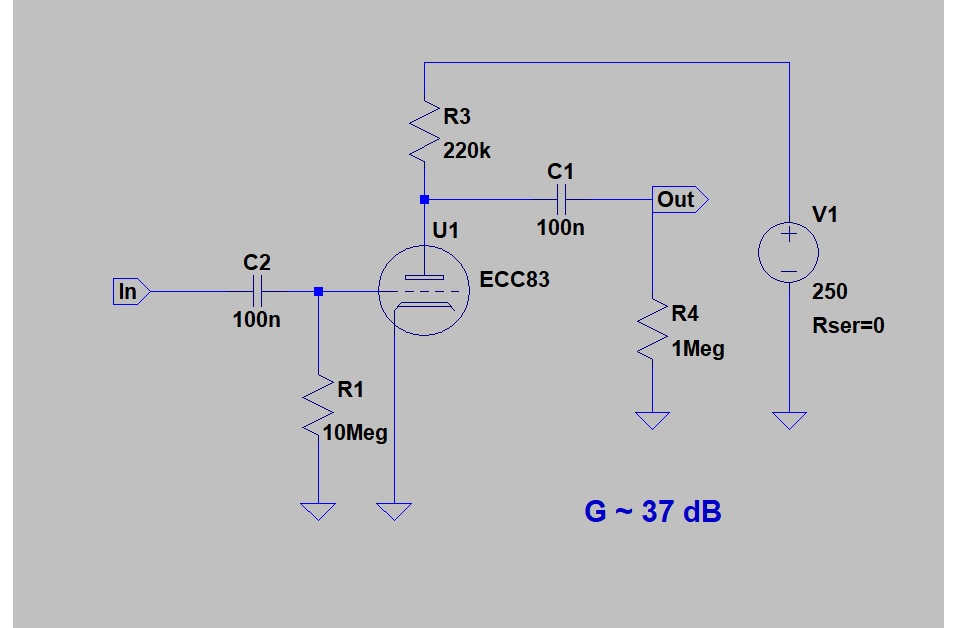

With the below circuit you can sort 12AX7 tubes by gain.

Did you notice the value of grid resistor ?
It is 10 Meg. This is typical grid leak bias. The grid voltage settles to about 0.8 V.
This kind of circuit works well with small signal levels.
I did but it seems like an unusual way to test a valve.
I would have used a bypassed cathode resistor and 1m grid resistor.
Then apply a sine wave and monitor output at anode.
Unusual ?
What particular problem exist with it, taking into account the original purpose that was described .
Cathode bias is negative feedback for DC, which means that it essentially "hide" some difference between the tubes under test.
Technical explanation: (Quote from: http://www.angelfire.com/planet/funwithtransistors/Book_CHAP-4A.html )
An amplifier stage in which the cathode is grounded and there is no external source of bias is called a zero bias amplifier. The bias isn't really zero because the action of the tube will develop a small amount of bias. This is sometimes called contact bias because it is generated by electrons coming in contact with the grid.
The grid wires are thin and very few electrons strike them but there are billions of them passing by so even a small percentage is still a very large number. Electrons that strike the grid stick to it and give it a negative charge. If the grid resistor is made very large, say 10 meg ohms, the voltage on the grid will be almost a volt. Now, if the tube has been designed so this voltage is the optimum grid voltage, and some have been, the parts count of the amplifier stage can be reduced by two...This circuit is most commonly used in All American 5 radios but is also seen in guitar amplifiers and hi-fi equipment...
