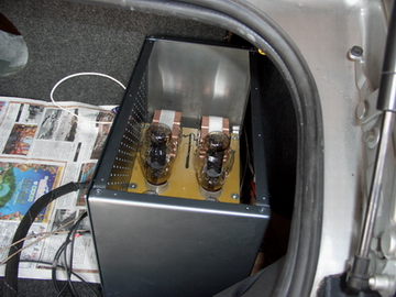

I was wondering if any one out there would have or know were to find a 12 volt power supply for maybe a SE 300b ?
I have built a pair of 300b mono blocks for home and I would really like to try to make some for the car.

this is one of the power supply

power supply is 12 volt to 110 volt 60 or 50 Hz [/B]
Neat. Did you pull the inverter board from an old UPS?
