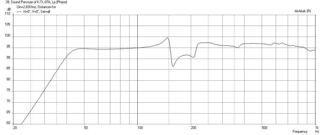

Sim of Tannoy 12 in Karlsonator
Based on the following T/S parameters that I got for this driver:
The optimal size of the Karlsonator is close to a standard 12in Karlsonator per GregB's design. In fact, you could use it as drawn and it would work very nicely with about 44Hz f3. However, if you want a little more bass extension and a flatter response, scale the height by 13/12x (taller) and the width by 11/12x (narrower) and you will get this for SPL vs frequency - good for about 95dB sensitivity with an f3 of 41Hz:

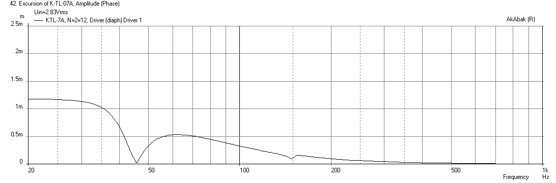

Here is predicted cone displacement - nice how it is well controlled and no runaway excursion:

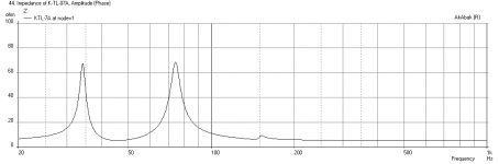

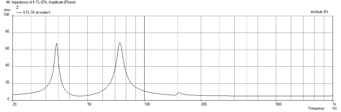

Here is predicted impedance:

questions: What causes the freq response squiggle around 150hz? Is there a way to flatten it and is a problem?
Does the karlson opening of the front chamber work as a hybrid of horn and ported box?

The reality of the cancellation dip may be different and in general not as deep as the simulation. The sim is a 1 dimensional lumped element model. The front chamber and aperture will have 3d effects. It will need to be modeled with ABEC3 or Comsol Multiphysics to capture that properly. The bass extension and level though is pretty accurate. To get 95dB at 2.83v and 45Hz means no BSC is needed with this design. That is a very sensitive bass generator.

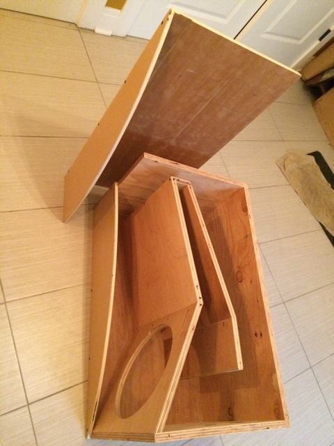

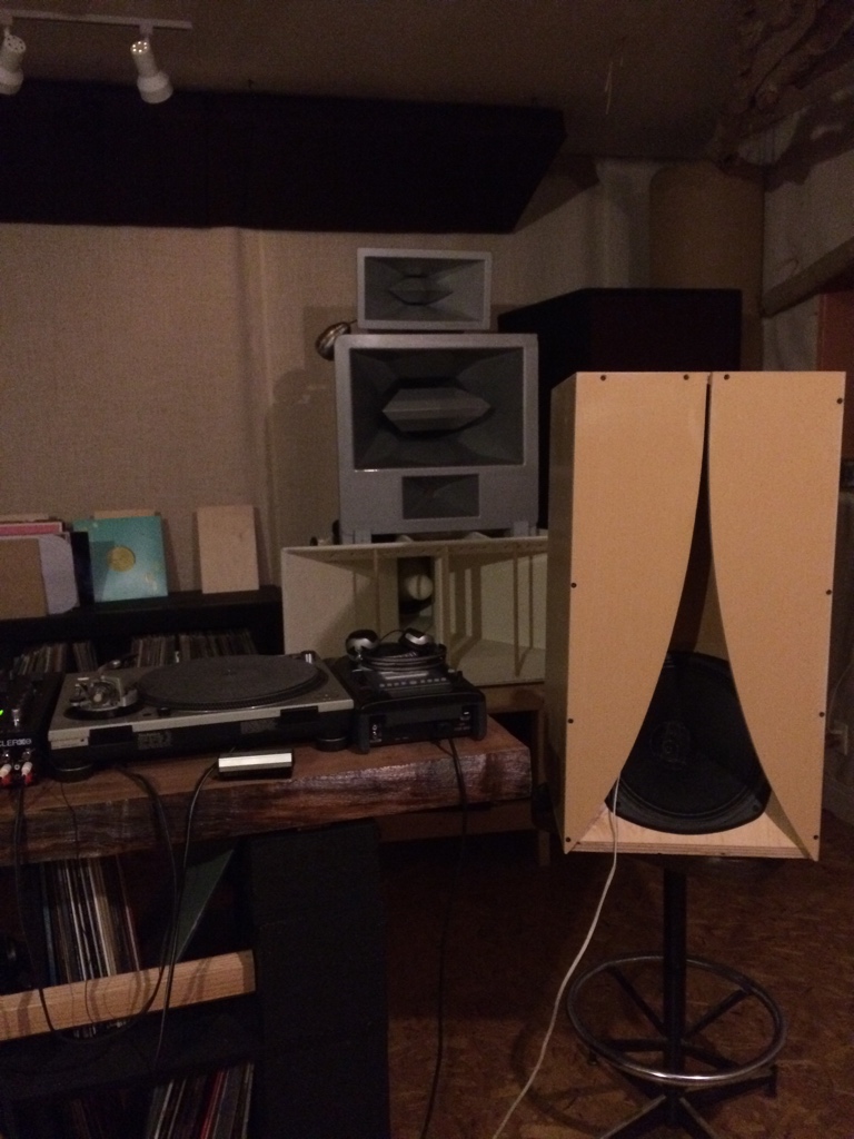

very nice looking - I only had damping in the stub and floor -a bit more might be good. What's the wing thickness? - I've watched pretty well braced Baltic birch wings deflect on K's and klam but the Ks didn't have the vent area of a Karlsonator - some struts should help on the mockup. What kind of plywood is that?
- Full Range
- 12" tannoy paper coax and box type. Karlsonator or...?.
