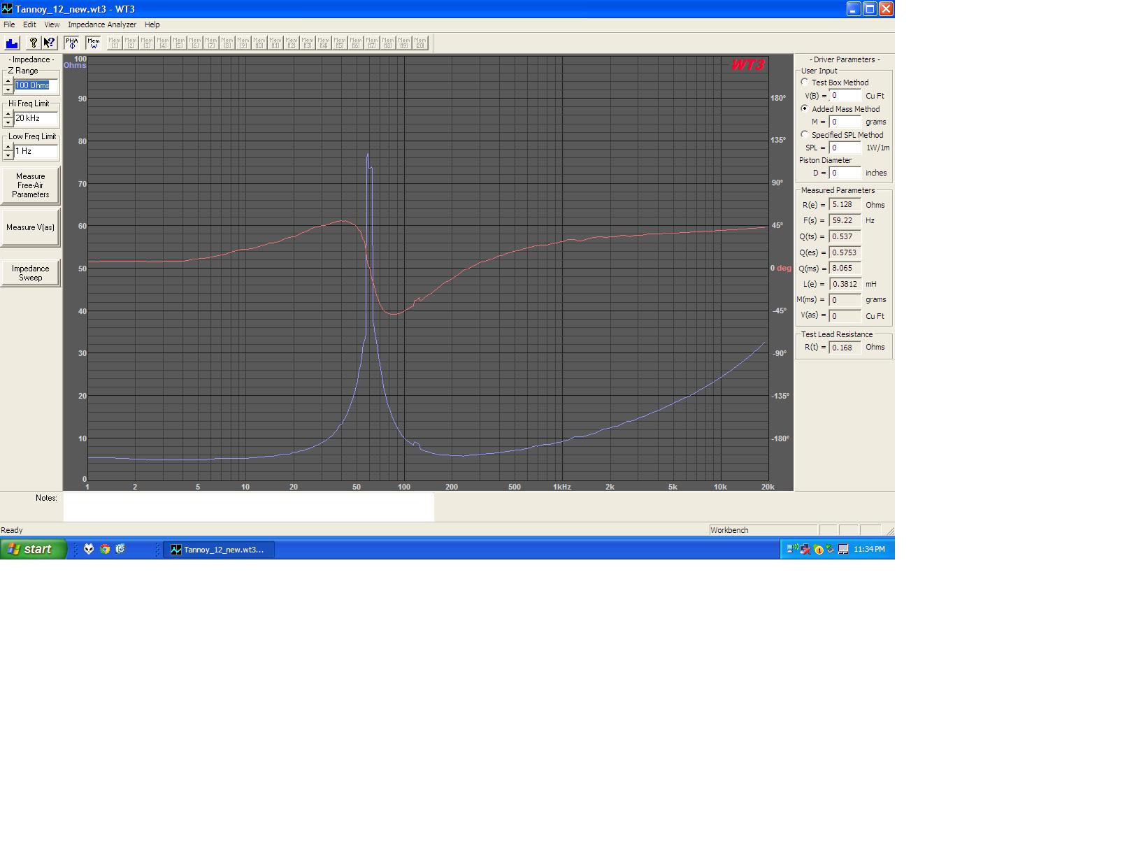

I have gotten a pair of Tannoy 12" paper coaxials to build my friend good quality outdoor PA speakers.
Tannoy CMS 12/8 Dual Concentric Ceiling Speaker. The factory specs show a ported box.
I will need to build boxes. Other than a standard ported, does it make sense to consider and try other enclosures in the attempt to squeeze out max performance from these drivers?
TQWT/Karlonator/Sealed TL??
thanks.

If T/S parameters are not readily available, and you don't have the wherewithal to measure for yourself, I'd be inclined to follow the manufacturer's recommendation. If you retain the net cubic volume and port size, you can play around to a degree with dimensions to suit aesthetics.

WinISD simulates ported box, 4 cu ft, 50Hz tuning.
Tannoy factory recommended ported box, 2.9 cu ft, 48Hz tuning.

The midbass of a Karlsonator will tend to be stronger and more horn-like than a vented box. There is an elevated gain region which in most cases will act as a built in baffle step compensation. A BR will typically require BSC. Also, the presence region (~1-3kHz) will be somewhat attenuated by the bandpass action of the front chamber. That is usually a good thing since many drivers have a break up there that needs to be suppressed, but it depends. Might be too mellow with some drivers. Any Karlson type has more edges for potential diffraction and coloration. Whether this outweighs the other factors is a judgement call.
With those Tannoy specs I'd say the Karlsonator is a fair bet, depending on the freq response. It was intendended for mid Q modern pro drivers. The Tannoy is a bit on the high Qts side, but within range. Since it was a ceiling speaker, it's not going to have BSC in the crossover, so that should be good to go.
TL can be nice too. In this case I'd consider it if the speaker is to be run with SET and placed in a small room with carpet and lots of stuff. I usually like Qts around .7 for old school folded TL's. High output impedance will make up for it.
BR are simpler to build and can sound very nice. Depends on the driver and system synergy. You might need to modify the crossover in this case.
TL would be a great choice for home, but IMO not for PA use. They have poor excursion control.
