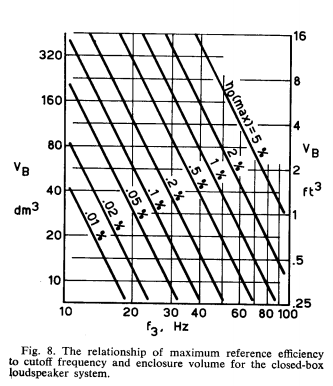

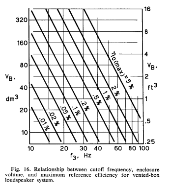

12 inch woofer in 55 liters from 40 Hz with decent sensitivity
But I'm having trouble finding a fitting 12" woofer that:
- Can reach 40 Hz in 55 liters with decent sensitivity
I reckon something around 93 db/w would be perfect
Unfortunately the physics makes it somewhat problematical since per the attached: ~40 Hz/~55 L/F3 = ~0.1% sealed = ~82 dB/W/m and vented ~0.2% = 85 dB/dB/W/m: Efficiency and sensitivity conversion - loudspeaker percent and dB per watt and meter loudspeaker efficiency versus sensitivity vs speaker sensitivity 1 watt = 2,83 volt box chart - sengpielaudio Sengpiel Berlin
