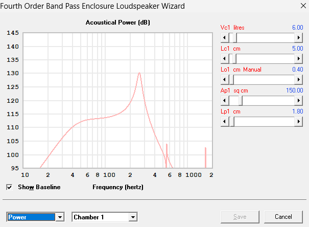

It occurred to me that a simple chamber, with absorbent lining and an offset port, could at least help to attenuate any high frequencies from radiating directly out. If the port was large and short it wouldn't have a noticeable affect on tuning, so the chamber sizes could remain small, much like a simple sealed design.
A bit of modelling suggests that a port that is about 1/3rd of SD and 18mm long (the thickness of some ply sheet) doesn't affect tuning or cabinet size much, and wouldn't suffer from LF pipe resonances or significant airspeed. In the frequency response it still introduces a peak above the crossover point and then steeper roll-off towards high frequencies (that latter might be vaguely useful), though it doesn't extend or increase the lower frequencies.
(so the effects on FR are all above the intended subwoofer range)
So i don't know if this could legitimately be called a bandpass design, but it might still offer at least some of the benefits that I wanted. Another bonus is that it would still hide the driver; the port could even be down-firing (without needing the driver to be oriented horizontally). It might be worth it for that alone, in my case.
