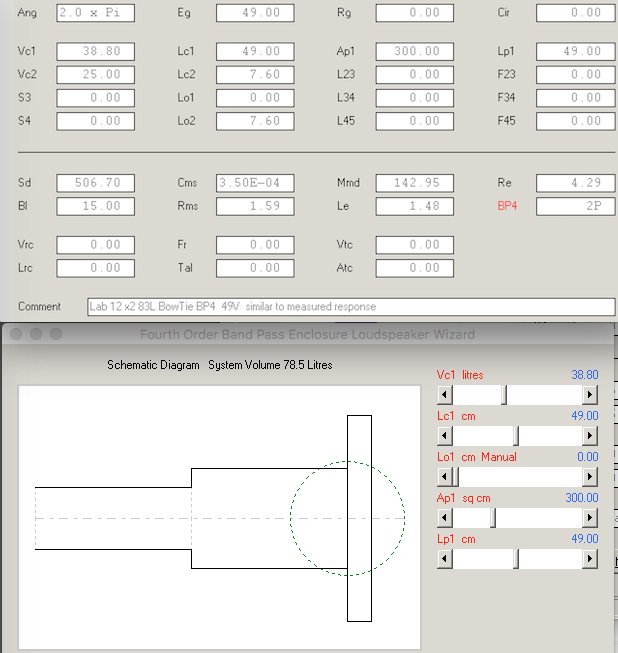

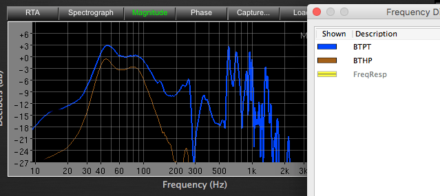

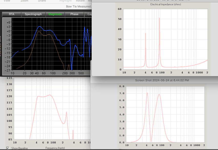

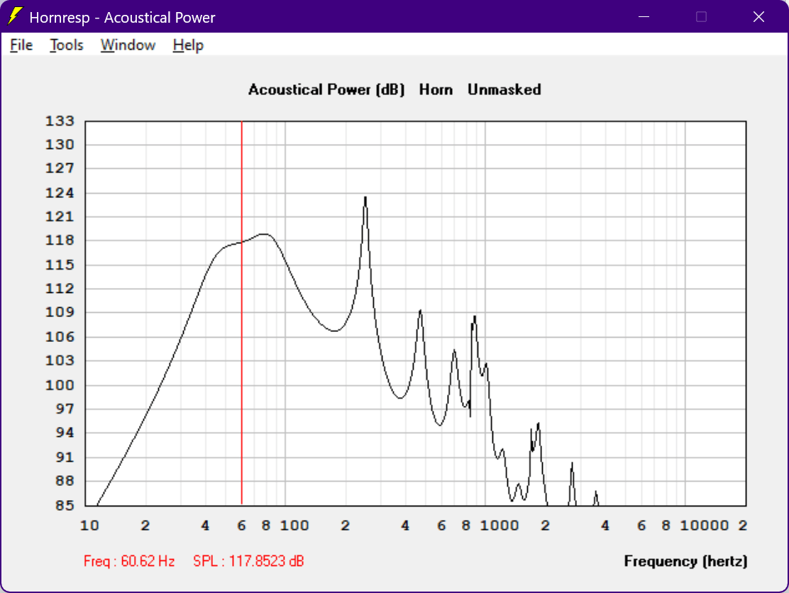

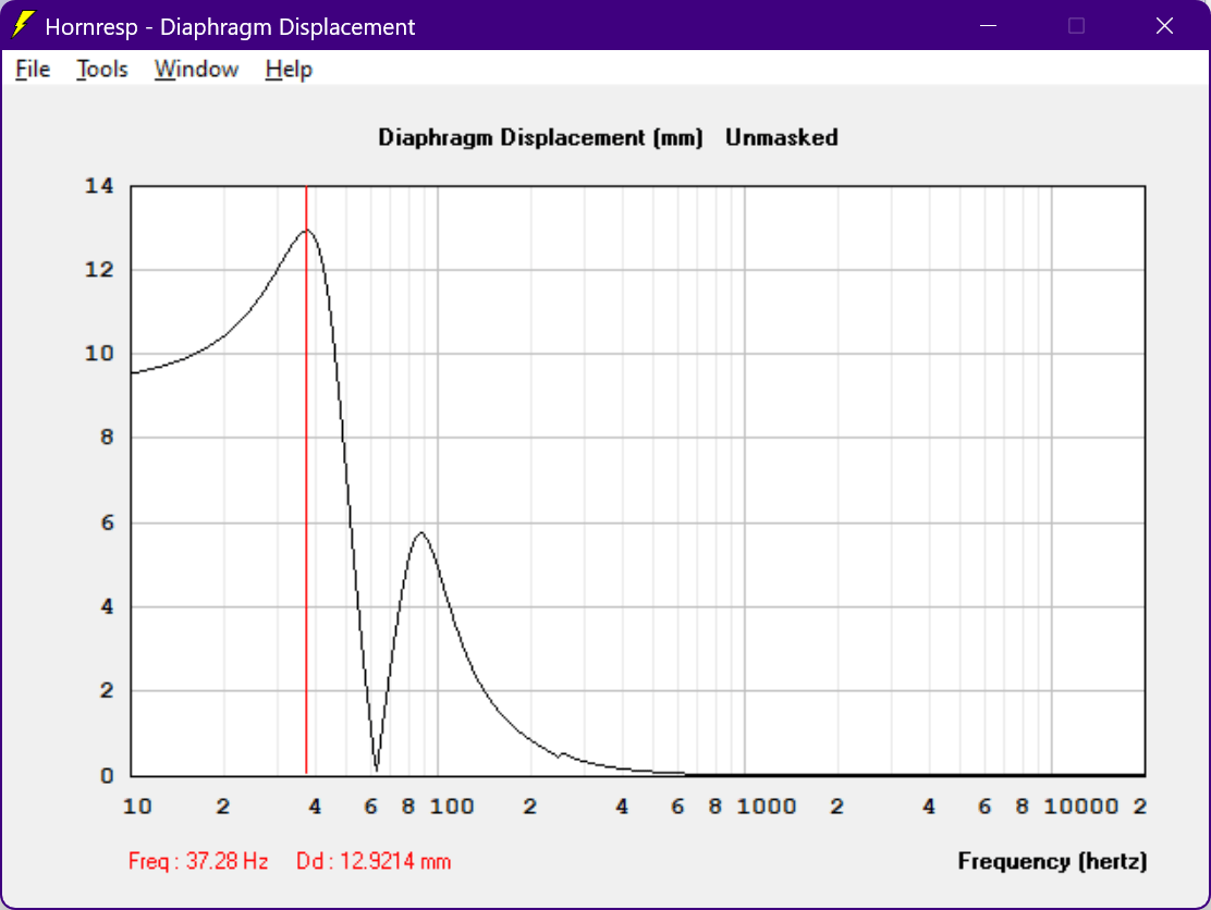

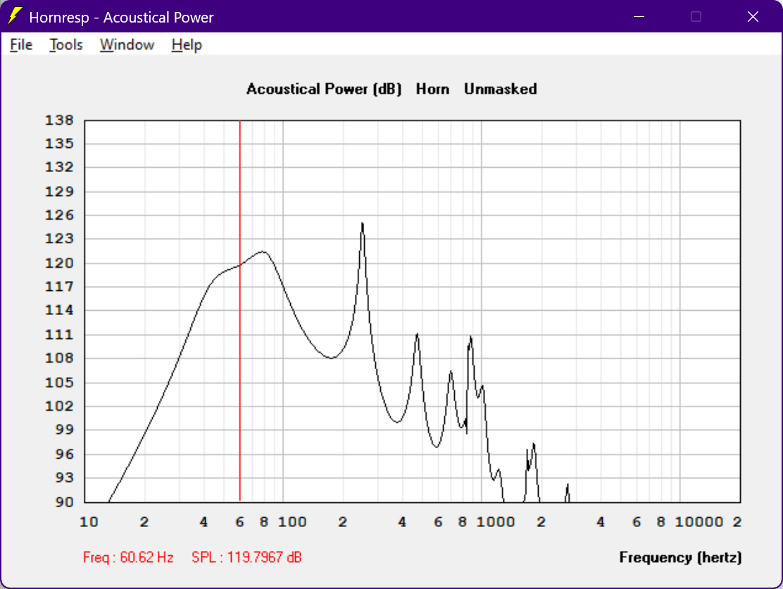

I have designed and built bass reflex (BR), tapped horns (TH) front loaded horns (FLH) and a bandpass (BP) box for LAB 12s.
The BP box, called the "Bowtie" had a similar response to yours, though shifted up about 1/3 octave, and a +3dB "bump" between 40-50Hz:
The LAB subs are pretty clean until run past Xmax.
Objectively, measured distortion levels were not much different between the Bowtie and the bass reflex cabinet.

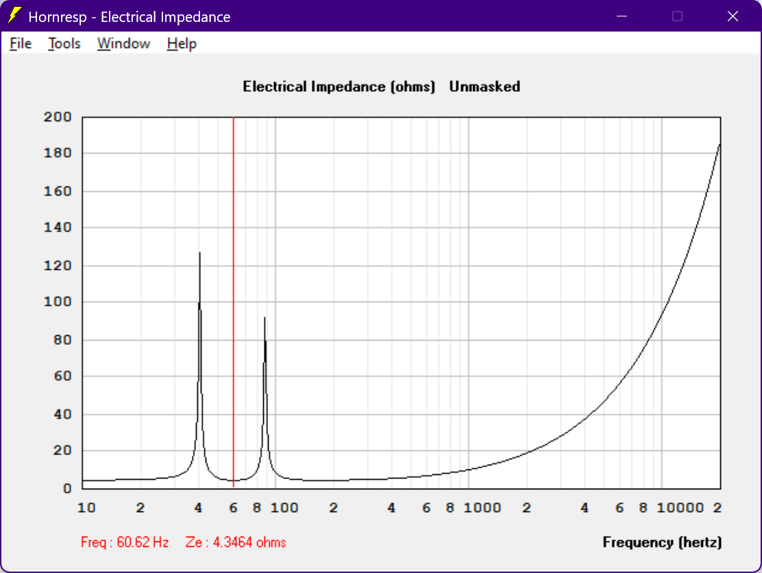

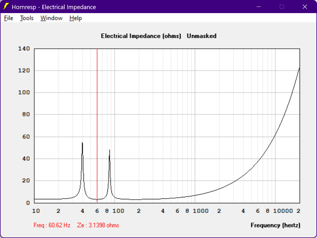

Did you ever measure the impedance curve of that build, Art?

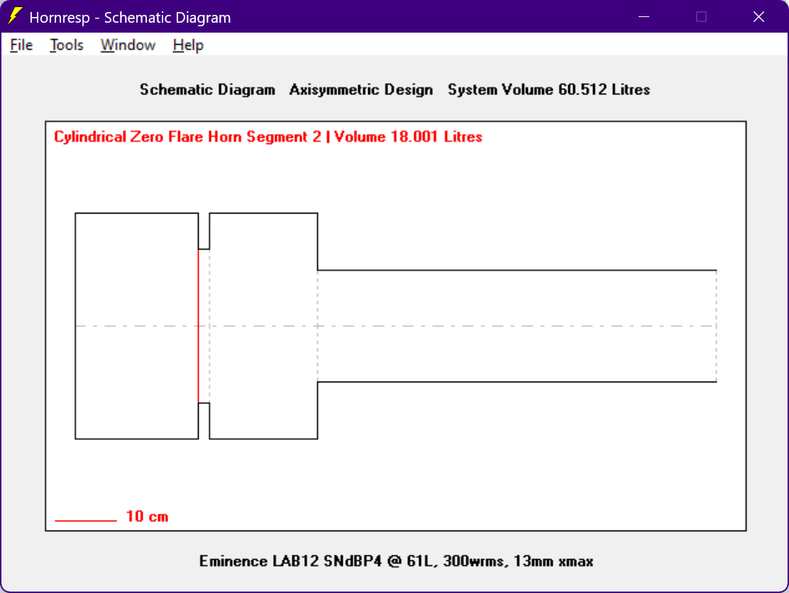

I ran into a similar response issue with my "Enigma" build, where there was a "bump" at the lower end of the passband, and it turned out that the build was tuned too low because using the usual vent calcs resulted in vents that were too long (the calculation gets more inaccurate as the volume of the vent gets larger than about 10% of next box volume), Proximity of the vent to the rear wall also affected Fb. I ended up having to trim a good >20% off the vents to flatten the passband.
Your experience with the THD (compared to the vented box) is also interesting. The THD curve for my Enigma build reflected the reduction in THD caused by the acoustic filtering of the vented chamber. FWIW, I also used a bit of stuffing in the vented chamber as I found that subjectively that significantly improved the sound (measurements show that it also significantly reduced the higher out of band vent resonances).
If you're going to try a BP4 build, I suggest going with an offset-driver design, like the "Enigma" build in my page. Why? The shape of the box and the location of the driver in the box can be used to reduce or completely null out the 1st harmonic resonance (you can actually see this effect in the FR posted by Art for his build). I've got a spreadsheet on my website that can be used to generate an equivalent Hornresp model for such a design.Thank you, Art, it is good to be reminded of this during all the simulating. I think it is clear that the BandPass design has a number of potential disadvantages; IMO by the time the required response is achieved it isn't necessarily going to be the smallest, or loudest, or least complicated, or greatest in the time domain. My interest in it remains mostly in any sonic benefits of the acoustic filter, especially with respect to attenuating spurious above-band noises.
Whatever you do, I also suggest designing your build in such a way that you can easily change vent lengths. Even a few cm change in length can make a pretty big difference, not only to the shape of the passband, but to the amount of out of band noise as well. Finally, including some stuffing in the vented section, near to the panel that's farthest away from the opening of the vent(s). This should reduce some of the out of band noise. I lucked out with the Enigma - the out of band noise in the final version was so low that I could use it without a LP filter.
No, but since the response is kind of inverted from the Hornresp sim, I'd expect the impedance curve would be too.Did you ever measure the impedance curve of that build, Art?
I found after building the Bowtie sub my original 2012 Hornresp model was done completely wrong, even though it resulted in a similar response curve as the finished cabinet 😳.I ran into a similar response issue with my "Enigma" build, where there was a "bump" at the lower end of the passband, and it turned out that the build was tuned too low because using the usual vent calcs resulted in vents that were too long (the calculation gets more inaccurate as the volume of the vent gets larger than about 10% of next box volume), Proximity of the vent to the rear wall also affected Fb. I ended up having to trim a good >20% off the vents to flatten the passband.
I had figured the tapered inlet and exit would need some compensation, after adjusting the port width (lots of clamping and cursing) got it to do 40-100Hz. For rentals, I figured the "bump" at the lower end was a bonus.
The Hornresp sim above was done long after I sold it.
I found the transient response lousy when A/B tested compared to the LAB12 in BR, FLH, or TH designs.Your experience with the THD (compared to the vented box) is also interesting.
I didn't find the THD a sonic issue even though the upper pass band distortion measured 3 to 4 times higher than the LAB12 in BR, FLH, or TH designs tested at 49v, while the Bowtie low end distortion was similar.
Maybe the LAB12 just does not like moving +/-7mm 120 times a second 😉

Thank you for the tips, Brian. The offset design makes sense, now that you mention it. I'd noticed that the hornresp simulations do show interaction of the box and port together on what I've simply been calling the port resonance; it isn't an open pipe in isolation.If you're going to try a BP4 build, I suggest going with an offset-driver design, like the "Enigma" build in my page. Why? The shape of the box and the location of the driver in the box can be used to reduce or completely null out the 1st harmonic resonance (you can actually see this effect in the FR posted by Art for his build). I've got a spreadsheet on my website that can be used to generate an equivalent Hornresp model for such a design.
If I build anything with a port I'll make at least one prototype to enable large adjustment and testing before settling on the final thing. But yes it might still be useful to have the final version somewhat adjustable too; these will see different rooms and different positions so I might want to tweak them in ways other than DSP. Thank you for the suggestion!

The problem is the bump is in the wrong location.The BP box, called the "Bowtie" had a similar response to yours, though shifted up about 1/3 octave, and a +3dB "bump" between 40-50Hz:
In a word, the BP sounded "rubbery".
But the BP could fit in the trunk of my car, and survive rentals.
Art

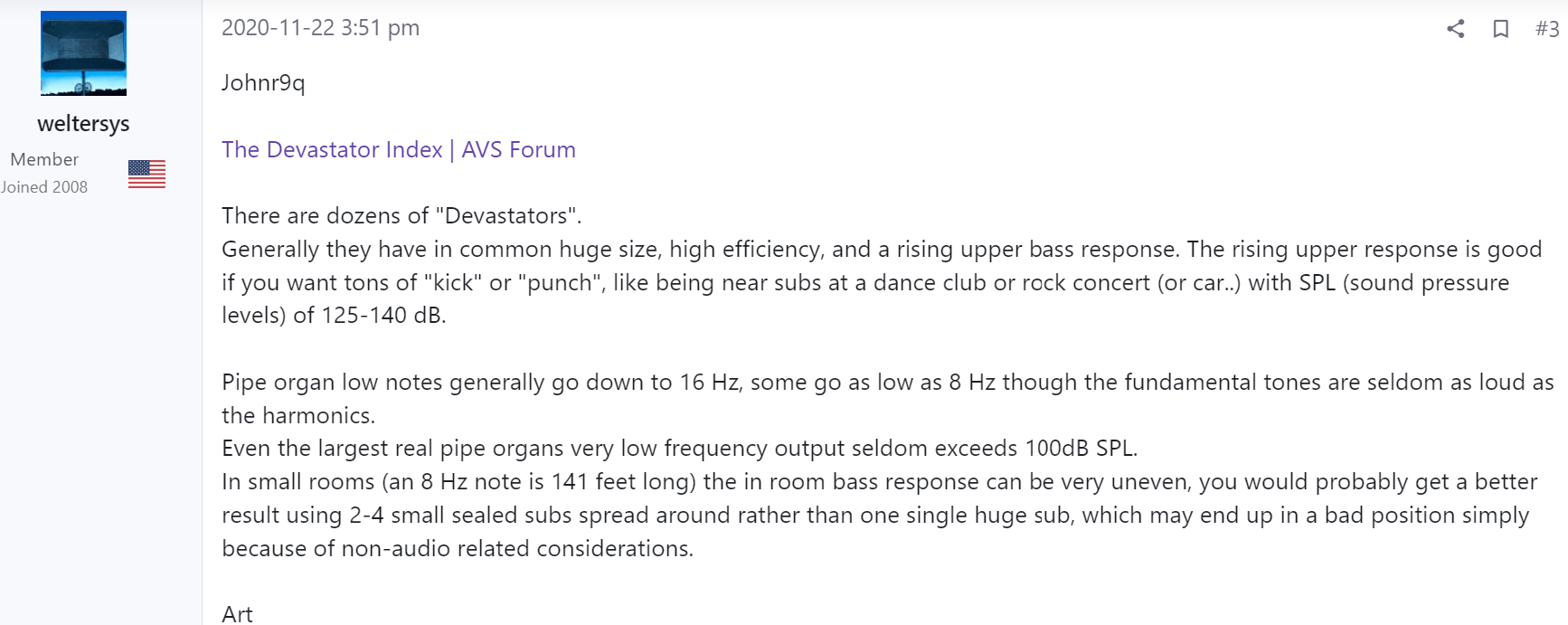

The bump needs to be in the 80-100hz range to bring in the midbass.
That's why the Devastator enclosure on avsforum.com is designed the way it is.

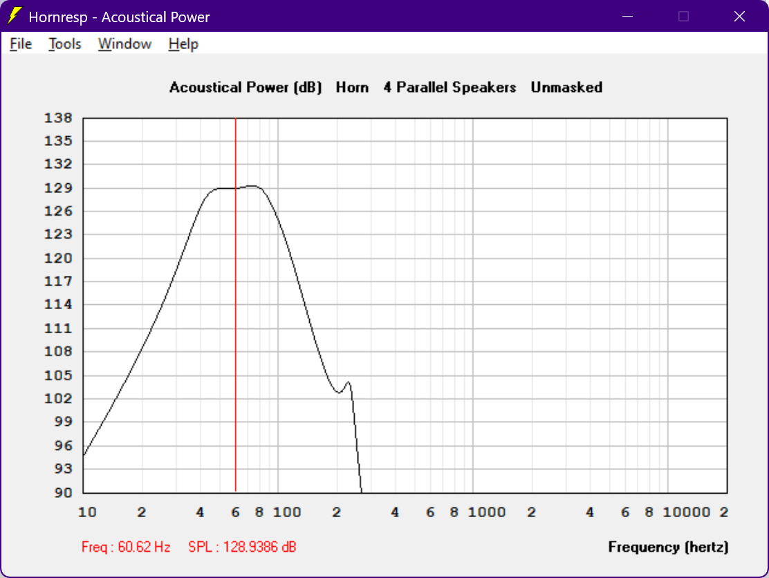

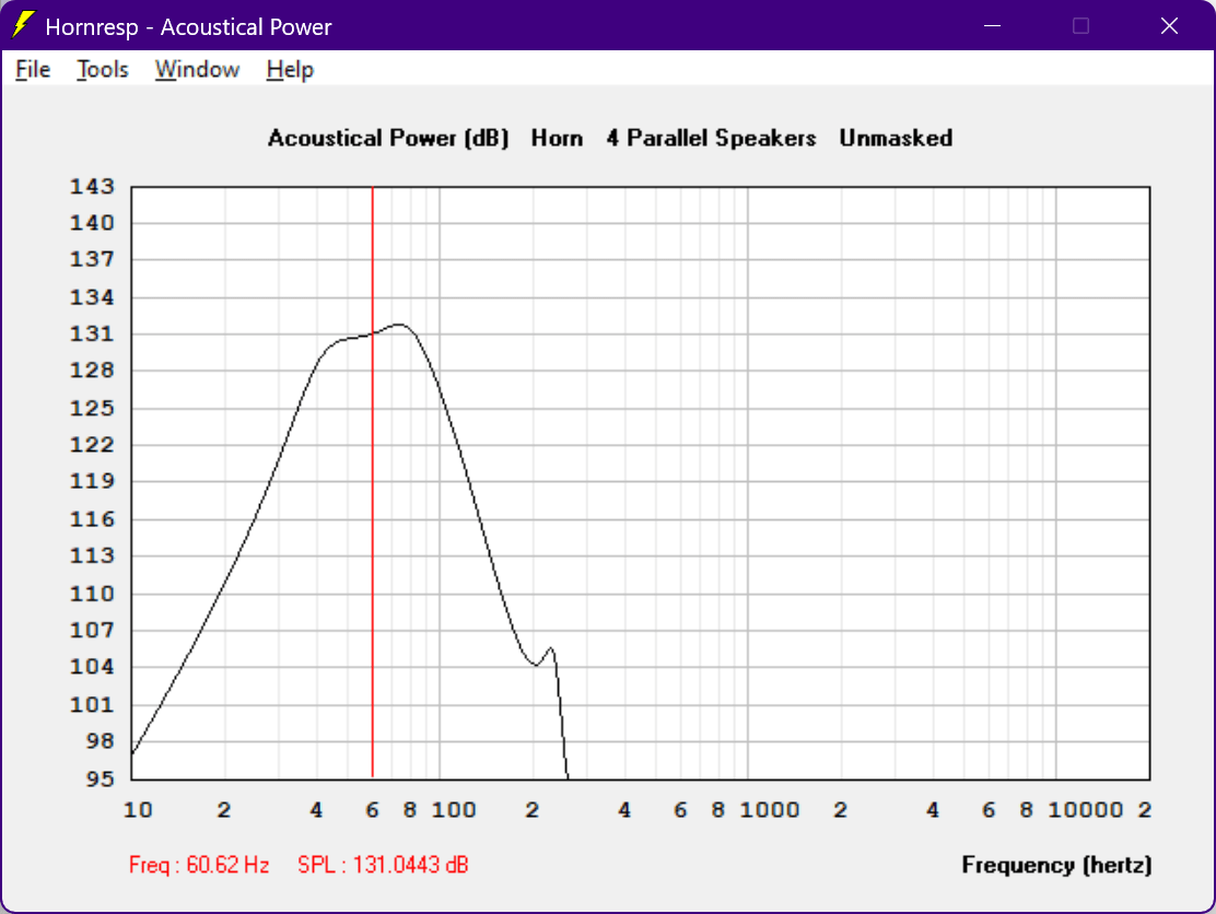

Is that a 2pi or 0.5pi HR model?
If that is a 2pi HR model, then you definitely gonna get muddy bass in a car.
Transfer Function is a beast below 50hz.
If that were my 2pi HR model, then I would have that 90hz hump around 125dB so the curve flattens out at 0.5pi with transfer function.
4 parallel speakers = 0.5pi = 1 enclosure in a car/PU/SUV before transfer function.
Also, mount the driver's basket in the vented chamber for voicecoil cooling.
The 2x12" Bowtie was designed to be small enough to be transported in the trunk of a car for DJ rental use, not as a car sub. It was designed around cabinet dimensions common to the rest of my speaker inventory at the time.Is that a 2pi or 0.5pi HR model?
The Bowtie Hornresp model is 2pi:
The HR sim does not have the LF bump.
I didn't spend much time on the sim, as the cabinet had already been sold, and I had no intentions to build any more.
Like any bandpass subwoofer with output only through a port, the upper response is indirect, a resonant delayed response from the internal air spring.
Efficient for the enclosed volume, but lacking in transient accuracy.
That type of response is OK for the intended users, but not something I would choose for my own use.

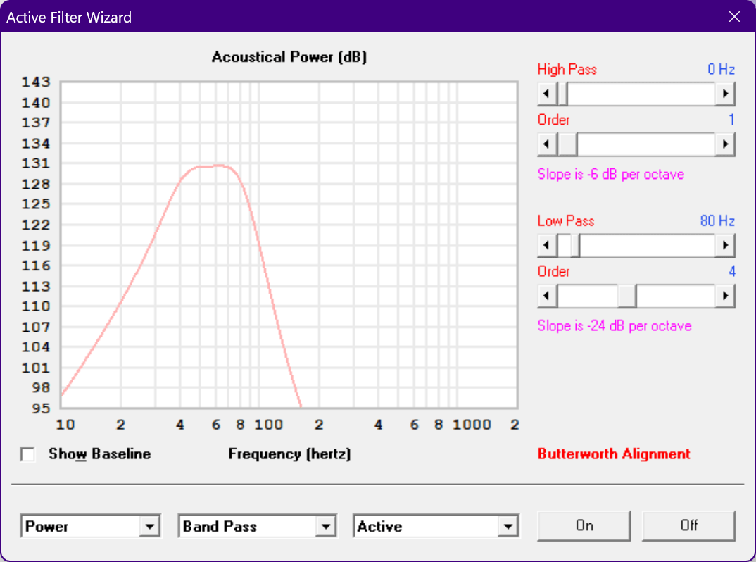

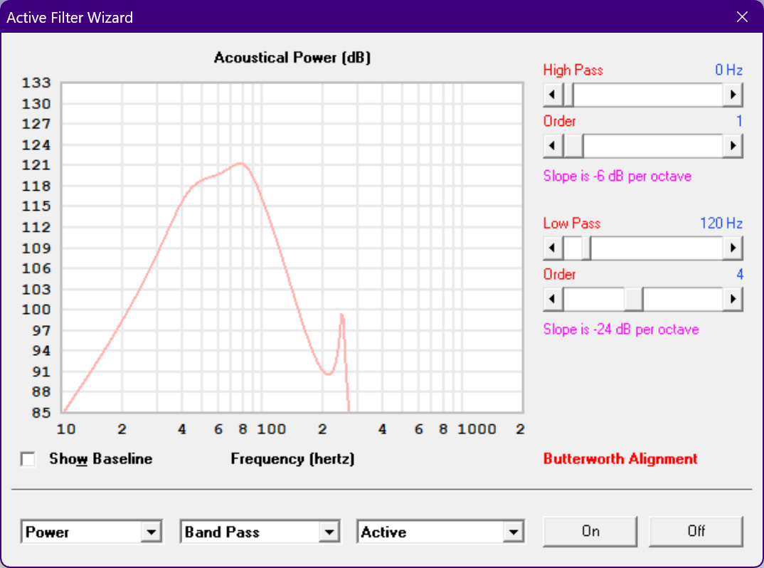

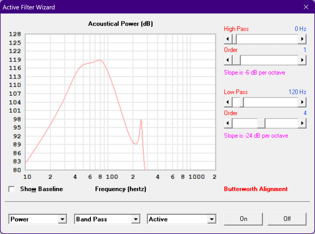

Adding a 12" LP filter to a direct radiator box also adds delay 🙂.
In any case, using DSP to address the TD should improve the "transient accuracy" a bit.

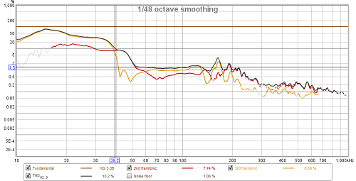

Oh, I found the THD curve for my Enigma (V2) BP. The curve was taken at the driver's rated power level. THD of ~1% from 50 Hz up is not too bad. Above 110 Hz or so it's a bit less relevant as the BP is rolling off pretty quickly above that frequency. Below 50 Hz the acoustic filter is no longer effective, so THD rises quickly.
(forgot to mention, that little blip in the THD above 150 Hz was caused by a buzzing x-over board, which I subsequently fixed).

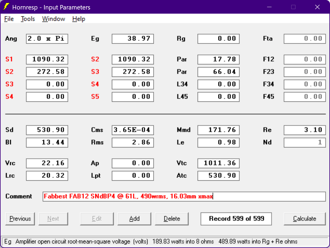

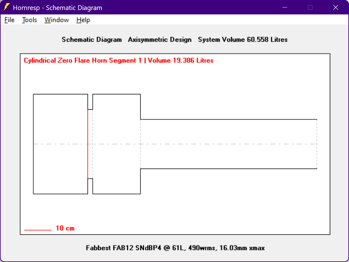

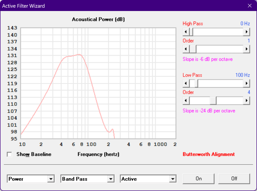

The BP4 doesn't need a highpass filter.
The BP4 doesn't need a speaker grill.

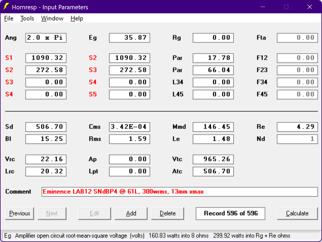

Lower that BR enclosure to 38.97 volts and compare that 30hz response to the BP4 enclosure.
A bit of an apples and oranges comparison.
A bit fairer to compare a BP4 box to a sealed box, and a BP6 box to a vented box ?
Rob.

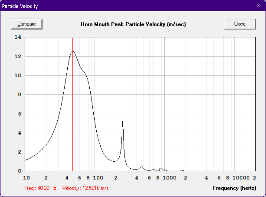

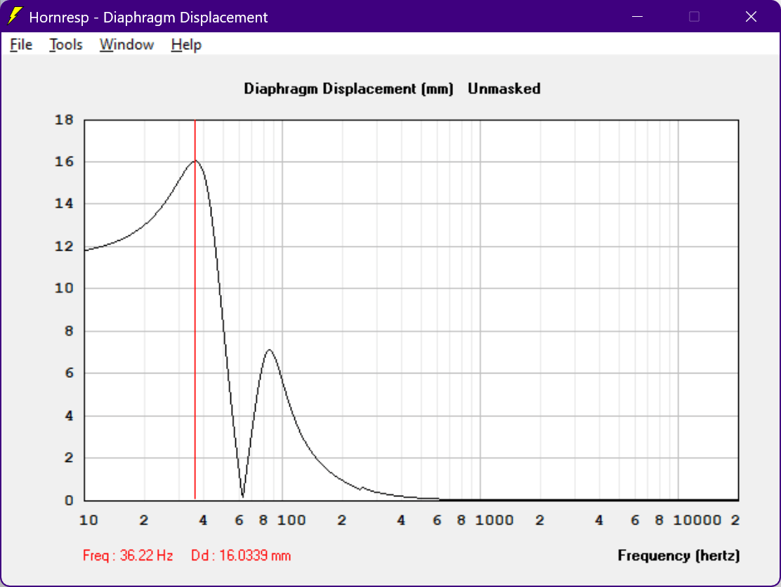

No, it's a fair comparison. His BR has the same volume as my BP4. My BP4 is more efficient per a given voltage up to 38.97 volts. The BP4 still reaches a higher SPL even though the BR can take 50 volts.

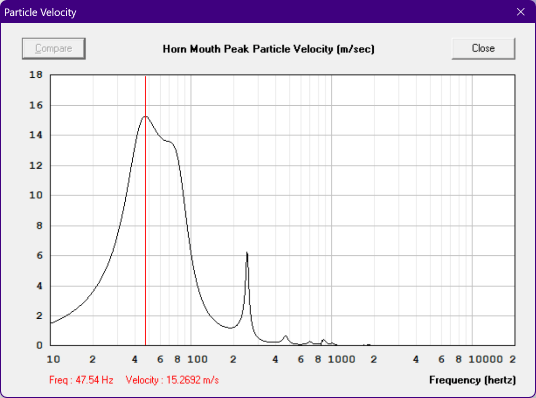

Also, note the BR's port velocity is around 24m/s. The BP4 is below 13m/s.
Original WinISD would go into the red above 15m/s. In another diyaudio thread, we established 17m/s should be the maximum.
