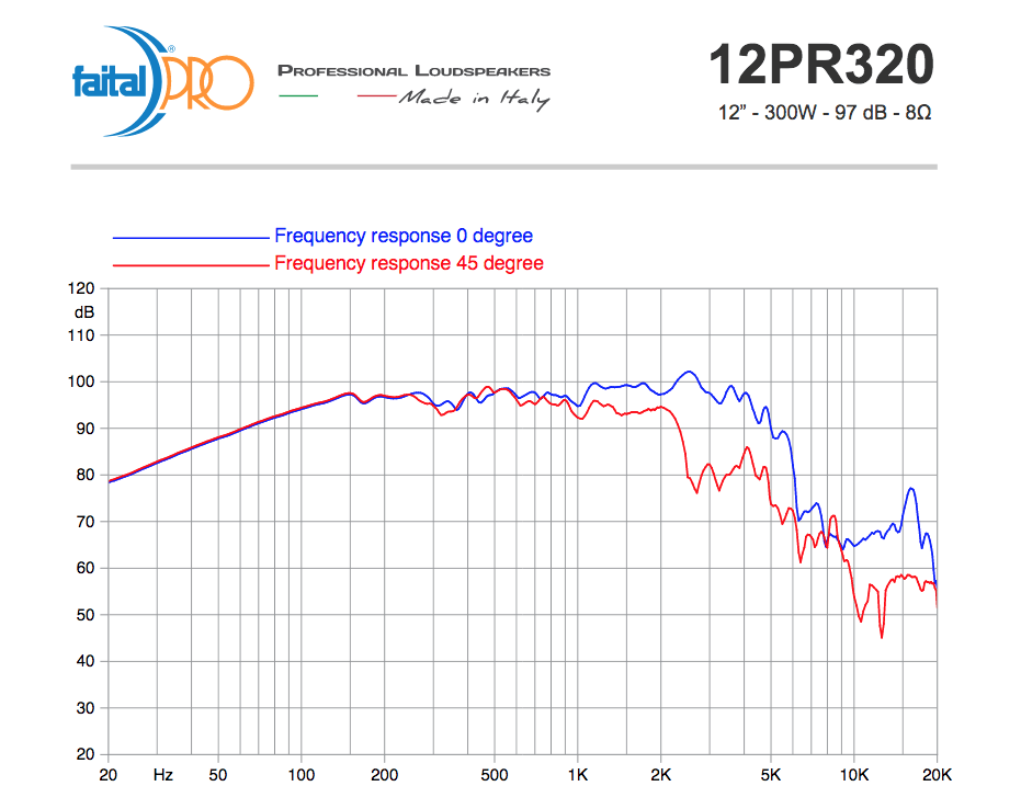

The 12PR320 dispersion is wider than 90 degree (-6dB 45 degree off axis) below 1.6kHz, <1kHz is less than -3dB.
A horn would not have to be 20" wide to match it's dispersion, 12" would be plenty.

@weltersys : the datasheet curve is in their narrow opening horn (60° or 70° IIRC).
I don't follow you, the data sheet in post #5 is of the 12PR320 12" cone.

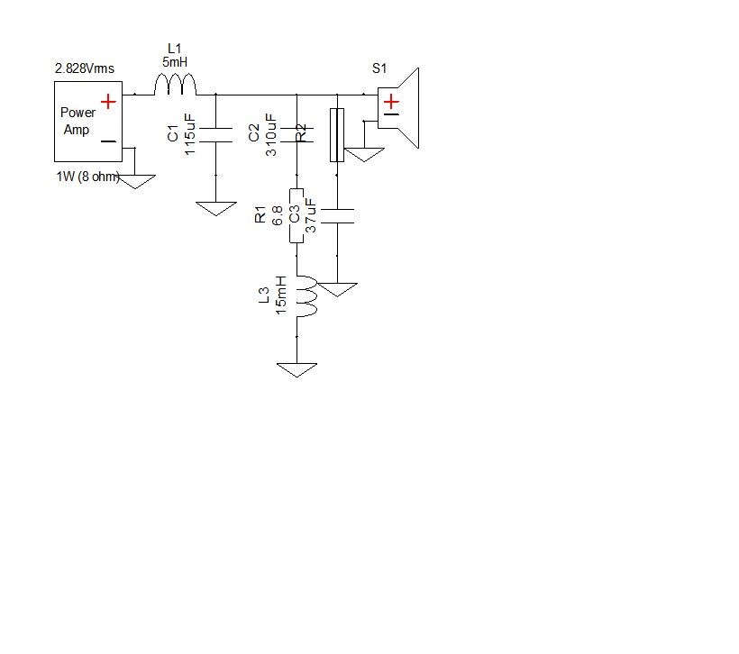

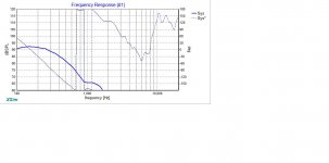

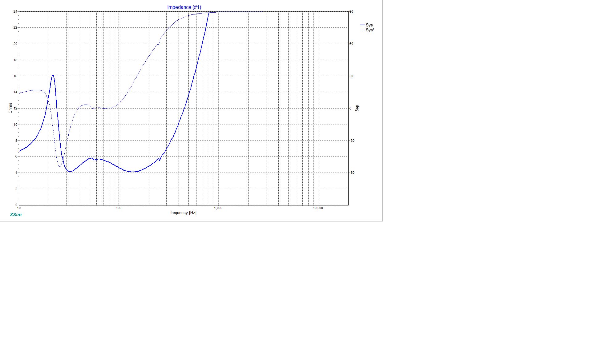

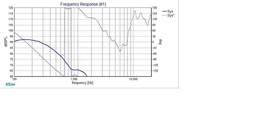

the 12pr320 seems happy in 400 hz (edit) and up range in a short fast Xsim I made thanks to Mbrennwa frd files, here on a circa 37 cm baffle:
