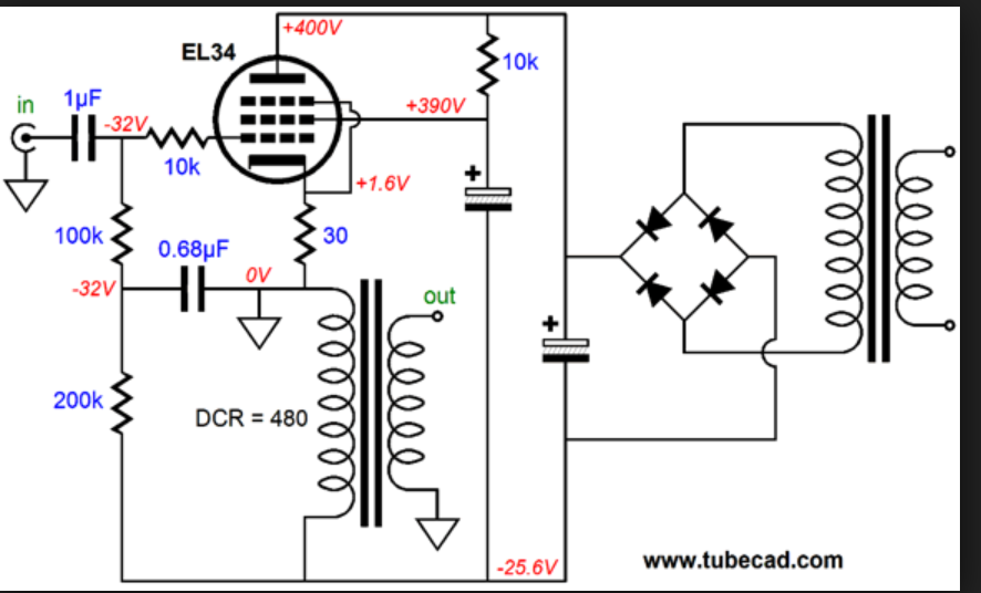

As-is that circuit is an excellent way to destroy tubes. You grounded the wrong side of the output transformer so the only thing in series with the tube is the 30 ohm cathode resistor.
That's also not inverted mode, it's cathode follower. It will require a very large input drive voltage and that 5K:8 will no longer be appropriate.
I modified the circuit from this floating power supply inverted circuit from Tubecad, its not a cathode follower. I value any input, the concept looks cool but is this something not worth trying?

Here we see the EL34's supporting circuitry and the floating power supply fleshed out a bit. Where to start? The 10k screen resistor seems to be in parallel with the load impedance; it isn't, as it sees a fixed DC voltage and all the AC power-supply noise. The 0.68µF capacitor connected to ground is there to filter away the output transformer's huge 250V voltage swings from the grid circuit. Remember the output transformer's primary will swing both hugely negatively and positively, but the average should equal the idle state's nominal -32Vdc. The 30-ohm cathode resistor is there to add some resistance to the output transformer's primary's DCR and to allow easy measurement; besides, it linearizes the output tube a tad. (The real reason it's there is that I envision three EL34s working in parallel, with a UBT-1 output transformer with a DCR of 160 ohms; and I want to prevent current hogging by any of the output tubes.)

Ahhhhhh, the problem in your schematic is you grounded the power supply. It's supposed to float.
Ignore the part of my post about the transformer. I don't know nearly enough about this circuit or mode of operation to comment on that other than the fact that DCR will be important since it biases the tube.
From what I've read the OPT should be the same impedance whether connected to the plate or the cathode.
Just my opinion, but I think both Post 46 and post 48 will not work.
Decide whether you want to build a cathode follower output, or a common cathode with plate output.
Then make the schematic accomplish that accordingly.

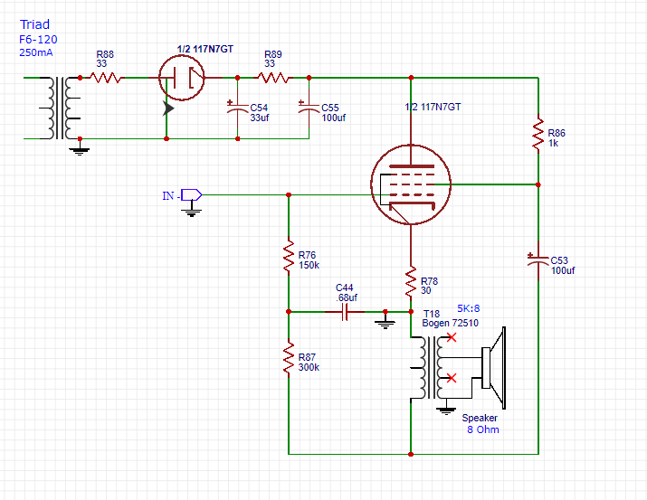

I am learning from you all here, who obviously have way more knowledge than me so can you please explain why it wont work? I plan to try a test board with this because the guy from Tubecad sounds like he figured it out, but I don't know what is wrong with it.
Blaxshep,
You want to use 3 each EL34 in parallel single ended and a UBT-1.
A UBT-1 primary to 8 Ohm output has a 14 to 1 voltage loss (not power loss).
A Cathode follower has a voltage gain of less than unity (less than 1).
Using a cathode follower and UBT-1 and no input gain stage before it
will not have enough gain.
3 parallel EL34 tubes in pentode mode has too high of a plate resistance to work with a UBT-1 for anything except to use it as a guitar amplifier. And it will not have enough gain to use with the low output guitar pickup. It will have some gain, but the damping factor will be very low, the distortion will be high, and frequency response will not be good.
3 parallel EL34 tubes in triode mode has low enough plate resistance to work with a UBT-1.
But the gain will be low, perhaps 7 from the tubes, and 1/14 from the UBT-1, the total gain will only be 1/2. 3 Volts peak from a CD player will only give 1.5V peak to the loudspeaker. And it will not have enough gain to use with the low output guitar pickup.
Your posts 46 and 48 are wrong.
The plate is not driving the output transformer.
The cathode is driving the 30 Ohm resistor.
There is nothing driving the output transformer.
What will you use the amp for?
How much power do you need?
What is / are the signal sources?
What is the loudspeaker load?
Hi Fi or guitar amp?
Then we can find what modifications you need to get there.

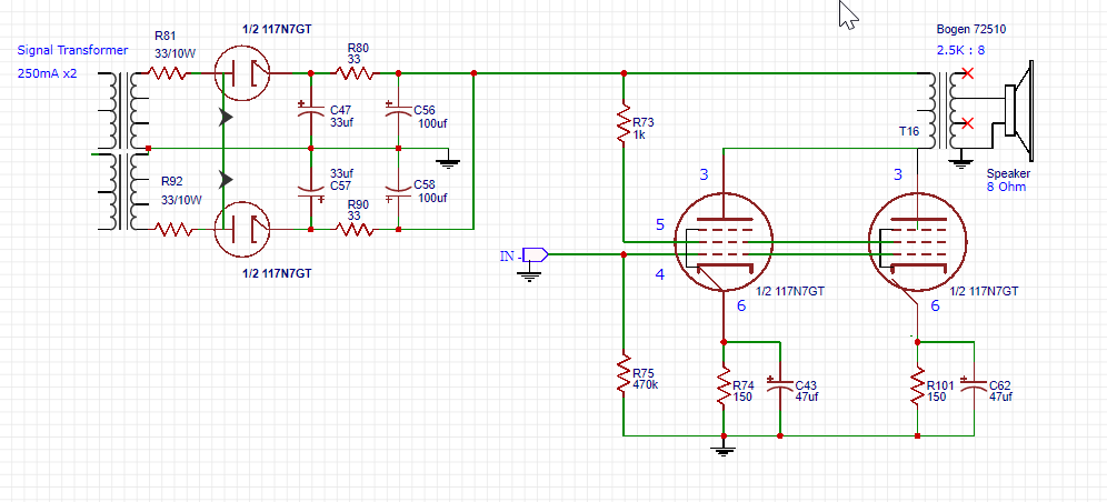

OK, what I am trying to do is make the 117N7, which is said to be crap, into a good sounding and safe mono block amp to power an old RCA 45 turntable or a usb, etc, ... So I was thinking if I had two 117N7 PSE I could put them out of phase to cancel the 60Hz noise and come out clean with 2W output. I think in PSE the 5K output transformer would be 2.5K instead of the 5k for a single tube, Im giving up on the inverted, floating based on the responses here, so what do you think about this design?

If you have the power transformers connected in the right phases, then you have a full wave B+ supply.
The main ripple will not be 60Hz anymore, it will be 120Hz, but it will be much better filtered.
You can connect one filament per secondary (you did not show the connection dot).
The gain in this circuit is because the tube is conected in pentode mode.
The parallel connection might be subject to oscillation.
Use two 1 k Ohm control grid stopper resistors, connected right up at the tube sockets, and the other ends connected to R75 and the input. And use two 2k Ohm screen resistors, one for each screen.
2.5k for two tubes is the same as 5k for one tube as far as the current per tube, and as far as the primary voltage swing.
But the output transformer needs to work with 2 times the current.
The transformer must be a single ended type, i.e. a Hammond 125SE series (is the Bogen for SE or for push pull?).
There will be no effective damping, i.e. for a traditional 2 way bass reflex or acoustic suspension speaker (because of the pentode mode that gives the gain).
There will not be very much gain, these kinds of circuits were used with what was basically an efficient midrange driver, and a high output crystal or ceramic cartridge in the turntable.

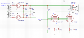

If you're going to do that, then you're better off using the integral diodes as a proper Full Wave circuit, and connect the pentode halves as a PP output stage. You could split phases with an IST at the input which could also give you some voltage gain. These pents aren't exactly intended for sonic quality, given the intended uses. Coming in at 6.28% isn't all that great, but it's not terribly out of line for this type of application. As to how that sounds, if it's mostly h3 it might be a bit on the "aggressive" side, but you may like that for some material. If there is a lot of h5 and higher, it'll sound pentode nasty without any NFB to clean up the harmonic messes.

Blaxshep, your biggest problem with using only this tube alone is going to be drive voltage. Even headphone outputs run ~3.3V signals and to fully drive this pentode you will need a 6V signal.
Now, there IS a way to use some of the waste from this guy to get that drive and still use tubes. The 50mA running current of the 117N7 is convenient because you can sub the heater of a 1U4 battery pentode for ~30 ohms of your cathode circuit and run a gain stage. This would also allow you room for feedback which would clean things up too. Since the 1U4 only wants to see about 90V at 1.5mA there is plenty of room to make quiet B+ for it.
If you want to go with a push pull circuit you can still run the 1U4 heaters but you might need to shunt extra current. Not sure how you'd setup a directly heated phase splitter but I'm sure someone here knows. There is self-split push pull but it isn't very efficient at much more than getting rid of 2nd harmonics.
Blaxshep,
Yes, for push pull, you might as well either go triode wired and no negative feedback (lower power), or pentode mode and use negative feedback. But these do not have enough gain, so the extra gain stage, and phase splitter is needed.
It is not easy to apply negative feedback to a simple push pull circuit when using an input interstage splitter without an added balanced or differential tube gain stage. And the interstage will have to be driven by a low impedance signal source.
By the time you make a working circuit of 117V tubes that will have gain, power, and low distortion, you have made the amp complex enough that you might consider other tubes:
Unless you are really wanting and requiring this to be a 117V filament pentode circuit, you might consider some other amplifier configuration . . .
Push Pull or Parallel Single Ended, with maybe a pair of 6V6s, EL84s, 6CK4s, 6BX7s, 807s, or many other tube types, plus a dual triode input stage for gain and phase splitting for push pull; or a single triode for gain in a parallel single ended amp.
