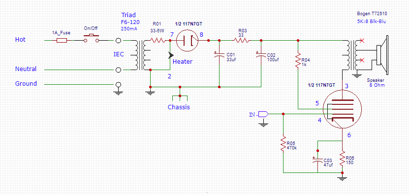

Blaxshep,

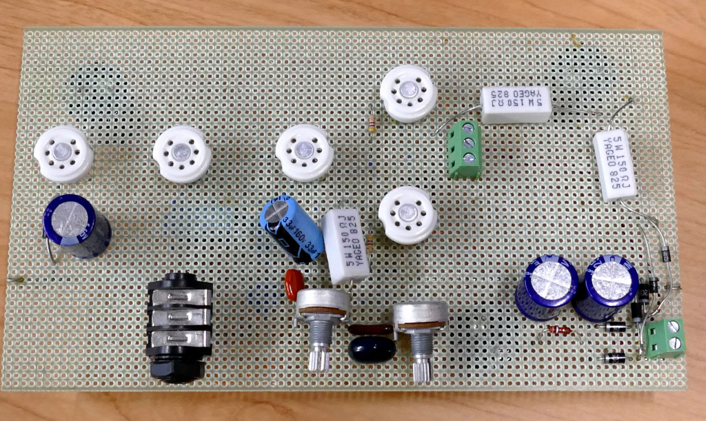

1. You still forgot to ground one end of the output transformer secondary.
What if the primary and secondary short to each other, it is not likely, but neither is a "successful lightning strike" directly to my body. The result can be the same.
2. The only significant current leakage to the chassis that I see during normal operation is from the power transformer primary to its laminations, and the output transformer primary to its laminations.
Why use a 100 Ohm resistor, and a 1 uF there, just directly connect the chassis to the other ground connections.
3. Ground loops are pernicious. For example, make a direct connection from the bottom (-) of the 33uF cap and the bottom (-) of the 100uF cap to the bottom of the power transformer secondary. The impulsive current could cause a magnetic field that will cause interference.
Keep that "aperture" short, and away from other circuitry.
Those kinds of things are not something that shows up on schematics.
But it is one cause of hum that so many on this web are experiencing.

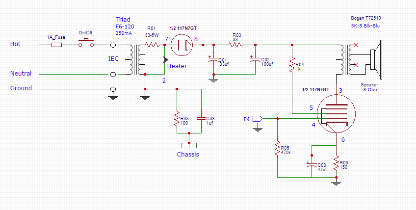

Sorry for the inconvenience, I have removed the schematic. For anyone interested it's called G286V, a popular amplifier/ record player. I posted it only for hystorical reasons.
You're connecting your power plug to the audio ground, and then the audio ground to the chassis via your underwhelming loop breaker?
Ahhh, now it is safe, as long as no fingers touch anything, and as long as no parts burn up (have the proper ratings of voltage, power, etc).
If the pentode dies, the voltage ratings of the 33uF and 100uF need to be more than 1.414 times the secondary rms voltage (and do not forget to account for the primary voltage rating versus your actual maximum power line voltage, that will cause the secondary rms to go up proportional too).
Thanks very much for the lesson on safe circuits. I have been using 160V caps in my breadboard sounds like I should use the 250V caps I have for the real thing.

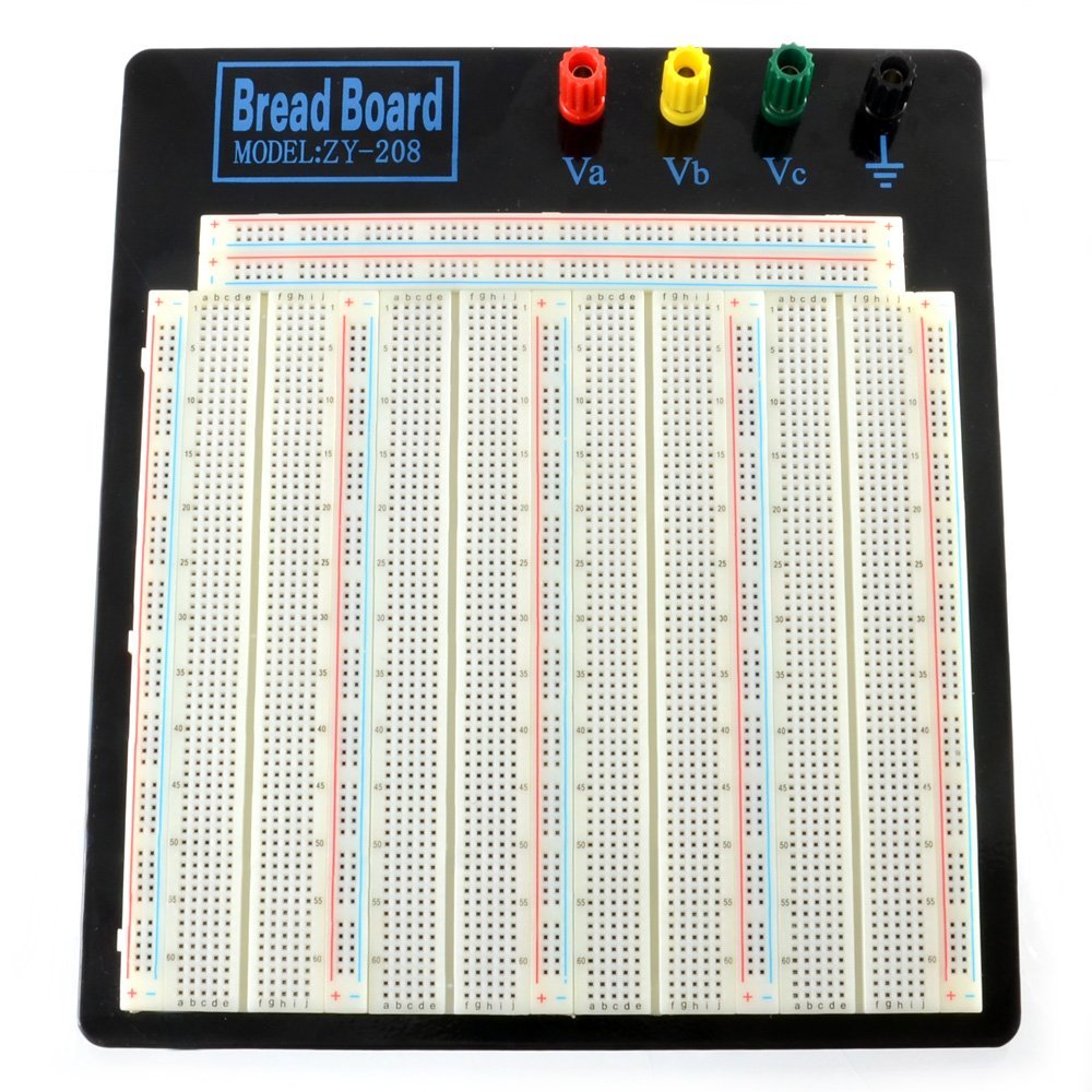

When you say breadboard, what are you using? It's not one of these is it?
http://www.ladyada.net/images/parts/breadboard-half.jpg
Because those shouldn't have anything over 48v on them.
Good point and I've seen a few used in interesting ways by people who should have known better..
Anything running from rectified isolation transformer should have at least 200 volt caps in it, but 250 volt caps are more common, so that's what I use.
Most isolation transformers are not 1:1. They have a slight step up ratio so that they will be 1:1 at full rated load. The popular Triad N-68X can put out over 140 volts with a light load on today's 120+ volt line voltage. I have one in a little guitar amp which pulls 100 mA for the heaters, and 40 to 80 mA for B+ depending on how hard you hammer it. The B+ is about 170 volts at idle and 165 cranked......too much for 160 volt caps. It has 250 volt caps.
I use 400 volt caps in circuits that run a voltage doubler from an isolation transformer. The B+ runs from 340 to 355 volts depending on load, again too much for common 350 volt caps.
Running the isolation transformer backwards, plugging the single secondary into the wall, and wiring the primaries in series for 240 VCT does result in a lower B+. I still use the higher voltage caps.

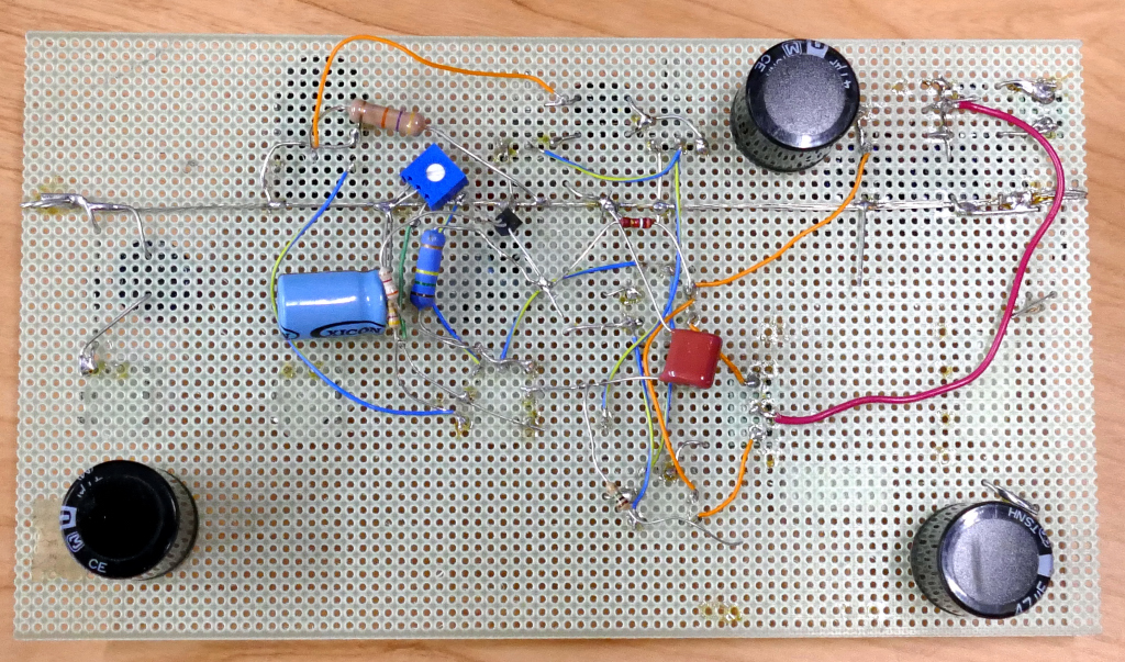

I usually make a PCB, or do something like this:

I use 250V caps in the doubler (in place of diodes in the normal bridge circuit), and 450V at the exit. Is that what you do? On 120V the peak is only 170V, right?I use 400 volt caps in circuits that run a voltage doubler from an isolation transformer. The B+ runs from 340 to 355 volts depending on load, again too much for common 350 volt caps.
Correct. The line voltage here runs anywhere from 122 to 128 volts and dances all over the place during the winter when everybody's electric heat is cycling. The pole transformer is right outside our house such that the service drop ia maybe 30 feet long. We get the most voltage.
yes, I will use 250 volt caps for each individual stage and a 400 volt cap for the output. 400 volt caps are the common voltage used in SMPS and PC power supplies, so they are the most common voltage on the surplus market.
You are no doubt one of the most fearless experimenters I know
I have grown more conservative as I get older. Too many things have blown up in my past that caused me no major grief. Looking back any one of those could have ended very badly.
I have exceeded the common sense voltage on the little white breadboards a few times. I keep several empty rows between HV rows and use a power supply that will not cause a major bang even when shorted out at full voltage.
When I was in a technical high school (1967 - 1970) we had some large versions of these boards. They were about 12 X 18 inches, made of clear plastic and designed for vacuum tube breadboarding. They were called DeVry boards after the tech school of the same name. I can not find any info on these now, but it would be cool to have a few. There were also plug in tube sockets in 7, 8 and 9 pin flavors.
When your'e about to flip the switch on anything new, or containing serious amounts of stored energy, it is wise to consider all the possible failure modes, and how to handle them before flipping the switch.
I have been working on a DIY SMPS for vacuum tube power. I think it will get tested outside at the end of a long extension cord for its first connection to line voltage.
If you are feeding that thing 250 volts make sure that metal plate is grounded. I have the same plastic pieces, but mounted them myself on a piece of PC board with a .020 sheet of Lexan between the plastic parts and the PC board which is connected to earth ground and power supply negative.
I wouldn't put that much voltage between adjacent strips either. I use an old Knight Kit vacuum tube regulated power supply that will not blow much stuff up even when shorted out.
