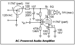

i ran a cross this on an ee site does this have any real place in audio does anybody know. seems kind of cool to me eliminating pt.
here is the link
http://www.du.edu/~etuttle/electron/elect27.htm#117
also here is the circuit he mentions
here is the link

Really cheap record players (like those you give to kids to keep them away from the good stuff) used amplifiers just like that.
Expect Lo-Fi operation: lots of hum from the high voltage heaters and typically poor filtering of the DC rail, no gNFB to tame pentode nastiness (and it's probably a really nasty pentode anyway) very inadequate output xfmr.
It was never designed to sound good, just to be dirt cheap to manufacture. For the cost of making that thing, you can get some chip amps that'll sound far better. Also, there won't be any

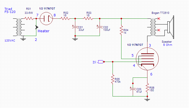

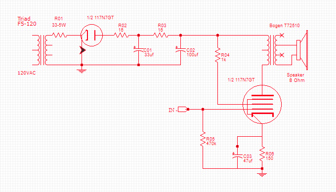

Attached is a safe Schematic for the 117N7
The rectifier diode looks backward.
The short to ground and arrow are confusing to less-experienced builders.
Which is actually 70% underrated since the heater is 90mA and the operating current is ~56mA making the needed transformer overhead for that DC around 78mA. Also, what's the point of R1 and R2? Because you are running this on a transformer you shouldn't need either one of those as the winding resistance of the secondary provides your current limiting. Run the recommended 40uF filter cap straight on the rectifier and drop DC from there.

Thanks for the advice, I actually used a 250mA transformer but I thought a 100mA would also work, you're saying the diode current is in parallel to the heater current not coming from the heater current? As for the filter I used 2 RC filters to reduce the ripple better, you think just a cap would be just as good?
Yes the heater is in parallel with the diode rectifier, at minimum a 250mA transformer is required here.
Yes, diode current is parallel to the heater.
I'm saying the resistors immediately before and after the rectifier shouldn't be there. You still need the CRC power filter but you want cap #1 right after the rectifier without a resistor before it. This gives you the highest Cap 1 voltage so you have more to drop to cap 2 and therefore less hum.
Ok, got it thanks. The first resistor before the diode is there to limit the voltage on the heater without it I get almost 130V coming out of the transformer.

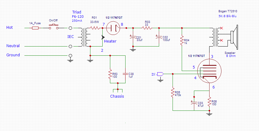

These incomplete circuits make me nervous, some will try and duplicate it verbatim, without regard to the following:
Use a 3-wire grounded outlet, 3-wire IEC power cord, and 3-wire IEC input socket on the amp.
Use Hot and Neutral to run the primary circuit, and be sure to add a fuse and switch in series with the primary.
Order of connections, Hot, Fuse, Switch, Primary, Neutral.
Ground the amp commons (bottom of DC power, bottom of self bias resistor, the bottom of the output transformer secondary, and the metal chassis). Connect all these to the IEC socket ground connection. Your signal input connector also needs to connect its ground to this same ground.

Spend the extra $6 and get a Triad N-68X. It is a 50 VA transformer for $15.81 at Mouser. I have a 4 tube 4 watt series string guitar amp running from one. Its been alive for 3 years and I haven't blown it up yet.
Do pay attention to the proper grounding comments made by 6A3summer. This MUST be followed if you plug anything metal into the amp like a CD player or a guitar. A shorted part can electrify the whole setup.
