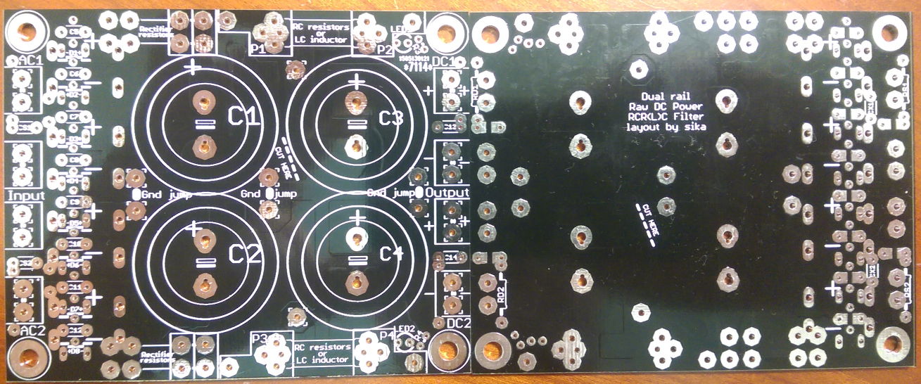

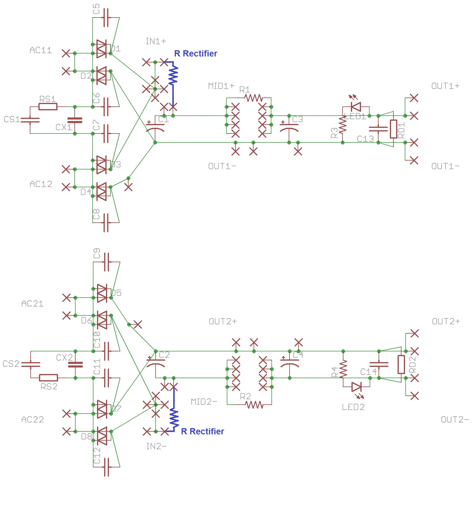

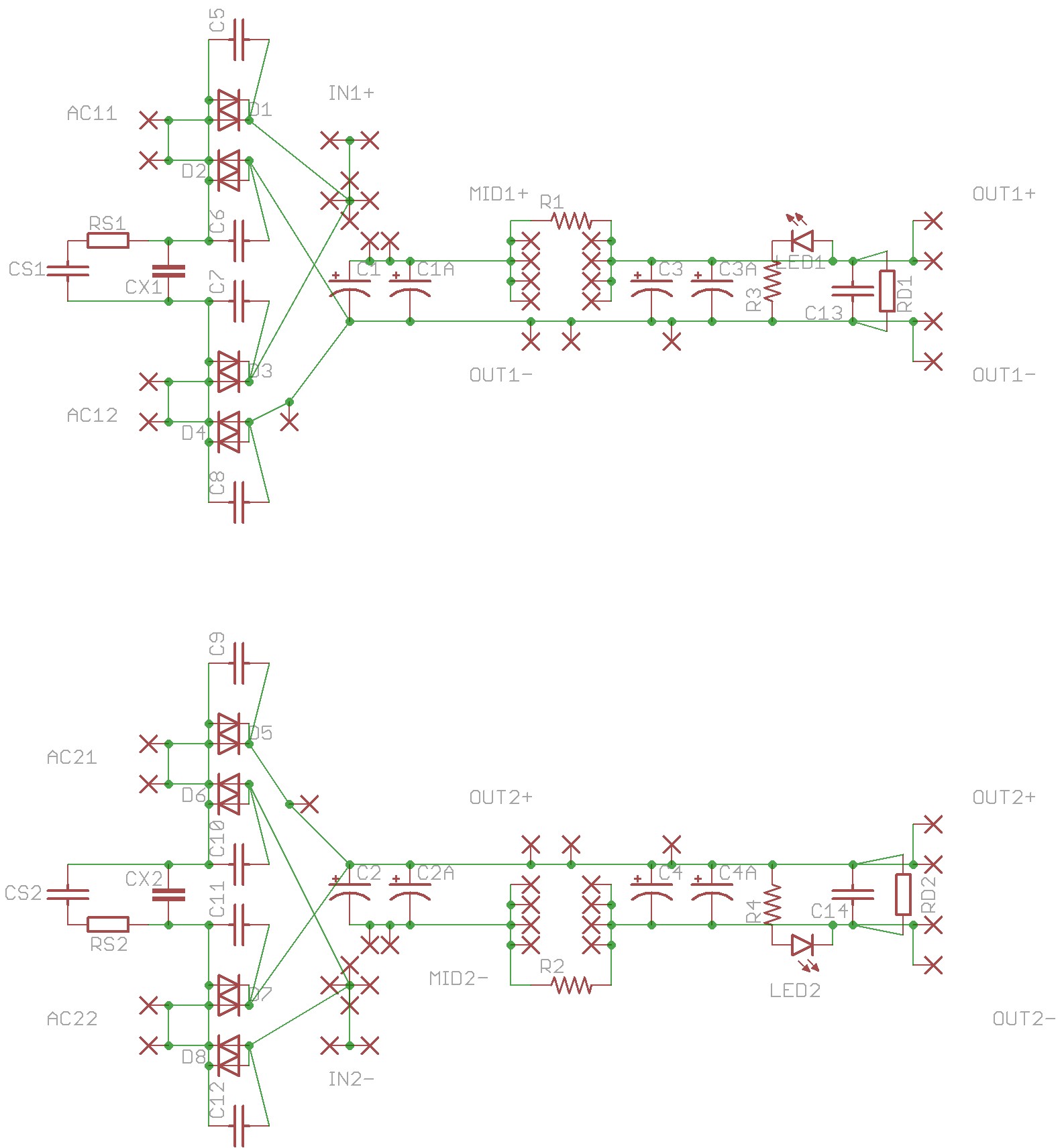

Hi Sikahr,
Can you show updated schematic for your PCB. I downloaded your last one and I see some extra parts like bleeder resistors and rectifier resistors which I can't find in that last schematics... I need to build dual +/0 and little confused about second +/0 like R placement for CRC on + side and jumper on - side.
Thank you.

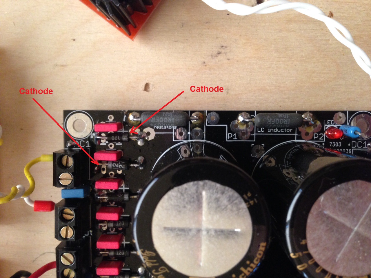

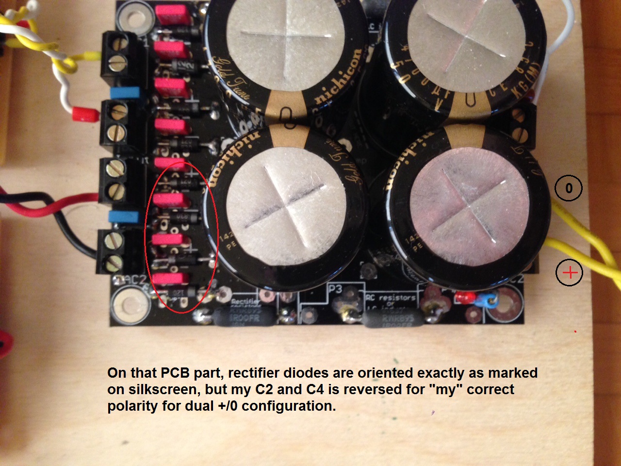

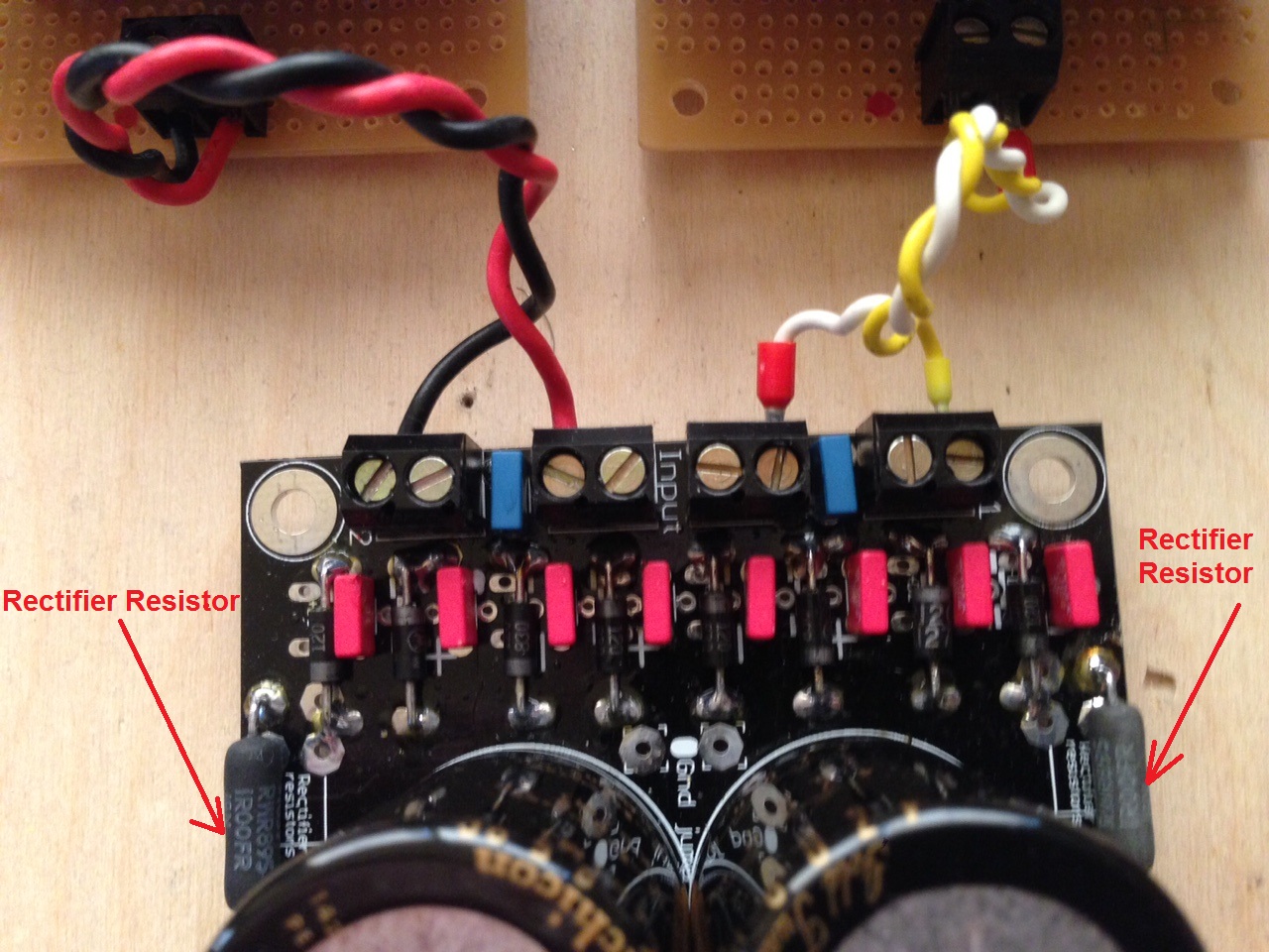

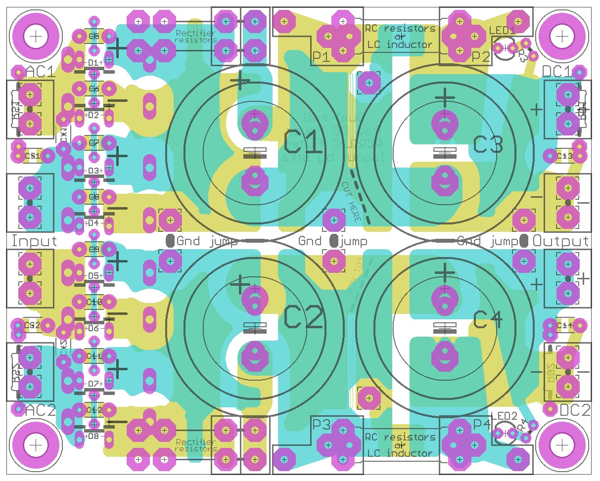

Hi Sikahr,
Thank you, but I see something that is confusing me.
First of all, you have 2 Ele caps per rail and not 4.
C1 and C3 for "+" and C2 and C4 for "-" rail.
Second, (for the top positive portion of PCB) all rectifier diodes are reversed backwards on PCB silkscreen. Take a look on D1 and D3, where anode is connected to Ele cap "+", D2 and D4 cathode connected to Ele cap "-". Bottom part rectifier block has the same issue for +/GND/- configuration.
I'm going to show some corrections on your schematics (it is my point of view and may be it is absolutely wrong for others DIYers!) and pictures on my tested board. Please let me know your opinion.
Hi, Alex You are right.
1. "a" caps are not real (only trick in Eagle)
2. Yup, unfortunately, all rectifier diodes have wrong polarity on silkscreen 🙁
At least, all are wrong marked 😀
3. Rectifier resistors are correctly marked on your schematics
4. In your case, dual +/0, you must reverse all polarized elements on bottom block, el. caps & rect. diodes, you did this, so all is OK
BR Sika
BTW Very nice build 😎

Hi Sikahr,
You are absolutely right about all point.
Also, I reversed bottom rail LED too. Sorry, I forgot to mention this.
PCB itself is very nice and it is easy to work with. I surprised by Dirty PCB quality.
It is definitely decent and I see no needs to manufacture that type of PCBs in US or EU who charge x10 for the same amount ob boards.
If it is possible to change rectifiers silkscreen for Ditry PCB guys, than this board will be nice asset to any DIYer.
Thank you a lot.
