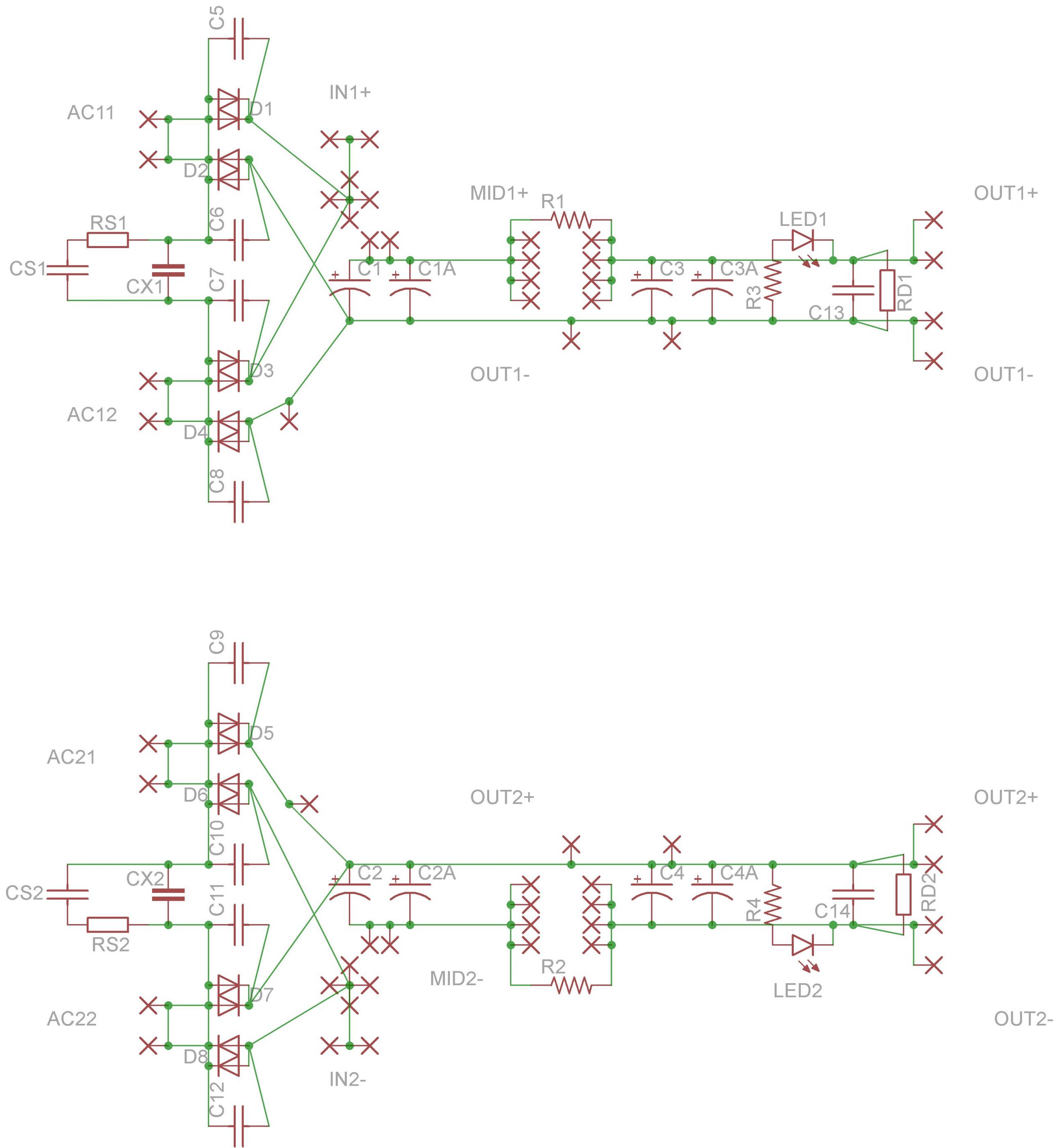

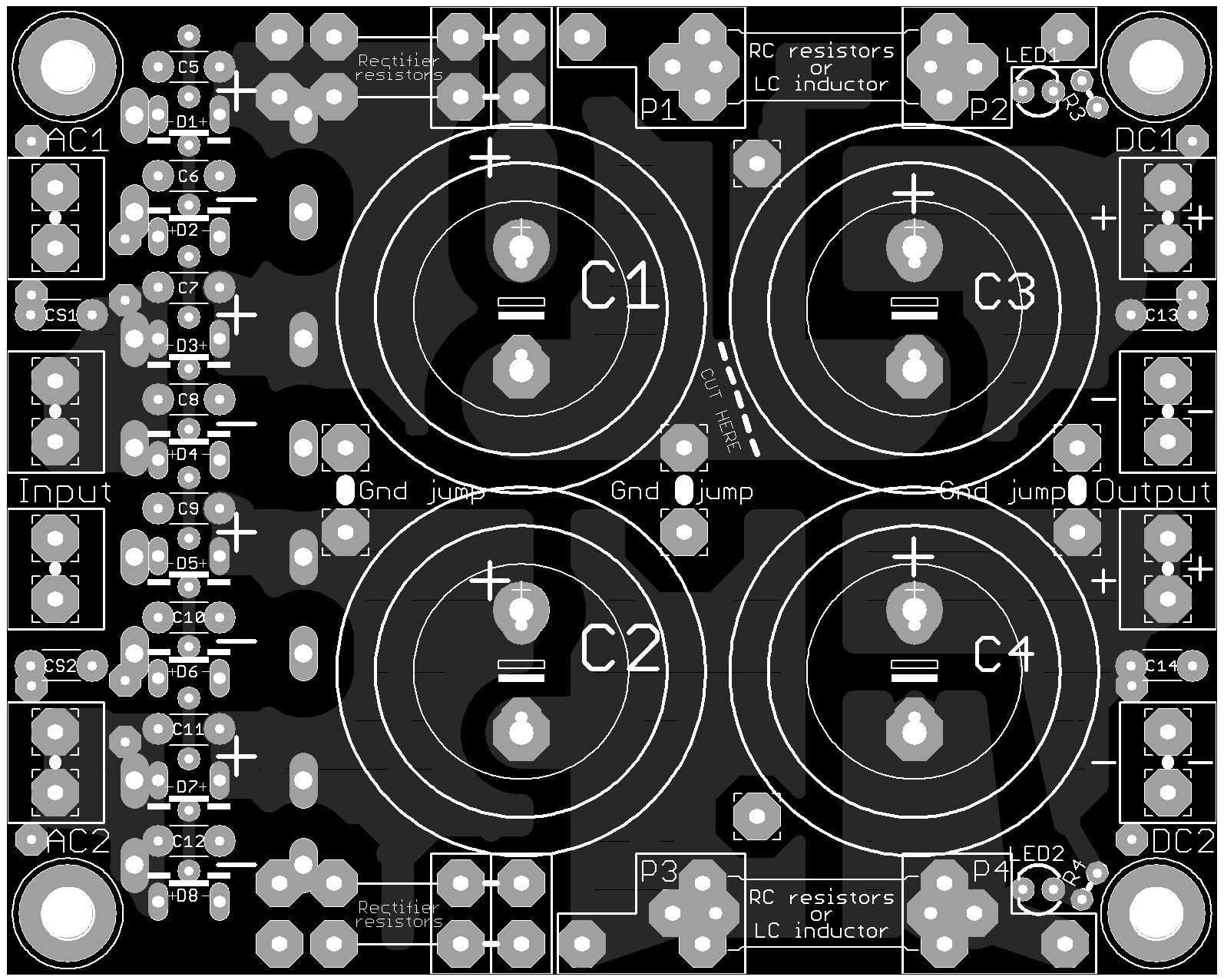

If you decide to leave the capacitors across the rectifier diodes, I advise you make allowance for a series resistor for each capacitor.
That then leaves the Builder with the option to set the R to zero/link, or to a snubber value.
Omitting the resistor is a nonsense.

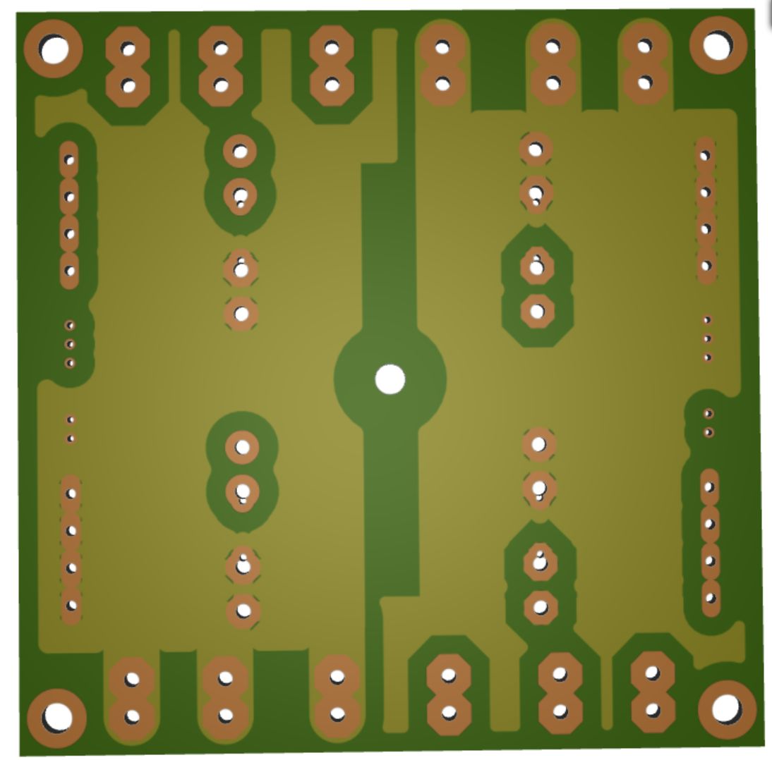

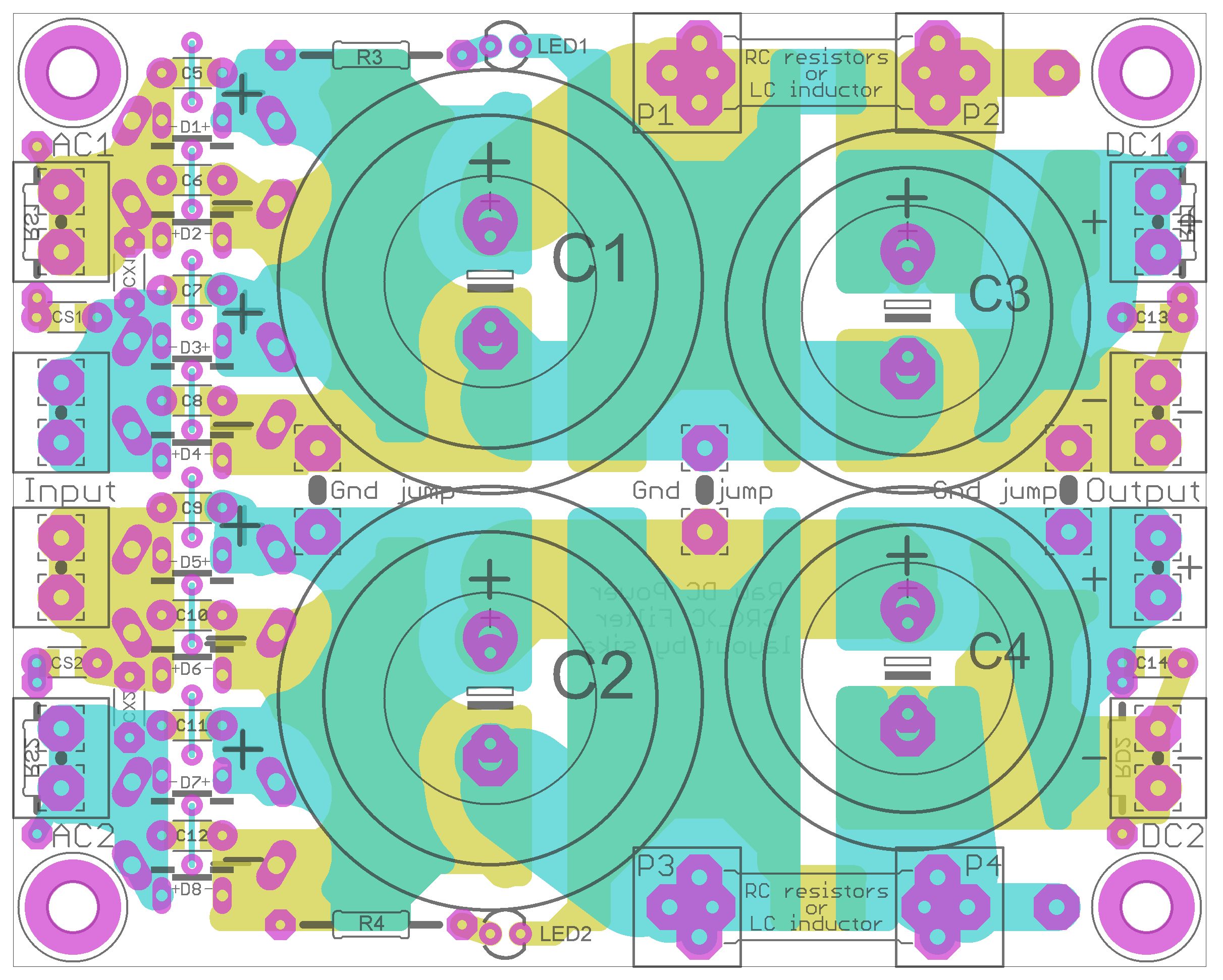

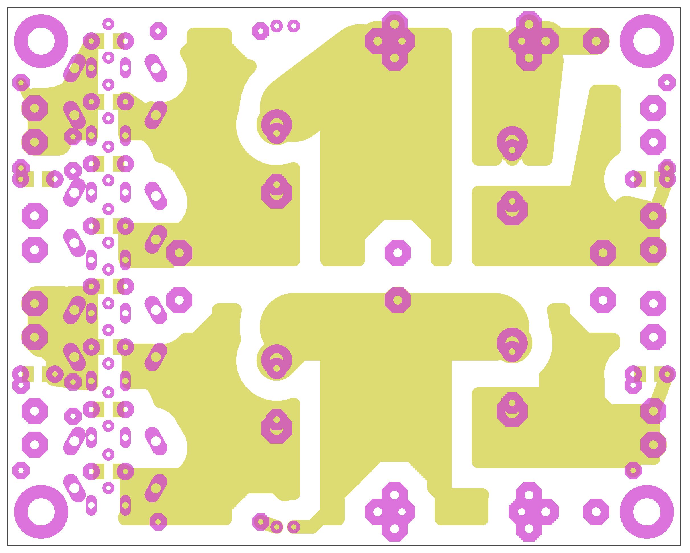

- (AndrewT) added little "island" with two connected pads between pads of diode "snubber" capacitor C5-c12. This way Builder have option:

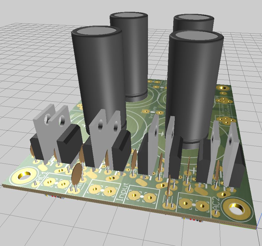

- (Keantoken) Rearranged rectifier diodes and snubber capacitors, space between back to back TO-220 diodes is 5mm now. I think best option for mounting is using spacer, this way we have mechanical rigidity & good cooling.
- (James) CS1,CS2,C13,C14 now have 6mm allowed width if mounting on top
- (James) All little element pads ("donuts") are enlarged
- (James) Added dedicated discharging resistors RD1&RD2 (resistor&LED not enough for discharging, James?)
to be continued...
- to use snubber caps only (island is disconnected). Pin spacing is 5mm and mounting is possible top&bottom.
- to use additional resistor in series with capacitor: One leg of resistor/capacitor is connected to island and other leg is connected to pads of original snubber capacitor. In this case resistor and capacitor are mounted on the bottom of the board. Pin spacing is about 3.5mm for both resistor&capacitor.
to be continued...
James:
- Resistors in ground tracks. 2 reason against:
- Resistor between rectifiers and first cap.
I'll think about it. I can shrink first cap to 30mm and put pads similar between P1-P4 but shorter. Maybe.
- Not enough space.
- Eventual position on board is between Caps, very impractical for changing

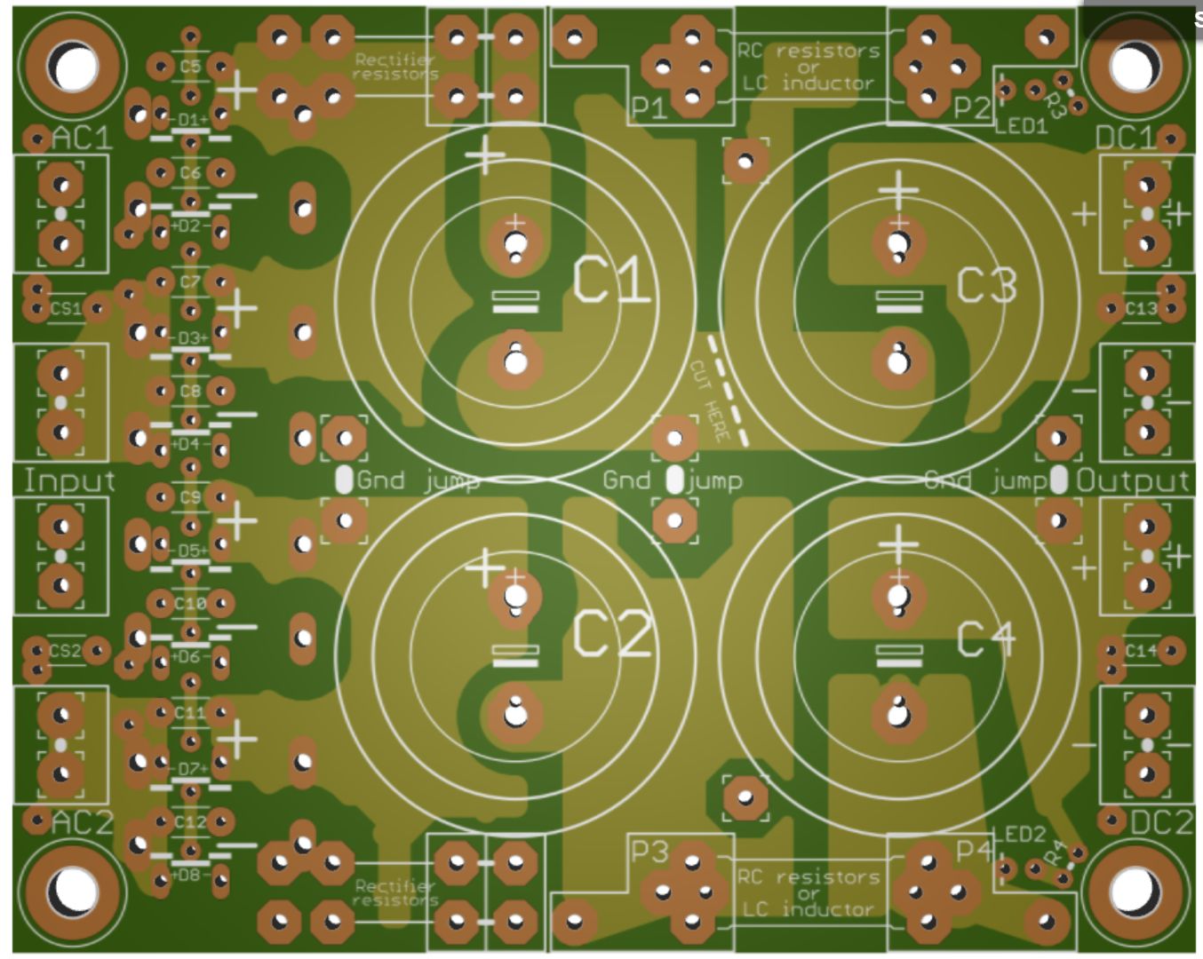

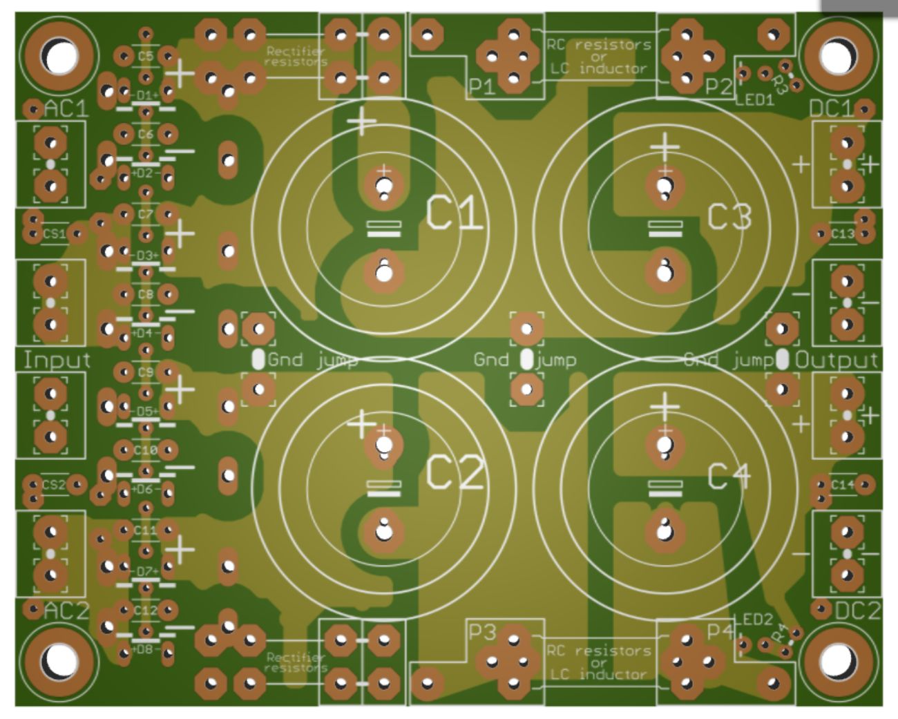

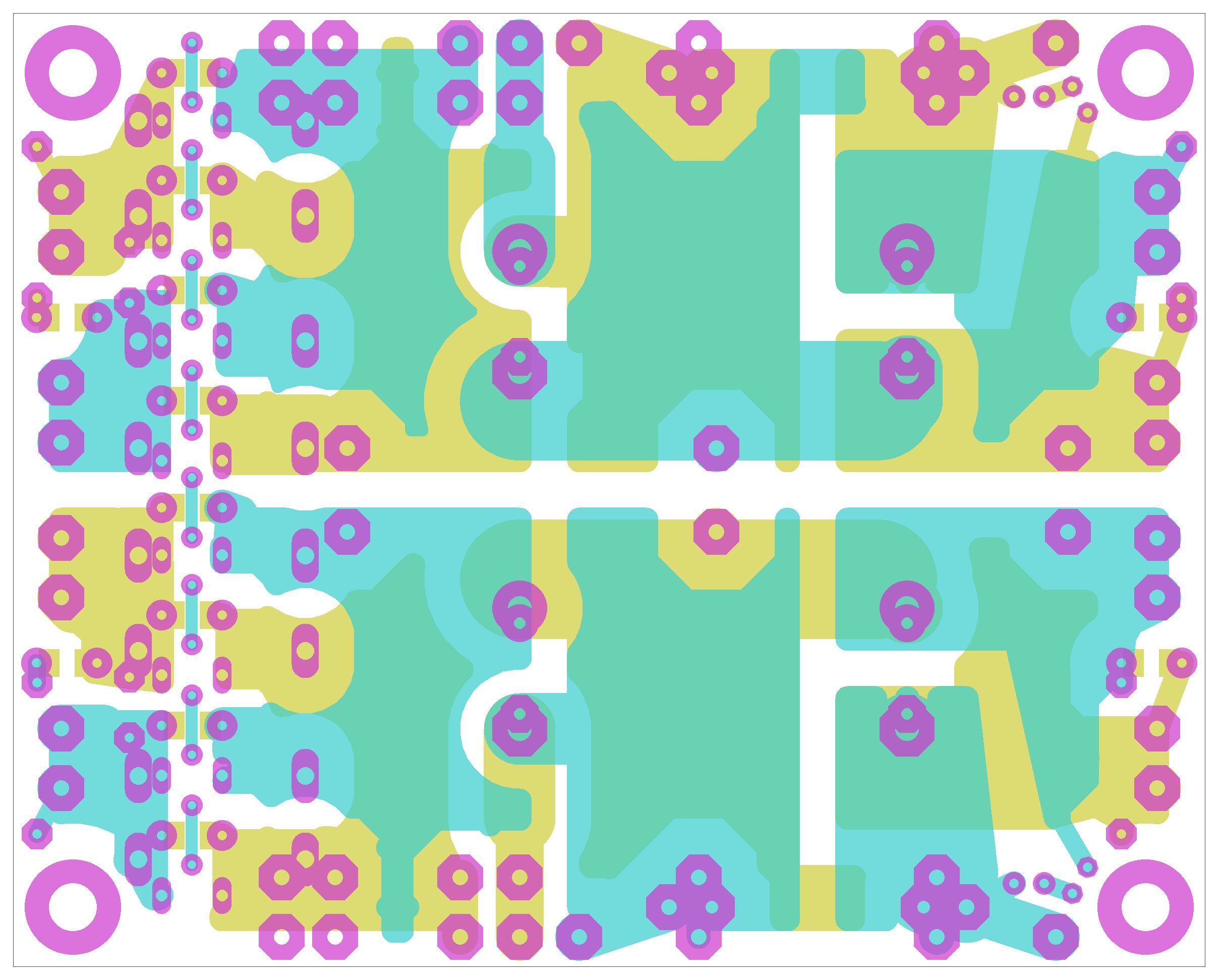

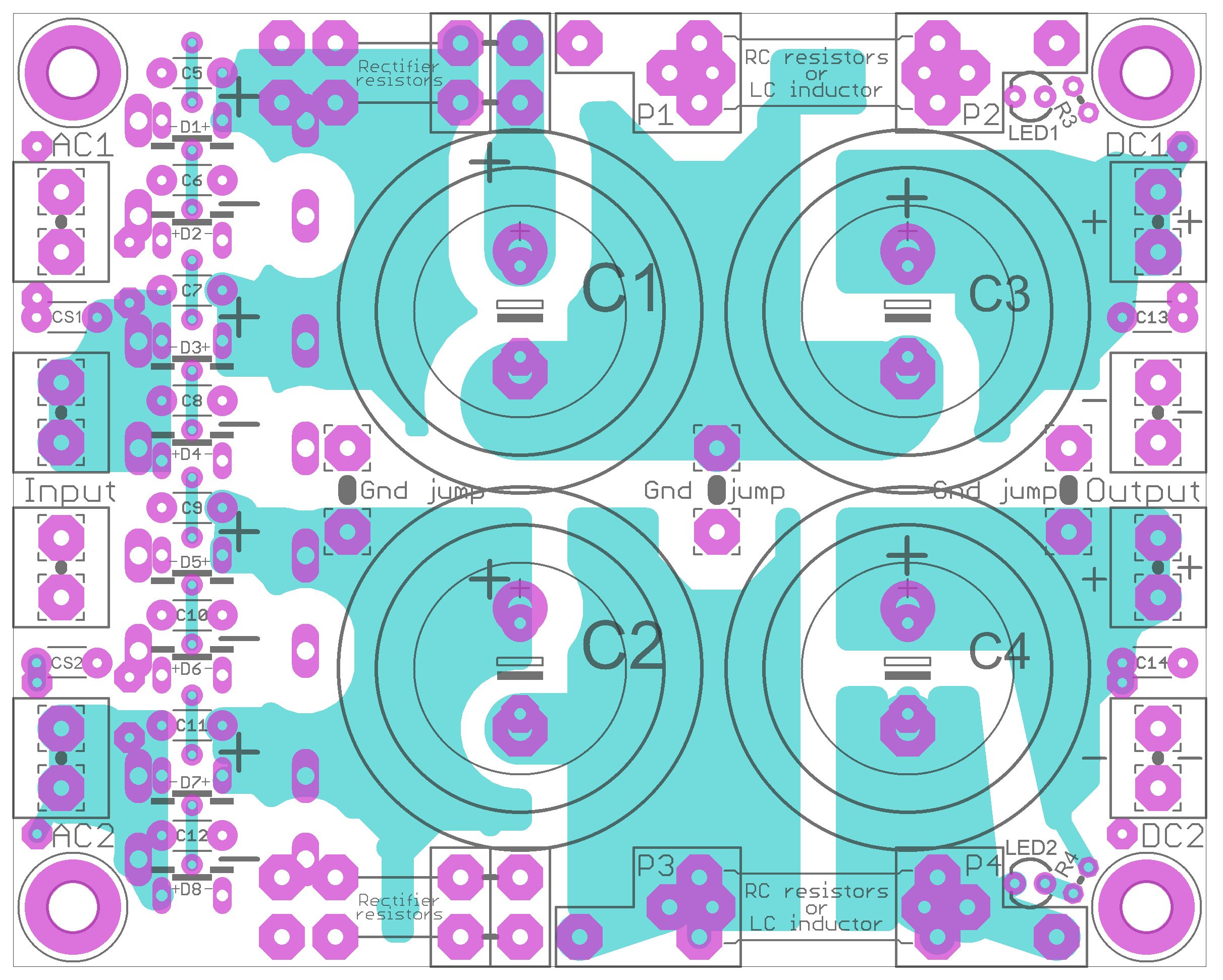

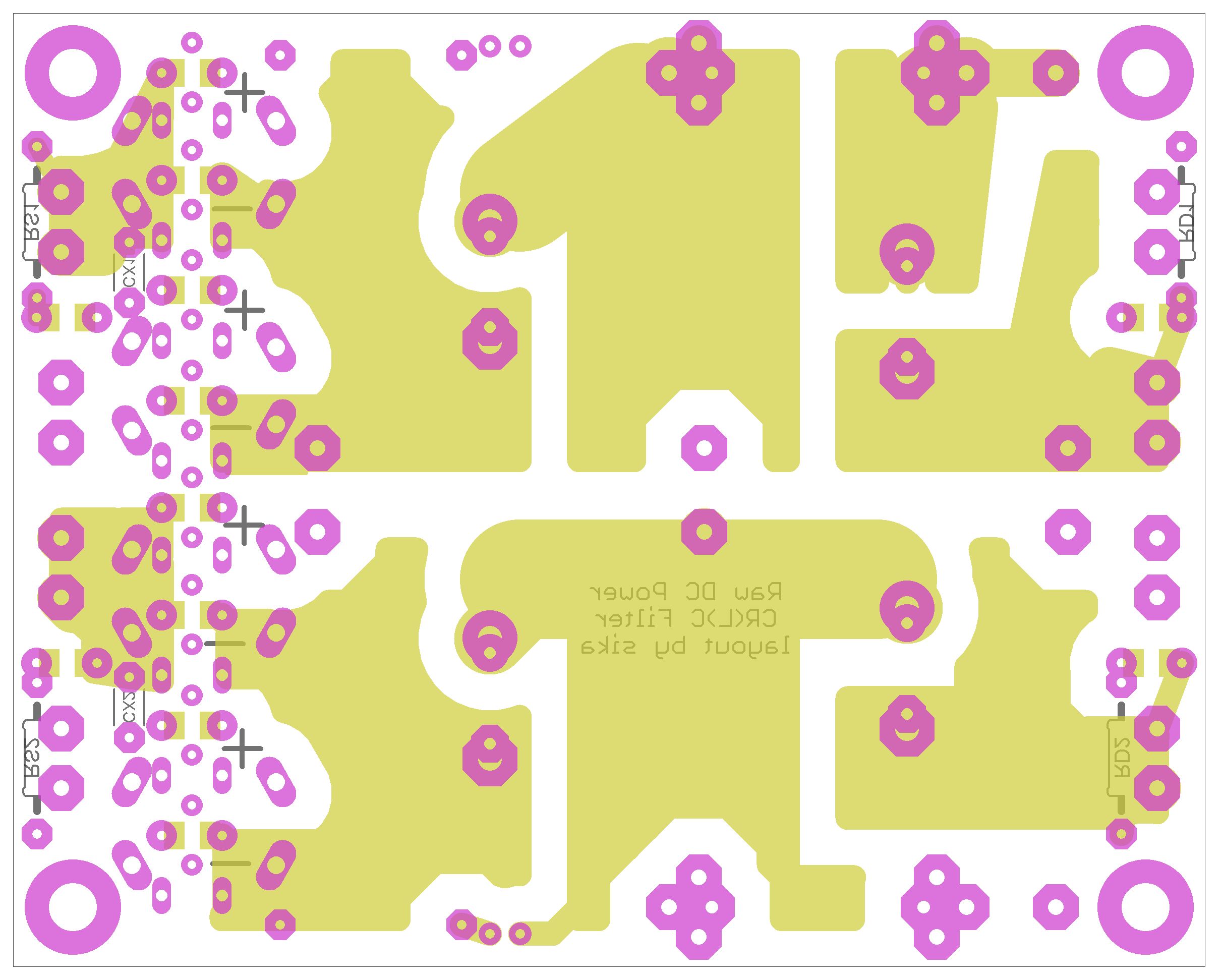

Done with additional rearrangements.
All please check one more time.
I think you've got everything covered now -
I see the short blue tracks under the caps C5 - 12 for R+C across the diodes? It's getting pretty busy in that area now!

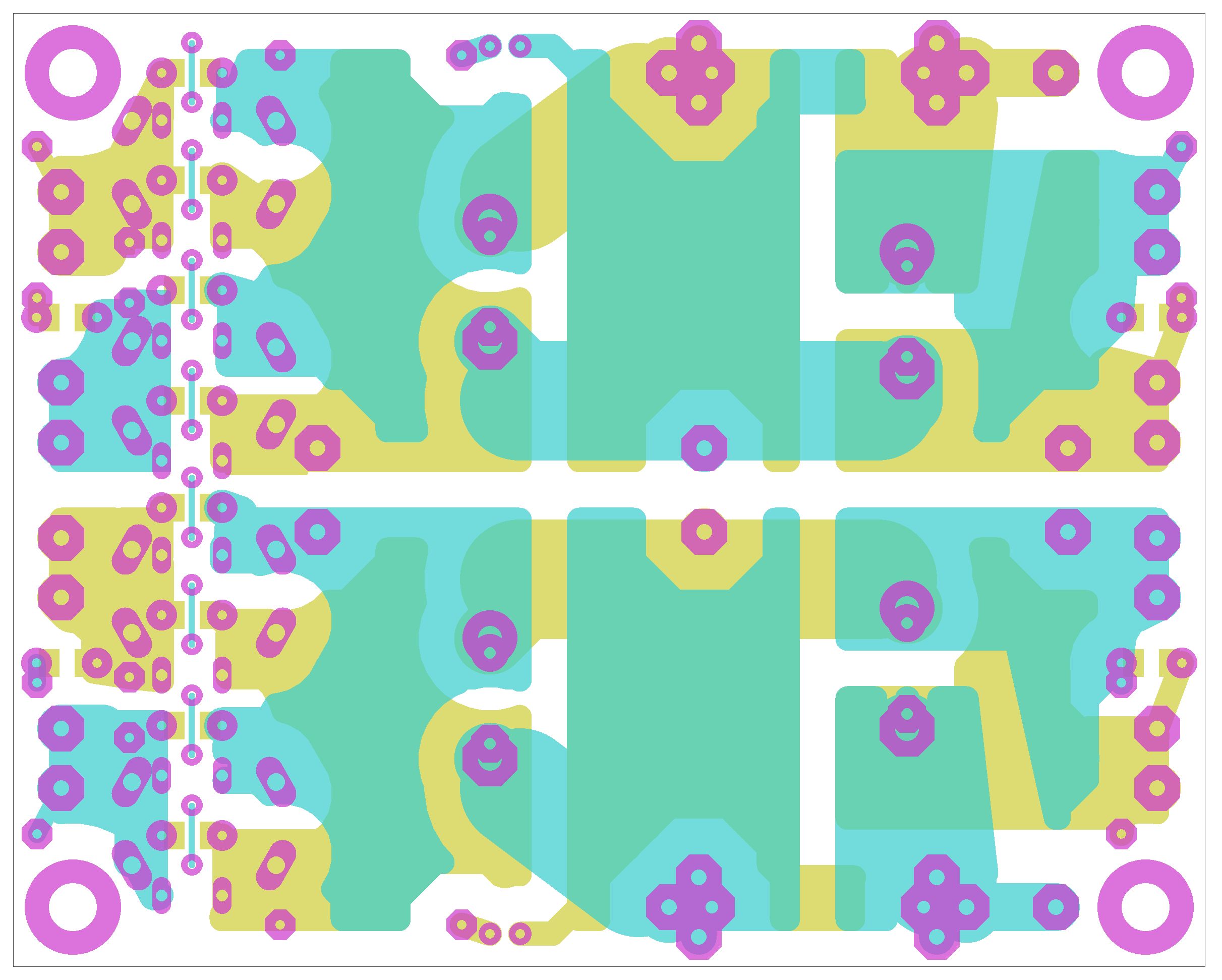

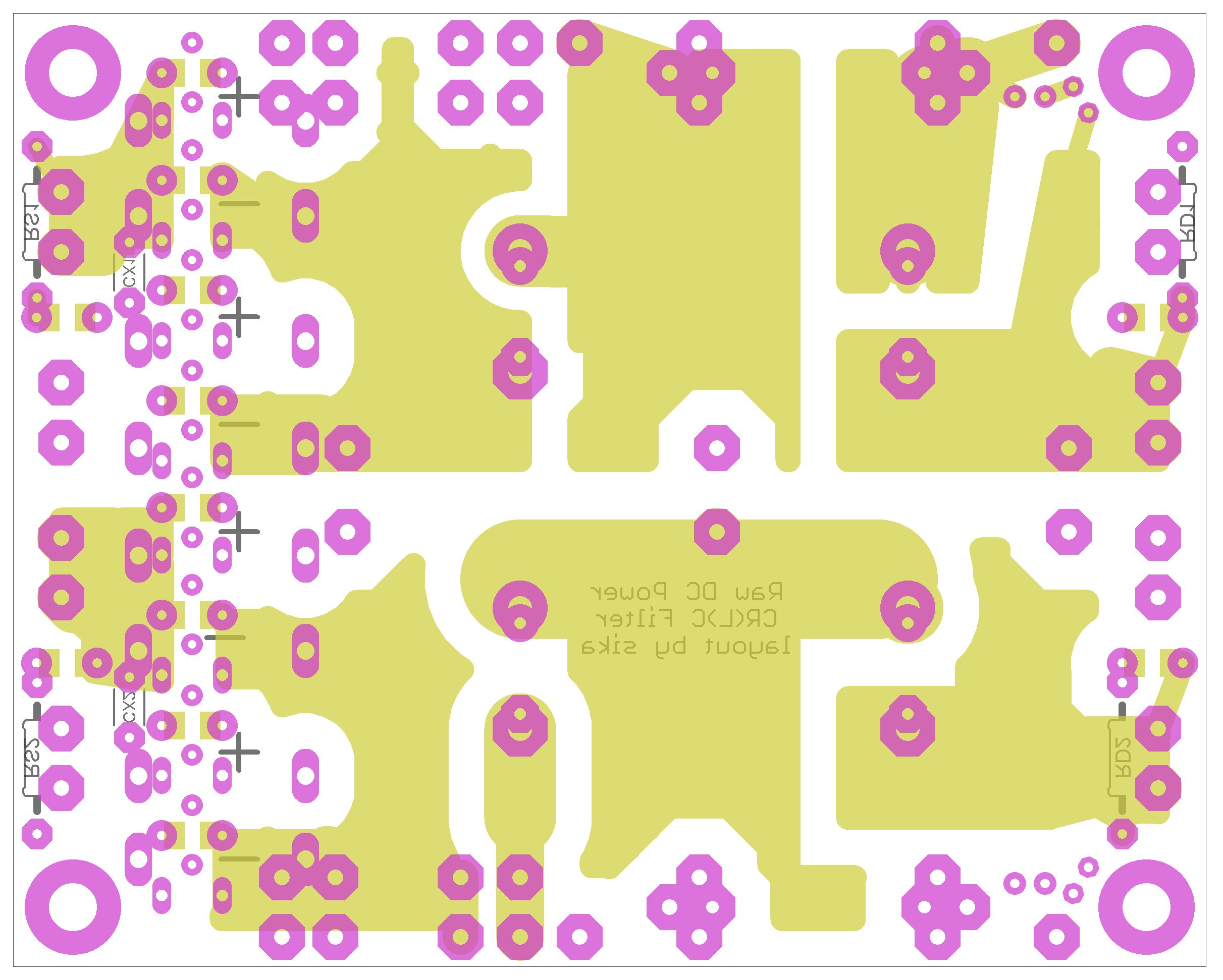

From the writing on the 5th thumbnail, the yellow colour is the bottom layer, yes?
Aah, found the discharge resistors RD1 & RD2, hidden next the output terminals and I see you've moved the leds to the corners - neatly done, that.
Could you do one last addition? if looking at the left hand thumbnail, could you add a donut directly below the "P1" terminal just inside the edge of the ground plate of C1, C3 (and a clearance hole on top plate between C2 and C4) and clearance space on the bottom plate - it'll enable a simpler setup to add a series resistor between the gnd terminals of C1 <-> C3 by cutting a groove across that ground plate (for C2 <->C4, it's the opposite with clearance hole on top plate and donut on bottom plate) - probably not often used but if simple to add, would like the possibility - it'll also make better use of that central "Gnd jump' donuts
.... and I've finally run out of things to say!! Thanks for your patience.
Ordered (this time in black).
I'll wait a little before enable order for others, want to be sure there are no manufacture problem with the board.
Manufacturing done, no problem 🙂. Shipped.
Ordering enabled.

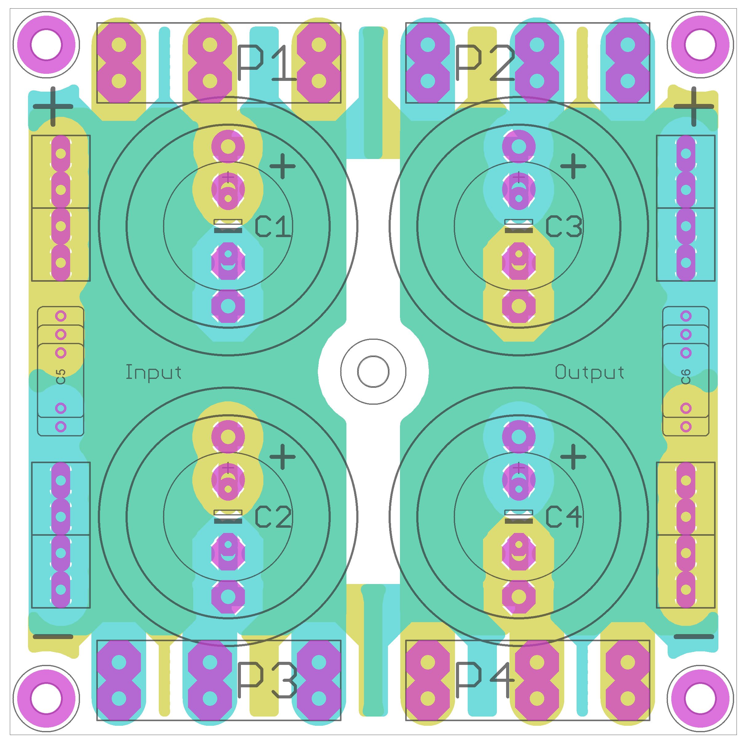

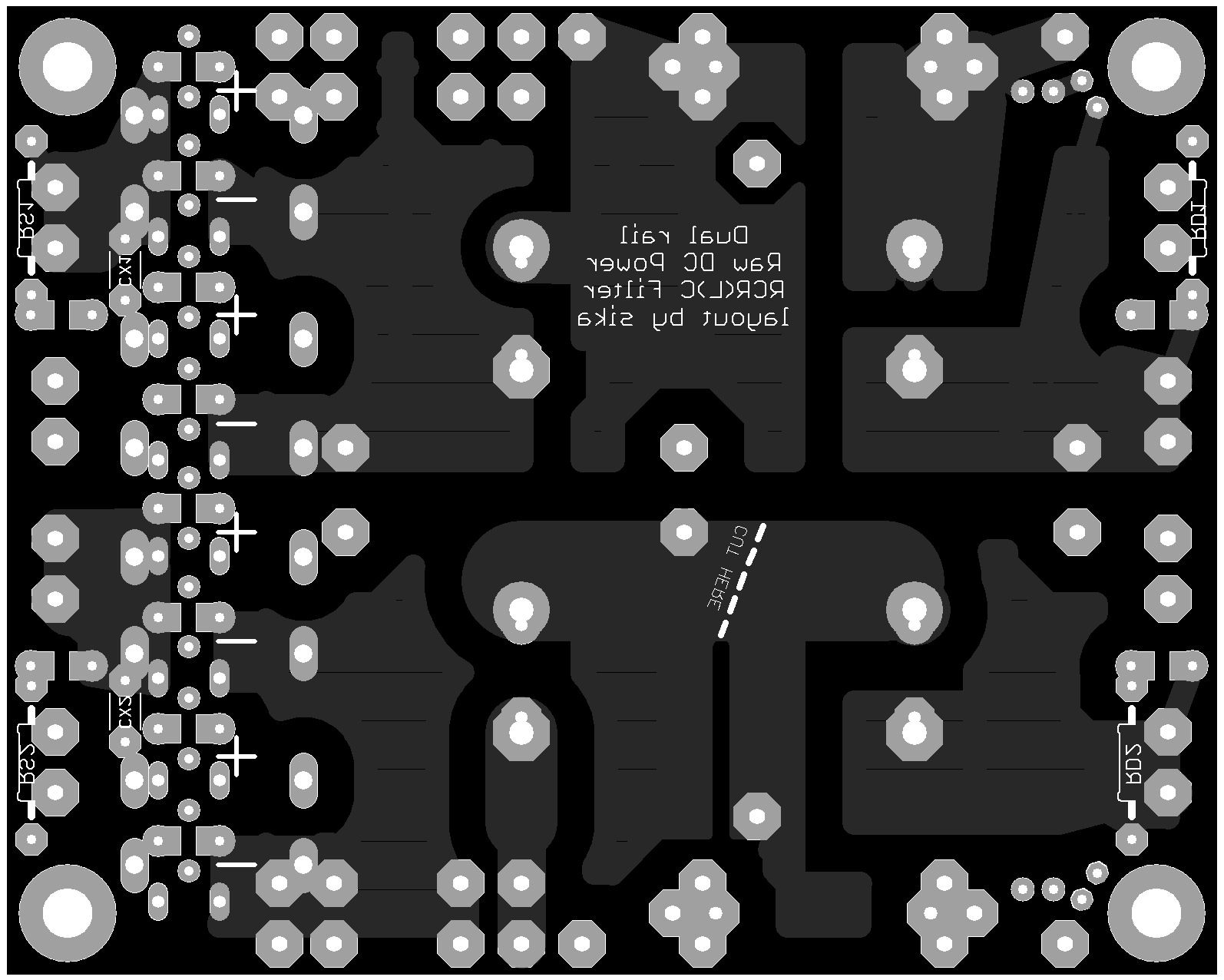

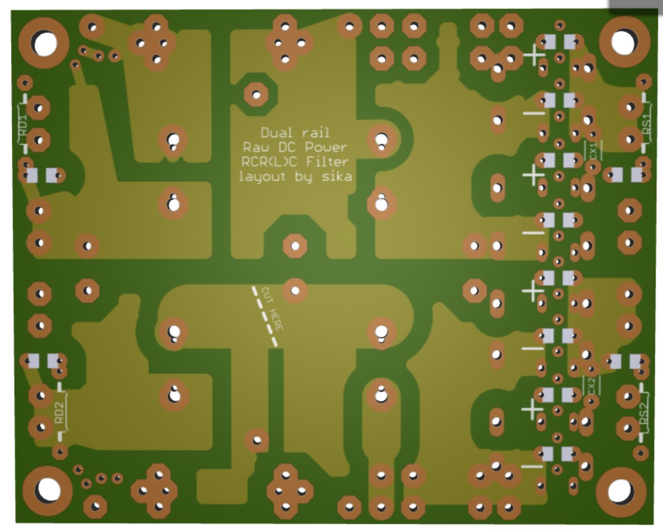

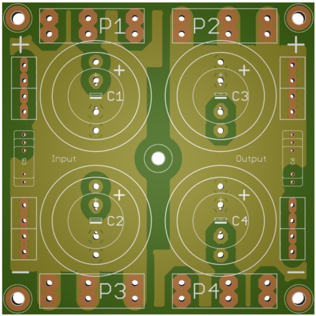

A little teaser for you guys, 10x10 power supply for power amps - one rail - with CR(LC) filter, symmetric resistors on +&- side, without rectifiers, plan is to use high power bridge or special rectifier board. 🙂
This is kind of modular, you can use 2 or 3 per rail for real high power filtering & optionally connect R or L between boards (jump filter connections on boards).

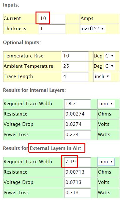

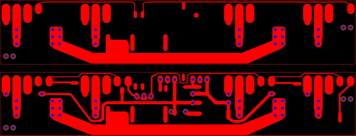

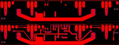

Question is how much current is possible through PCB traces (1 oz PCB thickness)?
That 7.19mm shared between top and bottom (external) layers of 0.142 wide traces for 10A continuous gives a 10C deltaT and 71.3mV drop along the trace.
You could check this with a DMM while the amp is delivering maximum power.
BTW,
I have laid out a 2pair output stage for a 100W into 8ohms amplifier using a 160thou trace top & bottom and it too is just under 4" long.The PCB is ~149.7mm long
