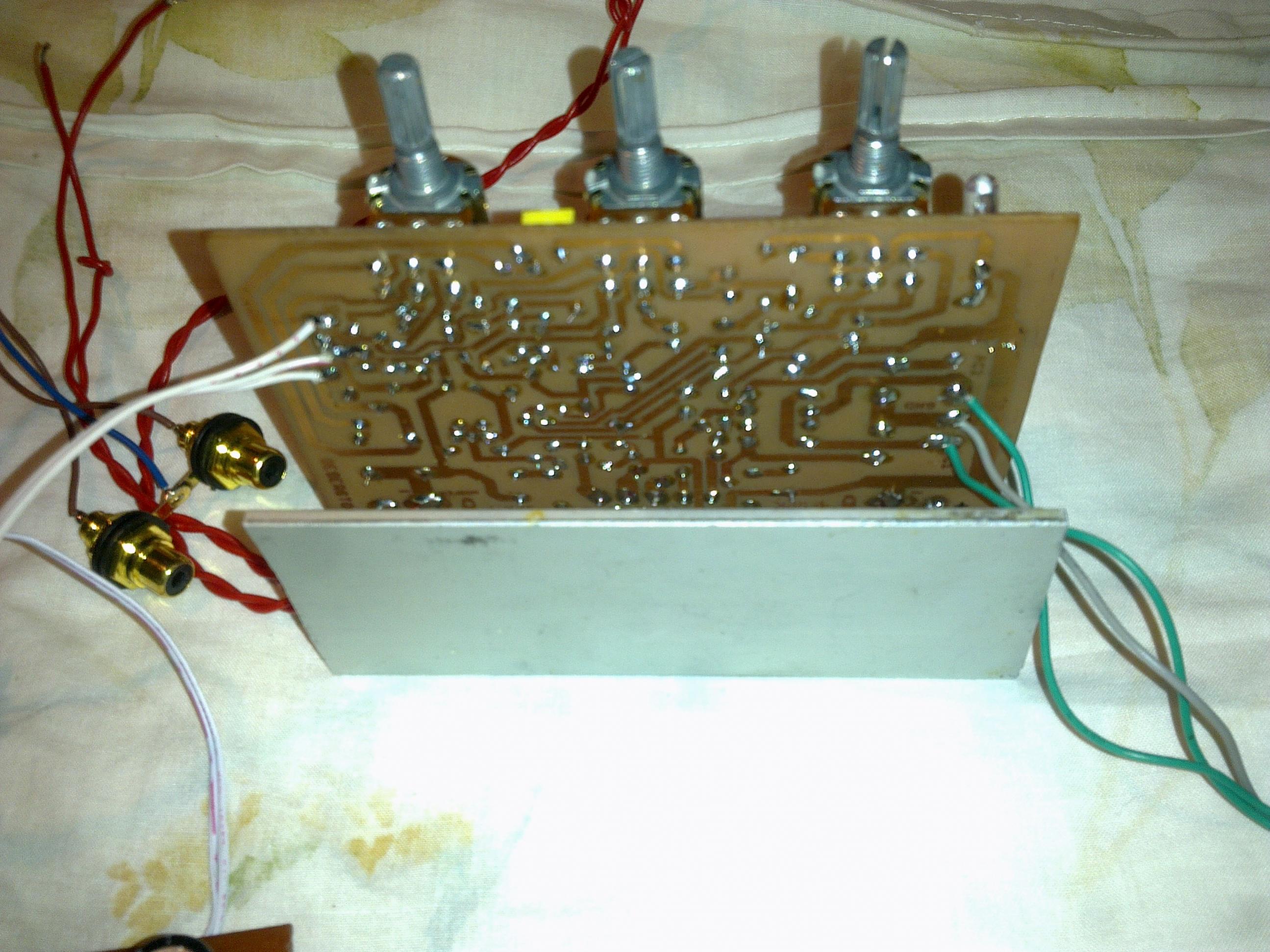

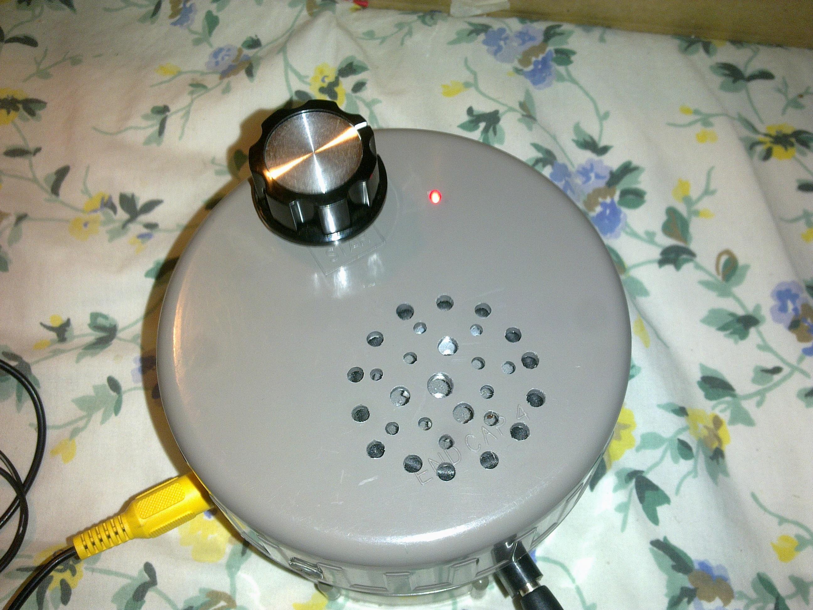

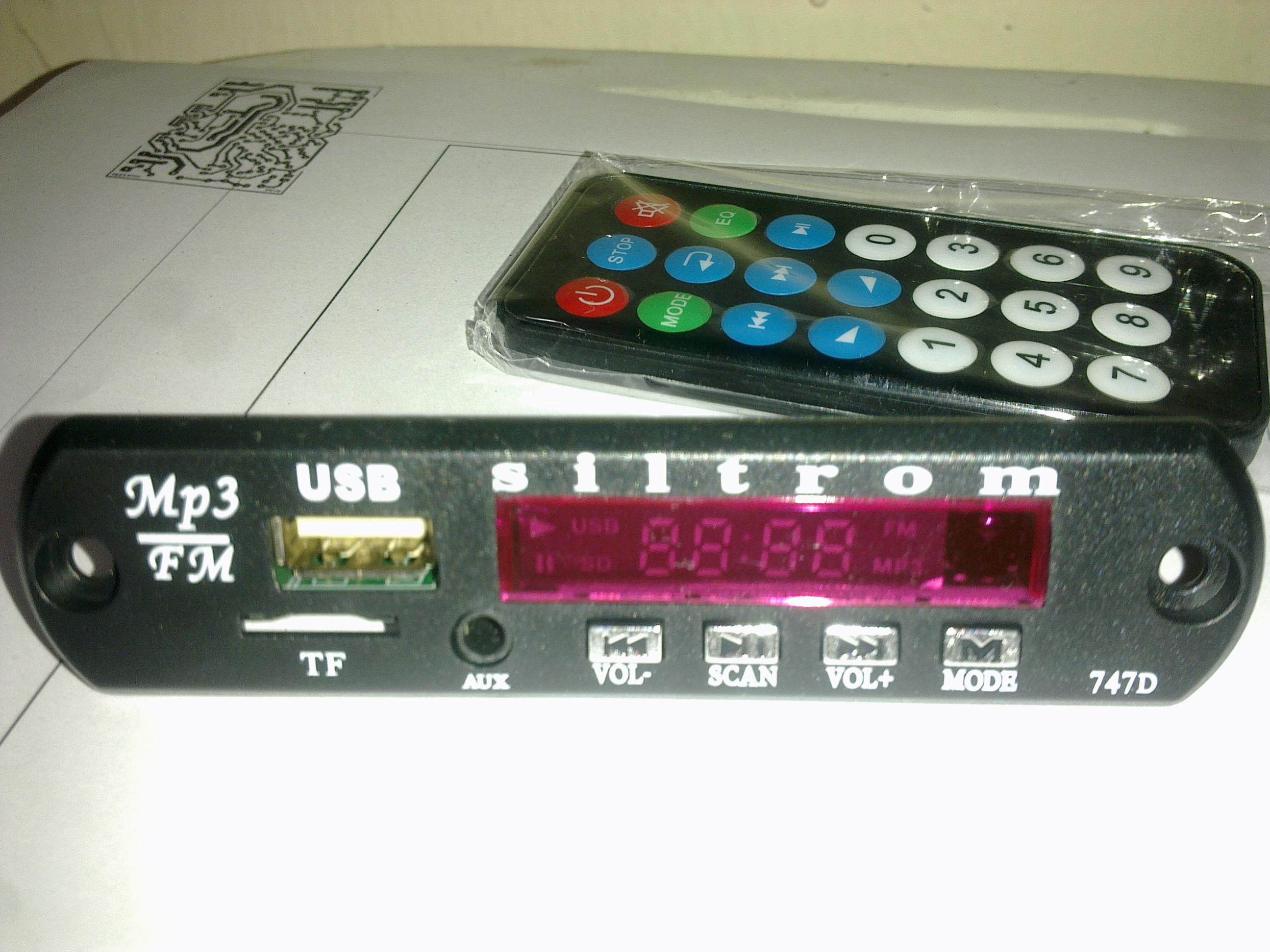

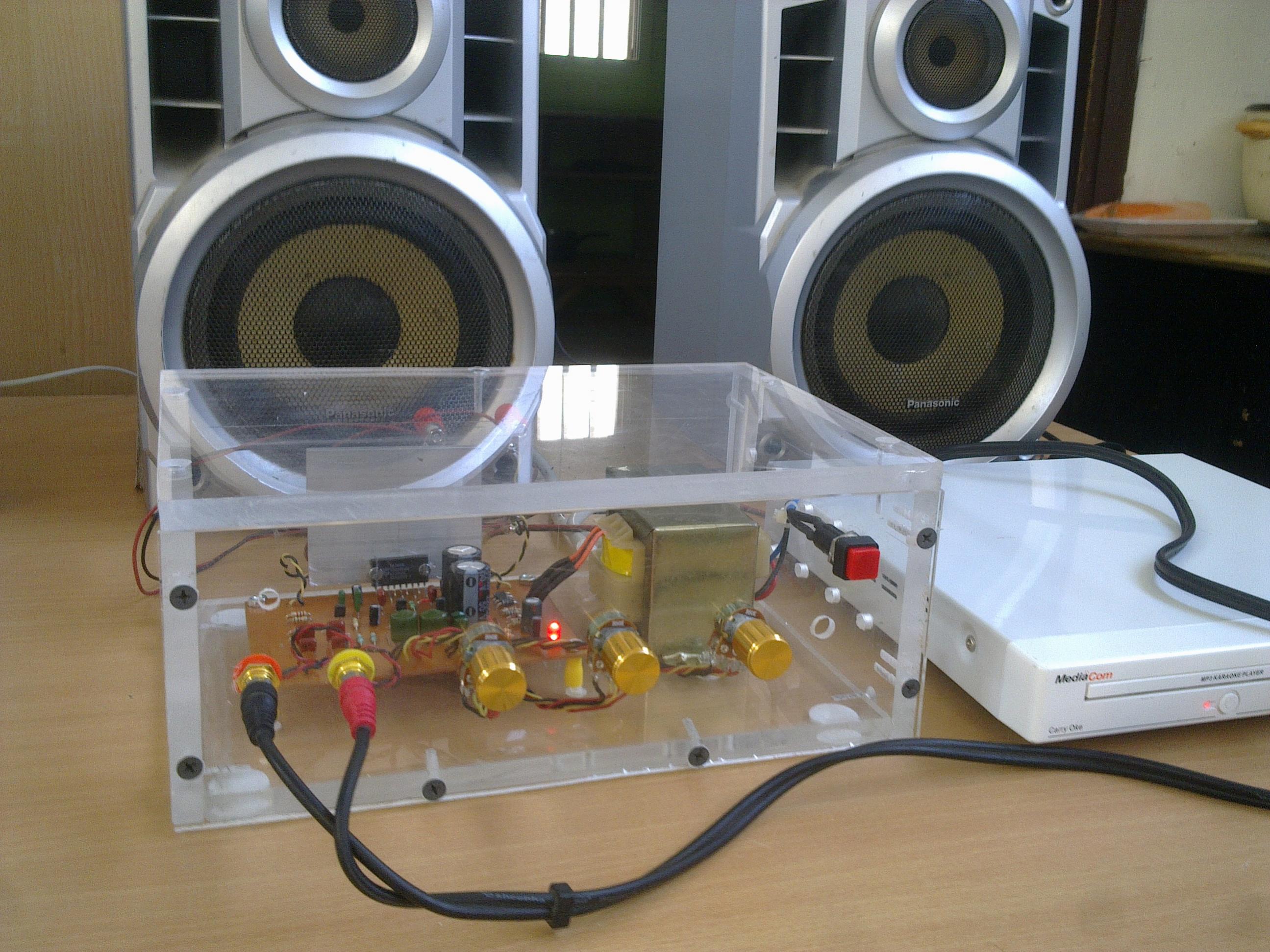

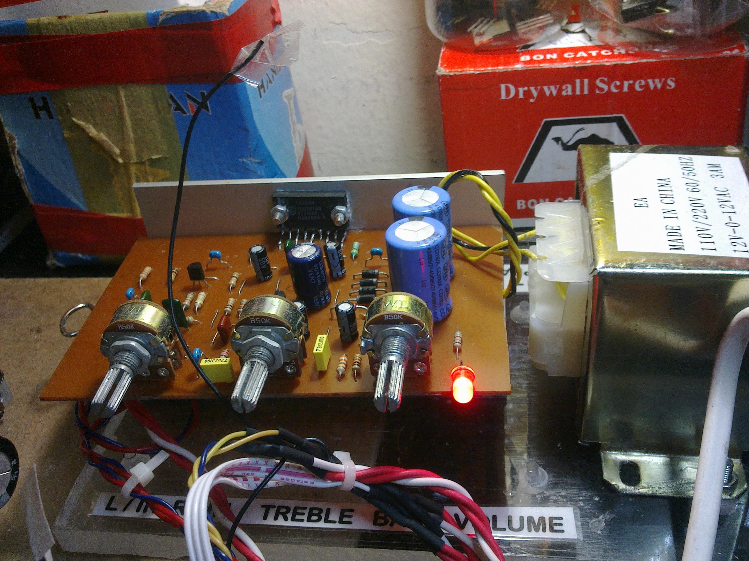

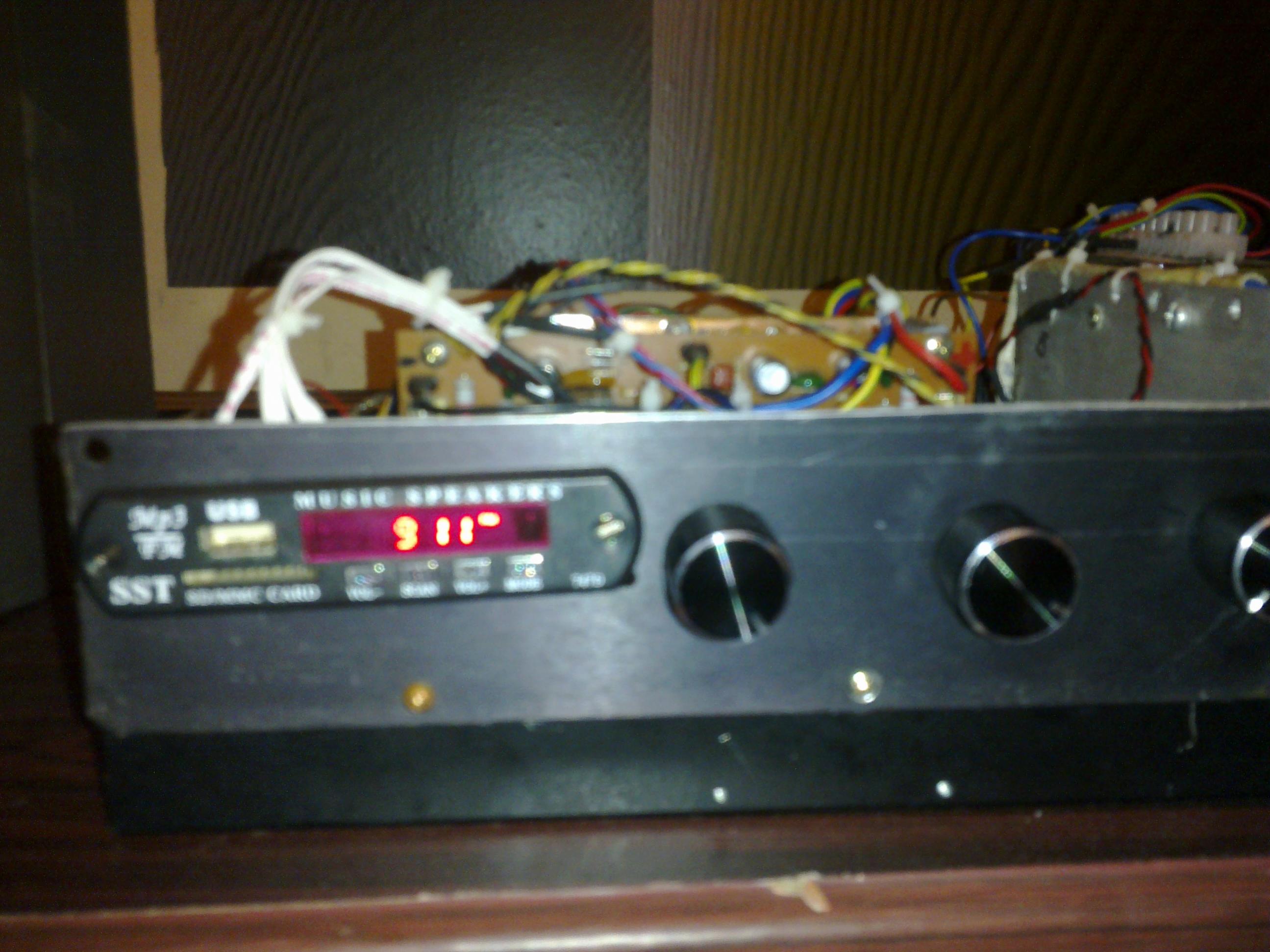

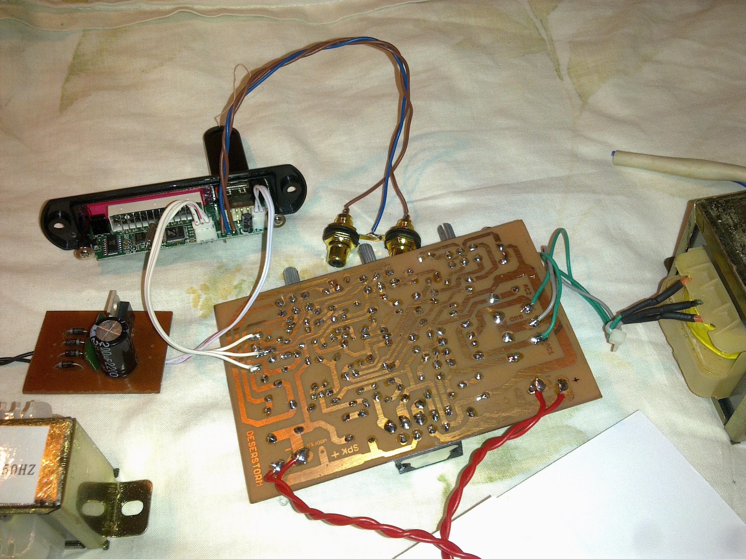

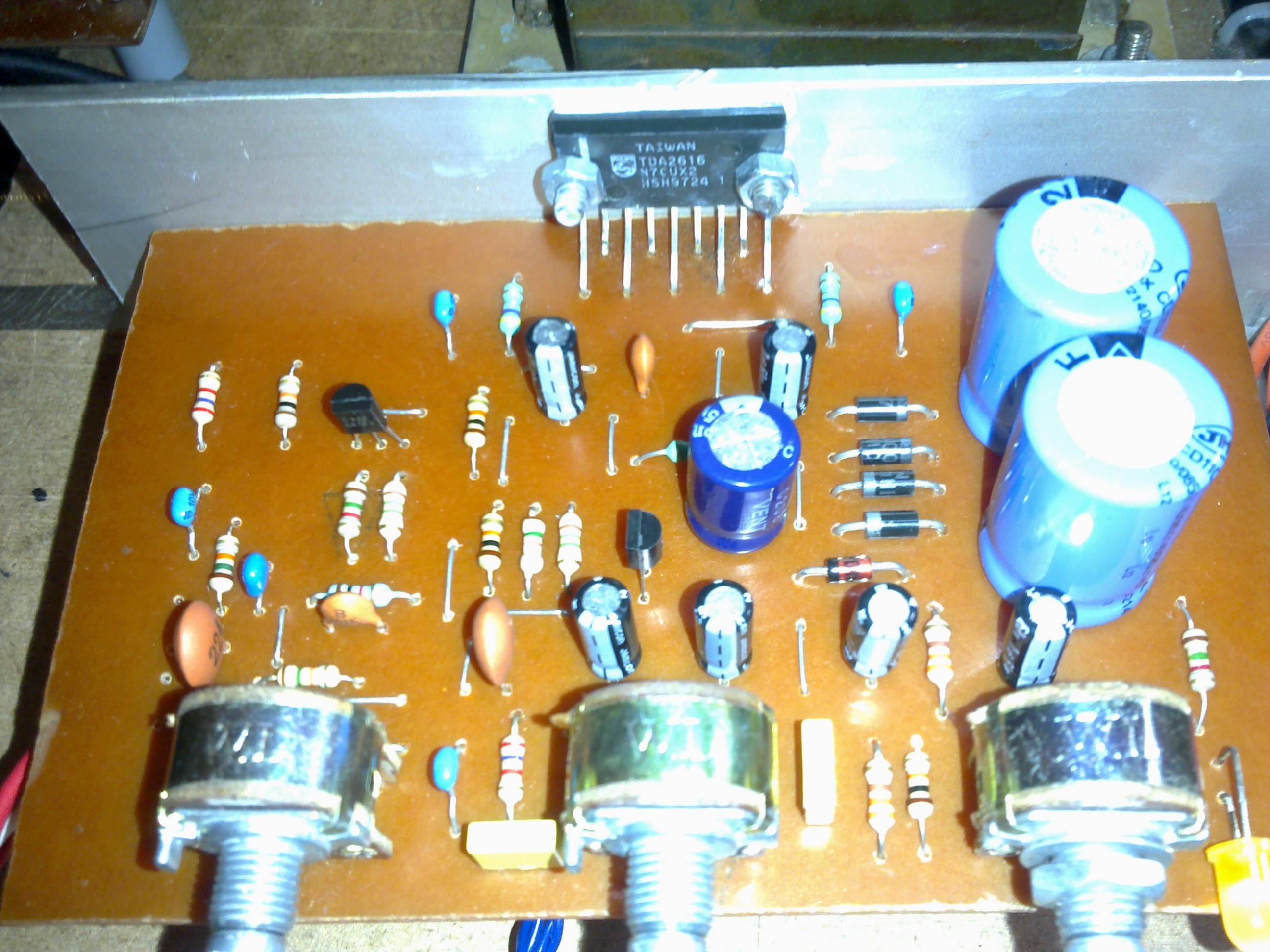

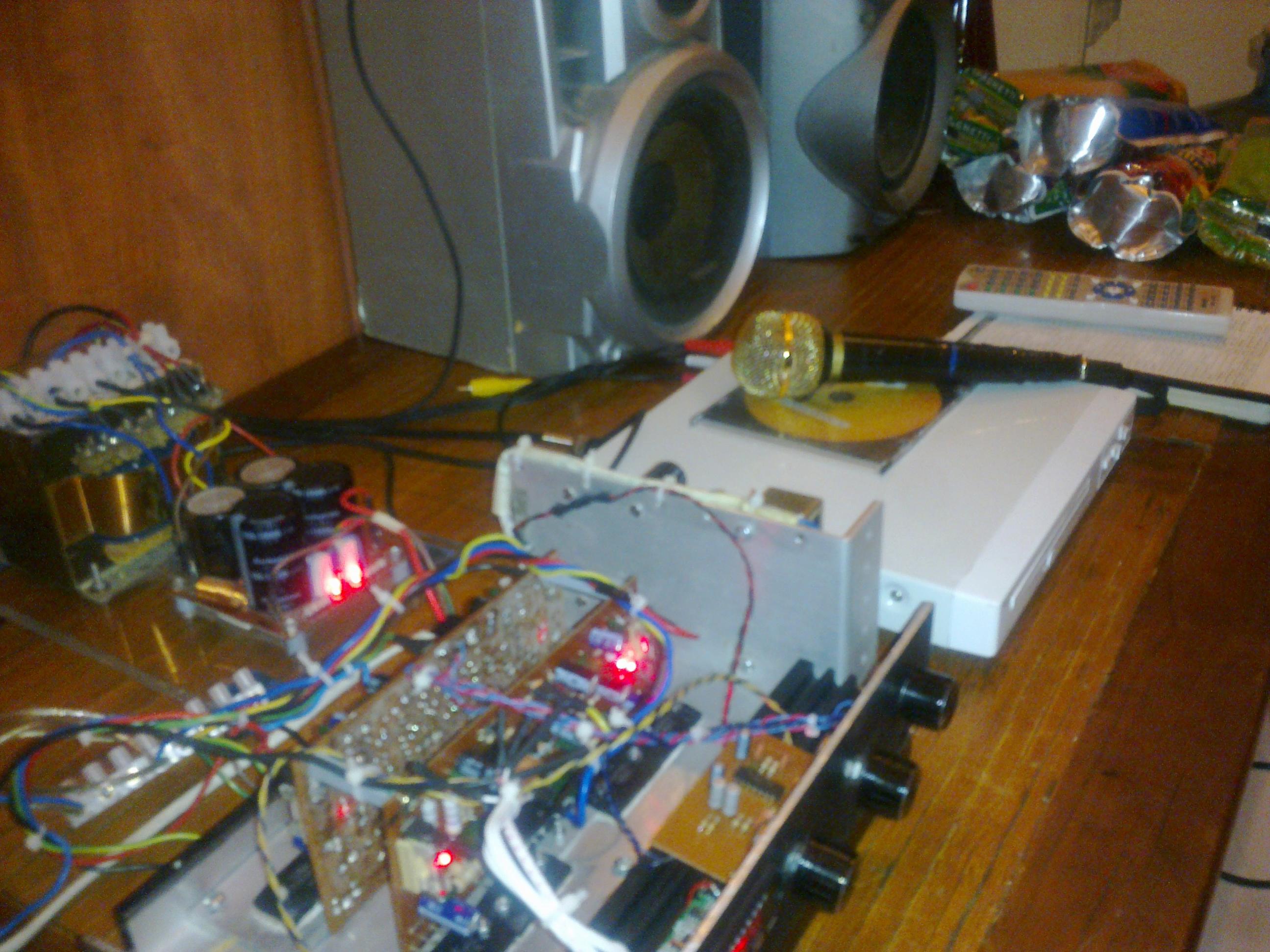

10watts power amp.
MY NEW TOY 10WATTS X 2 AMP. WITH MP3 PLAYER AND FM RADIO.

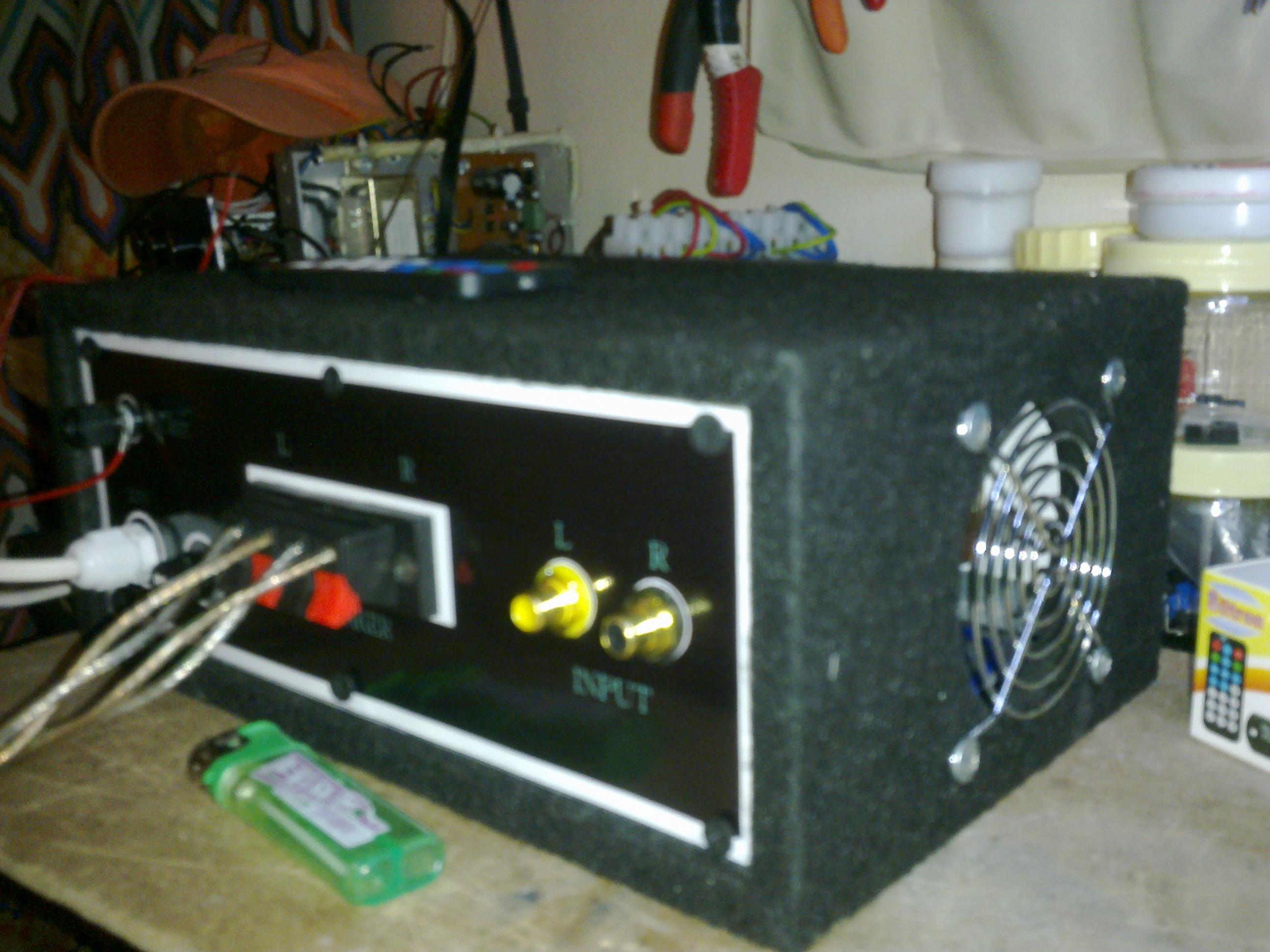

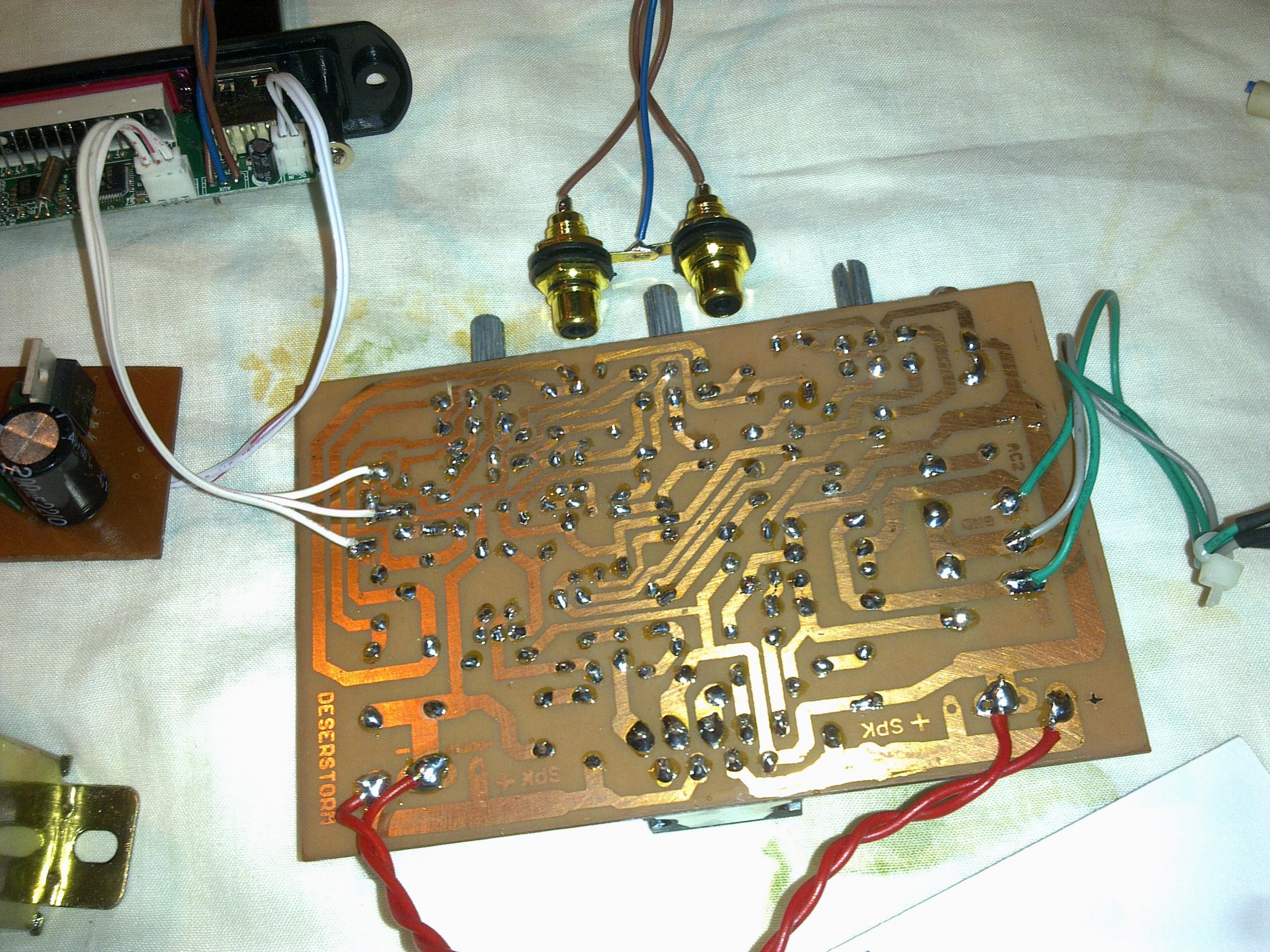

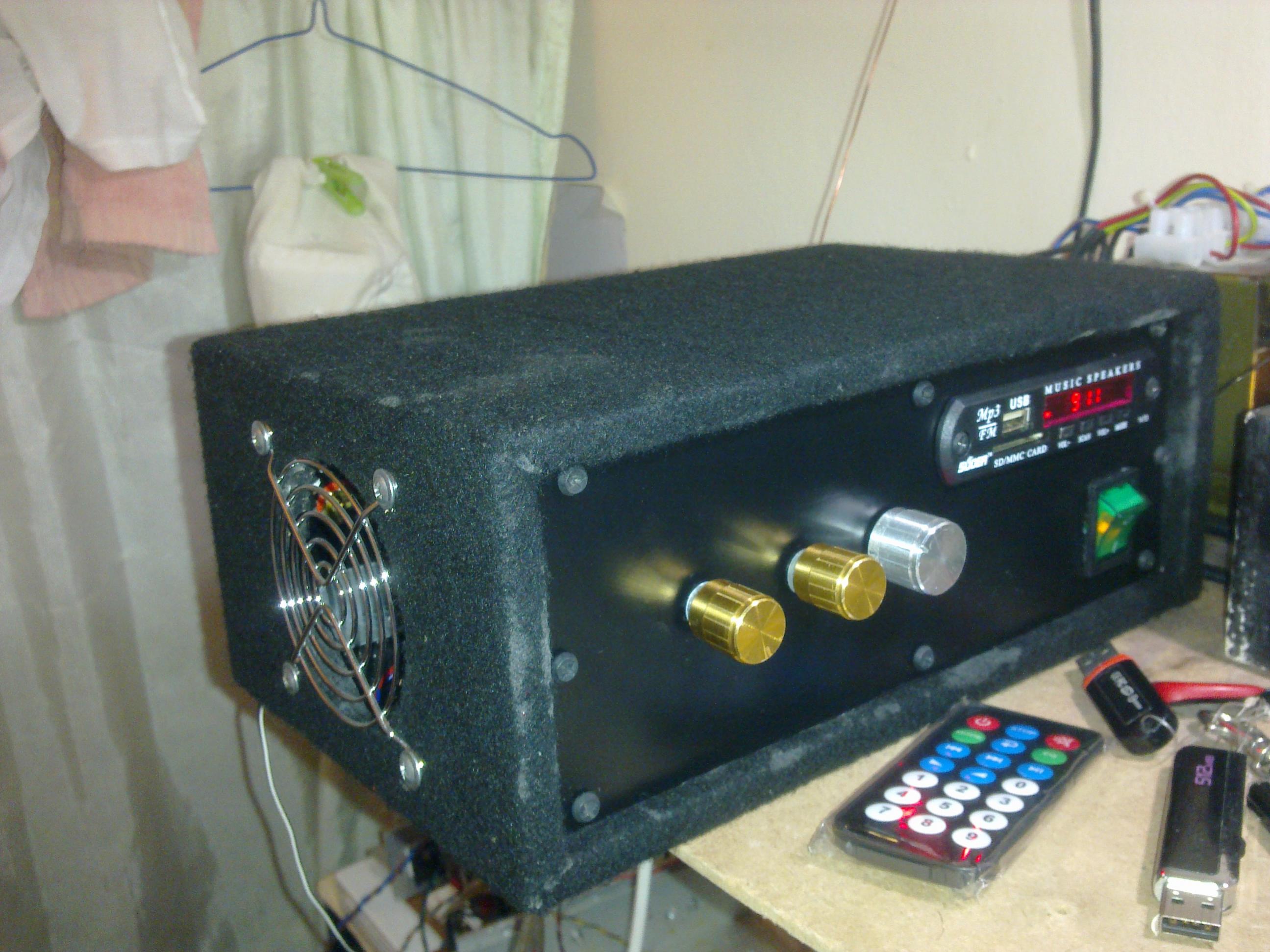

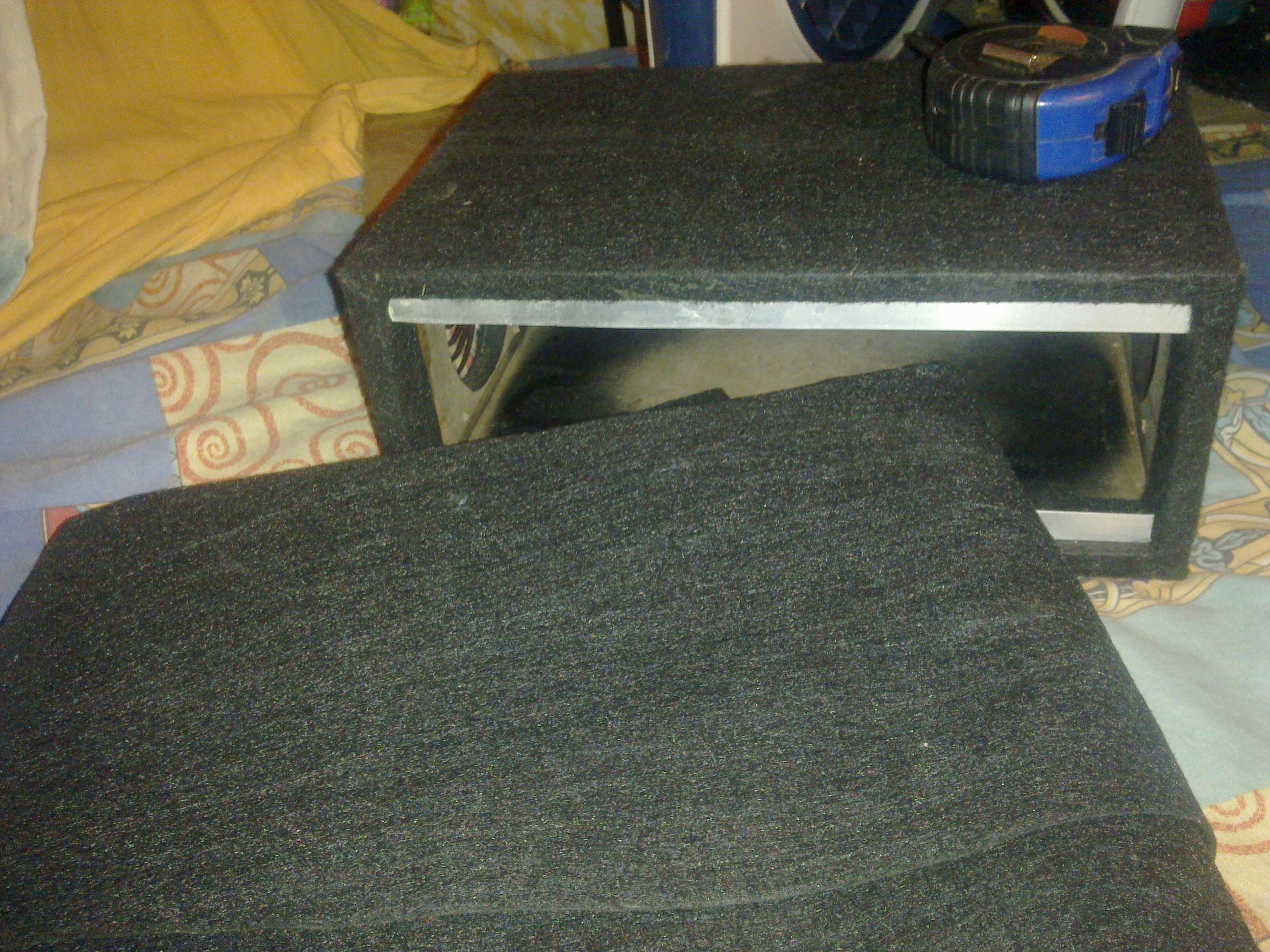

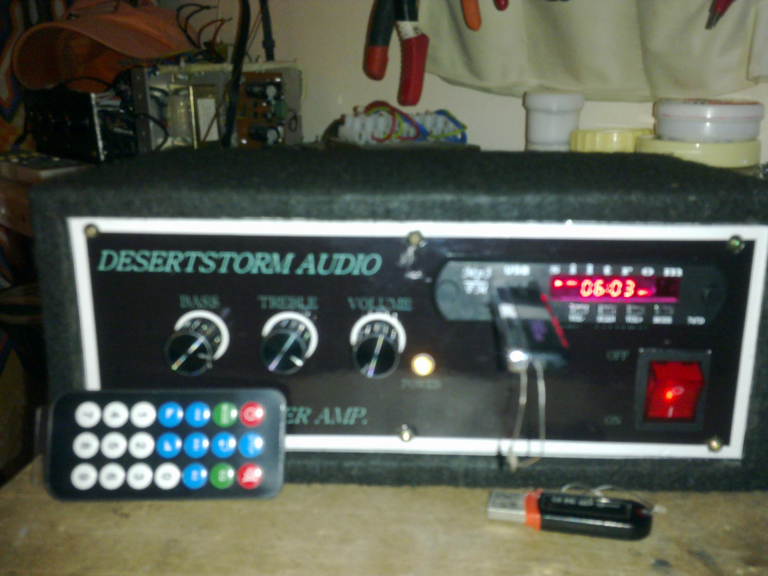

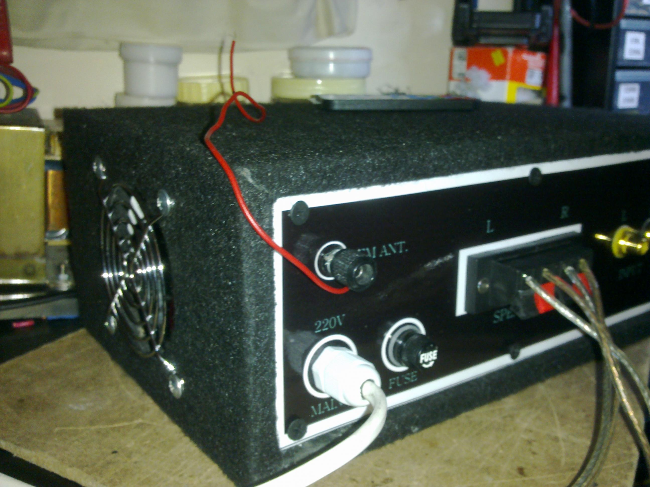

Can you give us more detalis about building amplifier case(first post, with mp3 player module)?
yes of course..why not..here it is...

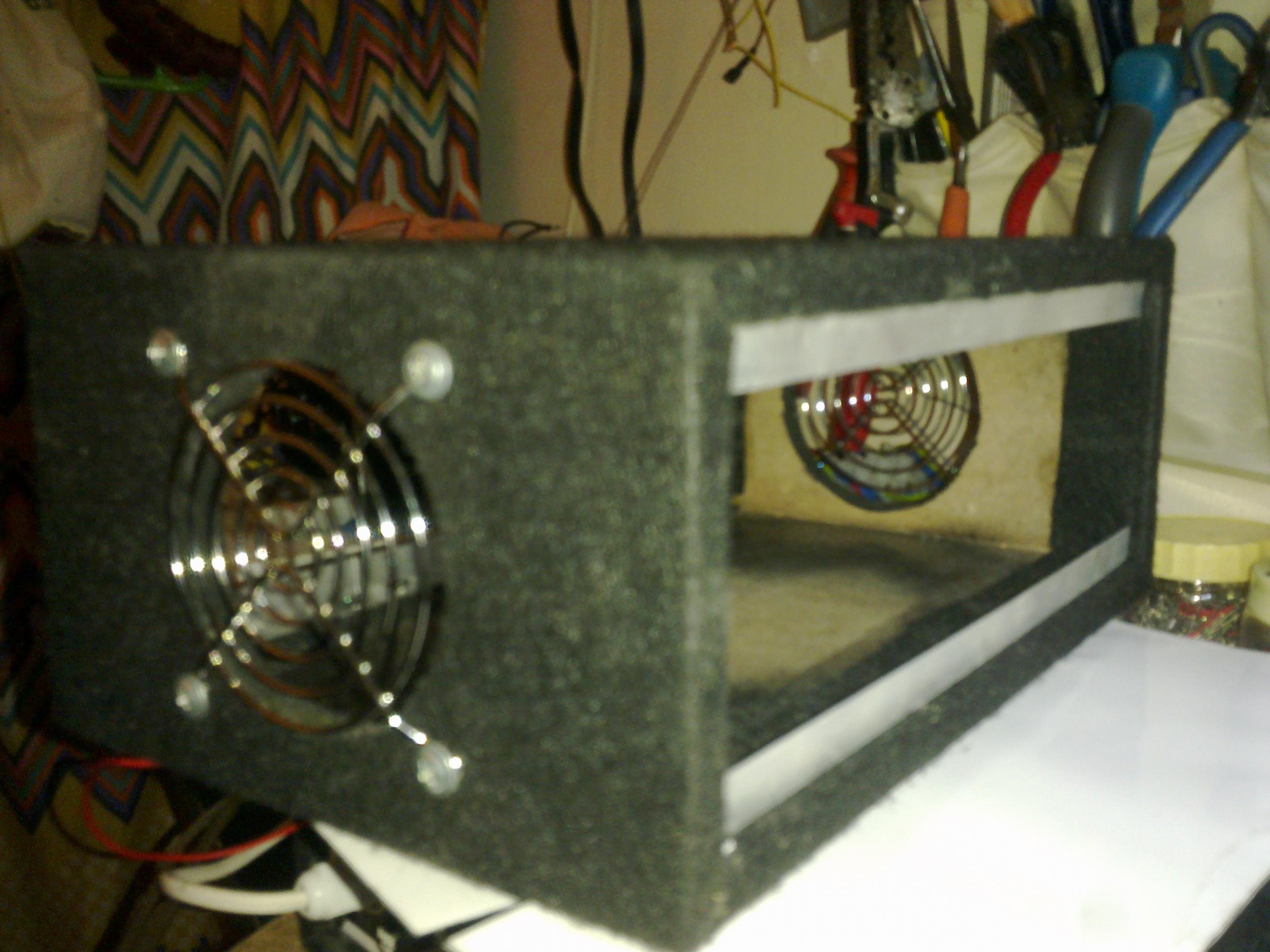

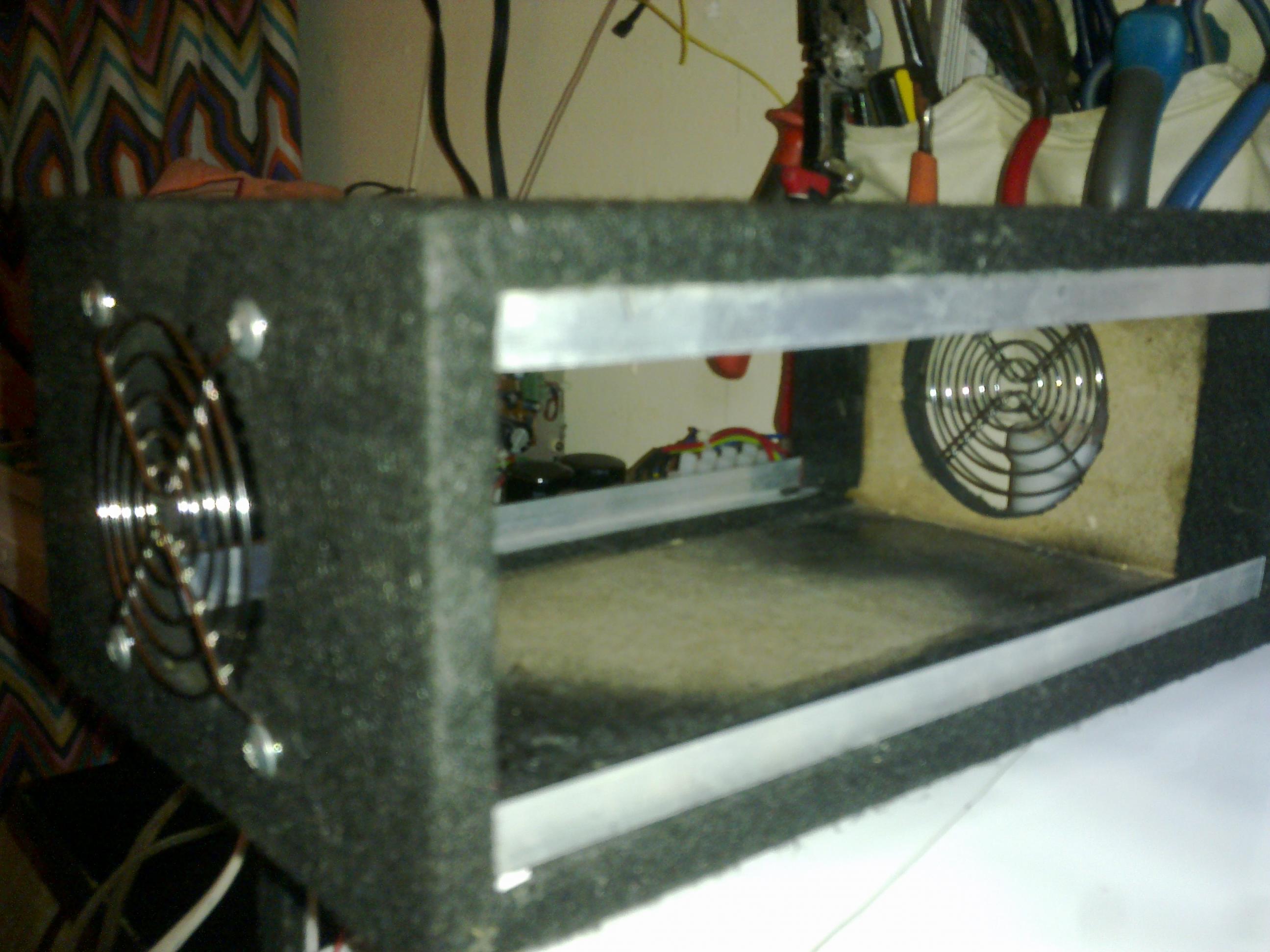

i use 8mm mdf fly wood for casing..size is L-27.5 cm , W-18cm and H-11cm and i cover it with black cloth.. i use autocad for making front and rear panel shown in the picture..and by tomorrow i give the details on how to hook up the digital mp3 player /fm radio to my main amp. just for fun but very good sounding and also powerful amp.

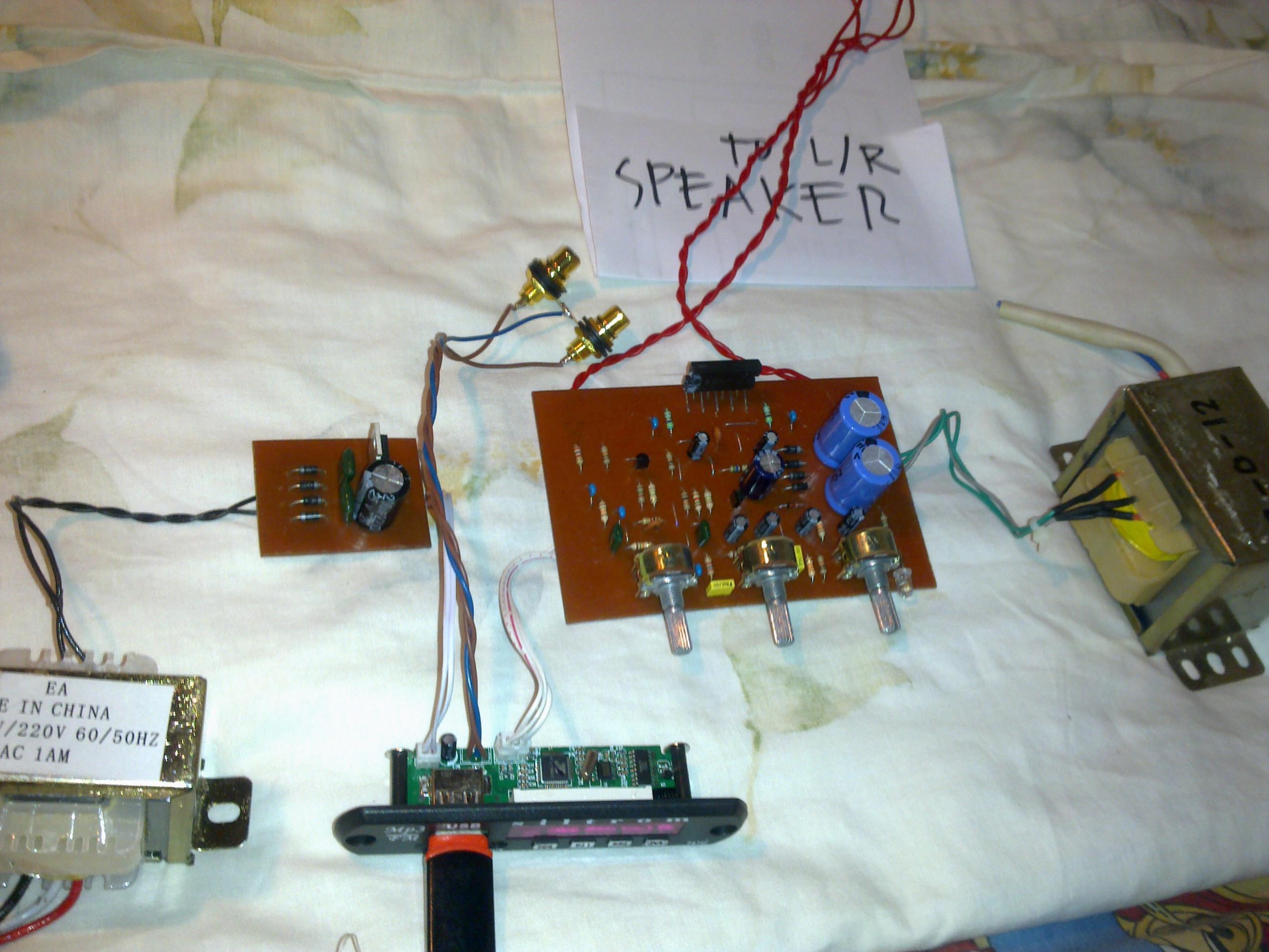

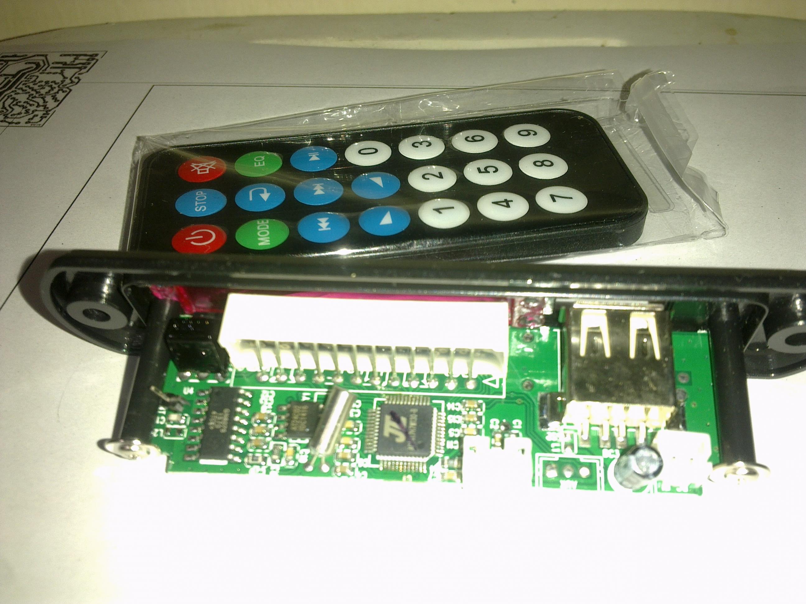

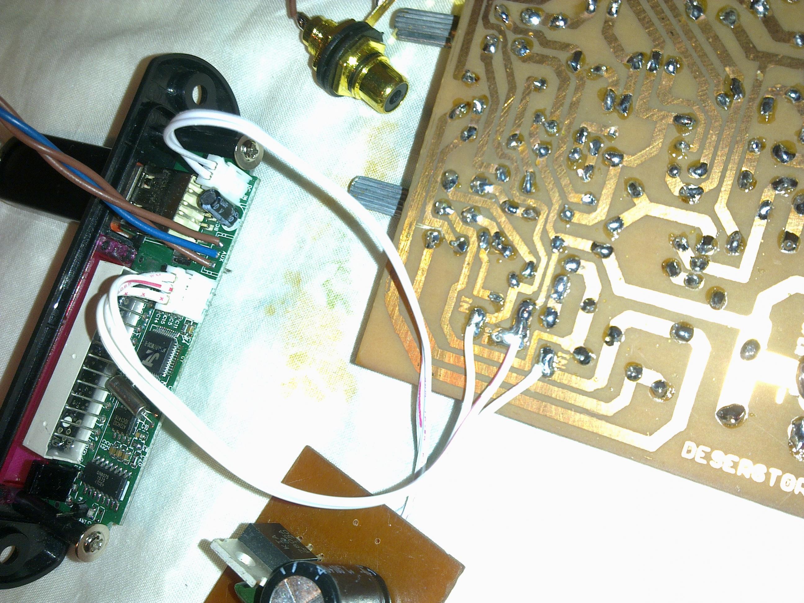

connections..

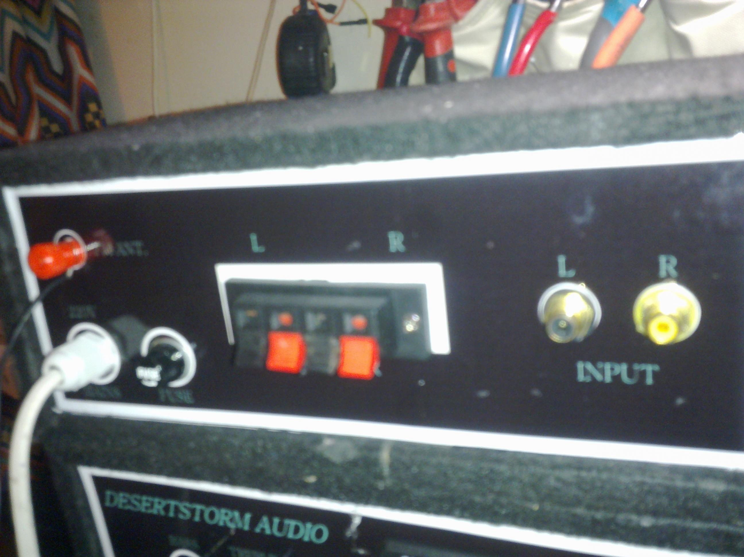

I have that same module connected to TPA3116 amplifier, now I am looking for case for both amplifier, mp3 player and power supply. What kind of cloth is it, some kind of carpet? Are front panels made from aluminium or?
i use ordinary GI SHEET Gouge 20 and then i make a front and rear panel design from autocad i send it to calligraphy shop to print in to glossy sticker with laminated clear plastic on it..
the cover is similar like a carpet i found it at the textile shop , hopefully there is also in your place the thickness of the cloth is 3mm.

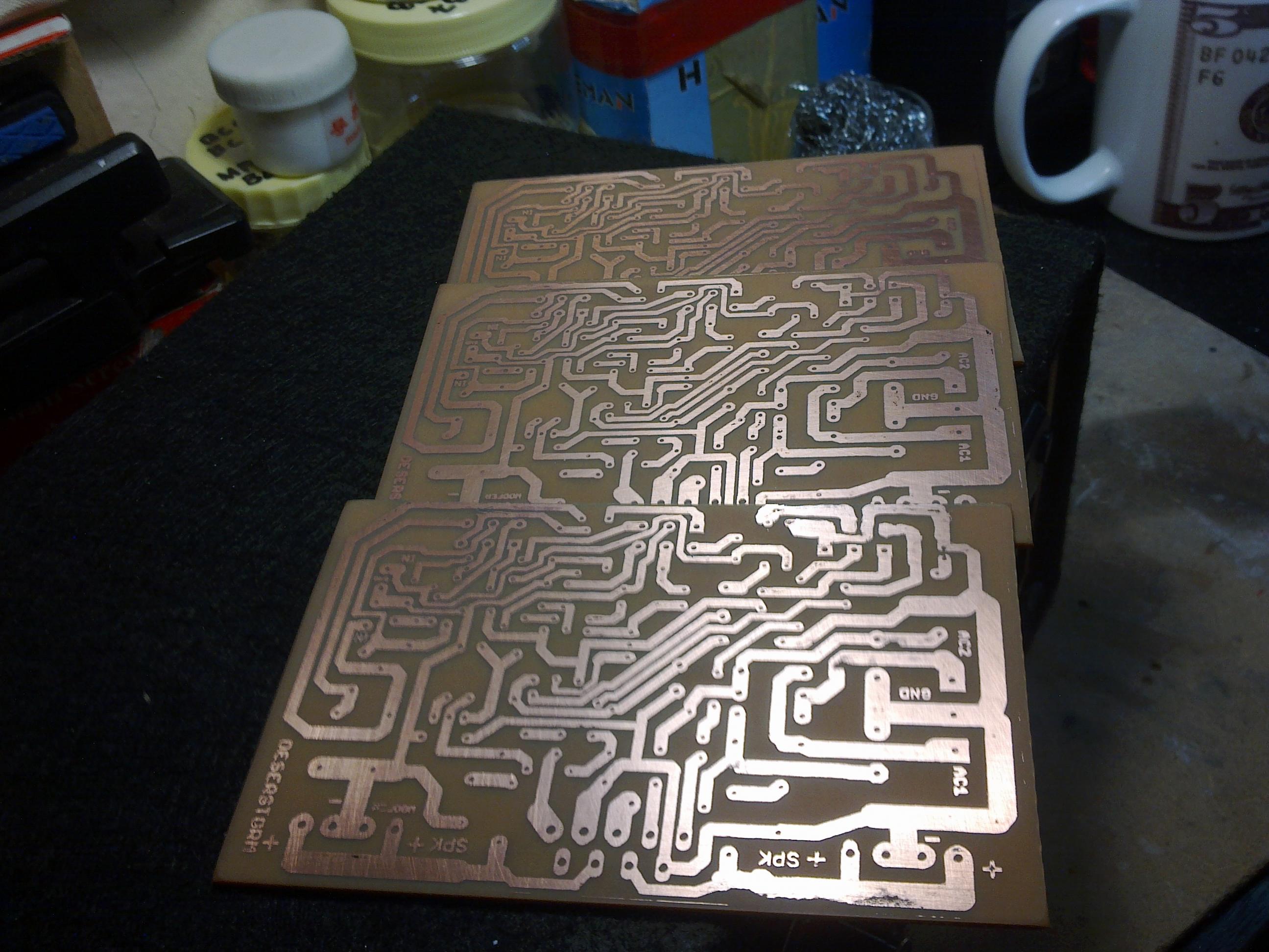

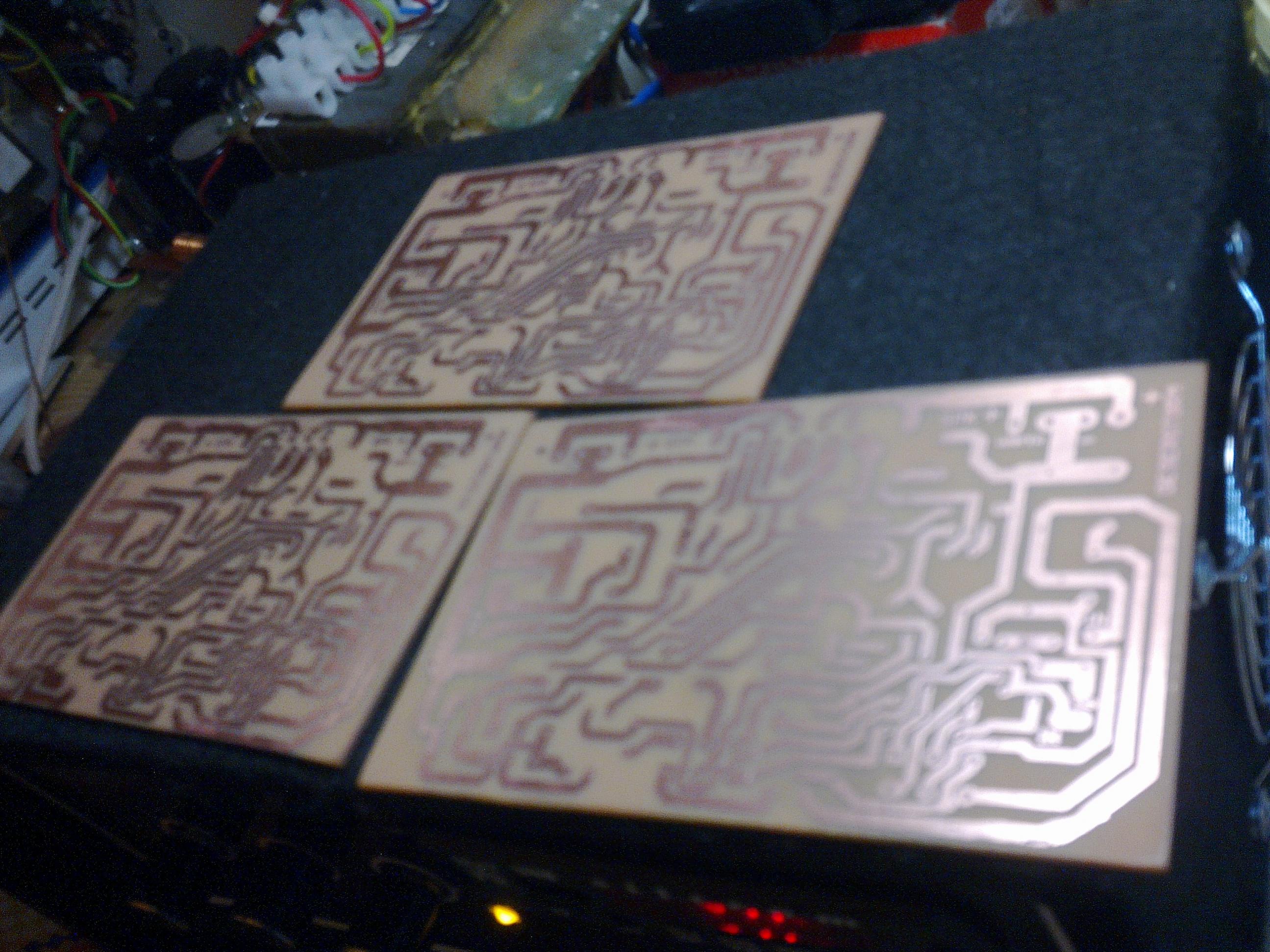

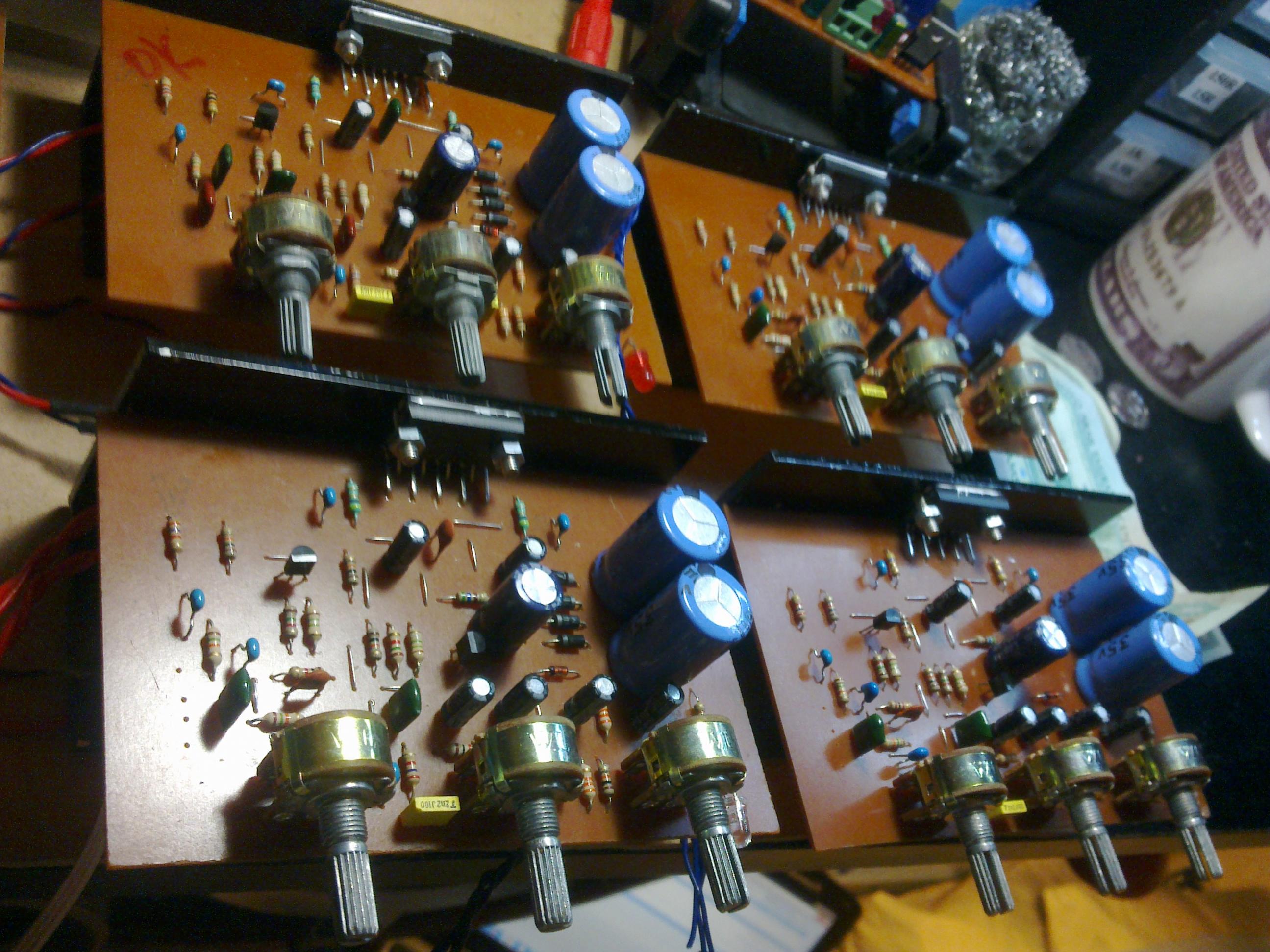

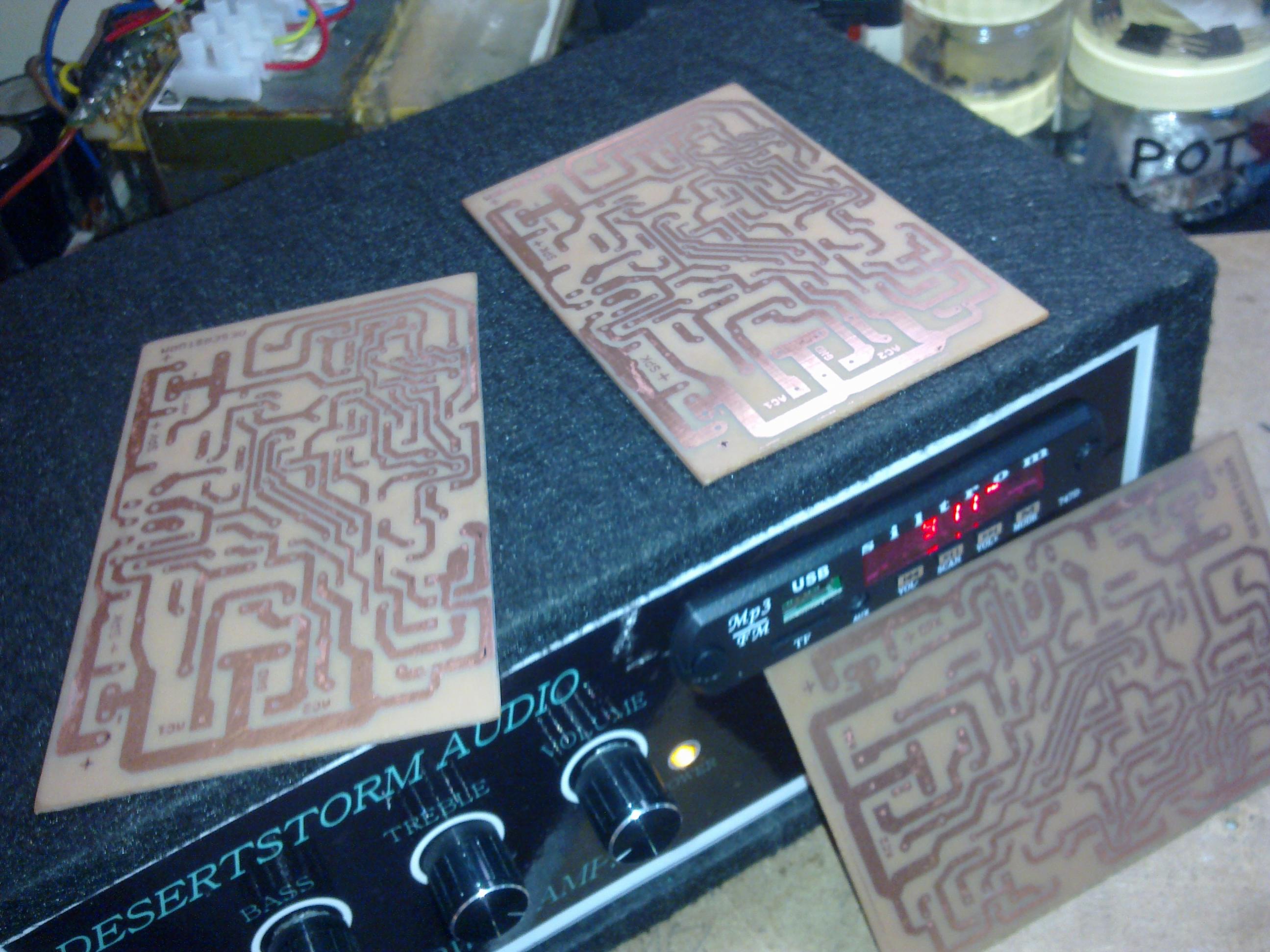

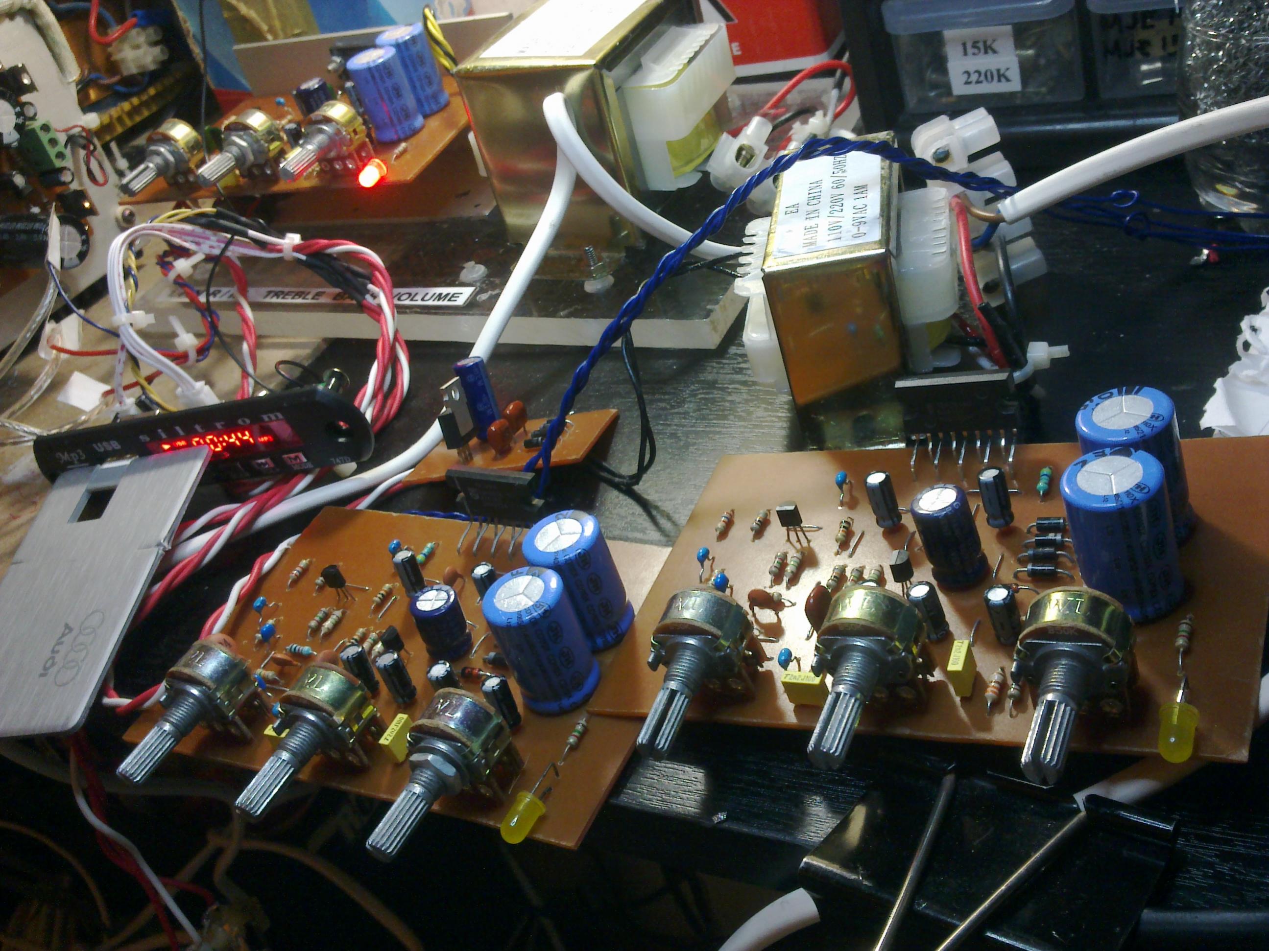

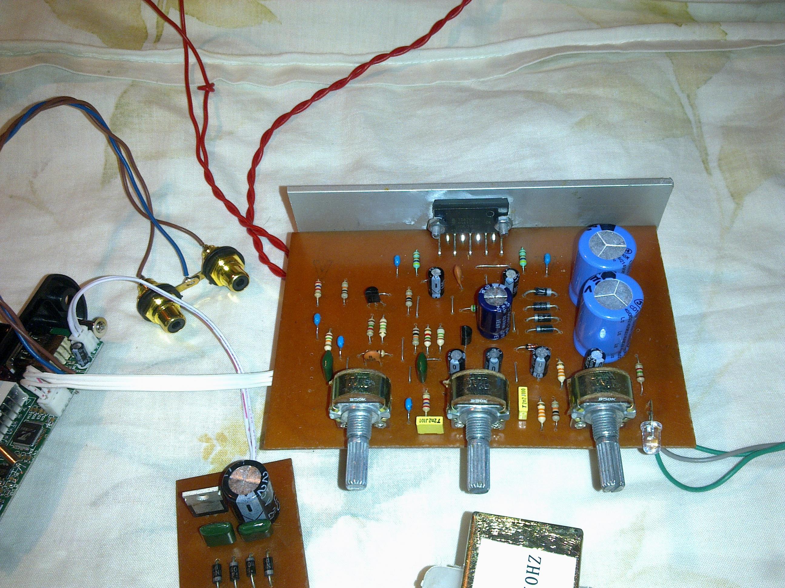

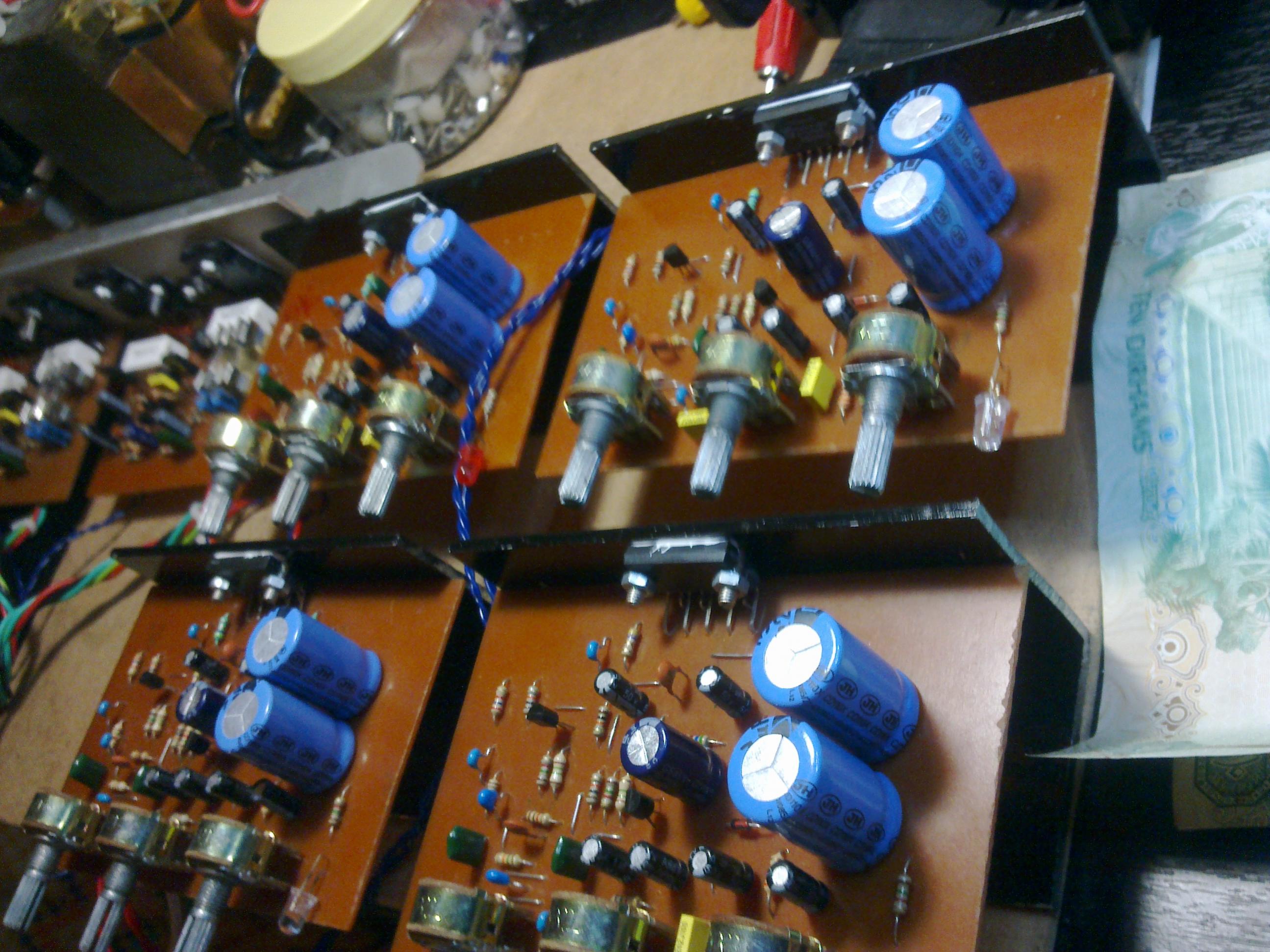

More 10wX 10w power amp..
