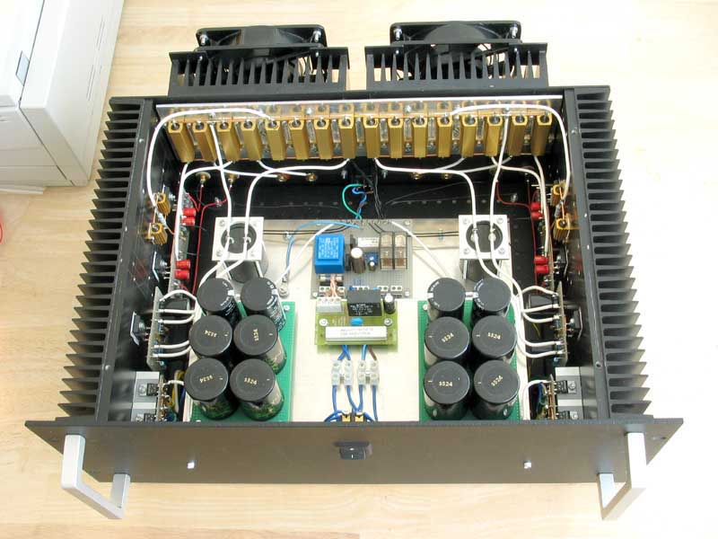

While we are on the subject (inductive resistors):
The power resistors I use in this SOZ are inductive. I have buildt several 8W SOZ versions in the past, all with different parts selctions etc. What I learned is that every little thing you put into this amp makes a audible difference in the final sound of the amp.
For instance, if you use non-inductive power resistors (in my amp: Caddock MP930 4+4 ohm) the amp is more analytical, while if you use inductive resistors (like this one Arcol HS50) it becomes more romantic. This is all a matter of taste. The only problem is that it can be quite difficult/expensive to to these kinds of experiments.
In this XSOZ version I have made my choice of components based on earlier experiences, except for the MOSFETs (I can also imagine some cap changes) which I will be trying different ones for obvious reasons.

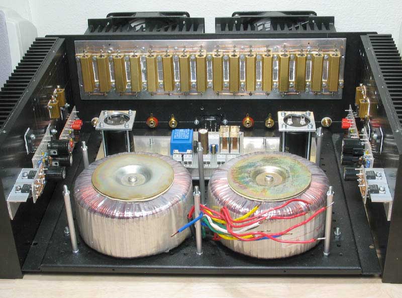

Very cute amp. Nice layout. Yup, this is a great sounding amp. You hear everything. It's only as good as your source. Quality LP's sound awesome. I have a little over ten watt mono blocks. It runs hot and I have at least twice the heat sinking. I do not know how your cute amp simply does not melt down into a pool of molten metal.
Also if one of those resistors goes it makes a huge mess. You hear a large pop. The ends fly off. A coil of charred wire pops out. And black soot floats about the room landing like black snow everywhere( if the top cover is off).
Thanks gnoumus..
Aluminium can take about 1000'C before meltdown 😀
I don't think 60-70'C chassis temp is something to get overly excited about, it just isn't pleasant to touch it. The resistors blowing is among the least of my worries, in fact I'm not worried at all 😉
-Sounds like you have experienced som resitor blowing? -Care to tell the whole story?
I was testing mosfets for SOZ in a real amp like test rig. Used too small a wire wound resistor without heat sink. Ignored the little bit of smoke from the resistor. Soon after boom. Big mess. Now if I smell or see the slightest amount of smoke in a project I am building I dive for the off switch.

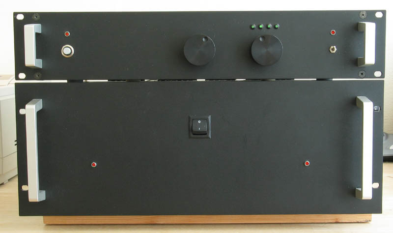

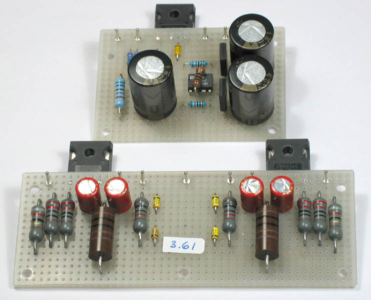

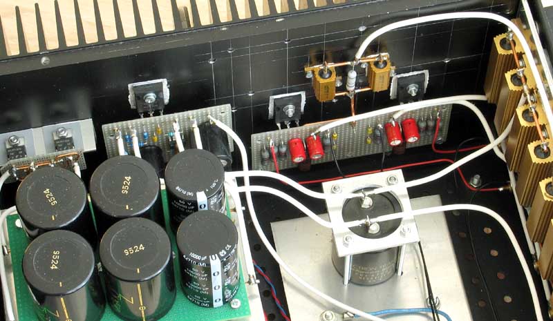

I have just finished my new 10W XSOZ, so it shoud fit in here.
Unfortunately I can't hear it, my midrange drivers is beeing reconed, I will get them sometimes next week:bawling:
May be I will go without fans at side of the amp, those heatsinks is just 32'C above room temp. When I think of Mad_K's I feel safe.
It also makes it easier to get the amp in and out the rack without a screwdriver.

Gnomus
Thanks for the kind words.
Yes, I am verry happy for those fans for the resistors, and I hope you are right abut the heatsinks for my fets.
Actually I have seen the resistors cooking, and the box, the heatsinks and the powerresistors are there from my earlier testversion of this X-SOZ.
