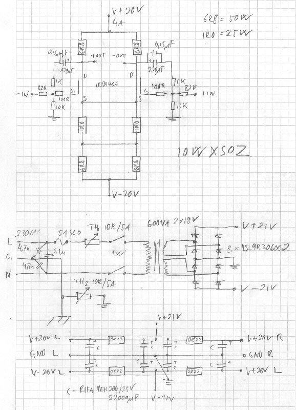

Some technical info:
-The circuit used is Henrik's XSOZ circuit, with 6,8R power resistor (Arcol HS50) instead of the 7,5ohm.
-Rails are at +/- 20VDC
-Bias is slightly greater than 4A per channel.
-MOSFETs are IRFP140A from Fairchild
-Dual discrete bridges made of 8 ISL9R3060G2 (30A, 600V Stealth Diode to247, Fairchild)
-Psu caps are Evox Rifa PEH200 22000uF/25V.
-220uF caps are Elna RJH bypassed with 0,15uF Evox Rifa PHE426.
-Light AC filtering with Evox Rifa PZB 300 in delta-arrangement.
-Circuit ground is connected to the chassis/AC GND via a ntc thermistor. I have also used a ntc to supress the turn on surge.
-Chassis temp is about 70'C. The heatsink carrying the MOSFETs is 77'C. The one carrying the power resistors is 112'C.

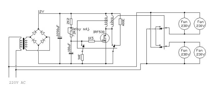

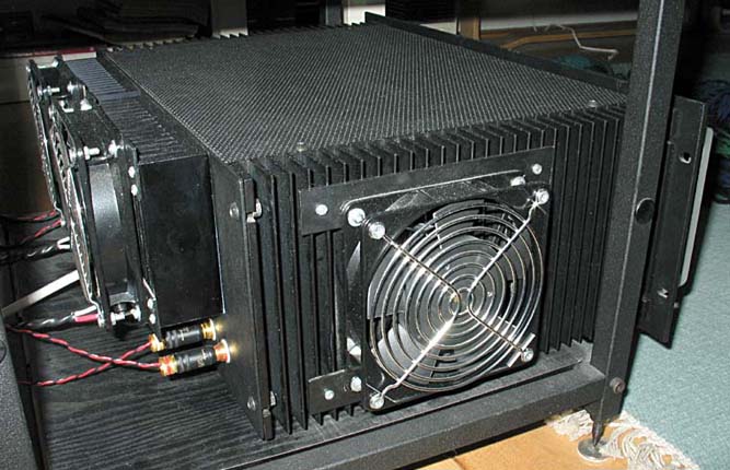

Yes I know some people don´t like to use fans, but in my oppinion it is not a big deal, I have had an SOZ and XSOZ running with fans for more tan 3 years now, it dosen´t bother me at all. But you need to use some silent fans. I ended up with 4 x 220V slimline sleevebearing fans, 2 X 2 in parallel to reduce the airflow and the noice, and this is verry effectieve. You have to start the fans non paralleled in order to start the up, and then couple them in paralleled mode.
I can touch my heatsinks, i guess they are 50*C for the mosfetsinks and 60*C for the resistorsinks.
My fans measures 120 x 120 x 25 mm.

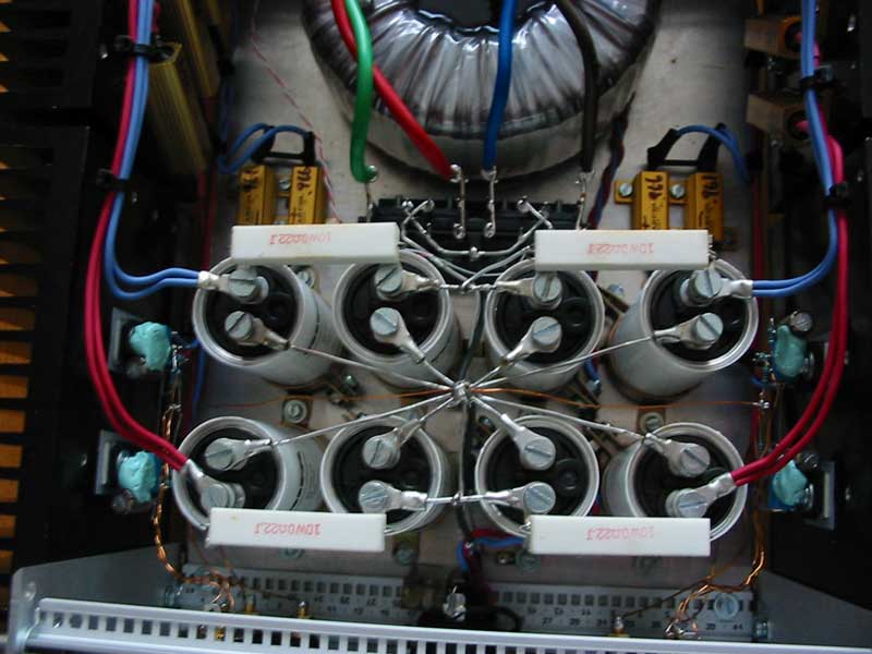

I also build my first XSOZ with the rectifires mounted at the same plate as the PSU-caps, but now i have mounted them at the mosfetsinks.

I have attached a pic of my fans.

Hi again.
My fans are running at 220V AC.
Once I tried 12VDC ballbearing fans, but they made too much nocie, and i ran the from a separate supply. Sleevebearing seems to make less nocie than ballbearing.
And don´t use fans at 120 x 120 x 50mm if you can avoid that.
As I see your heatsinks, they have pretty deep fins, which makes them more effective than mine.

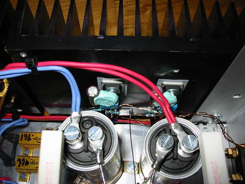

the bypass cap is a neat idea... hadn't thought of that.
thanks for posting the closeups of the FETS... i was really interested
to see if what i had done looked anything like what someone
who knows what they're doing did! 🙂
i take it the blue material is a dampening device? to keep the
capacitors from just hanging there? What is that stuff? I think i'd
like to try that on my amp.

In post #24 i wrote:
"I ended up with 4 x 220V slimline sleevebearing fans, 2 X 2 in parallel to reduce the airflow and the noice, and this is verry effectieve. You have to start the fans non paralleled in order to start the up, and then couple them in paralleled mode"
It shoud have ben:
I ended up with 4 x 220V slimline sleevebearing fans, 2 X 2 in series to reduce the airflow and the noice, and this is verry effectieve. You have to start all the fans in parallel in order to start them up, and then couple them in 2 x 2 serial mode.
Like in the scematic in post #27
Sorry for the confusion.

-You're welcome moe29!
The "blue stuff" is called Blue-Tac and is primarily used to damp vibrations, but it also helps in keeping them in place. It is made for hanging posters on walls, but also makes a very good dampening material.

First reason was that I had those 33V transformers without split secondaries on hand from an other project.
The regulated supply becomes more simpel, and it works pretty good.
The caps in the supply are working directly from + to -, where the the current draw is high. In split supplies the caps are pairs in series, which may or may not degrade the sound, but i believe that one single cap works better than two in series. Since the current flow through the ground is < 1 mA under normal conditions, it may be overkill to use those big caps to cover that little current, specially when the price paid is two in series instead of just one cap to take care of the high current draw from + to -.
I haven´t made any tests to compare those PSU´s side by side, so I don´t really know what sounds the best, so I am not an expert, i am a believer.
But I know that my XSOZ has a verry nice sound compared to others.

Here you go Magura!
The rest of the info you are asking are already in this thread..
No special hurdles in construction (Except a broken tap bit). The amp was made during a usual working week plus over the weekend. I had almost all of the parts in my junk-box already, so the amp was pretty much designed around that. I have no special tools. The only power tools I have is a Dremel and a power drill. Also I have no place to work on it so the living room/hallway was the constructionsite.
Heatsinks are Austerlitz KS160-100.
Please be advised that I do strongly recommend at least a 800VA trafo, and double the amount of heatsinking.
Please ask specific questions if you need/want more info 😉
