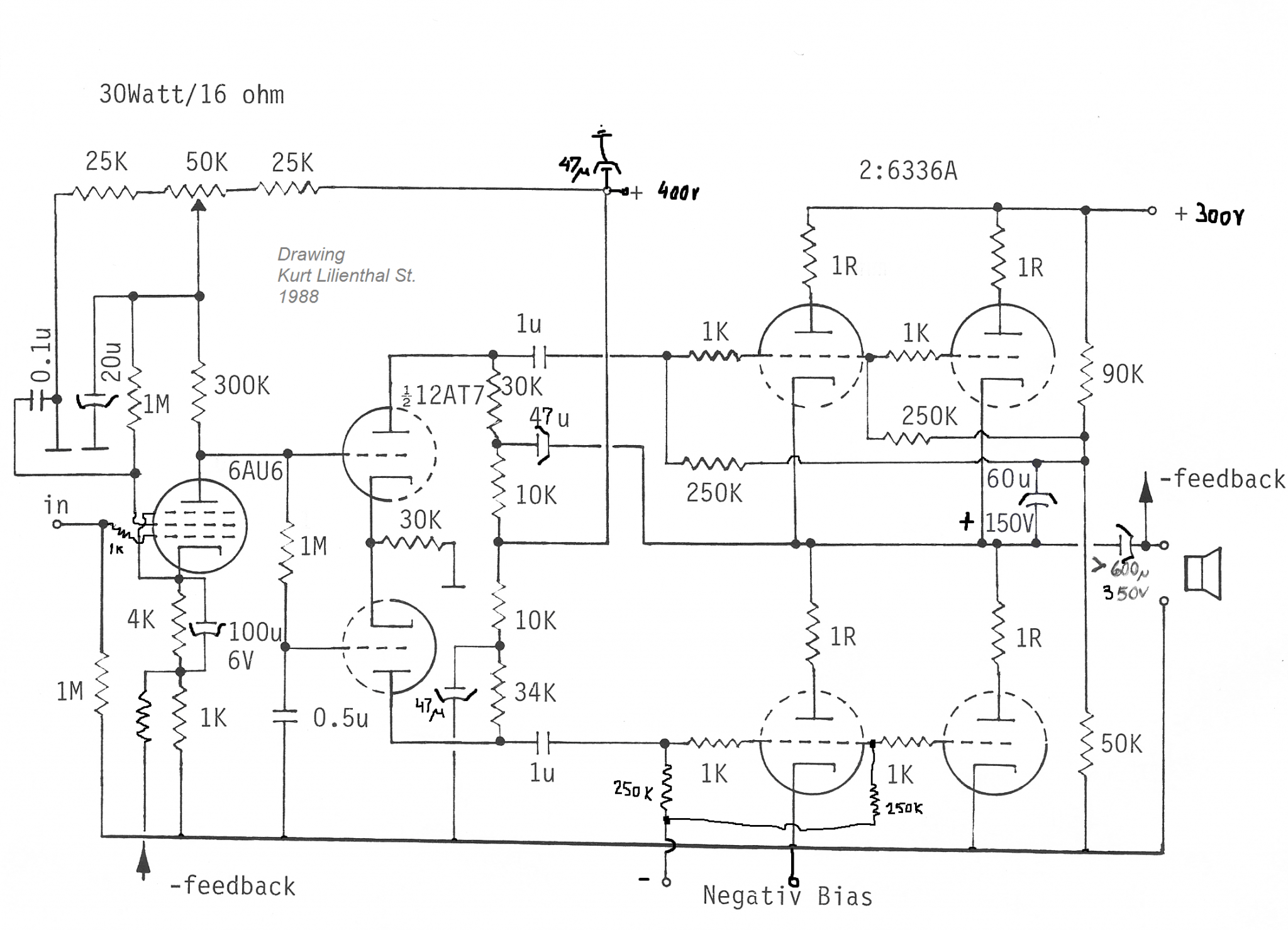

"Common" totem-pole OTL...
Is possible to achieve high Z with output pentodes with totem pole configuration, if one uses the "gain" configuration in the phase inverter connections.
If one wants to avoid sand at any cost
Hi Alexandre,
do you happen to have an example for that? I do not know what you mean with "the gain configuration in the phase inverter connections". In OTL there is the Technics and the Futterman, the first has a "cross coupling" from the driver to the output stage, the Futterman has none, therefore attaining higher output impedance 6C33C OTL

The Tube CAD Journal, Totem-Pole Output Stage
Is the "split load gain circuits".
With pentode, will result in a high Z out.
All this article is a must for totem pole stage modes, and PSRR also
Yes, the Futterman is a high-Z one, but since the analysis in tvr site was made with triodes, this result in some moderate/finite out Z.
"Distortion will be higher" affirmation: of course, since the high Z connection excludes the local feedback, the output will have the "full" device distortion
I thought a totem pole with Pentodes drives the speaker with a cathode (top tube in the totem pole), and the plate (bottom tube in the totem pole).
But . . .
Cathode impedance is 1/Gm (medium to low)
Plate impedance, rp, is high.
Medium to low impedance, in parallel with high impedance, results in medium to low impedance.
So, the Pentode totem pole amplifier must include current sensed negative feedback to get the output impedance high, Right?

In fact, the "Futterman" connection will brings high Z for pentodes, due to manner that the phase inverter is connected, behaving like 2 anode output stages in parallel.
Of course, commercial Futterman amplifiers with pentode out and low Z exists, but is due to global feedback converting gain and gm into low Z (global voltage feedback).

Erik you can also consider this OTL topology for your hybrid amp , where output power tubes have to be replaced with those depletion mode power Jfets (UJ3N065080K3S) , of course many elements and voltages have to be changed to work good with that new solid state OPS , advantage of this configuration is that no DC protection is needed since there`s coupling cap on the output line , and later you can also play with negative/positive feedback network to get desired output impedance , output power can be in range from 30 up to 80 W depending from OPS class of operation , A , A/B .

The transconductance idea did not work nice, due to the resonance of the speakers. Logical, afterwards...
I ended up making this amplifier, played it through my line arrays (32x 4R speakers in series) this morning, and it worked.
