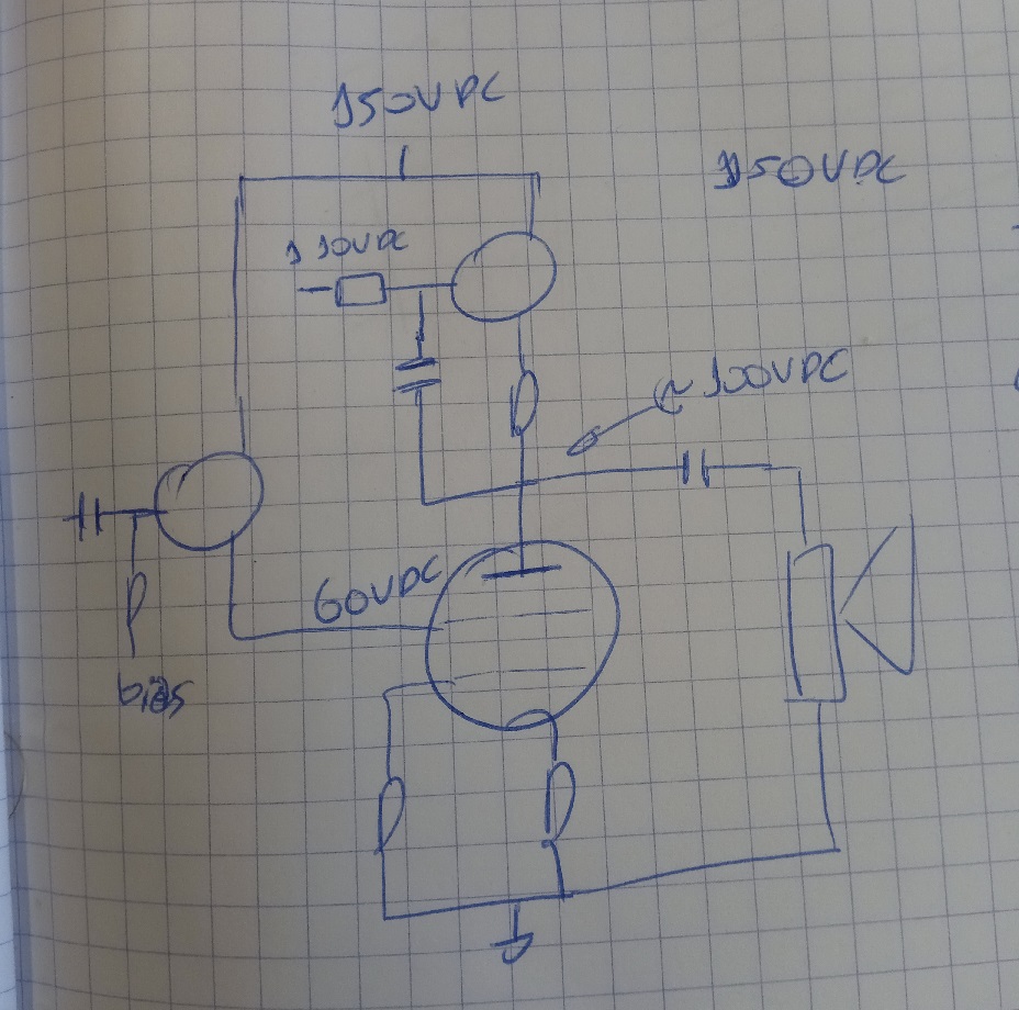

Wow, many thanks for all the replies. I read a lot of Broskie's blogs and indeed saw the OTL for the 50 ohm headphone, and his comments on the advantages of a 72 ohm speaker when using OTL. I understand the theory and a simple Futterman or circlotron would drive these to crazy levels.
As noted by 6A3sUMMER, I would like to have a current output amplifier. Taking these triode based Futterman and Circlotrons and skipping the feedback may be a first approach, but the distortion increases and it is still not a true current amplifier. So, as commented by Lampie, my thoughts are indeed towards the pentodes, natural high impedance devices, possibly aided with some current feedback that reduces distortion and further increases the impedance. Unfortunately this does not go well with OPTs, so therefore OTL.
I collected some thoughts and will make some sketches later on, show them here!

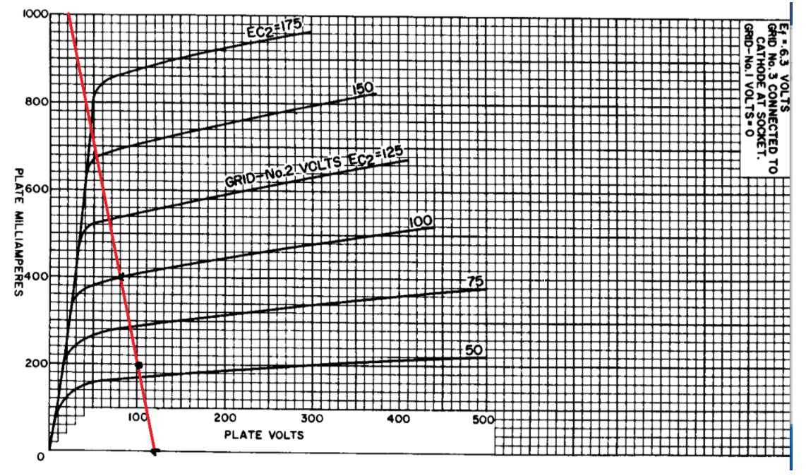

I have a stash of 22JF6 and an idea to use these in enhanced triode mode (G1 at gnd, drive signal at G2). The operating point in this example would be about 100V at the plate and 200mA, when it needs around 60V on G2, 0 on G1. The drawn loadline is 100R. The load is provided by a mosfet gyrator, with about 50V over it, to allow for enough swing and still be in its linear region (couple volts from drain to source).
In real life I would probably use 3 valves in parallel, with about 150-160mA per valve. Or PP, with 2 valves per side, and a lot less 2nd order harmonics 🙂 Also, some previous curve tracing with added cathode resistance and G2 drive has shown more linear curves and less gain (higher voltage and swing needed on G2), both consequences of the current feedback and good for my intention. Dual drive from SmokingAmp, or cathode driven from a P mosfet are also possibilities...
It is of course class A and a lot of heat dissipation!

I treated my simple PP pairs as separate slices only being connected on the output side of each slice’s output cap. This allows easier biasing and matching. Otherwise you’ll end up with a very complex system to tune as they’re all interdependent.
That steepness if vertical load line looks familiar!
A Google showed you can constant voltage load it by variable transconductance you’ll get the most out of the tube. A voltage governing triode Cathode tied amp with a variable current triode providing both would work to vary transconductance. Would need to experiment with LTSpice..
thanks for the link to tubecad, indeed what I was looking!
V-to-I Amplifers
Note the point at the bottom about capacitor size and current.
(This is where the wisened will shake their heads)
I have four PP pairs (slices). Each with 4x330uF+0.22uF, so in total 5,200uF per channel to reduce impedance from the bipolar 330uF caps with 0.22uF film cap. I could reduce that number of 330uF but for now it remains until I hear the amp running. In the grand scheme £5 difference isn't going to break the bank.
