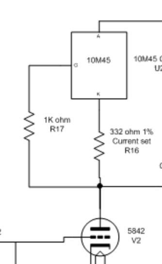

I found my bag of DN2540N5's, stuck one in the board, and it does work as expected needing a slightly smaller resistor to make the same current as a 10M45. Some early morning experiments on the complete signal chain suggests that best overall THD can be achieved with 6 to 8 mA, but further testing is needed. I need to bust out a TSE or TSE-II board for testing as well. TSE board number 1 is still alive and well in my Lexan TSE amp. The TSE-II board will not fit in that tiny amp so it will stay all original until it dies.
Unfortunately the DN2540N5 is virtually non-existent these days. I like the looks of the IXTP1R6N100D2. Spec sheet says 1,000v's X 1 amp =100 watts. It will be running somewhere in the 300v or less range at around 10ma in the Tubelab boards. Price is comparable to the 10M45s and it should survive with the voltage surge on startup being rated for1,000v. Only true test is put some in and put some hours on them.

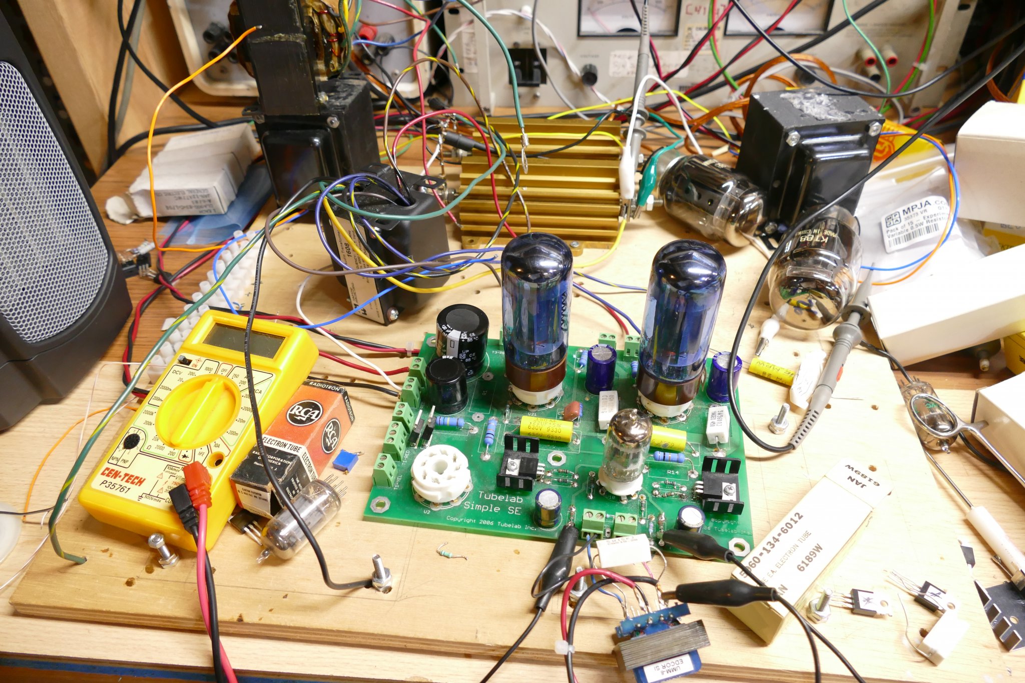

SSE board #1 has been on my bench for a few days. Before ripping it off the bench and putting it back into "the box" I decided to revisit the experiment that literally made the biggest bang, but on a smaller scale. I have known for some time that one could drive the two channels out of phase, then wire a P-P OPT across the two plates to turn the SSE into a not so Simple PP. I made a few guitar amps this way many years ago. Trying this with TV sweep tubes scattered electrolytic goo all over my workroom when I turned the power supply up a wee bit too much.
I used a small Edcor interstage matching transformer for a phase inverter and wired a 6600 ohm guitar amp OPT across the plates with the tubes jumpered for pure pentode operation. With a B+ voltage of over 500 volts I saw 50 watts at about 3% THD flow from the SSE board using the Blues Tubes 6L6WGT's. I tried some "expendable" Chinese KT88's from the 1990's, but lost ground due to excess grid current. I rolled through a bunch of driver and output tubes and a few different OPT's with varying degrees of success, but my goals are not my typical "MORE POWER." I need to find a driver design capable of feeding a BIG cathode follower output stage. Power is not important, I need CLEAN voltage.

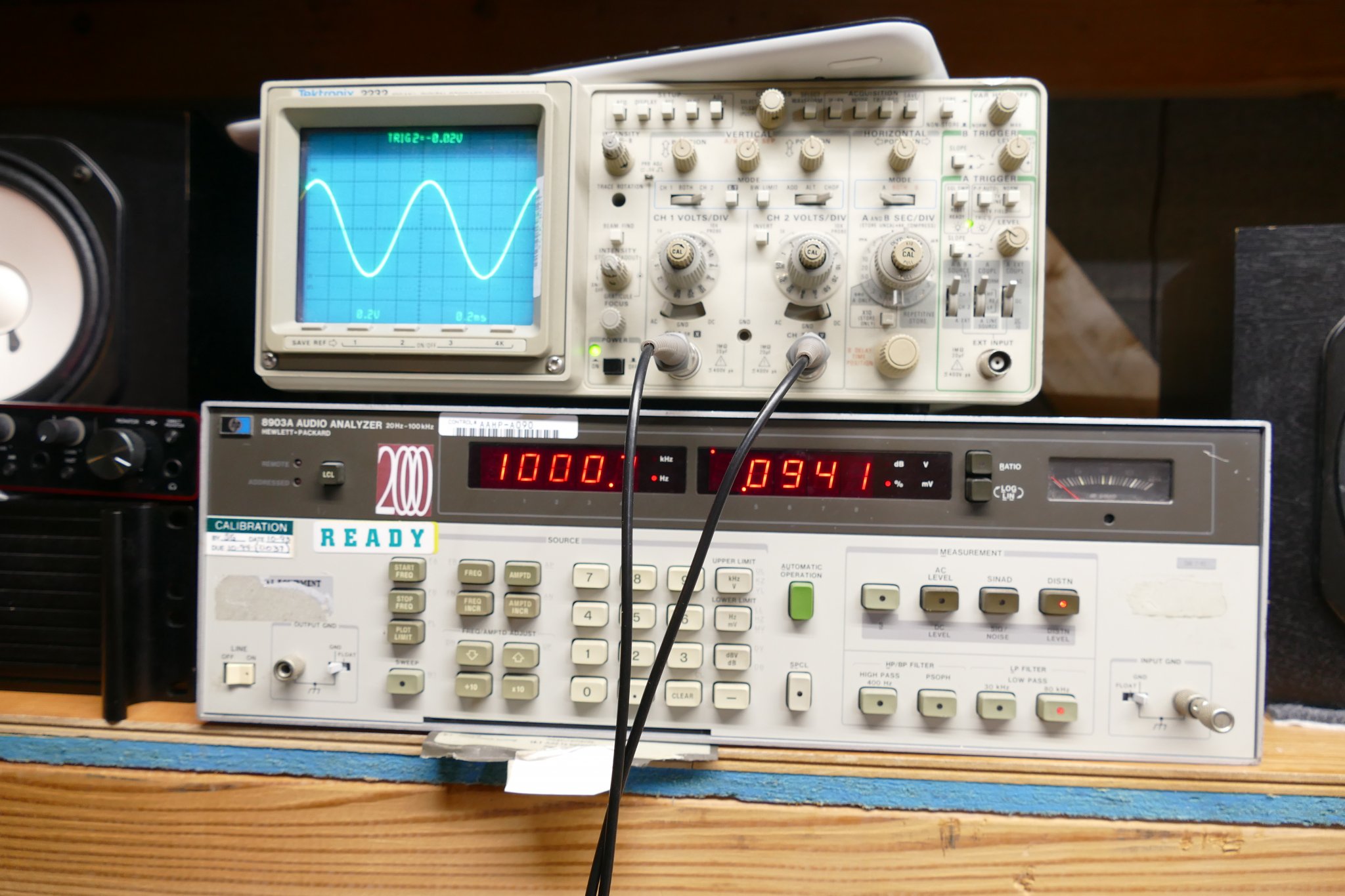

I stumbled across a combination that got my attention. It works too good to be true but it is. Good enough that I want to dig up another dead SSE board and build a second copy for listening in stereo, but I only have one OPT. What's so special? How about a little amp that only makes 10 watts from a pair of 6L6's in class A push pull. These numbers were seen on two separate occasions yesterday, and verified this morning. The residual THD in the audio oscillator is 0.04%. The 100 mW reading is affected by residual hum and noise from the sloppy wiring.
POWER THD
0.1W 0.103%
0.5W 0.056%
1W 0.068%
2W 0.1265%
5W 0.328%
10W 0.488%
12W 1.984% onset of clipping
15W 5.40% serious symmetrical clipping with slight rounding
The OPT is an old style Hammond 1608 wired for 8000 ohms. Tubes are the Chinese "Blues Tubes" 6L6WGBs and the driver is a JAN 6189W which is a 12AU7 that doesn't suck.

The 332ohm resistor will determine the current running through the tube. You want less than 10ma.To use IXTP1R6N100D2 as a CCS Is it the same circuit as the one in the TSE/TSSE or would it require any adjustments?

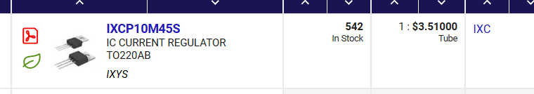

2 weeks later there are only about ~400 left at Digikey. Do not wait too long to get them. I bought a small batch so if anyone in Switzerland need a few let me know in pm. Not shipping anywhere else sorry.
FYI... Digikey is down to 28 in stock IXCP10M45S left. https://www.digikey.com/en/products/detail/ixys/ixcp10m45s/416792
