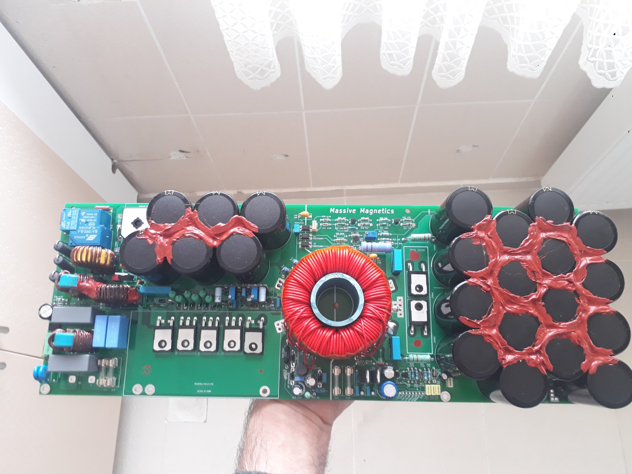

@alexberg yes I just checked their datasheet too, input is 230v 16A, , not to mention if operated from 110V in US , I think the maximum output of 14kW is written for 4 ohm bridge and it probably is a peak load measured for a very brief period for a pulse.
As for the ringing the video attached here by Veysel from another person checking the amp with scope showed the ringing and that seemed like the original lab gruppen amp, so I guess it's part of the thing.
"Chineese" watts (no pun intended) is a clear indication of datasheet craftsmanship. buy cheap, buy twice
"I guess it's part of the thing" - You do not listen: I am done with it.

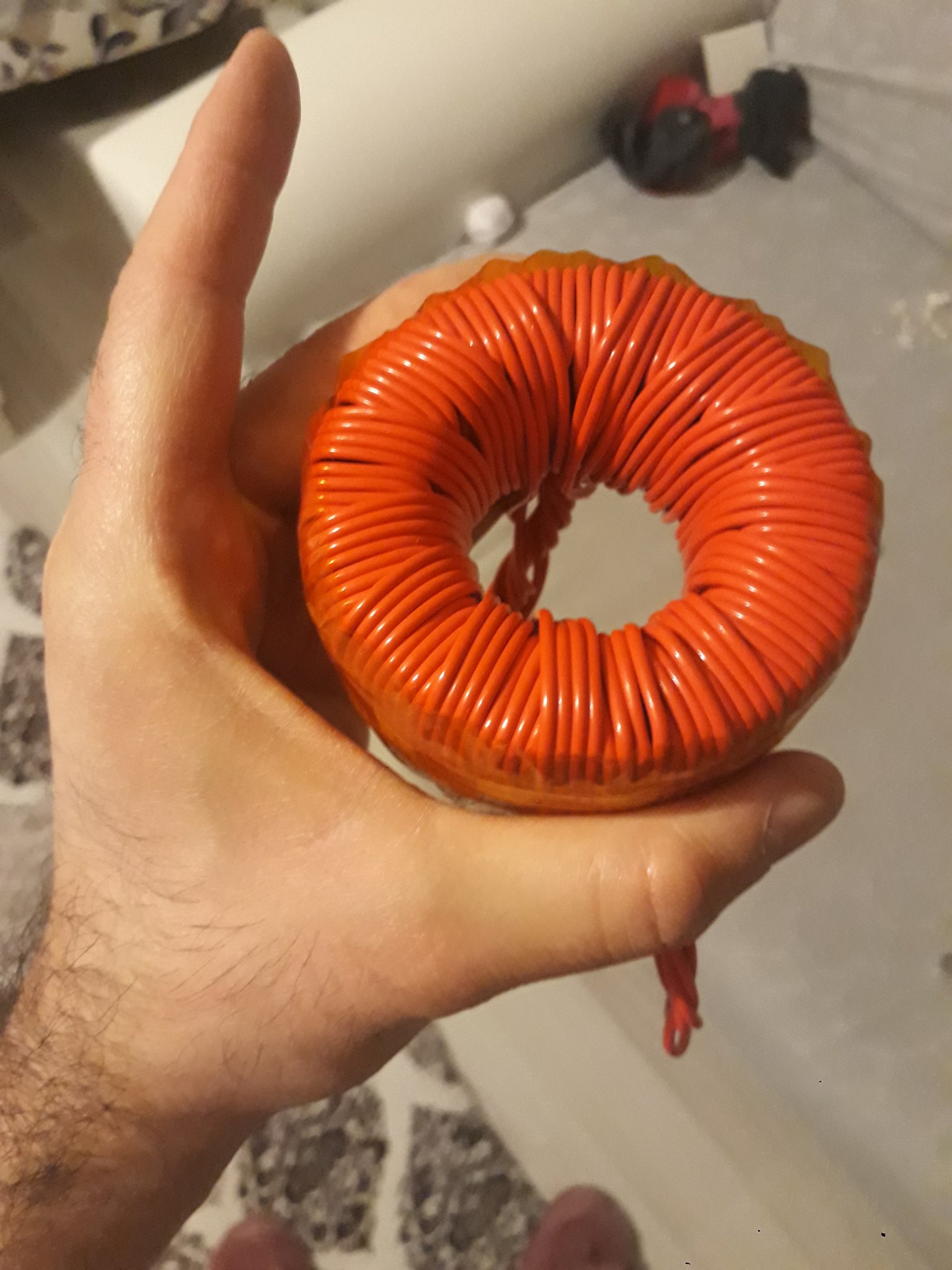

It is not a cheap project, I have allocated a large amount of budget for this work, I like to do the works that say no, I used a smaller Magnetics Edge transformer with my winding technique on the second version road.

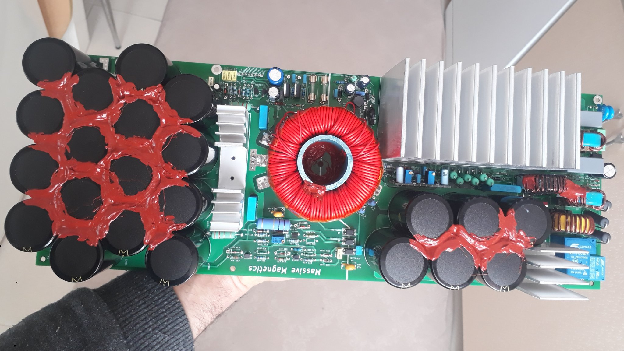

"In many current applications, however, the internal temperature requirements have been ignored: many times the capacitor banks are so densely packed that the capacitor bodies are touching. Even though the capacitor specifications usually require a 1" spacing, the demand for smaller packages overrides the capacitor’s need for cooling. The result of this tight spacing is shorter capacitor lifetime."

You may be right, I can say something as a result of long tests, I used kendeil 105 degree long-life capacitor myself.
