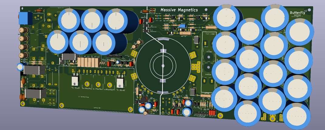

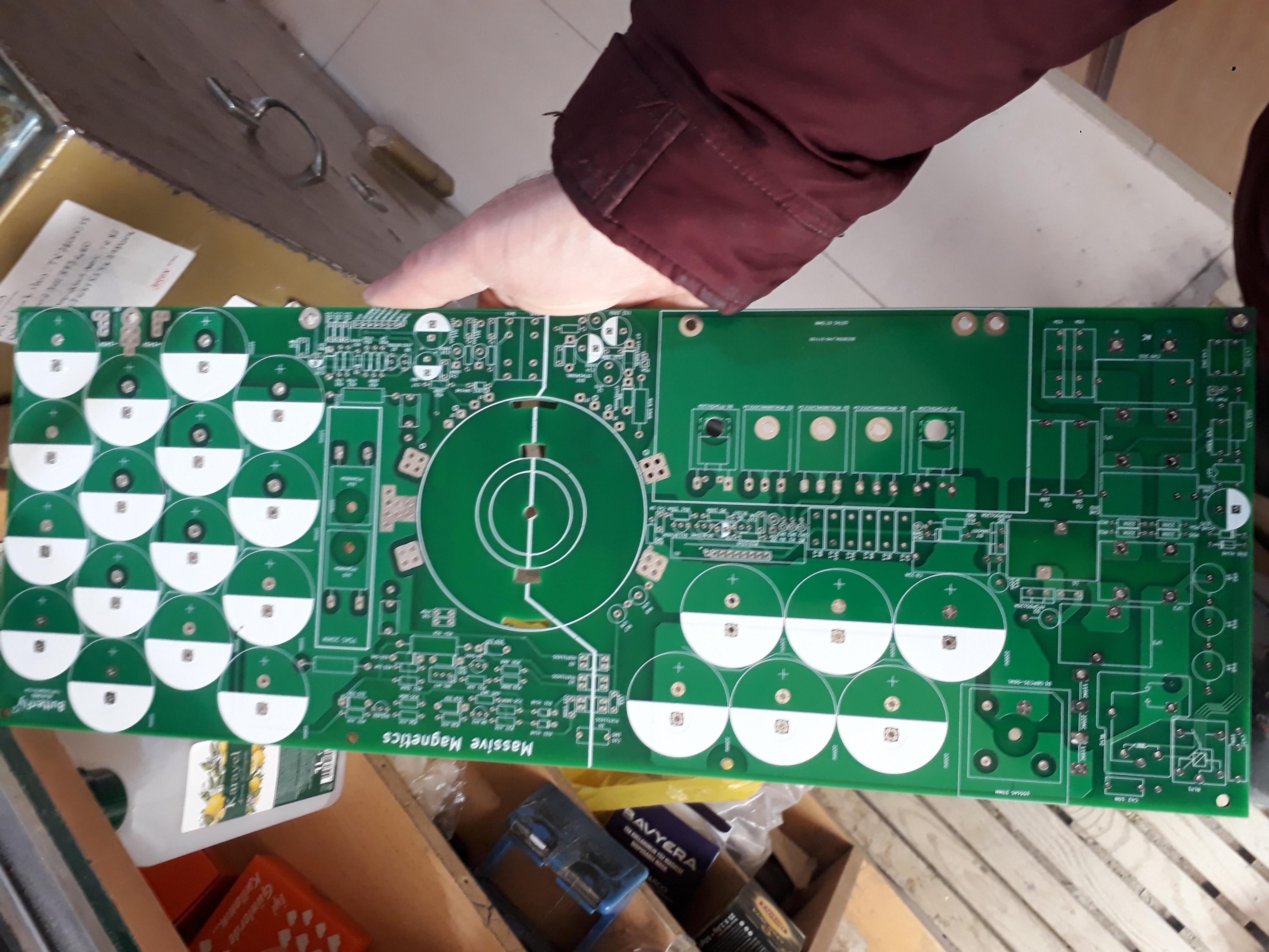

445.5 mm* 162 mm

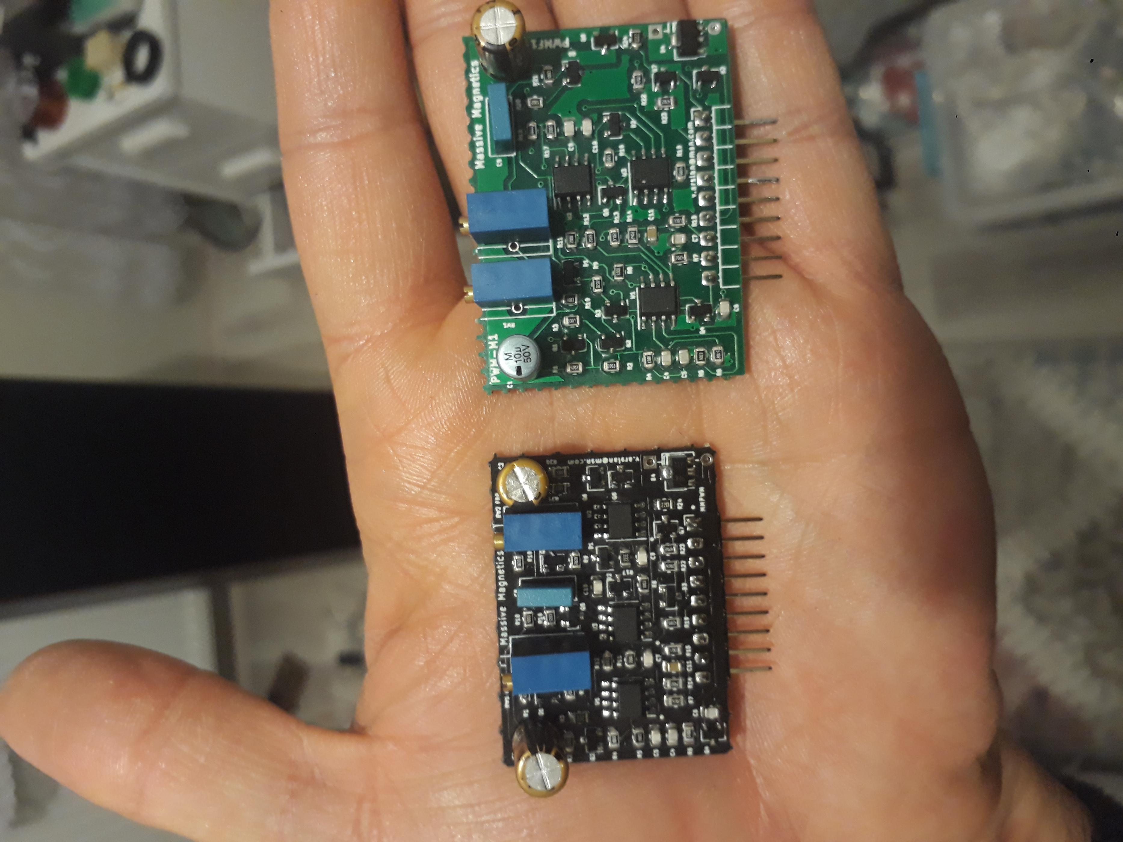

And new pwm( black ) improved ground loops
445.5 mm* 162 mm
Size
Hi dorel i can remove 8 pcs capacitor
And i can remove line filter
(10 pcs seconder 4 pcs primer)

It can also be called a device that is a mixture of pfc and flyback, it has nothing to do with the flyback in the lecture notes, the input fuse is 30 amps by the way.
