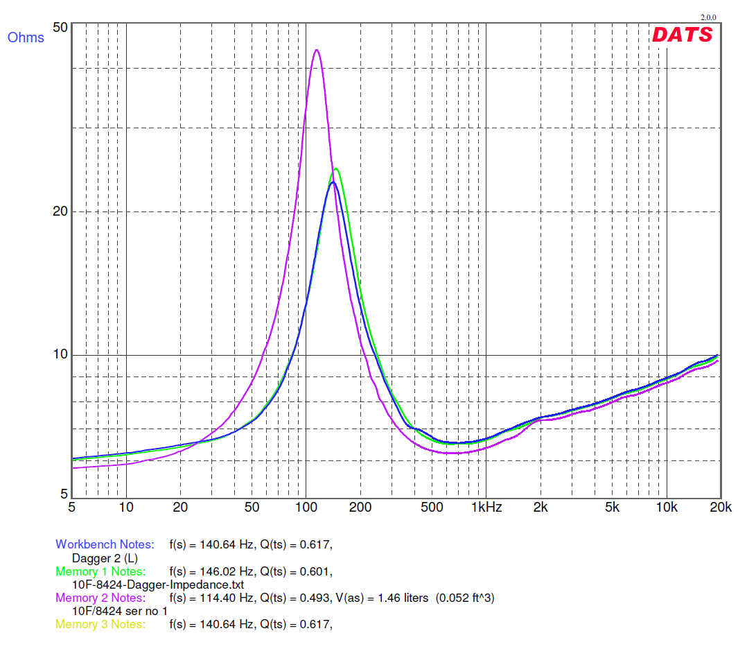

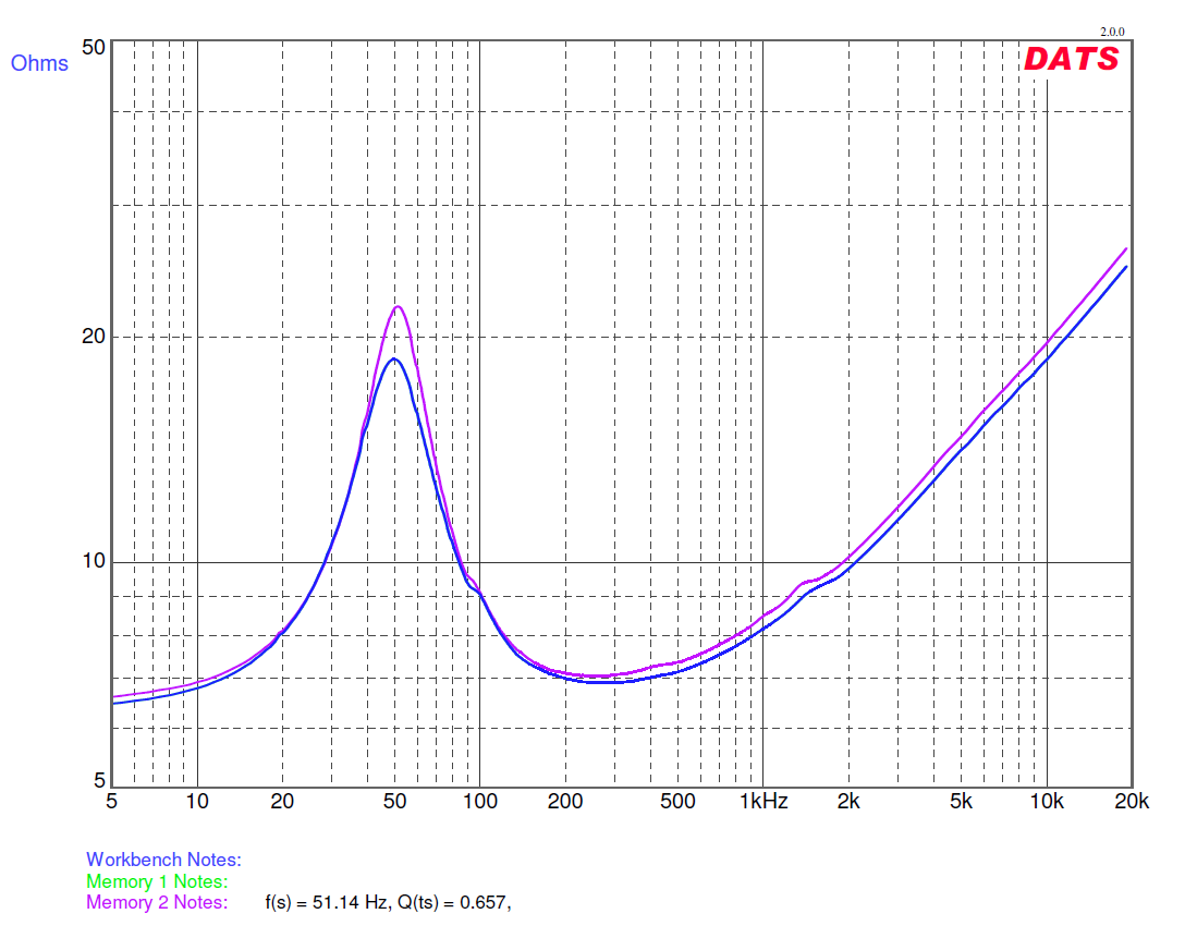

I first tested the impedance to ensure that the boxes matched. The Dagger is a pretty close match, the sealed RS225 is a little off with the unit 2 having a slightly higher Qts, 0.65 vs 0.61 for unit 1. I may have to adjust the fiberglass stuffing to balance them.
10F/8424 Dagger Impedance (purple is bare driver and blue and green are in Dagger):
RS225-8 Impedance:

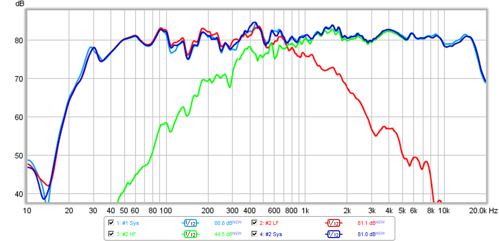

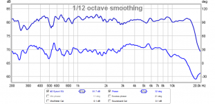

Here is the comparison of unit 2 (Left) compared to unit 1 (Right) response for LF and HF drivers and overall system response. Unit 2 is dark blue, Unit 1 is light blue - pretty close match.

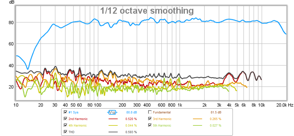

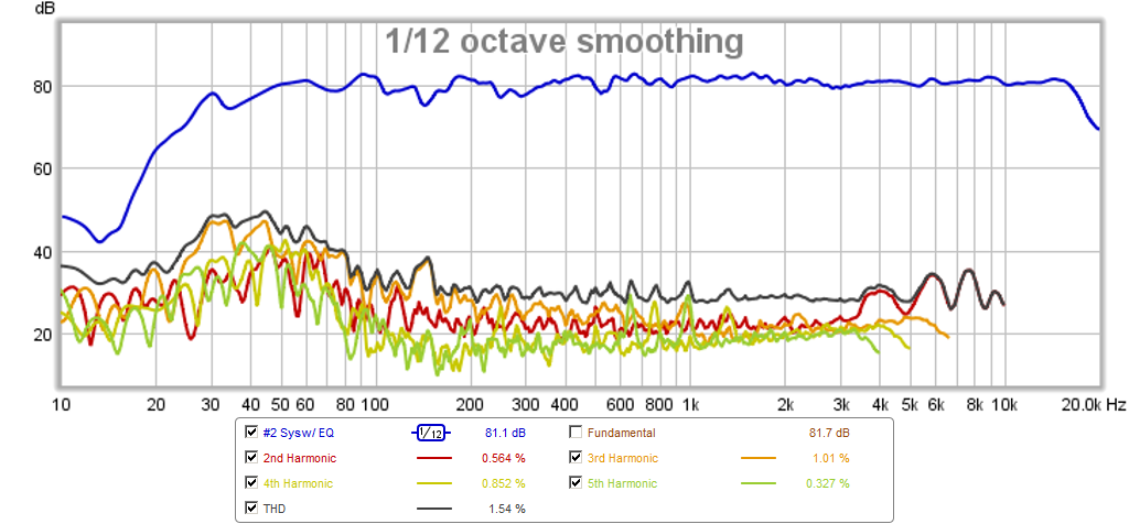

This is harmonic distortion with wet glue, resembles earlier HD measurements that I made of unit 1:
This is the HD of unit 1 now that the glue has dried and the internal braces are securely affixed, significant reduction in HD! So I will have to wait a week or so to make sure the glue really dries before making more measurements:
Again, these are HD measurements at 0.5m and 0.71 volts just so that I can see things are working or not. In this case it shows that glue is still wet.

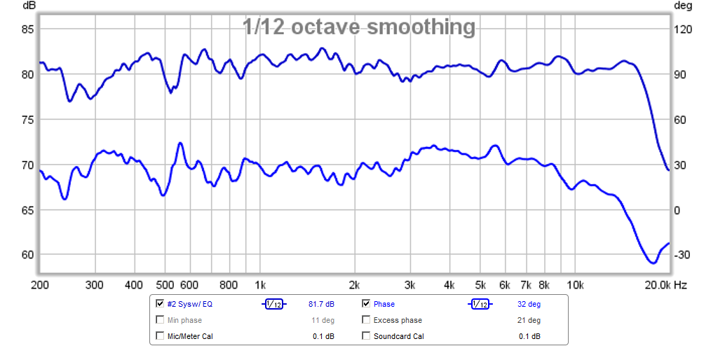

Here is the response of unit 2 with a 4ms gate applied and some very small tweaks to the PEQ to get the response and absolute phase very flat:
RS225-8 Impedance:
