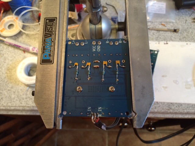

Here is how I did the bootstrap snubbers on the TDA7492. Those are ceramic 330pF 100V caps and thin film 1/4watt resistors.
