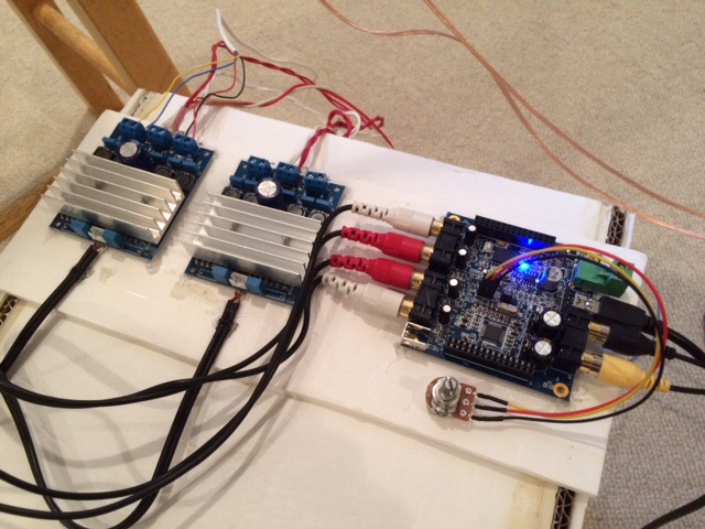

These were assembled because I need another general purpose miniDSP setup to continue to make and design more speakers. I can't say how good they sound yet in comparison until I do more listening tests. First thing will be to load the setup for the 10F/RS225 FAST in them and switch the current system over and listen for a while. I can't imagine it can be as good as my last modified amp. Generally you have to at least switch the main power cap to a quality name brand low ESR one. On class D amps that is the single most important mod.

Ok I swapped out the amplifier and miniDSP for the new TDA7492 and set up everything and listened first. It sounded bery different - in a bad way. I had to take out the mic and measure it and I had the polarity flipped on one of the drivers. The new amp has a different polarity orientation on terminals. Then it measured without cancellation. I listened some more and the HF seems very detailed compared to the 3116. Sure enough it too -0.5dB low shelf from 1700Hz Q=1 to get the response to match the 3116. In the bass area it felt lighter and measurements show about 1.5dB reduction from 100Hz on down. This is probably the result of the cheap electrolytic cap. Low bass is usually the first thing to go. But overall - the system sounds very nice for $8 amps. They appear to still sound more detailed in the high frequency even with EQ balanced. Will listen more and get better assessment.

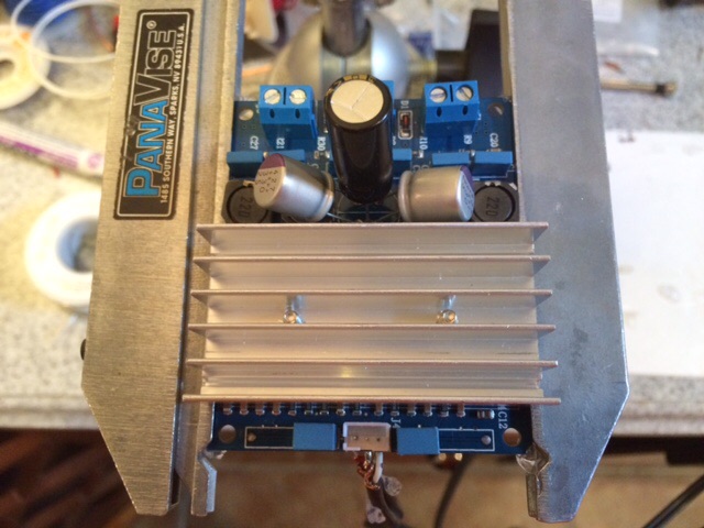

I just swapped the stock no name caps for Panasonic qnty 2 x 330uF 25V SEPF OSCON and qnty 1 x 560uF 35V FM. I also added a 330pF + 10R bootstrap snubber. The amps sound fantastic now - better sound stage, more impact on the bass, and smooth yet detailed highs. I would say it sounds as good or maybe better than the TPA3116D2. The mods probably cost about $7 in parts (those oscons at almost $2ea). The system really sounds great though.
