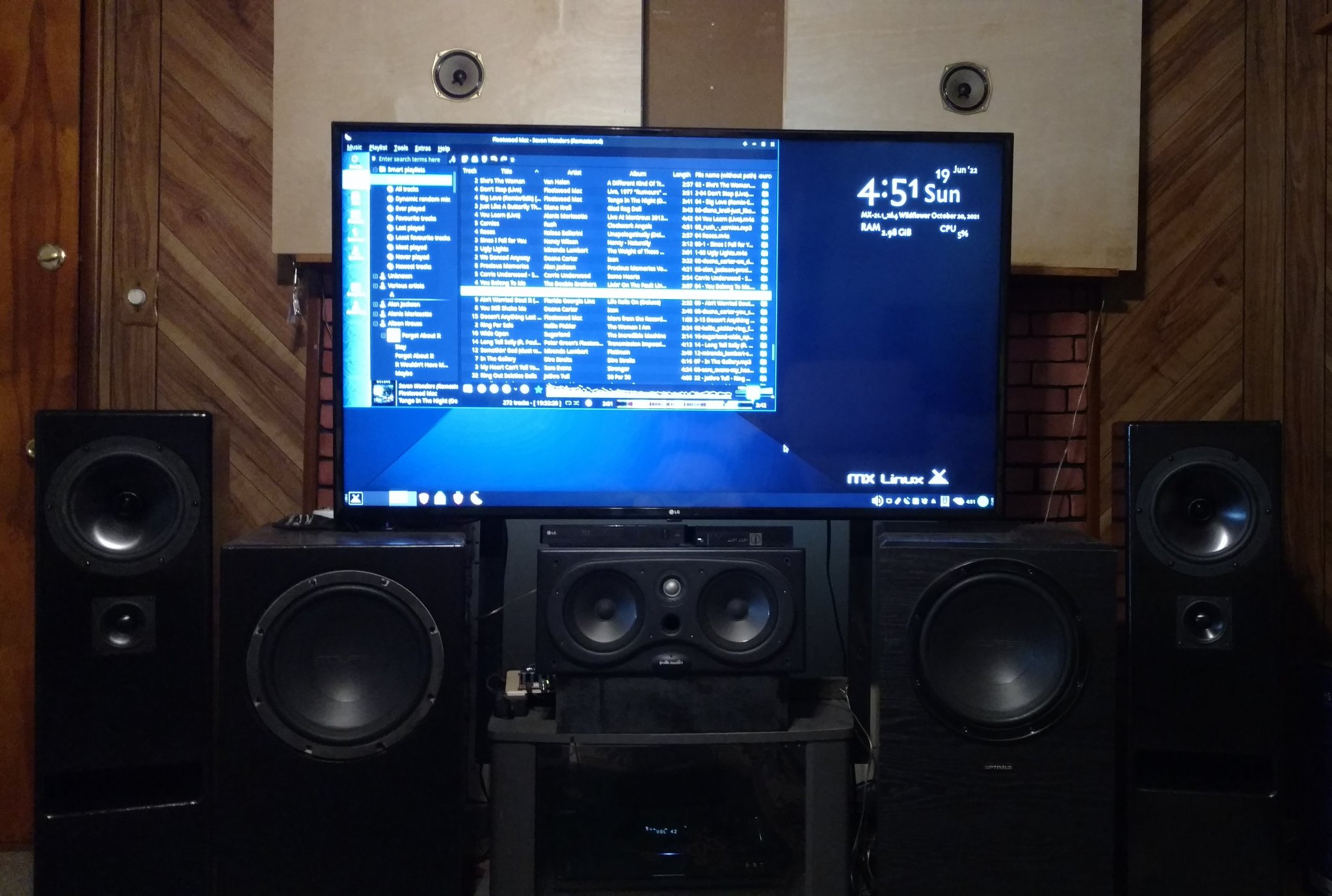

Its working now, 8 days start to finish. they replaced Acoustic Research S-50's for
HT and music. Over all it seems like they work fine, A bit smoother not as sibilant,
much more coherent image Need more time to judge....... and adjust polyfill.
I think the DMA90 driver works good but:
How much better would an approved / tested driver be?
Maybe its time to buy a better microphone
I do have a pair of the 3 1/2" TC9 drivers from 5 yrs ago whatever was recommended in the spiral horn thread so those could be swapped if that helps?
I have a lot of amp building parts but nothing for crossovers so that is why I used what I had. With measurements maybe they could be adjusted...
Or leave it as is and buy some foam board/ look for something else to build?

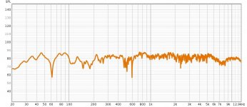

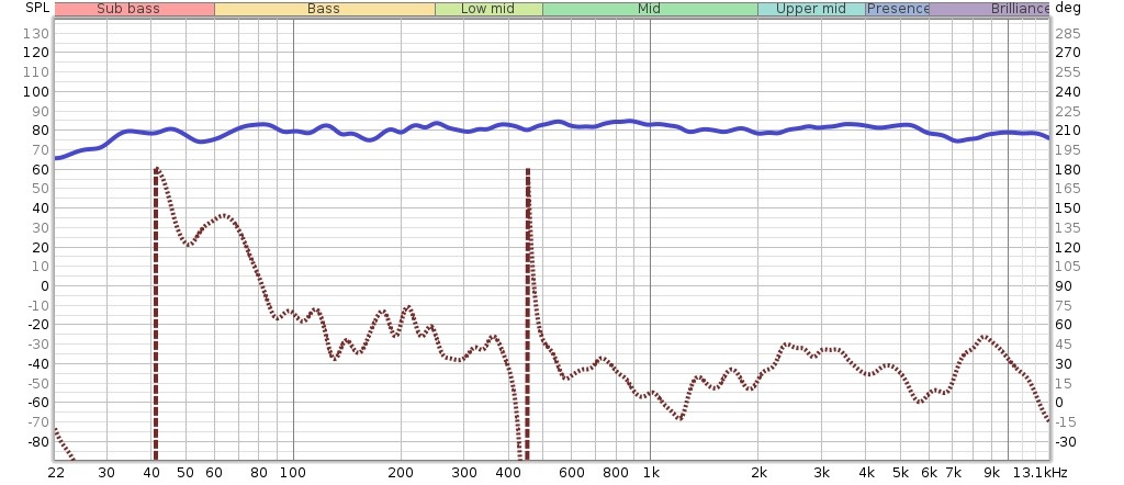

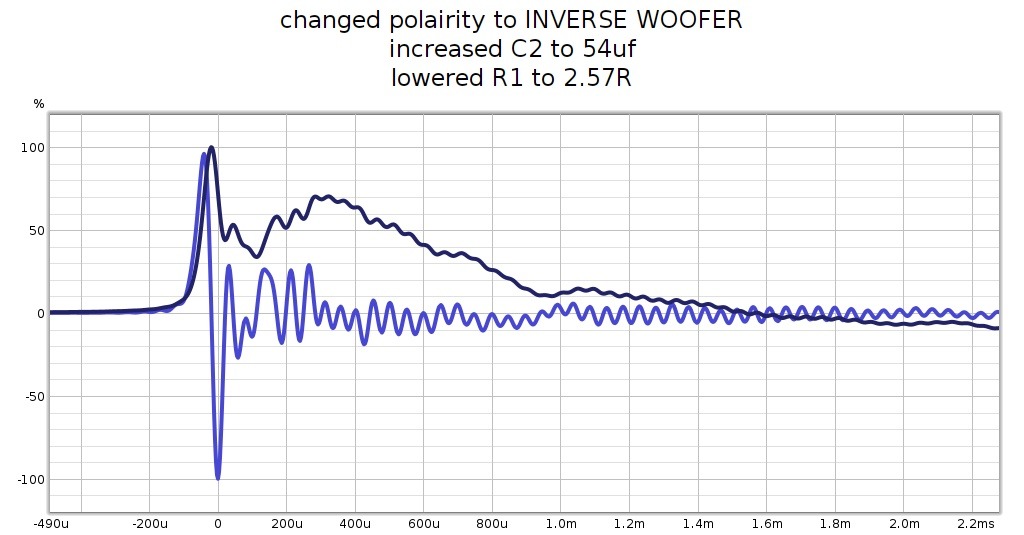

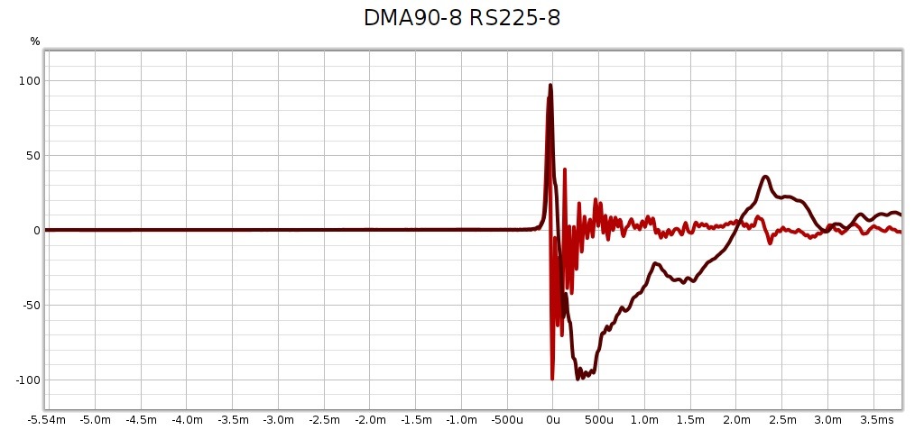

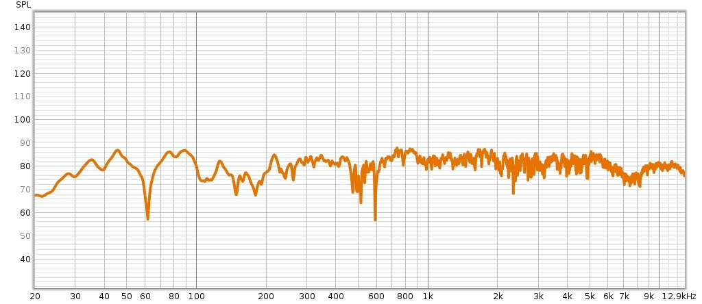

its been a few years since I used REW and that was on HPhones.
so muddling a bit in the dark.........

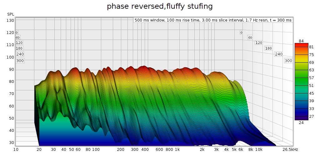

First run - no smoothing
looked like some suck-out and phase reversal so reversed RS225 polarity and lightened stuffing a tiny bit
and added 1/6 smoothing
one way I judge a speaker is how temped I am to turn it up to get it to sound better
These sound good from 75db to 105db

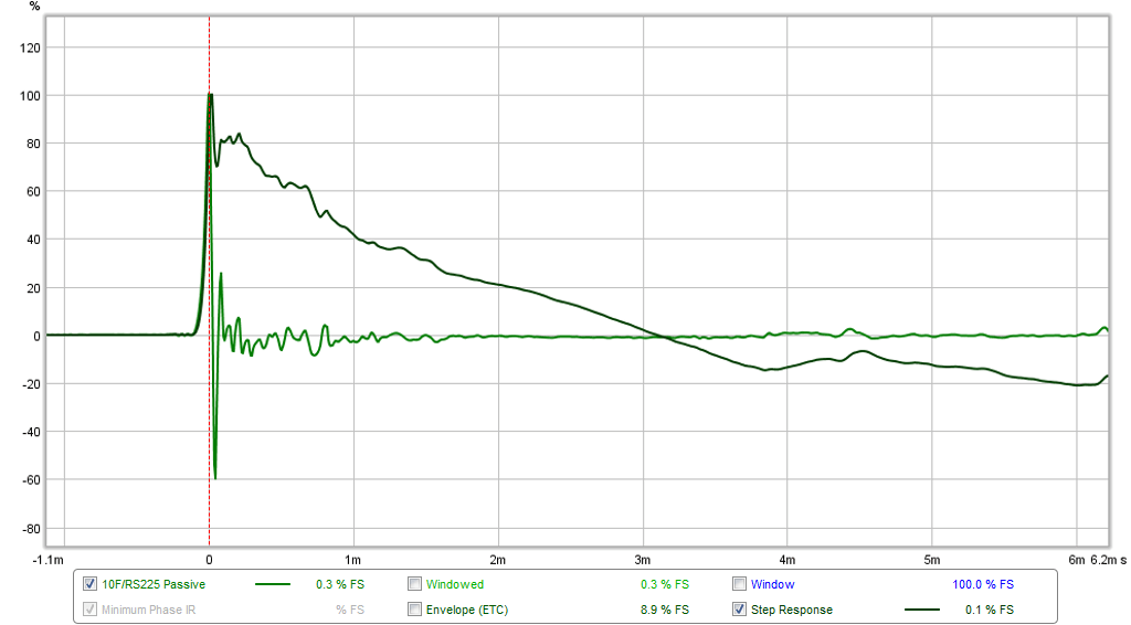

Look at the step response and make sure you have a right triangle. Inverting the woofer polarity (unless it was accidentally reversed) may not be good. Your measurement shows a phase glitch at 400Hz which is odd. Measure on a stand at least 1m above the floor. Set the mic at 0.5m height on fullrange axis. Look at frequency dependent window 6 cycles. The phase should be flat from 100Hz to 15kHz.

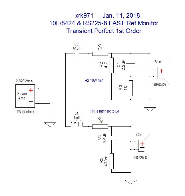

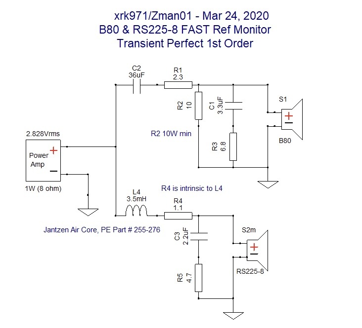

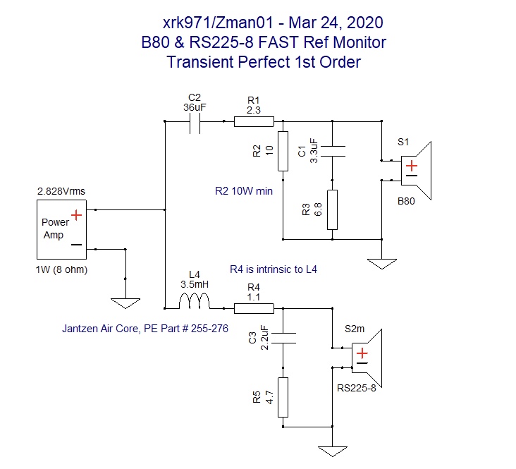

Hi Congo,
Can you please remind me what drivers you are using and if you are implementing the XO as described in the schematic?
Under the “Impulse Response” tab, click the “Step Response” check box. You should see something like this:
The whole thing may be upside down if your mic is inverted (or amp is inverted output). But the important thing is the tweeter and woofer are if they same polarity. This is what gives the the realism to the percussion.
10F schematic:
B80 schematic:
Note that both tweeter(wideband) and woofer are same absolute polarity.
10F schematic:
B80 schematic:

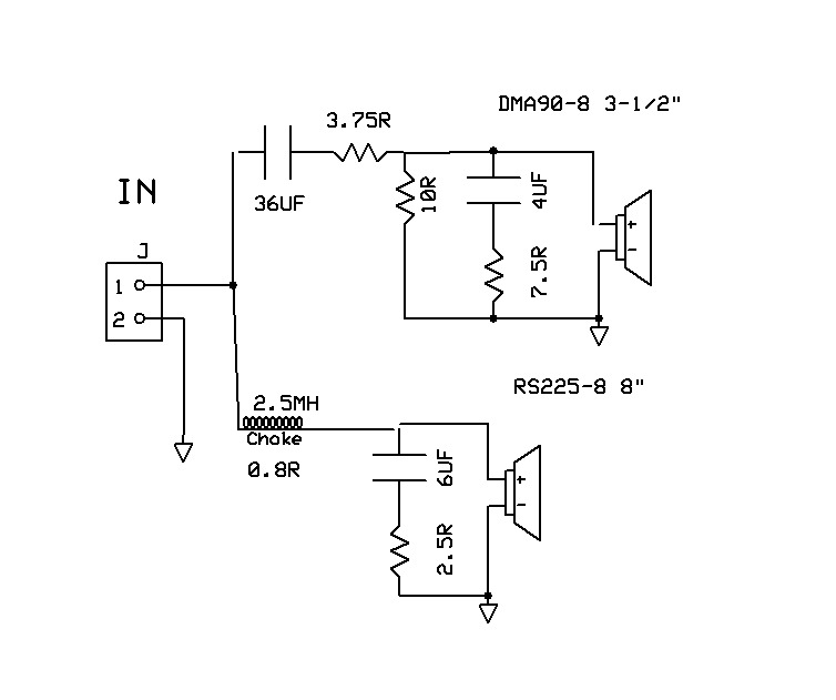

Drivers are:Can you please remind me what drivers you are using and if you are implementing the XO as described in the schematic?
RS225-8 https://www.parts-express.com/Dayton-Audio-RS225-8-8-Reference-Woofer-295-356
DMA90-8 https://www.parts-express.com/Dayto...Aluminum-Cone-Full-Range-Driver-8-Ohm-295-589
The Good:
The box IS built to your 3/4 BB plans
the Dagger is 5 sided sealed & stuffed 1/4 plywood
I used some butyl rubber in center of spans
the foam is done to spec's
this DMA90 is an undocumented fullrange driver
studied your schematics and made one with parts on hand to closet values I had.
and I have not made an order for crossover parts yet
Yesnote that both tweeter(wideband) and woofer are same absolute polarity.
None of this is a Design fault
its my work in progress
Nothing is permanently compromised Yet
I like this driver fine but a new one can be ordered
its already better that what I had
need learn to simulate the
xo;s
You have your woofer inverted polarity and that can be seen in the step response. It may have better integration because the inductor and capacitor values are so far off. Inductor should closer to 4mH and cap closer to 60uF. As you have it, the crossover frequency might be up a bit higher and causes phase misalignment of 180deg requiring polarity flip. But it’s probably not bad sounding at all - just not transient perfect.

OK thanks a lot ...............
I can add an 18uf and a 6uf film in parallel = 60uf
also have a 1mh inductor add that in series for 3.5mh??
I can order better parts but wasn't sure about values

Now place your microphone on the woofer axis 0.5m away and that should provide the time delay to get the wideband time aligned with the woofer. That’s why the woofer is on top. That’s about 10cm delay to get 350usec shift.
