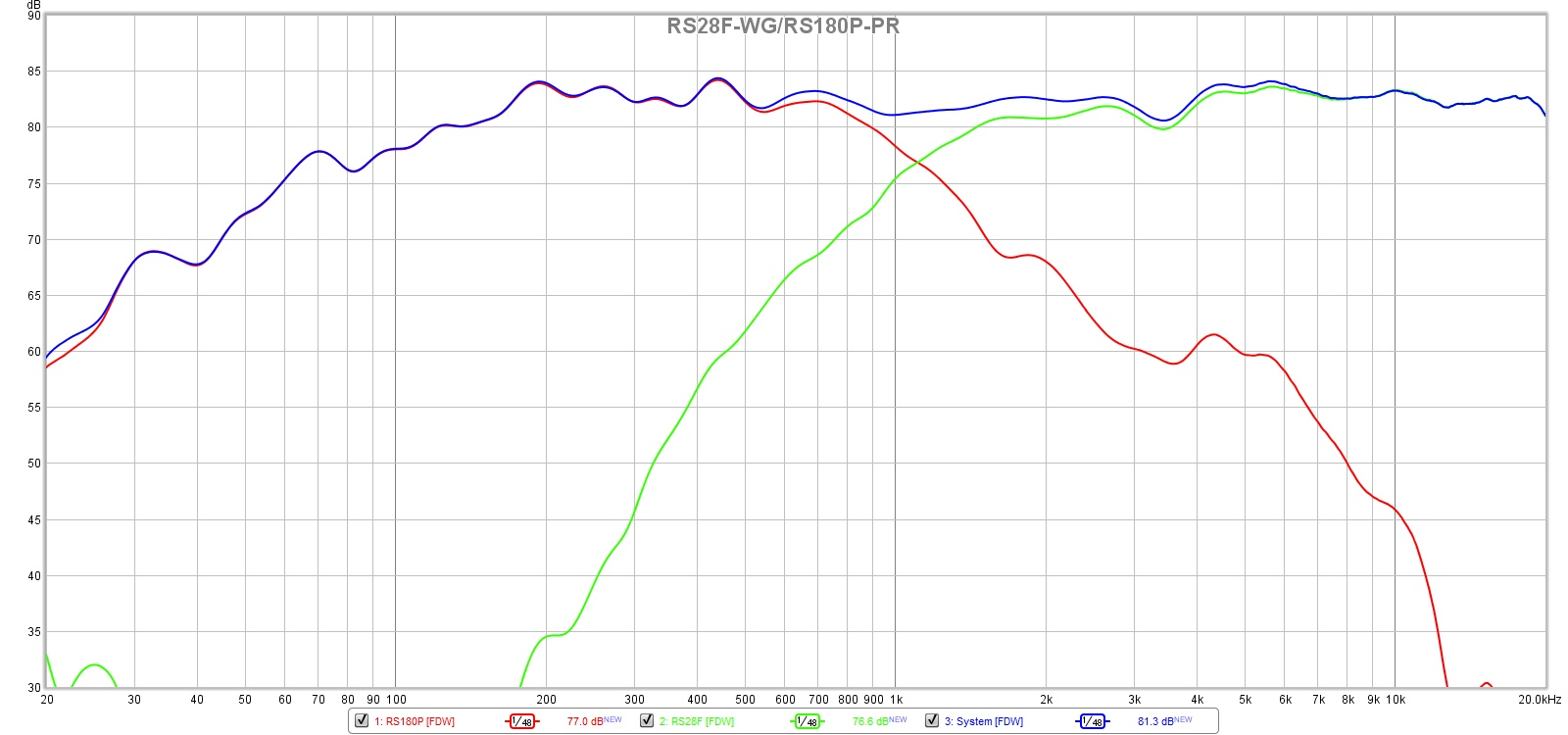

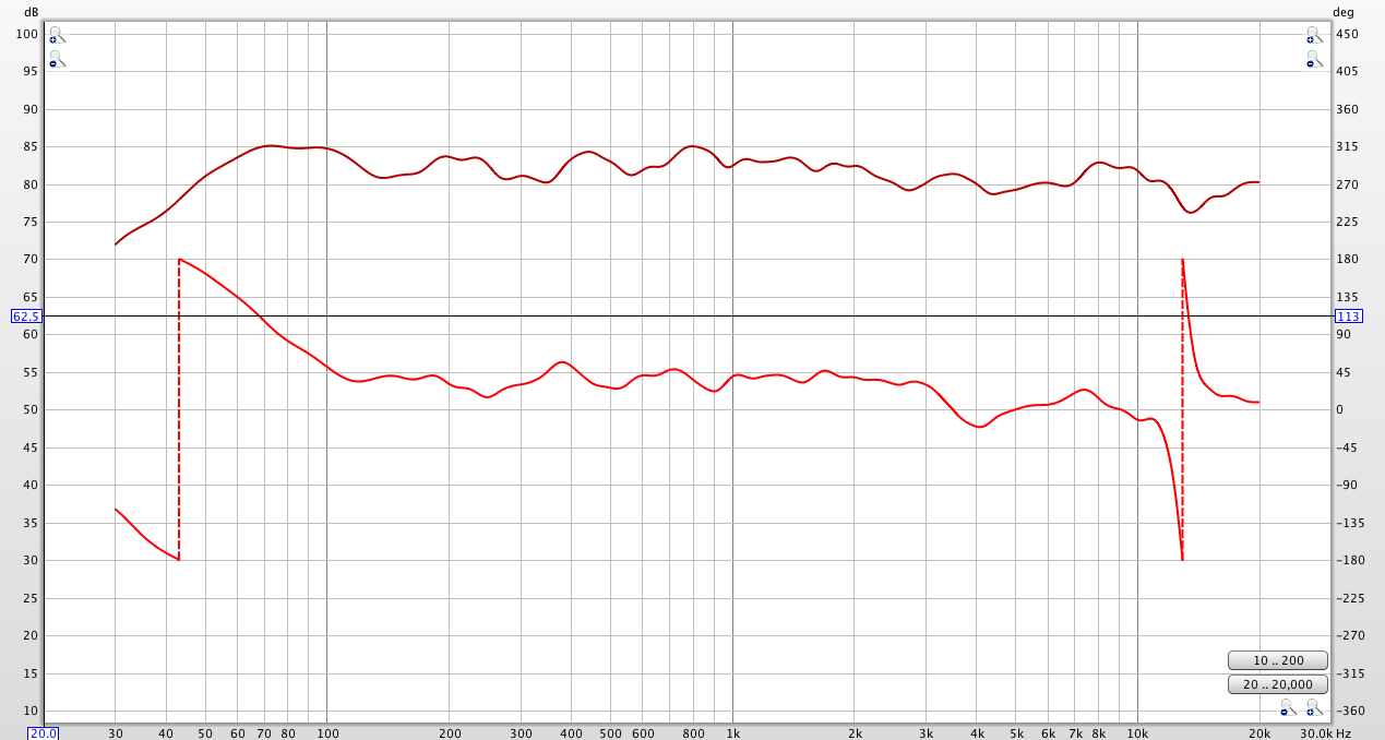

Hi Perceval,
That’s a nice job you did there - the XO is very simple. It actually looks very close to transient perfect given the very flat measured acoustic phase:
What is surprising is that the predicted phase has all that noise and wraps up and down. I wonder if you don’t have the inter-driver delay adjusted correctly in XSim? But in real life it is corrected by placement of drivers.
Those race track drivers are probably a good candidate for a TL.

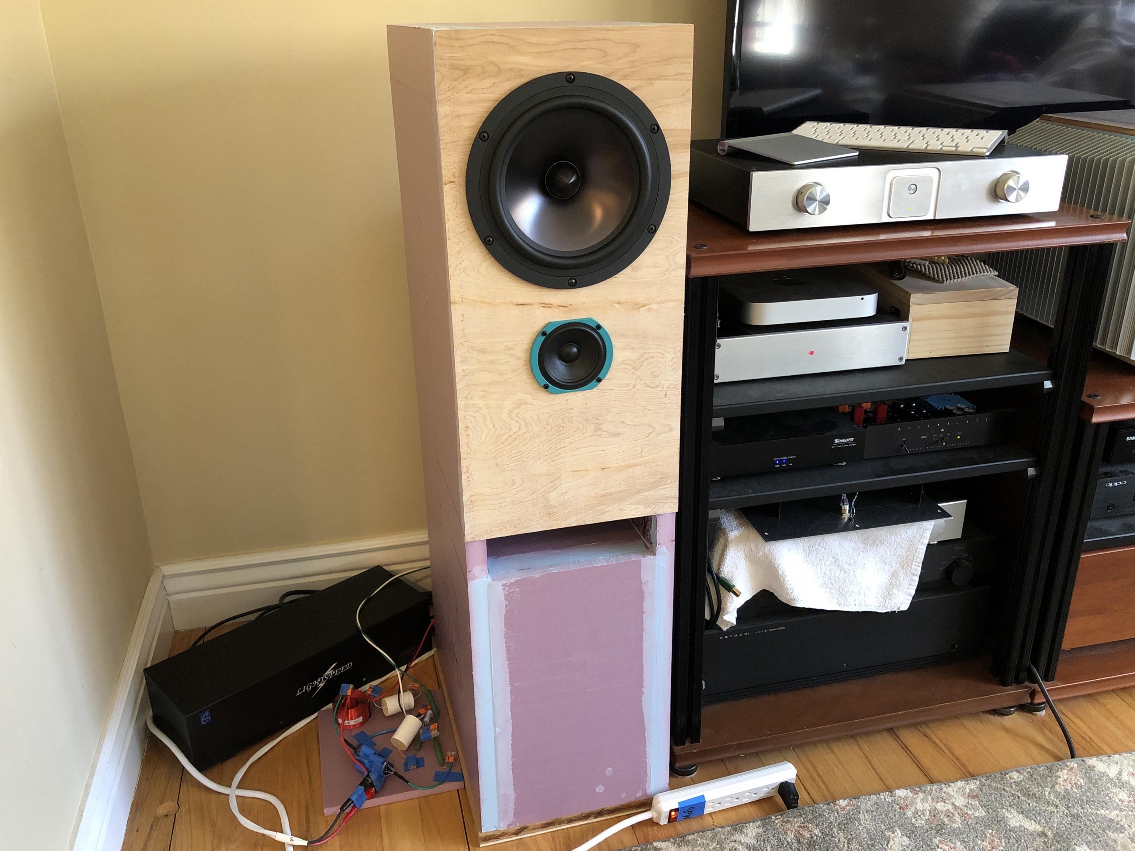

Speaker #1 will sing tonight and #2 will be ready tomorrow for full stereo enjoyment.
Vunce

I didn't adjust anything in XSim, as the drivers where measured while placed on the baffle. But, I didn't extract minimal phase so that might be why.
And yes, a plan is already set to put the race track driver in a TL, vertically, and add a FR on top.
It does sim very well.

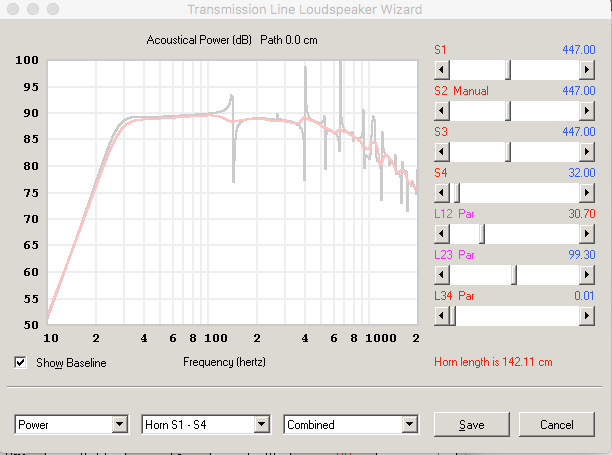

Hi Perceval,
Nice sim with 90dB close to 30Hz! That will really be something - is that 2.83v at 4ohms?
Yep! but 8 Ohms. that is with a single driver, not dual.
Should be quite nice!
I didn't try to sim dual woofers... it would be insane output.

Hi Perceval,
Is the above the sensitivity you are gettng at 2,83v and 1m? That racretrack driver is quite the driver. I have an SB23 that I have been meaning to put in the cabinet and take a measurement to develop a crossover. It is not as flat of a response as the RS225 so may take an extra notch filter. However, I think it may be 2dB more sensitive.
Sorry, no. The above graph was not calibrated nor measured to be at 2.83V.
It was at 1m though.
I've come to be really enamoured by these racetrack drivers.
They can be used in multiple ways and designs, they can be pushed with EQ without breaking a sweat or going into uncontrolled distortion, and sim incredibly well in a MLTL.
I think I'm going to order a box of them for future designs!

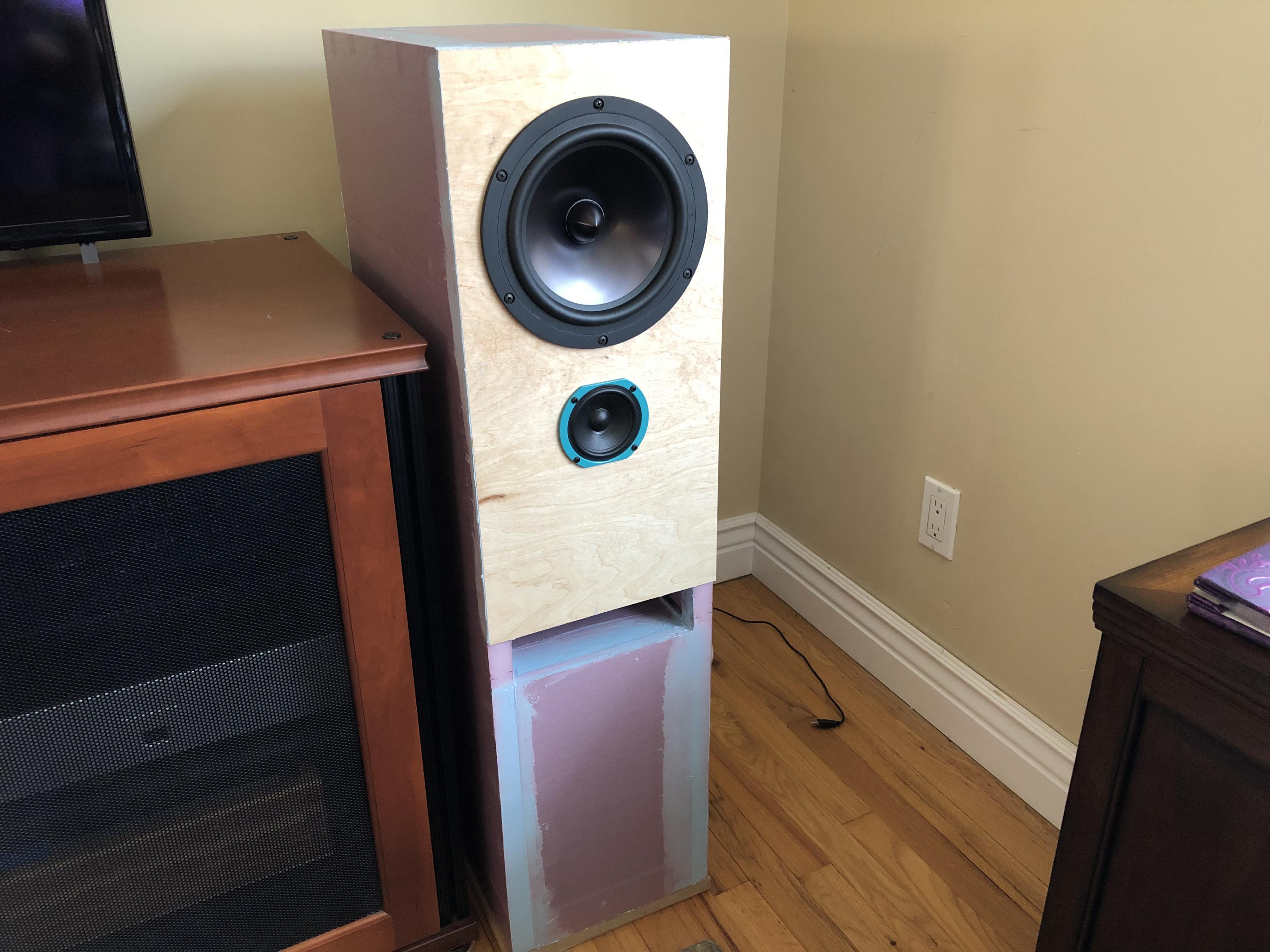

FAST TL’s are Singing!
This journey started as a simple question posed to X, can the 10R/8424 & RS225-8 FAST monitors be made into a floorstander speaker? I’ve never really been satisfied with monitor type speakers unless a subwoofer was present, but this speaker intrigued me. A few days later the FAST TL model was whipped up and posted. So, let’s build a speaker! I don’t want to bore you recapping the XPS foamboard build, but, I will say there were a few details that took longer than anticipated finishing up the interior damping and sealing.
How do they sound?......Fantastic!!!
These FAST TL’s have exceeded my expectations. I am amazed a speaker built from foamboard can sound this good. I move out my Forte’s and placed the FAST TL’s in the same location. They are 2” narrower but 5” deeper than the Fortes. Unfortunately, my living room setup will not allow for optimum distance from boundaries to get ultimate spatial characteristics, but all speakers that I use in this room are placed in the same spot, so all is relative. When listening to music the word ‘snappy’ comes to mind. These speakers have a quick and agile presentation, the “toe tap” feeling is there in spades. The Scanspeak 10F driver is so clear and detailed without being ‘shouty’. Acoustic guitar has the ‘in the room’ realism to it. Even heavy metal with all its inherent distortion and chaos has a refined quality. Percussion work sounds incredible, I like to play Godsmack’s Batalla De Los Tambores when putting new gear through its paces. The sound stage is wide and deep and the impact of the kick drum was seriously powerful.
The TL design has plenty of low frequency reinforcement, no subwoofer needed for music playback. I’m sure with more break in time these speakers will get even better. The FAST TL speakers are definitely a keeper and worthy of a fine wood cabinet..... another project 😉
Thank you X for entertaining my thought and producing an excellent floorstander design!!
Vunce
Vunce

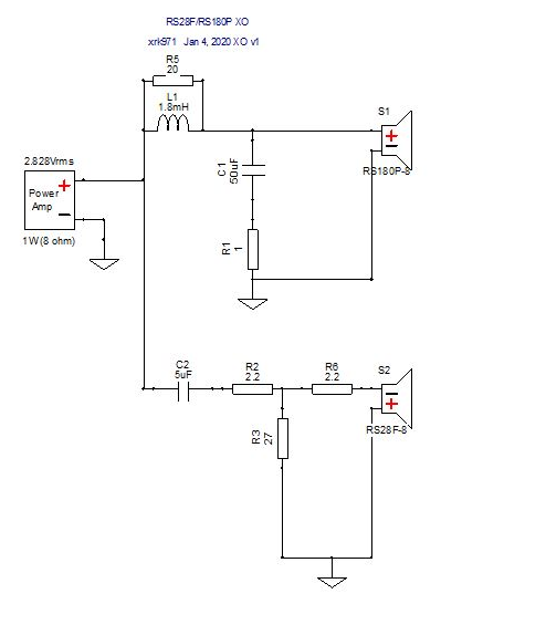

What you are talking about with dual DC160 and DC28 in TL is basically a new design from scratch. The XO is different and the TL is different.
I just made a XO for an RS28F and RS180P last night. It wasn’t too hard but the cabinet was in place already.
RS28F-RS180P-B80 as Hole Filler 3-way
Here are measurements:
I can help you with a sim of the dual DC160’s. You will then build the cabinet install both drivers, measure them and produce FRD data files. You also need to get the ZMA (impedance) sweeps. With these we can design a new crossover. It takes some tools, and lots of reading and practice to get the measurements.
This is what the people in the Multi-way forum do. The basis of multi-way speakers is making the cabinet with educated choices. Then measure, then design passive XO.

Excellent effort on the build! The results look great and I'm glad they sound good. Pictures and The 1000 Words parable is always true. Your work has me full of questions:
1) How does the low end of the FAST TL’s compare to the Forte's?
2) Do you like to use a sub (subs) with the Forte's?
3) Is the structure of the assembled speaker substantial enough to accept the glue-up of exterior 1/4 inch panels (regarding gaining the look of wood while being light weight)? The question goes to X as well.
I'm asking because of having Forte II's in my less-than-ideal living room, and have heard Forte's, so this is a good situation for me to decide on moving forward on FAST TL’s. They check several boxes for me, like TL design, dagger shapes, full range response, etc. The construction has similarities to my house because my walls are built with SIPs, so we live inside dampened panels and the quiet is easily noticeable. I wonder about starting the speaker build with a laminate panel verses laminating the completed foam speaker box like a core.
