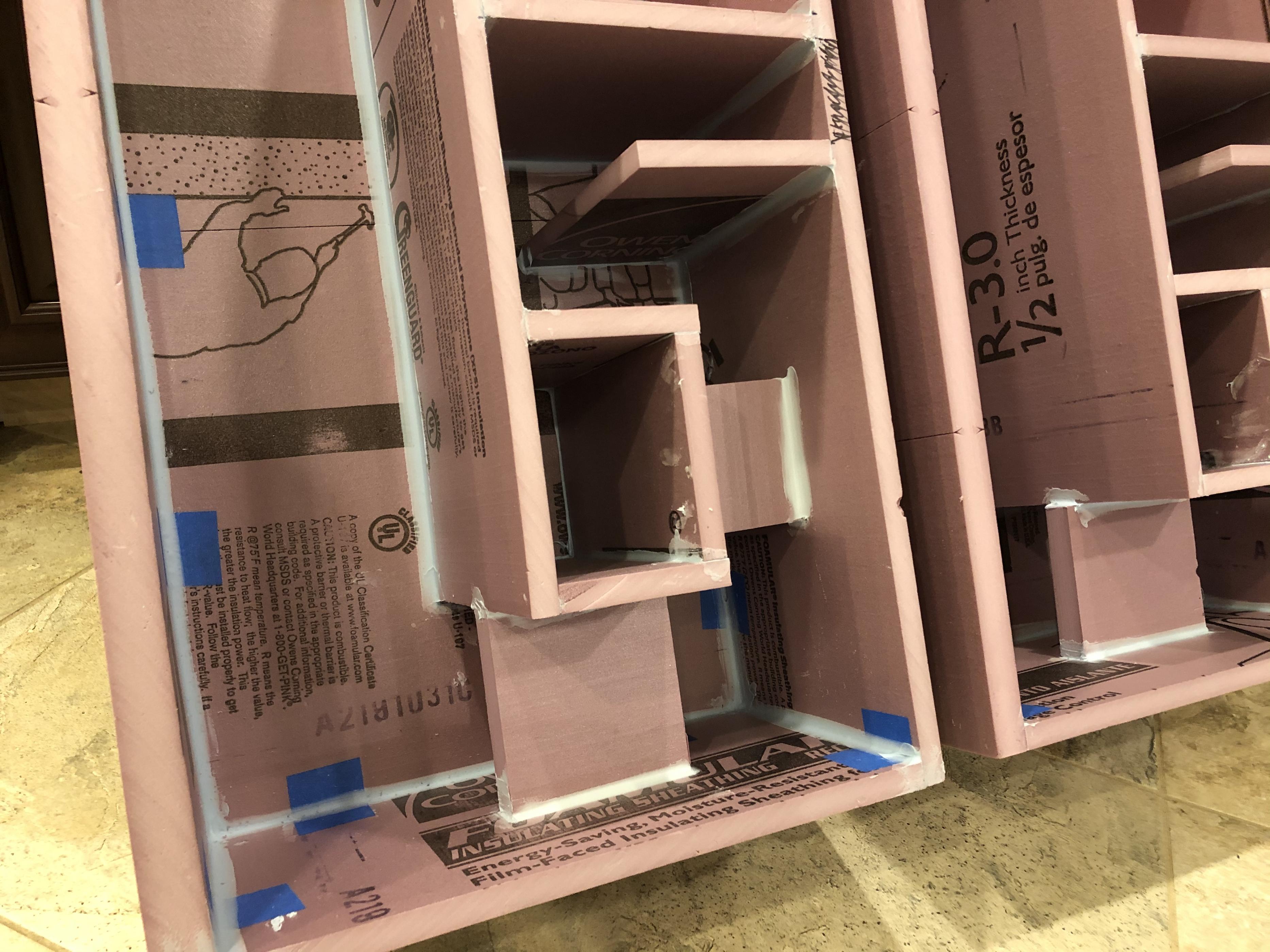

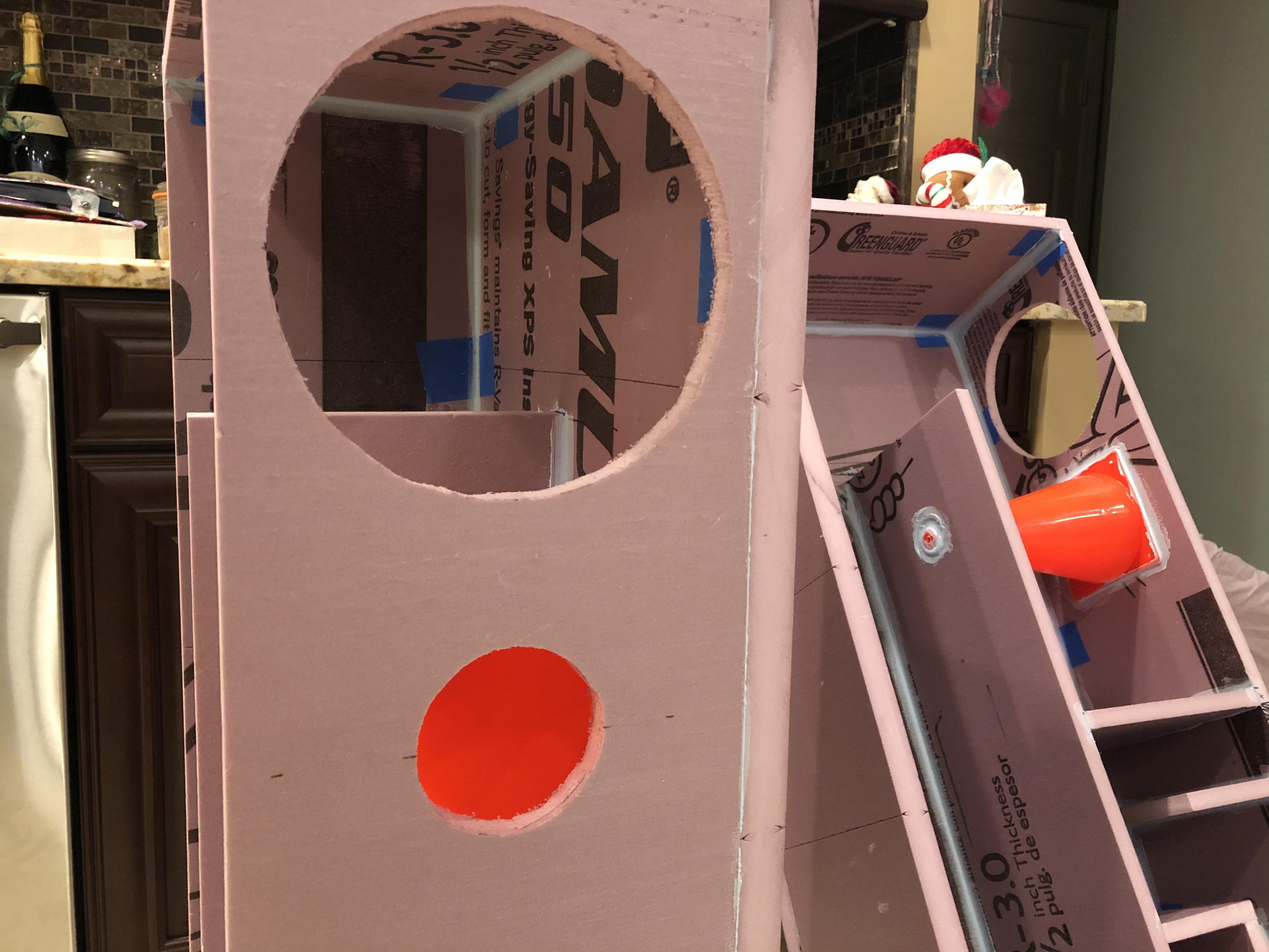

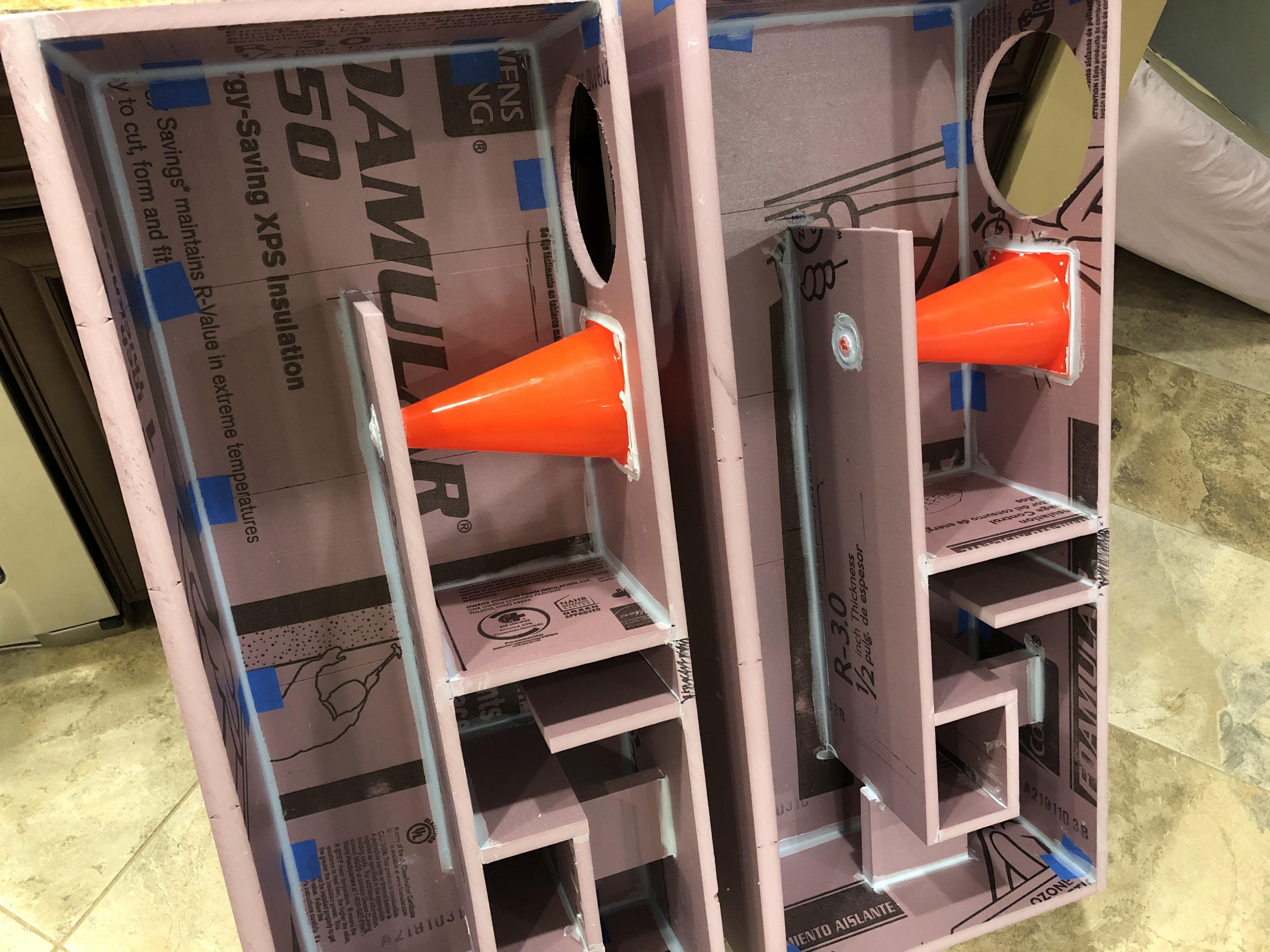

Progress Report
Spent the evening hacking up foam and glueing 🙂
The cones are a great idea X! The 10F/8424 driver has a perfectly sealed chamber, there is a hole drilled in the cone tip to pull the wire through and then it will be siliconed to seal.
X, for this test enclosure, do the drivers have to be flush mounted? Or, can I just drill holes in the plywood and mount them on top?

Nice progress, Vunce! That sports cone looks like it was designed for that singular purpose as the fit is perfect. Did all your drivers and crossover parts arrive?
If you get a chance, I would break in the woofers while they are waiting to be installed. Play some nice deep bass house techno music through them while sitting in the open for a day or two. That will help loosen the suspension. You could wait until they are installed but they will be much louder once in a cabinet.
Great progress though! :cheers:

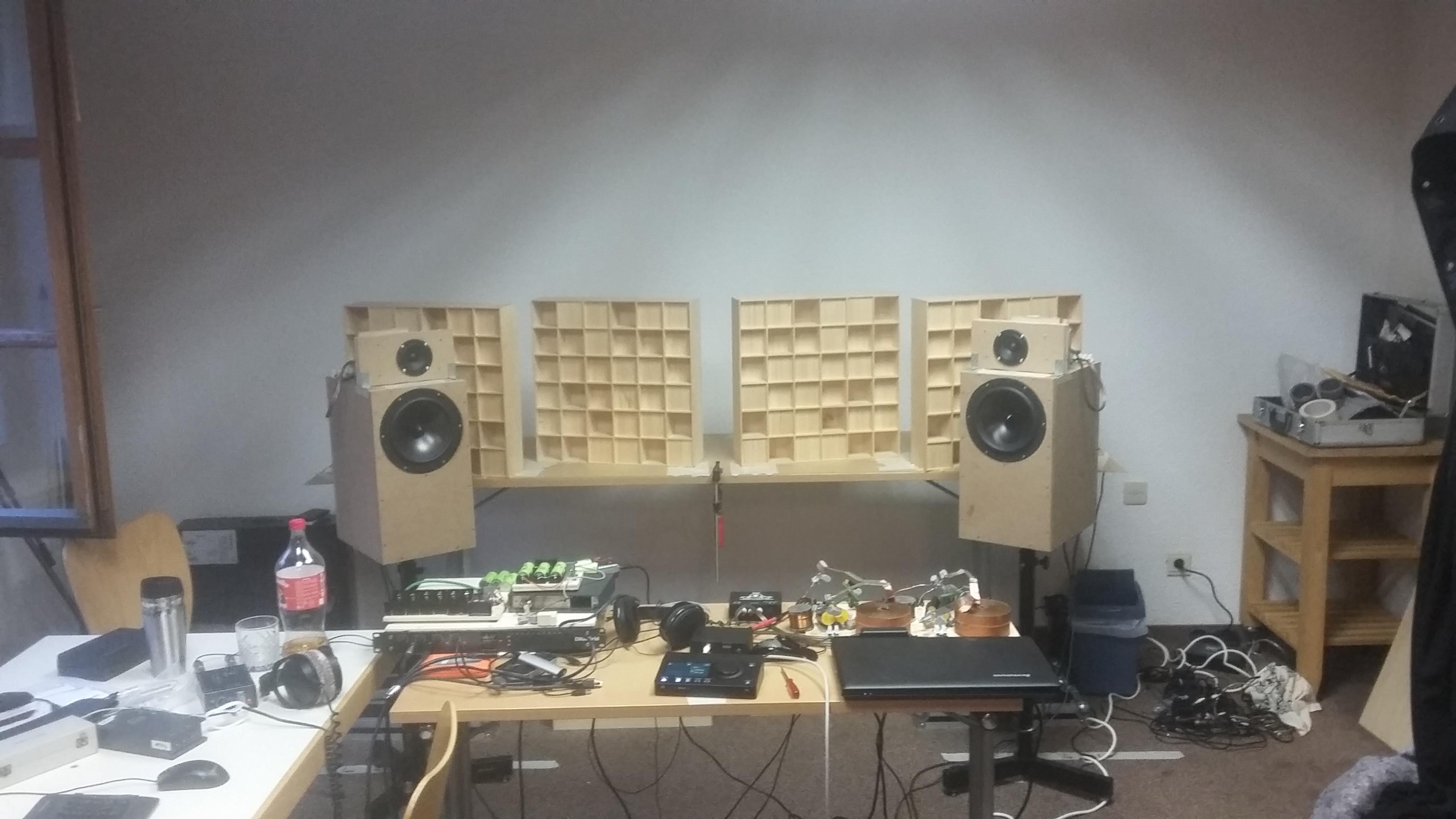

FAST speaker finished
Dear loudspeaker fellows,
I have finished my FAST speakers a couple weeks ago. I have made things a bit different to what XRK has designed it, I would like to share this with you, perhaps it is interesting to you and the project.
The most important thing, that I made different to the original plans, is that have made a physical offset of the fullrange driver. It is 6,75cm, that's 2,66 inch. I have set up the speakers outdoors, and came to this distance by trying and listening, it was a decision by ear, 6,75cm is the distance, when it really sounds "on the spot", when the 3D of the sound picture is right and perfect (most foward part of the drivers to each other). To my ears this offset is very important, you miss quite a lot, when you do not mind.

As you can see in the picture, my dagger is rectangular, and the driver is positioned off center. I have made it of 1,9cm plywood, I regard it as important, to make the dagger massive. Because of the offset position I hope that I have less symmetry and therefor a smoother frequency response. The rectangular shape allows for a minimal distance to the woofer.

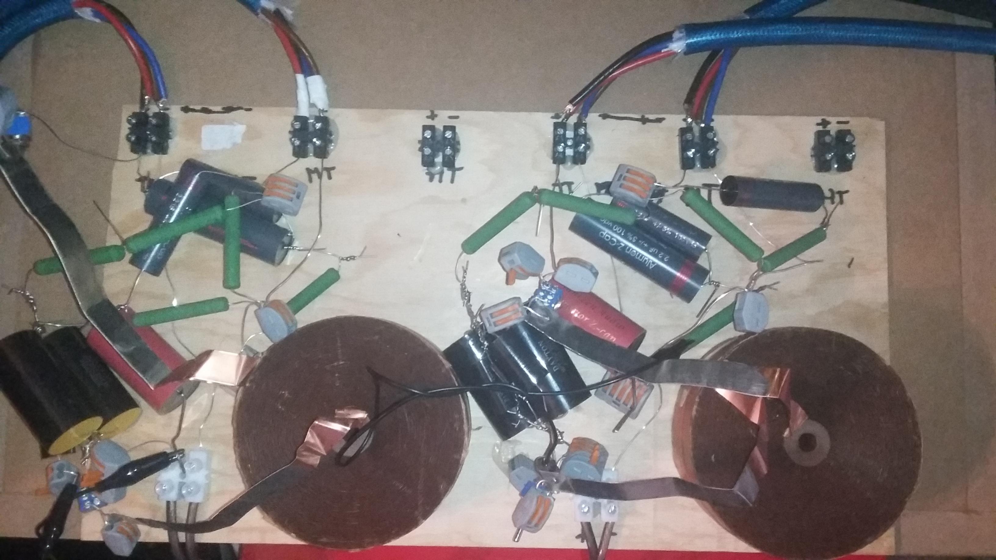

The final thing I made different, is, that I tried a couple of different capacitors and inductors. I have finally ended up with a 125€ inductor from Jantzen Audio, it is a band coil, which is hardened with a special wax. This coil really sounds "high-end", quite a difference to the usual air coil. The sound of the wax band coil is more stable, higher resolution, keener. To my ears it is worth the 100€ extra money, concerning the other money, you have to spend for the speakers.
The Dayton Audio Capacitors are really great capacitors, I very much like the neutral, musical sound. But there are capacitors, which have quite more resolution. In my setup I have got Jantzen Audio Alumen Z Caps for the small values, and a Jantzen Superior Z (3,9µF) as a bypass for the in sum 61µF big cap. I did not like the Alumen Z here. With the Superior Z Cap resolution is higher than with Dayton Audio only, but it does not sound that coherent any more, as compared to Dayton Audio only. My recommendation: If you want to enjoy music, go for the Daytons, if you need very good studio monitors, go for a Superior Z, perhaps it is worth to go for 61µF Superior Z - that I have not tried yet.
Thank you XRK, for sharing these are really awesome speakers with us! I have now got to know a transient perfect speaker, I now know about what it means, if a speaker has got a right step response, and I really do not want to go back to any other speaker any more, which is not transient perfect. I will keep looking for similar speakers, as I would like to spend more money on even better quality one day, what makes this speaker definitely not my last speakers, is, that the resolution of the treble is not the resolution of a real tweeter or ribbon tweeter. But after all, it is a really good speaker. I have also tried the Visaton B80 instead of the Scan Speak - but those drives (Visaton + Dayton) do not match, to my ears the Scanspeak matches perfectly with the Dayton. A very good combination, well done. - Thank you!
Florian

Hi Florian,
I love what you did! Outstanding!!! To put the due diligence to test the tweeter setback by ear, outdoors with a ruler. Nice.
Also not surprised that a premium flat copper ribbon inductor sounds better. One thing we could try is a thicker gauge wire air core. Thank you for trying the speaker with all your heart and means. It’s reassuring to know basic budget MKP caps from Dayton work well. I might try bypassing the 61uF with 0.022uF copper in oil like Maty recommends or at least try a metallized polycarbonate film one that Vunce provided me. Those sound as goo, if not better than more expensive Mundorf EVO aluminum in oil caps.
Thank you for the effort and for the kind words. I sometimes get a bit evangelical about how important a good step response is - but now you know, it is all worth it!
