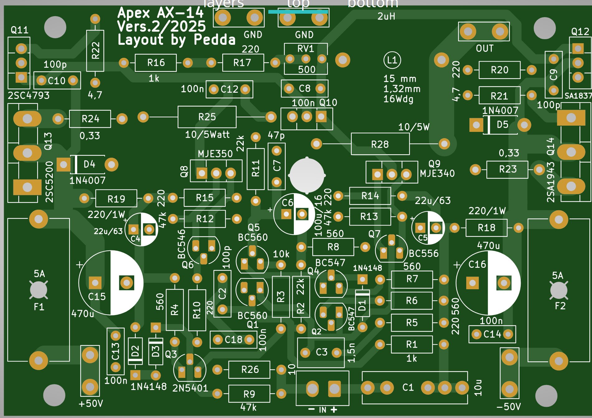

Hi, i have seen that there is a new mistake. As i have updated to the new pcb with other pinouts, KiCad had changed back my mod for the coil. I have corrected that...
the AX14 seems to be not my friend...
Please use this gerberfile to order...
Two mistakes on the pcb are awful....

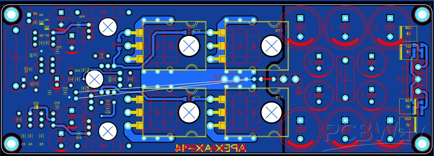

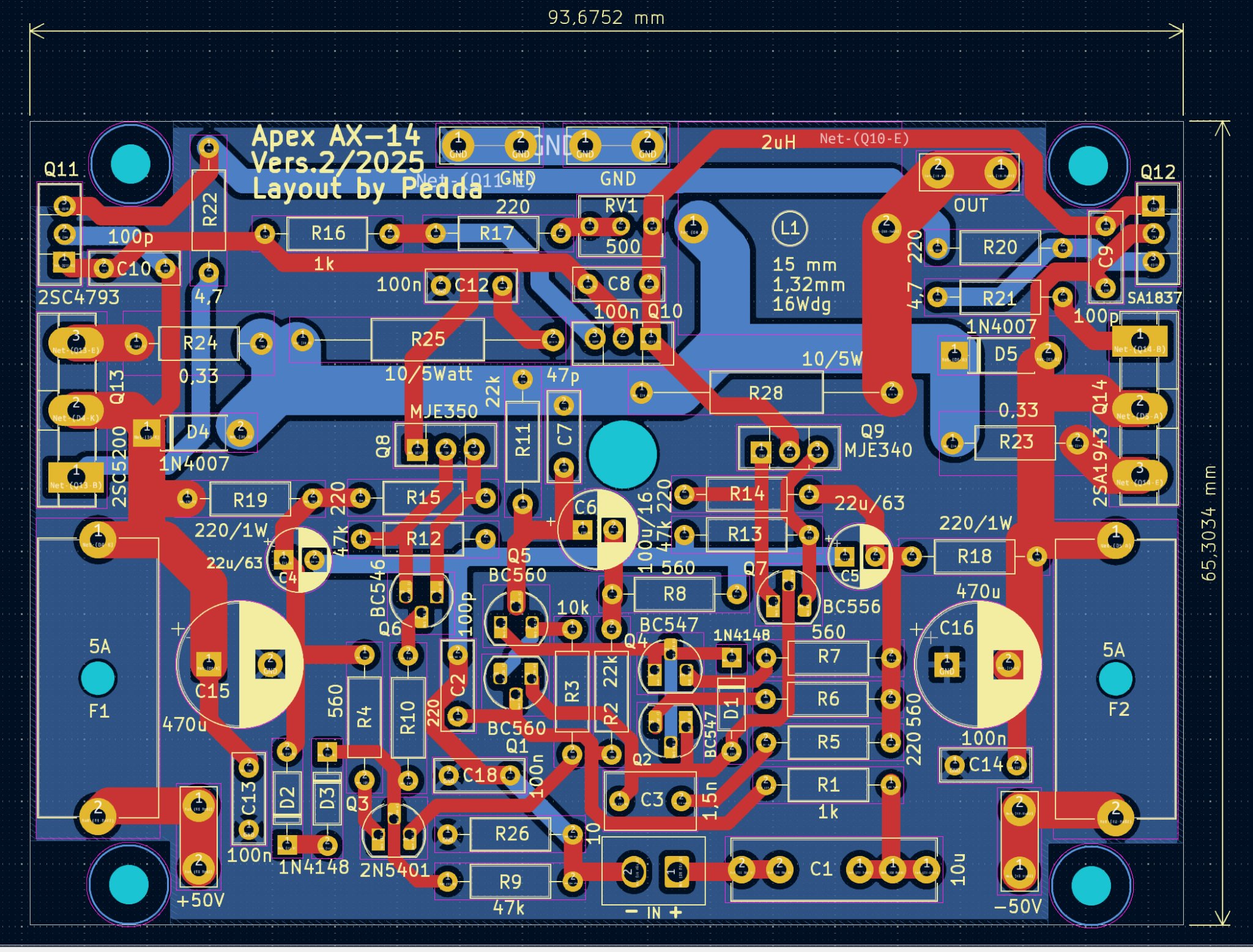

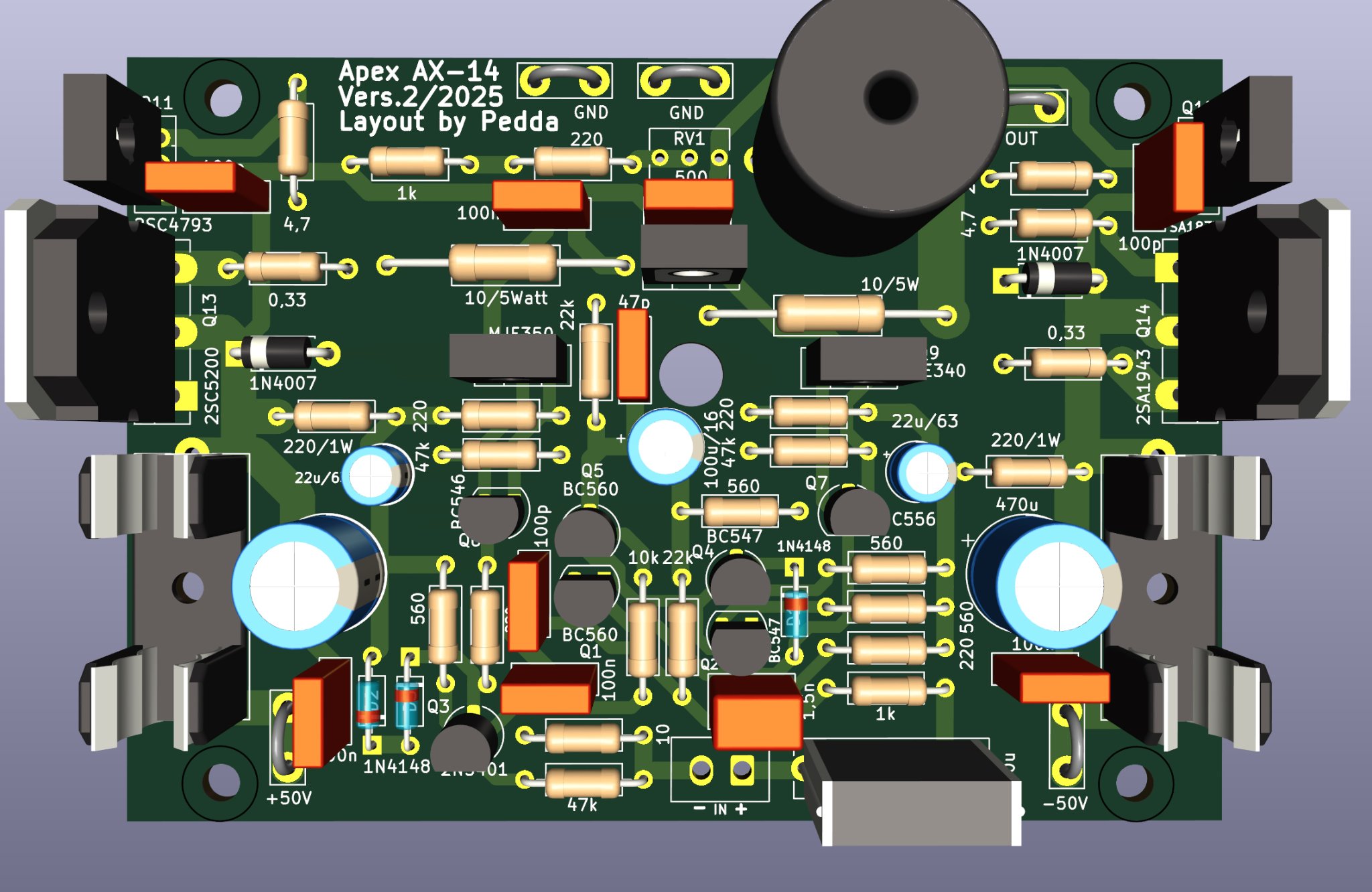

i have desigend a new pcb for the AX14. Perhaps you like it more. The new pcb has more length, less hight, for smaller enclosures with less highness. The boom, and schematic and values are surely the same. Now two versions are available and i hope both pcb will work...
Perhaps i will make a pcb for the mosfet version too...will take time....

You can order the manufacture of boards, size 62х177мм.

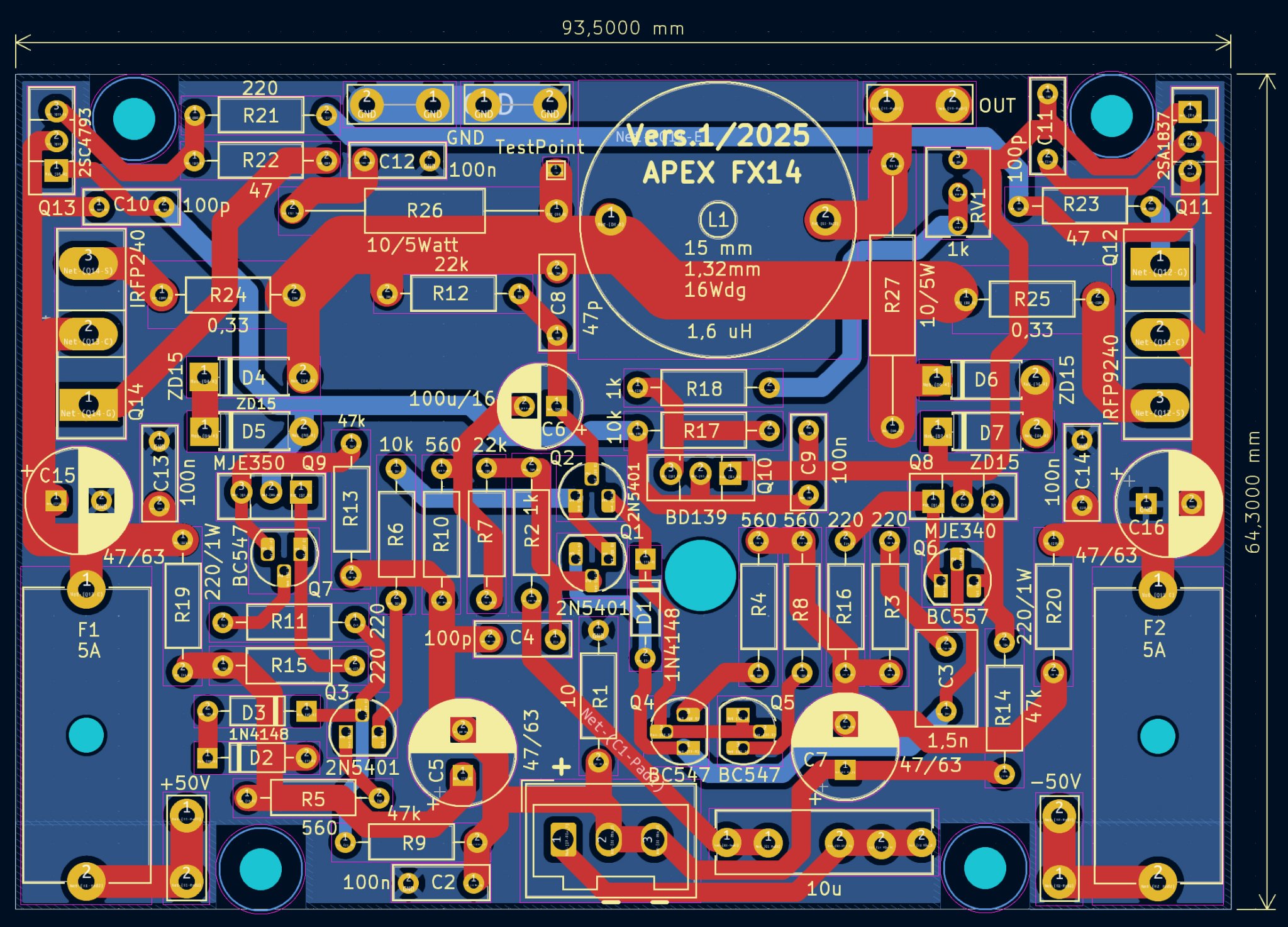

awfully i found another mistake on my AX14 pcb's. That is extremely annoying because i dont know the reason. Yesterday afternoon and in this morning i made a new pcb for the Apex FX14. At last i controlled all transistor pinouts. Found out that the pinout of the MJE 350 is not correct. I wonder why and dont know the reason for this mistake. The pinout for the MJE 340 is correct (wtf).
As i registered this i took a look to the AX14 pcb and had to see that there is the same mistake on it. A solution is to solder little wires to the MJE 350 pins and twist the pins 2 and 3 in the right way, possible because the MJE 350 dos not need a heatsink. It is not possible to turn only. Pin 1 is on the same place.

here with the corrected MJE350.
I have a zip file for the FX14 too. Glad to make it because i found the mistake on the AX14 pcb.
I hope there is no mistake on the pcb. If someone has an idea to make something better tell me...

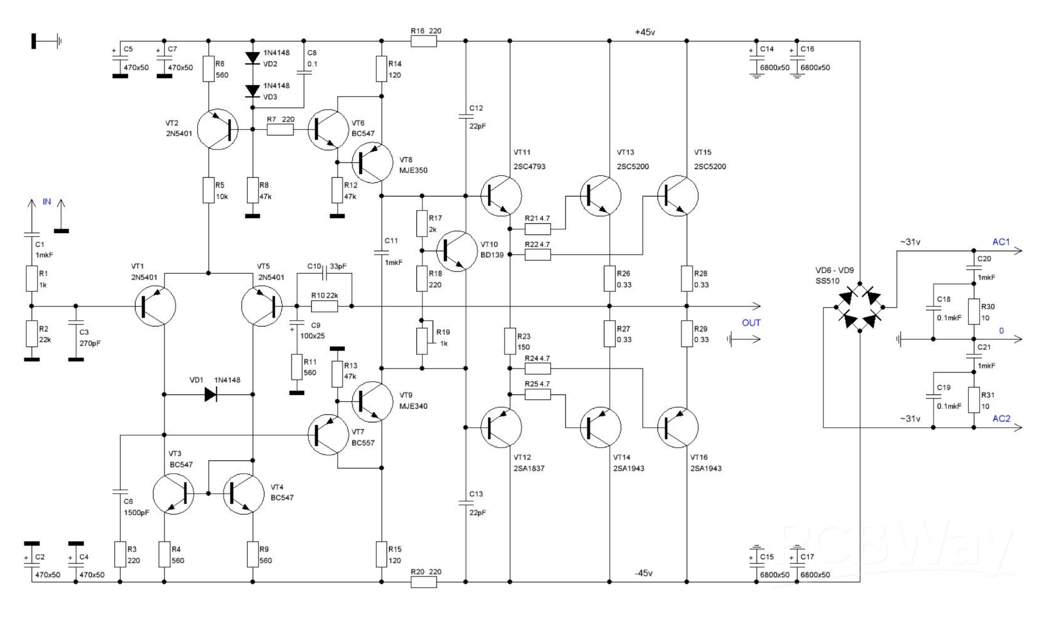

Do some one know which is the last, right schematic ? I had made a pcb, but awful if something is wrong...
My schematic has only one output pair 2SC/2SA. I will compare with the schematic shown in post 14.439 shown with mine. I think there are a few different values.
