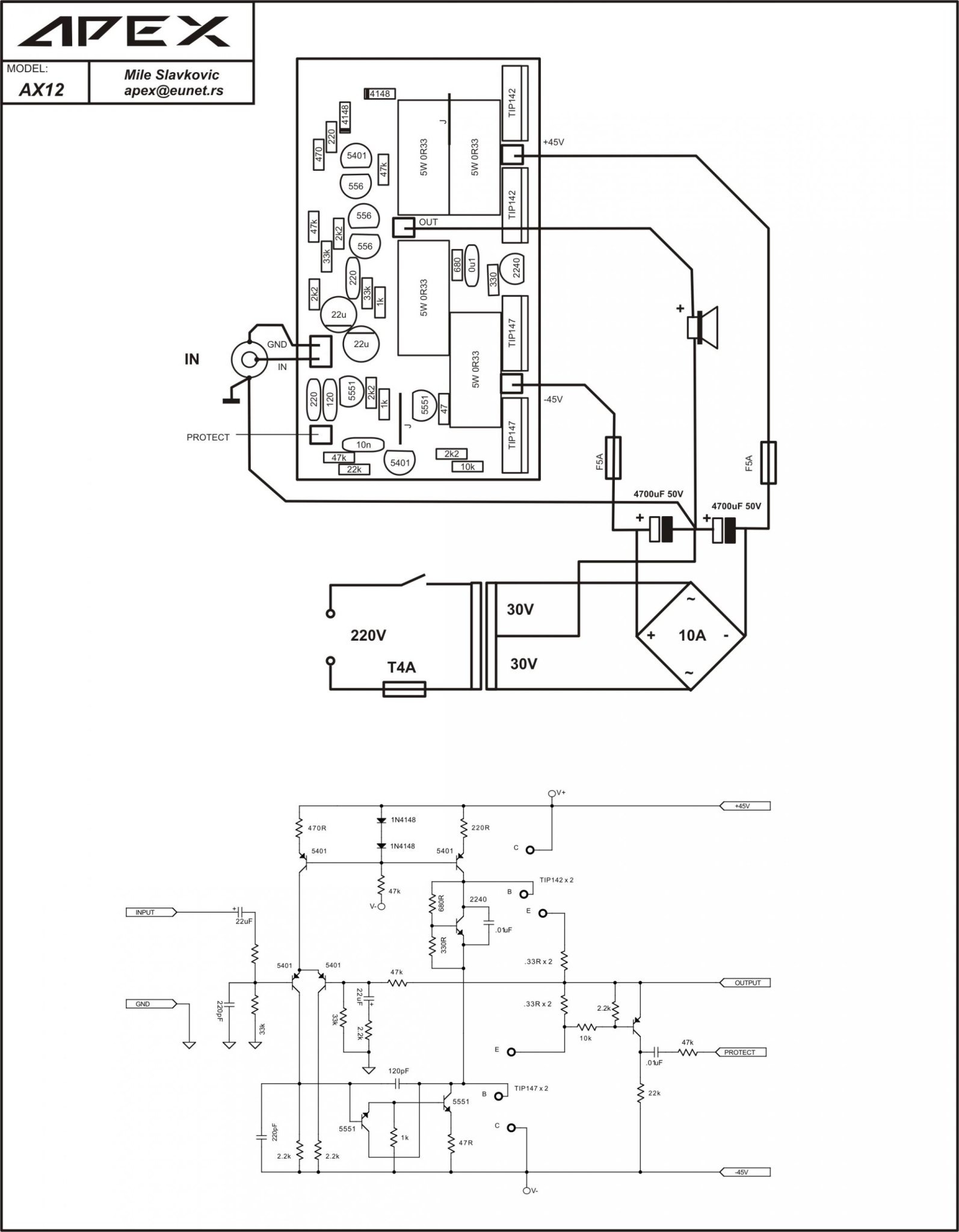

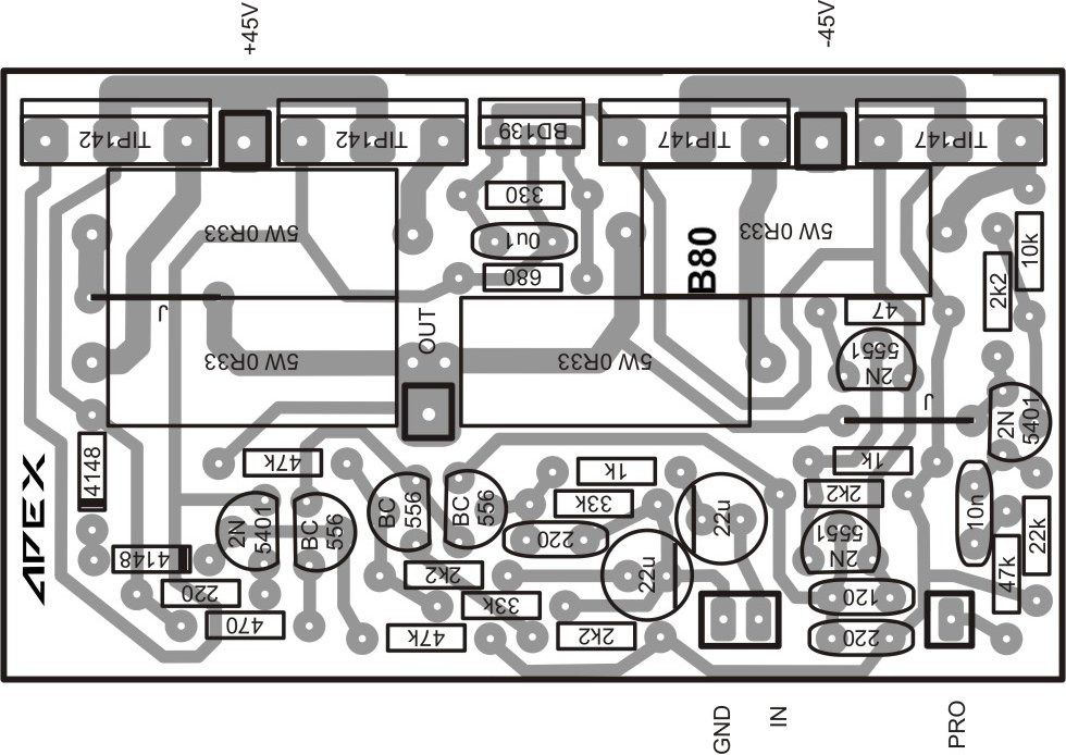

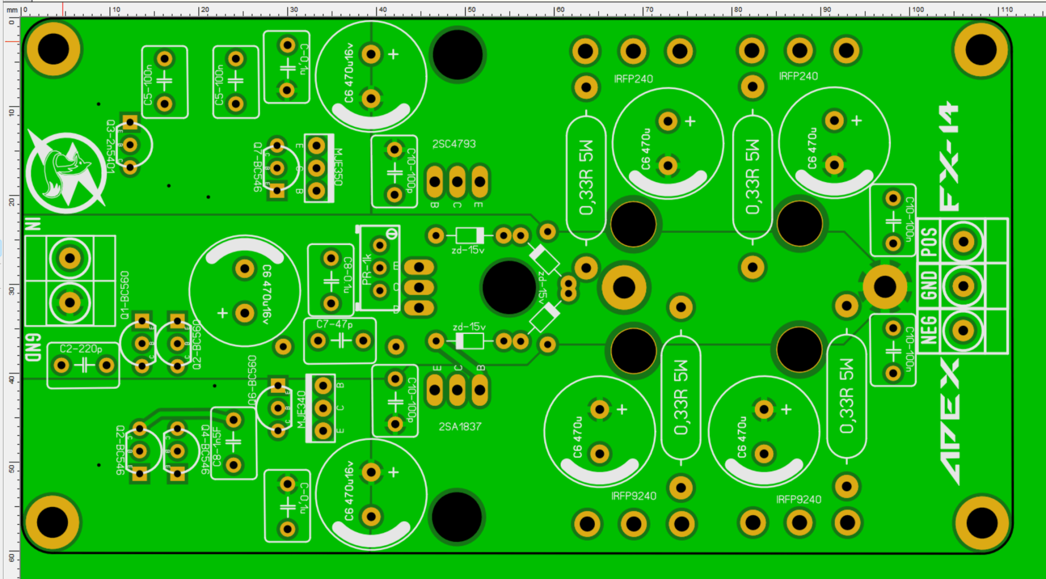

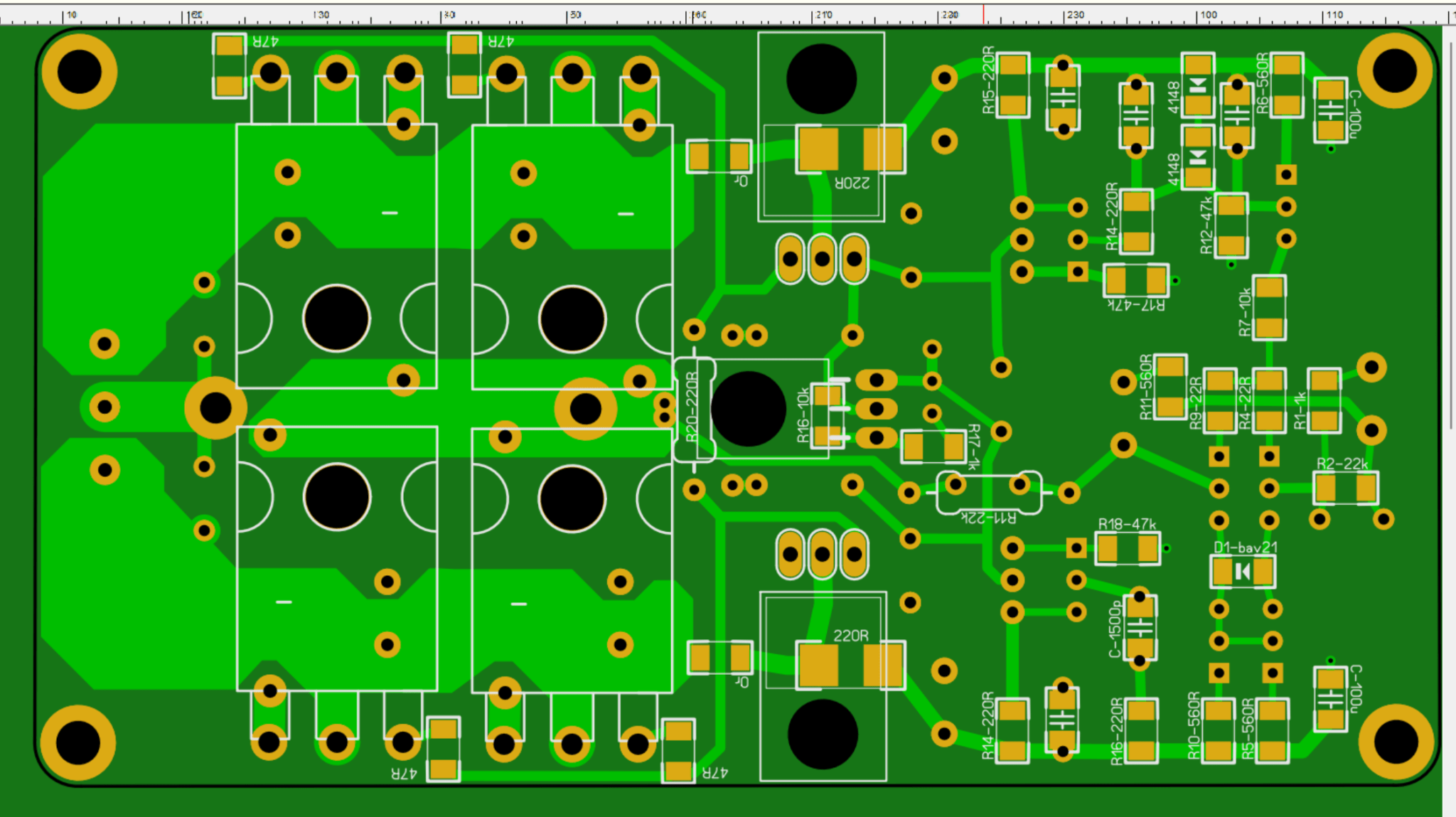

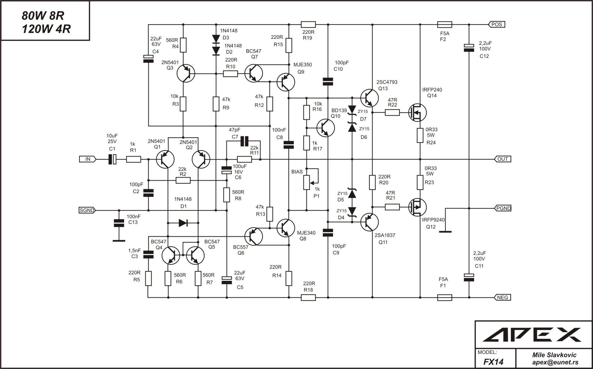

is this correct PCB and schematic for this type apex amp?
any one create this before?

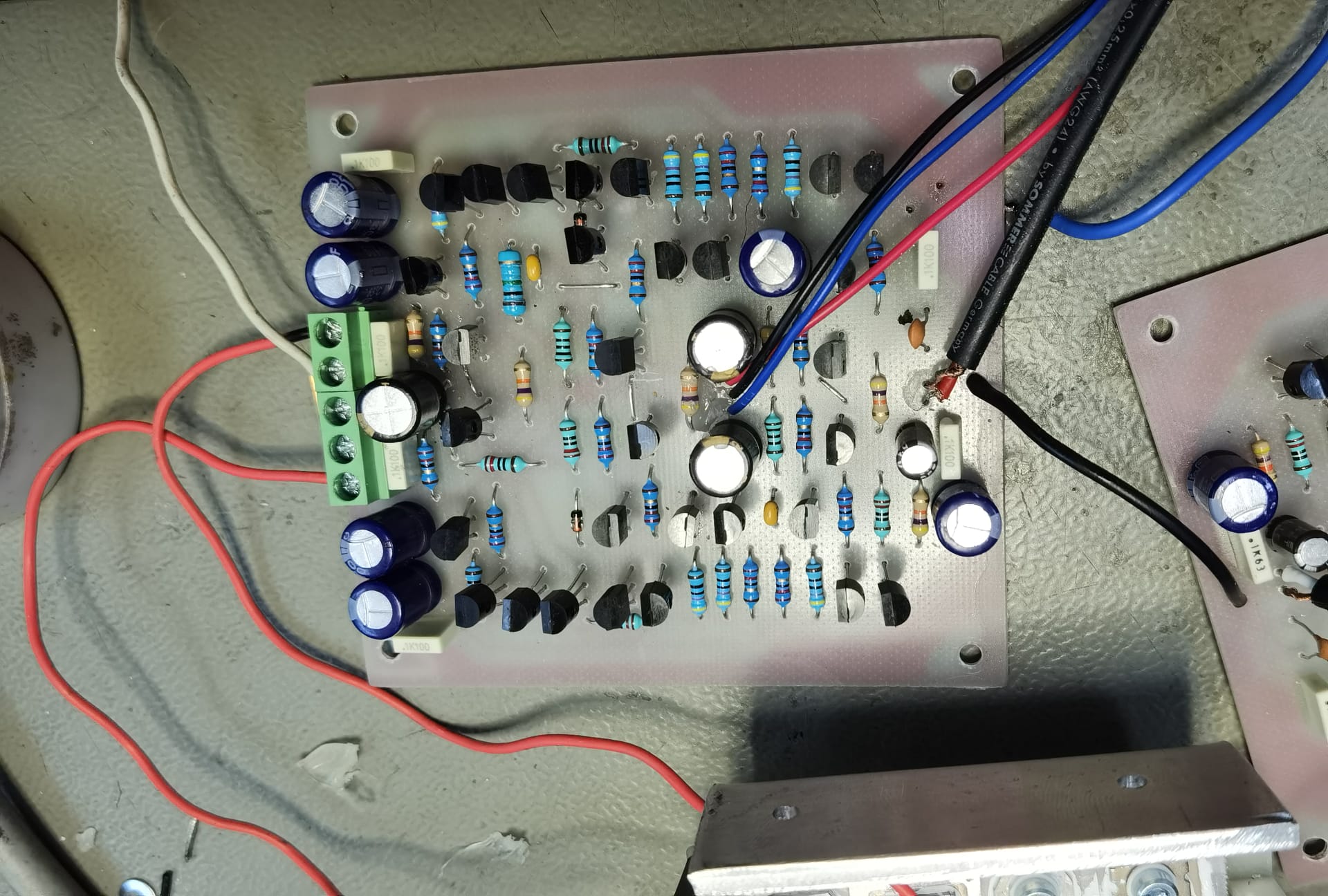

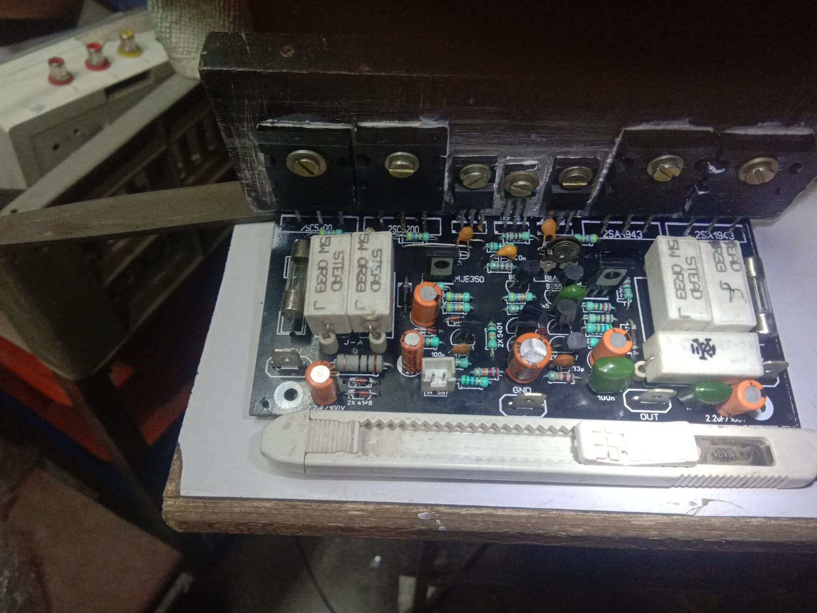

today i checked my first build of Apex ax-14
here is video ..having some issue want to discuss with you sir @apexaudio
Check the Transistor Orientation and valur same happend with me when i made apex ax-14 later it worked fineI have build NX14 and testing with 41VDC . But its outputs DC 38V.

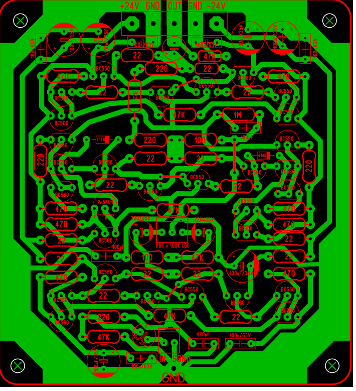

Hi all,
I wanted to make the TB3 tone control schematic used by Marantz and I saw in #13.460-13.548-13557
the schematics and pcb layout, are the schematics and pcb correct?
Can I start the implementation without problems using NE5532 as opamp?

Hi Mira1,
then can I easily build the TB3 tone control using the NE5532 as OpAmp without problems?
thanks,
Marco
thanks,
Marco
Hi, yes! You do use it and when you do would read about of OP AMP, here is link: https://www.diyaudio.com/community/threads/tl072-vs-ne5532.253155/page-2

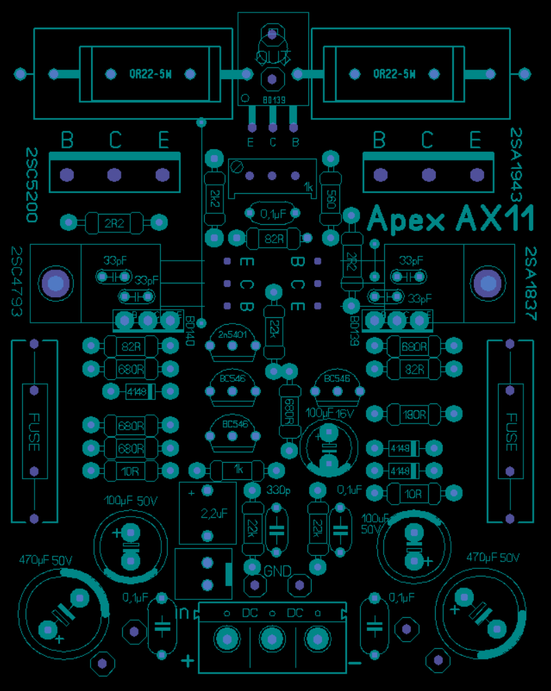

I want made it
But how much is bias qurent for each bwd transistor?
1.2 amper for all bdw93 rail and bdw94 too?
Or for each power transistor is 1.2A?
I see video in youtub..but i can finde this
please use the other thread:
i don´t build it but if you do the math it makes more sense to use overall (for all = per rail) 1,2A @ 30V rail.😉

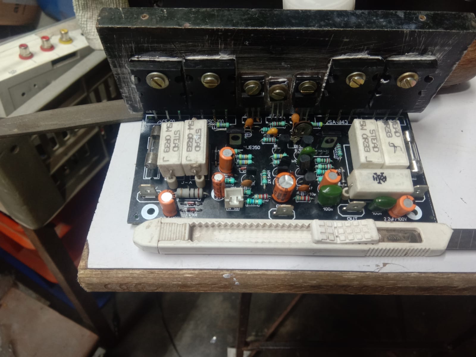

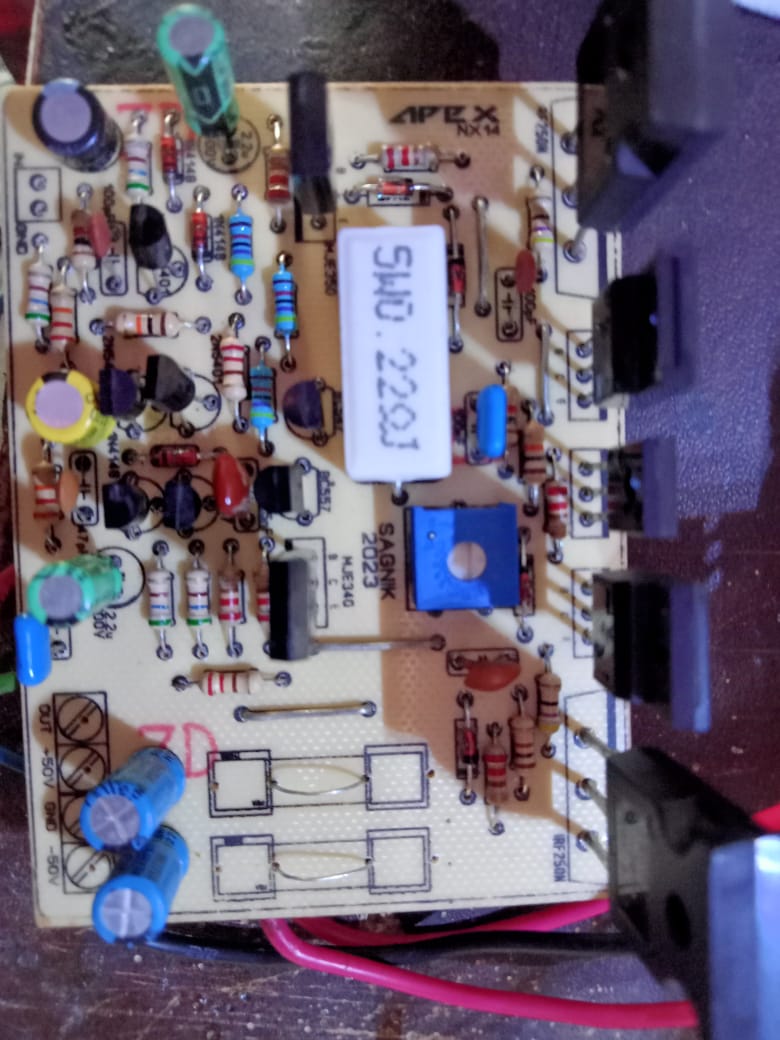

Hello ! After long troubleshooting of the P30 circuit, I managed to make it semi-functional. The pcb I used had the 2n5551 inverted. The problem now is that I have a font noise that I don't know how to get rid of it. Do you have any ideas?
