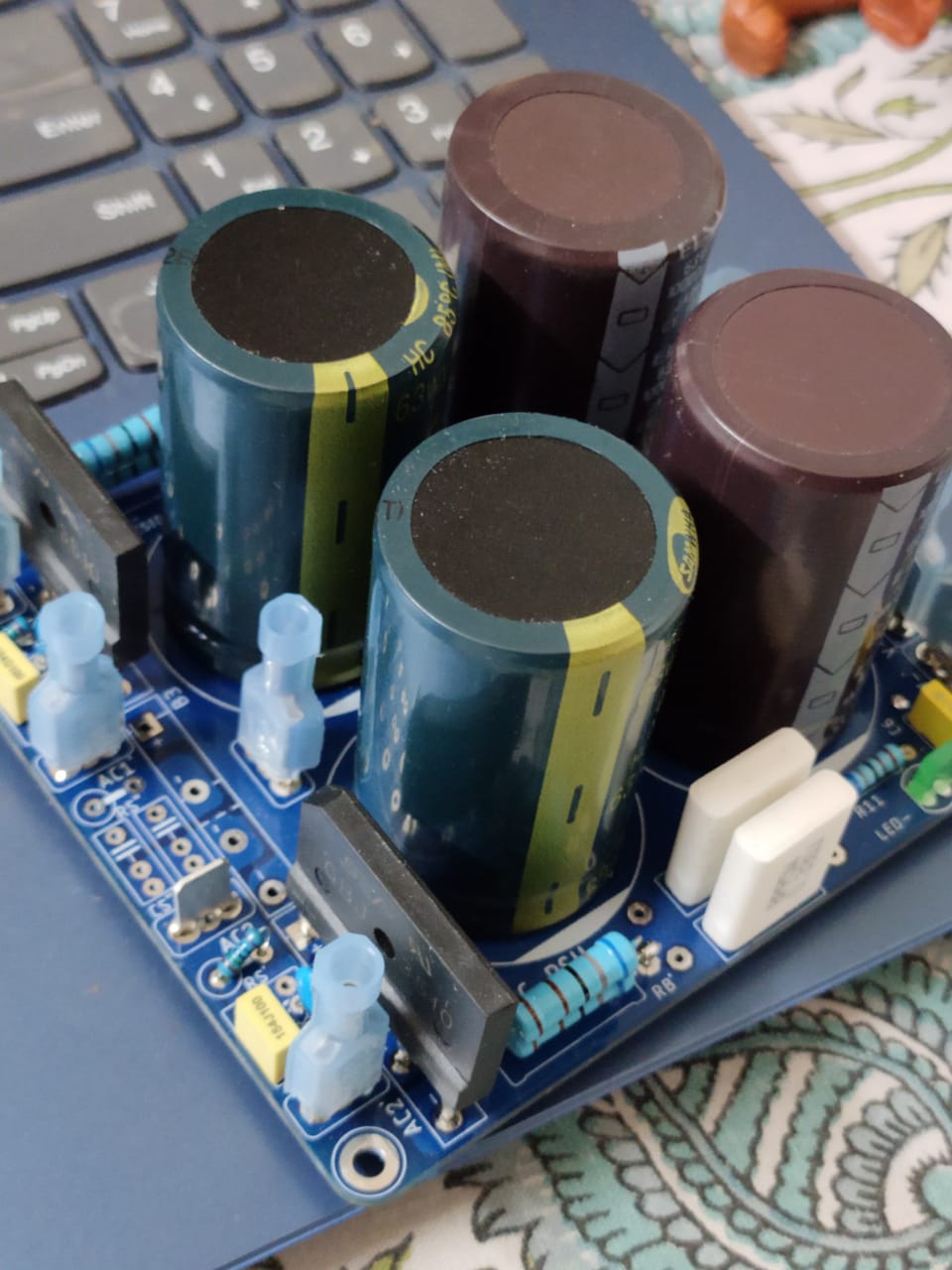

@Prasi, any idea if we need to put the aluminium strip with screws on the GBJ3510 bridge rectifiers on the Compact CRC psu boards for heat dissipation if we are going to use a transformer rated 30 to 35v secondary with 5A to 8.5A current on each secondary with a total 300-600VA?
Yes, it would especially if operating at higher loads continuously.
For home listening at normal level you can get by without the sink.
If you have a simple infrared thermometer gun, monitor the temperature, if it goes beyond 70 deg at normal levels, best to sink it.
simple solution is take a plain 30mm wide , 1 mm thick Al sheet of 80-100 mm and bend it around a plywood similar to following

Remember, at 4 ohm loads at full power (and with pure sine waves), your rectifier may dissipate as high as 8-9 W of power.
=1.2V*7Amps.
But rarely is the case with music and also rail due to sag, dissipation will be lower.

I do not have any 4 ohm speaker so I should be fine and also I don't listen at high volumes. I use the audio nirvana 8" full rangers which are like 96db sensitive 8 ohms nominal.

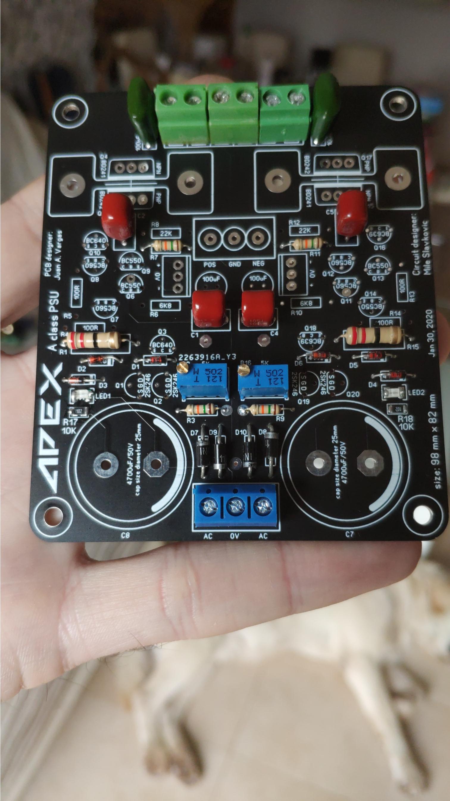

I'm really sad that I can't order PCB from JLCPB but a friend I send the gerbers to him and he is putting together the Apex P30 and Apex Class A PSU layout I did a few months ago looks great I hope all goes well on his build

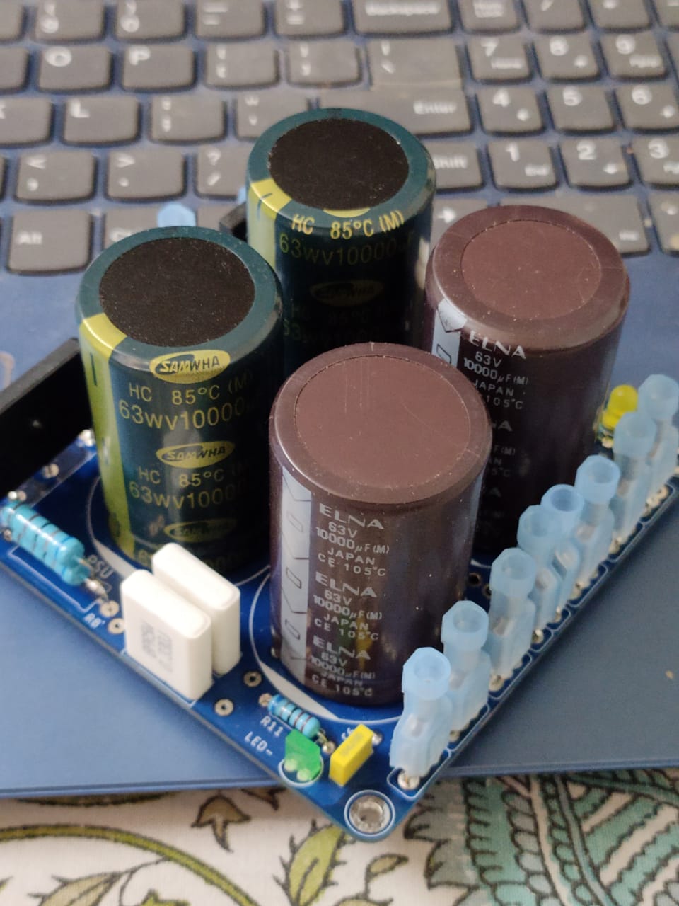

here is how i built mine.
caps are 10000uf, 63V. will be using it for Apex fx-8 bimo mod amplifier.

Well, regarding psu, everything fits and works , i get +/-34.5V from 25V transformer with dual 5 amp secondaries(total 250VA) .
since there are no thermal reliefs (purposely), soldering is a two step process with a 60W iron. First heat the joint with little solder then wait for 2-3 sec and then start feeding the wire.
