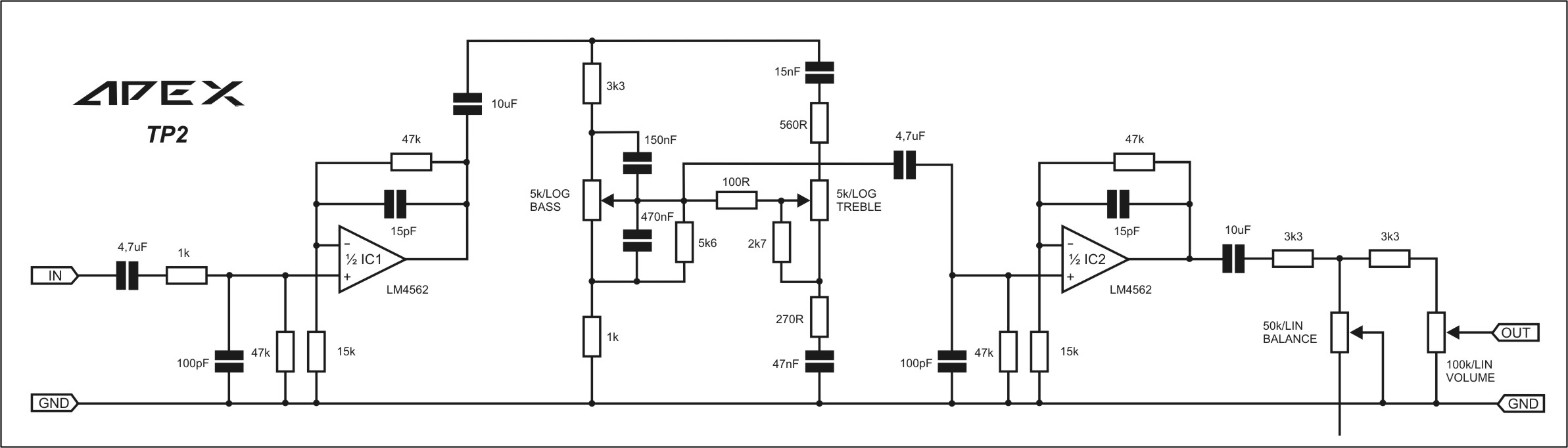

P30 preamp, volume pot help
Hi Mr. Mile,
As per the P30 scheme volume pot is 100K. Is that a LOG or LIN pot?
Also, I do have a 10K LOG pot, shall I use it with P30 without any modifications to the scheme?
I have added NE5532 based preamp and TB3 to my A40, but the results were not satisfactory, sounds like the preamp degrades the audio. So I am planning to make P30.
Thank you.
Sha
Hi Mr. Mile,
Thank you.
Sha
You can use 10K LOG pot with P30 without any modifications to the scheme.
