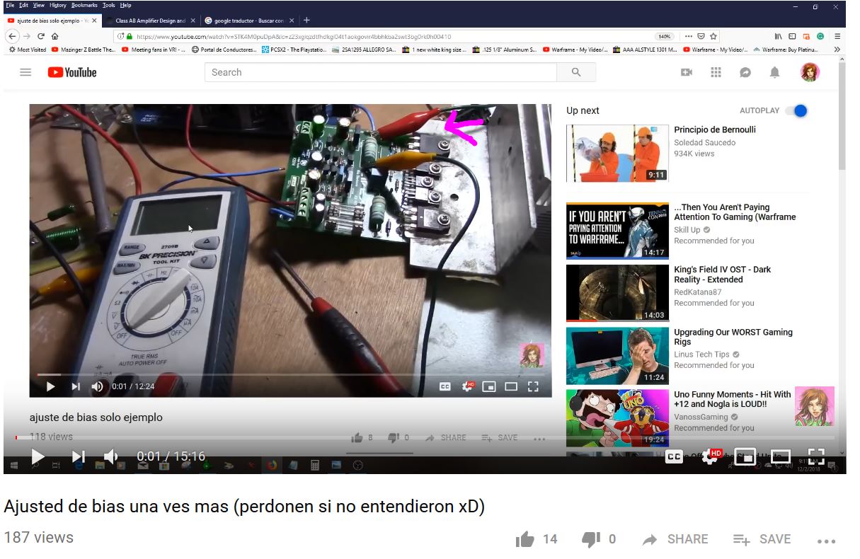

sorry bro I'm in Puerto Rico maybe the local time for the more experience guys are sleeping xD try later :) if you mean bias is too easy just measure voltage across any emitter resistor and adjust to 23.5mV to 26mV offset is low I measure one of mine and it was 15mV of offset that is pretty good for me that was a long time ago :p
