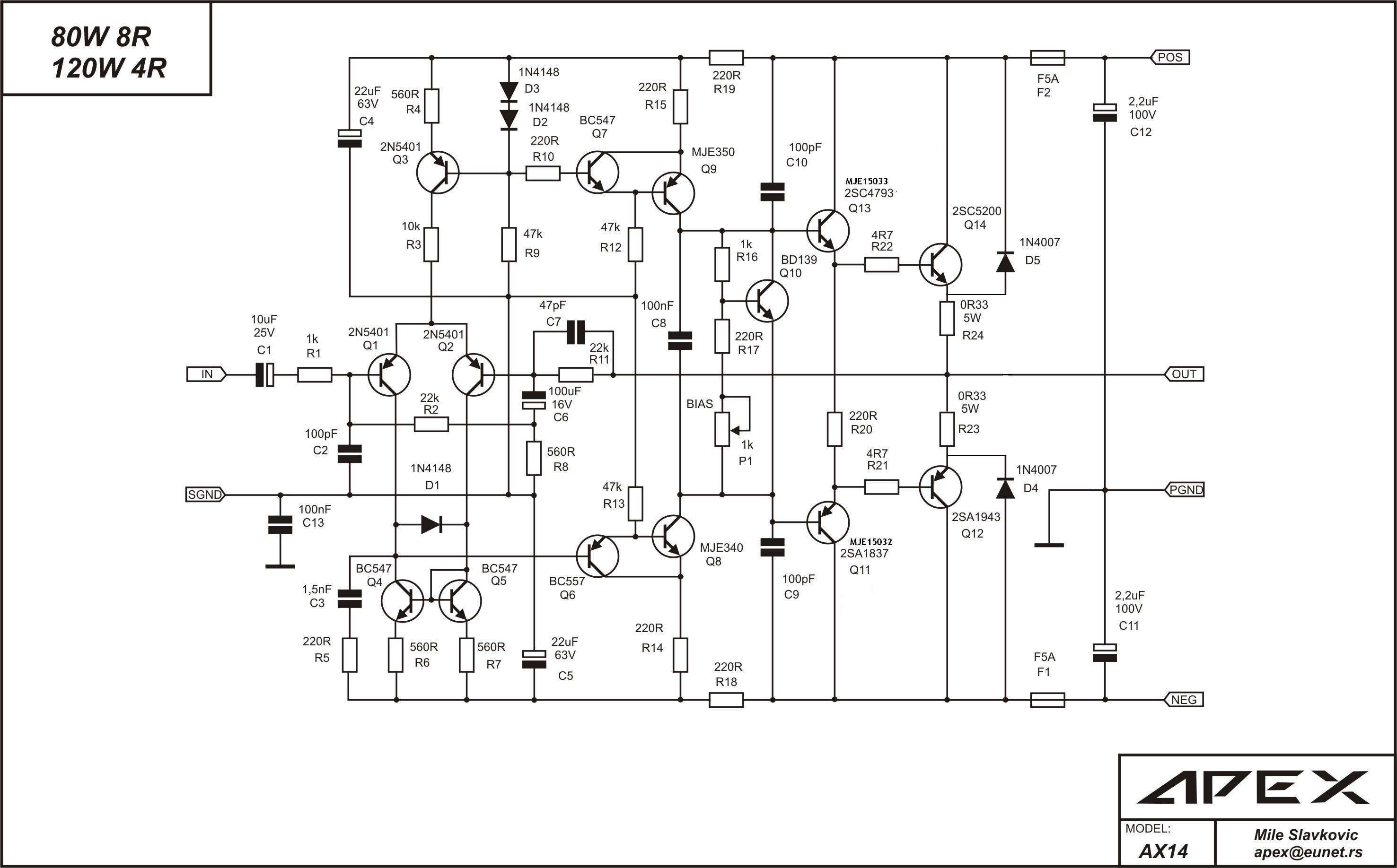

Help if required someone About AX-14

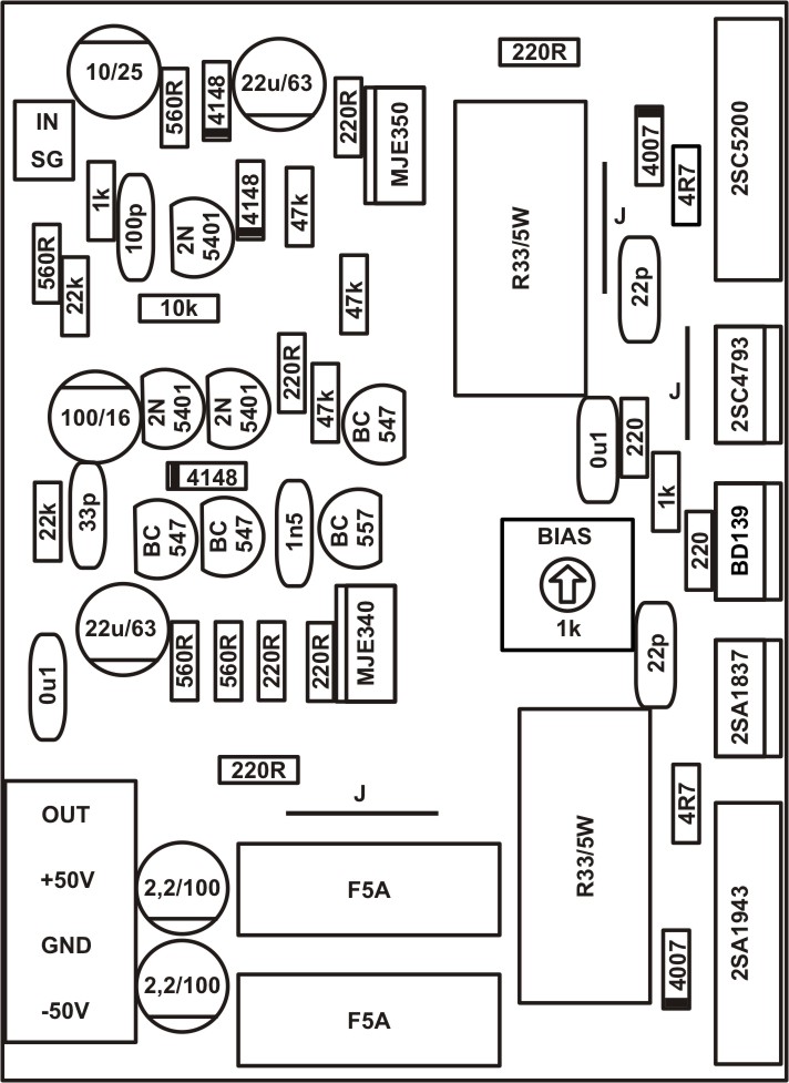

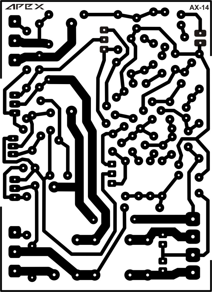

Hello DIYers
I am posting some information about building AX-14 Amp.I attach schematics, PCB bottom layout and top with a component orientation which I use during building this amp.I am using one pair semantics.Use these schematics if you want only one pair of an output transistor.
For biasing connect
Input GND to PSU GND and short an input signal to GND
DC offset voltage must be in mV
use 10R/10W resistor instead of fuses.
if you want to have a bias of 50mA...
V=IR; ohm law
V=50mA*0.33Ohm
V=16.5mvolts
Place your DMM negative probe to GND. and Positive to R33/5W or Emitter of 2SC5200/2SA1943 and adjust 1K trimmer to 15mV DC.
as per suggestion, the bias is between 15mV to 20mV (50mA to 60mA bias).
if you have trouble setting the bias, you may need to change R16 from 1k to 1.5k.
if you have an unstable bias, you may need to install Zobel network on output, that connects output and ground with 4.7R/2W resistor in series with a 100nF/100V capacitor
Replacement for transistor
2SA1478/2SC3788, or 2SB649 and 2SD669... can be used instead MJE340/MJE350, a replacement for 2SC4793 AND 2SA1837 is 2SA1306/2SC3298
2SC2336/2SA1006 can be used as drivers for AX-14.
2SC2922/2SA1216 can be used for AX-14 without changing anything.
And please read the thread for more information If you want to success AX-14 amp without much trouble.
Best regards

No, that is not the correct way to measure bias. Bias is measured "across" emitter resistor. + or red Probe to emitter side of the resistor and - or black probe of DMM to "speaker out" side of the resistor. It should measure the voltage drop across emitter resIstor and hence the current flowing through it.
Unless you want to convey something else, which I am not able to understand.😉
