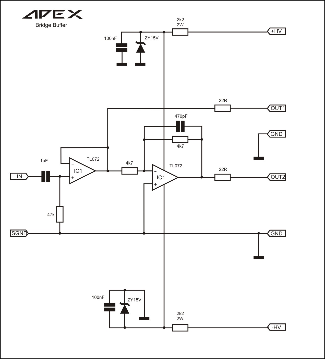

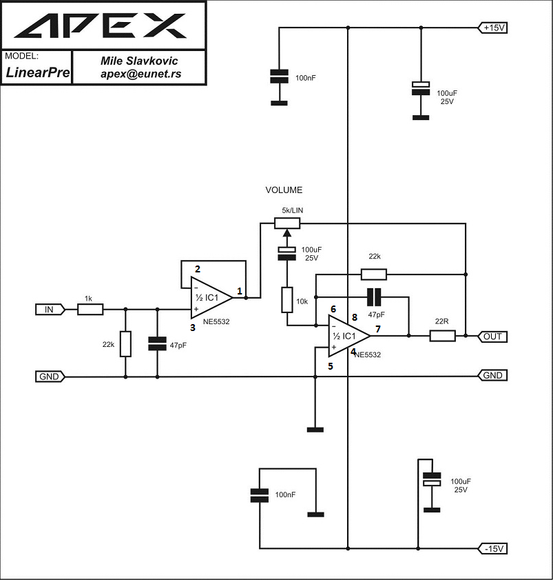

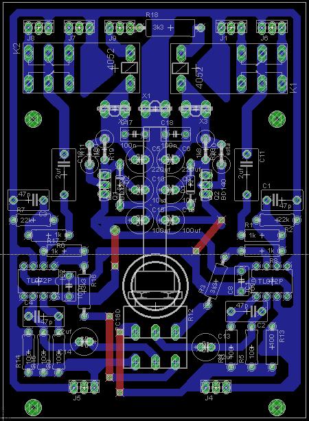

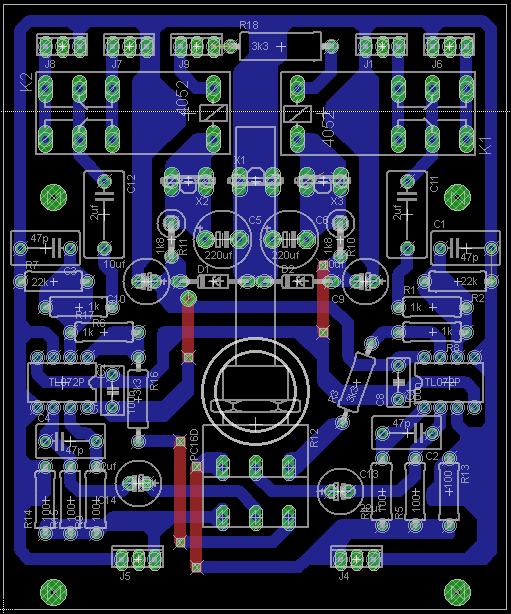

hello, Im try to do the Apex preamplifier.
Do you think is enought a zener to reduce the tensión to 15v or its better to use transistors?
Thanks in advance.
The two first pictures are my pcb, with zener and transistors. (not finished)
The others are the preamplifier and a example what i mean when i say reduce the tension with zener (the supply of bridge).

Yes you can use zeners for this preamp, nice pcb.
Regards
