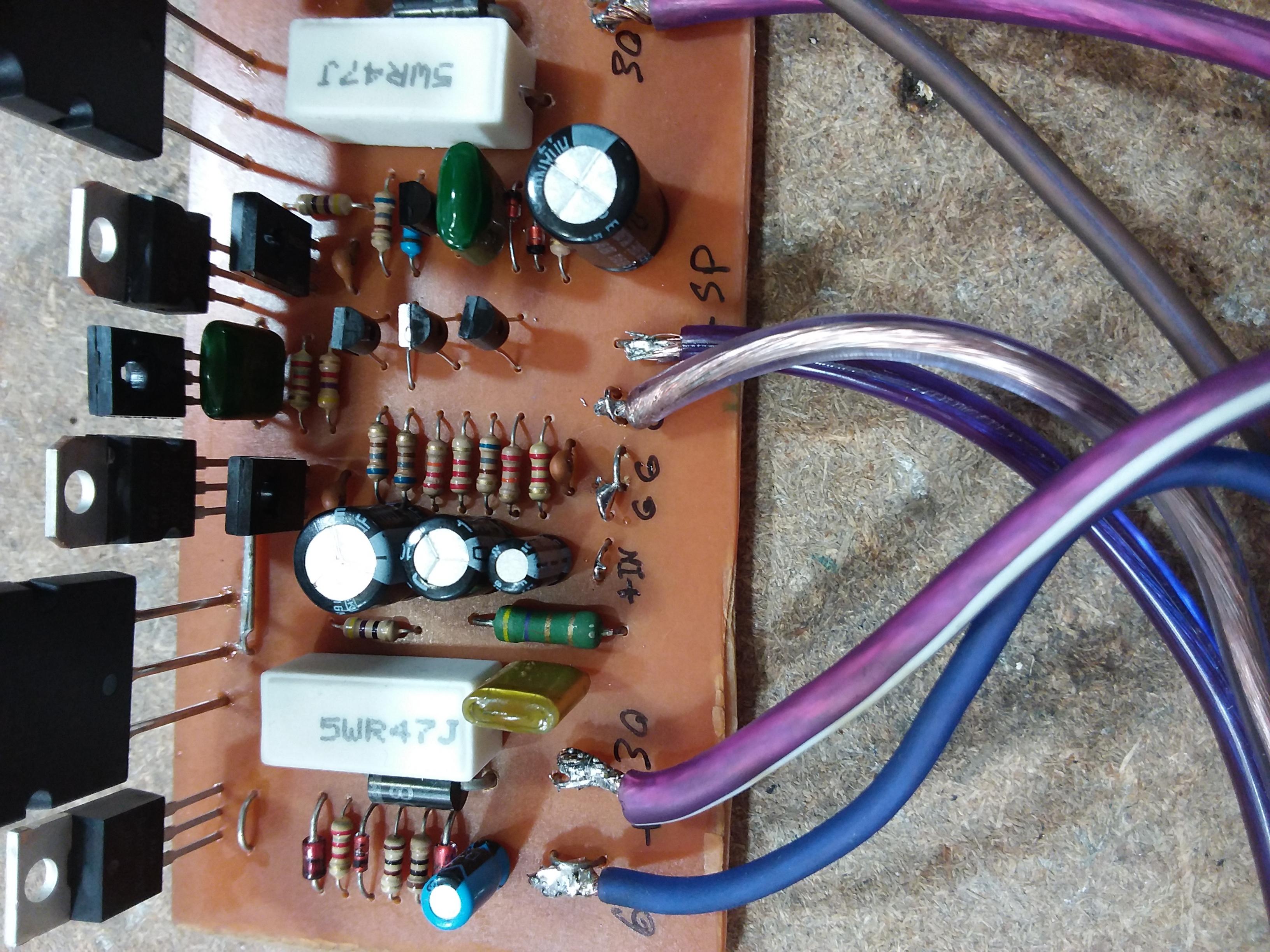

Is this correct?
Reverced all TO92 transistors
All 2n5551 and mpsa92
Is this correct?
No MPSA92 polarity is OK

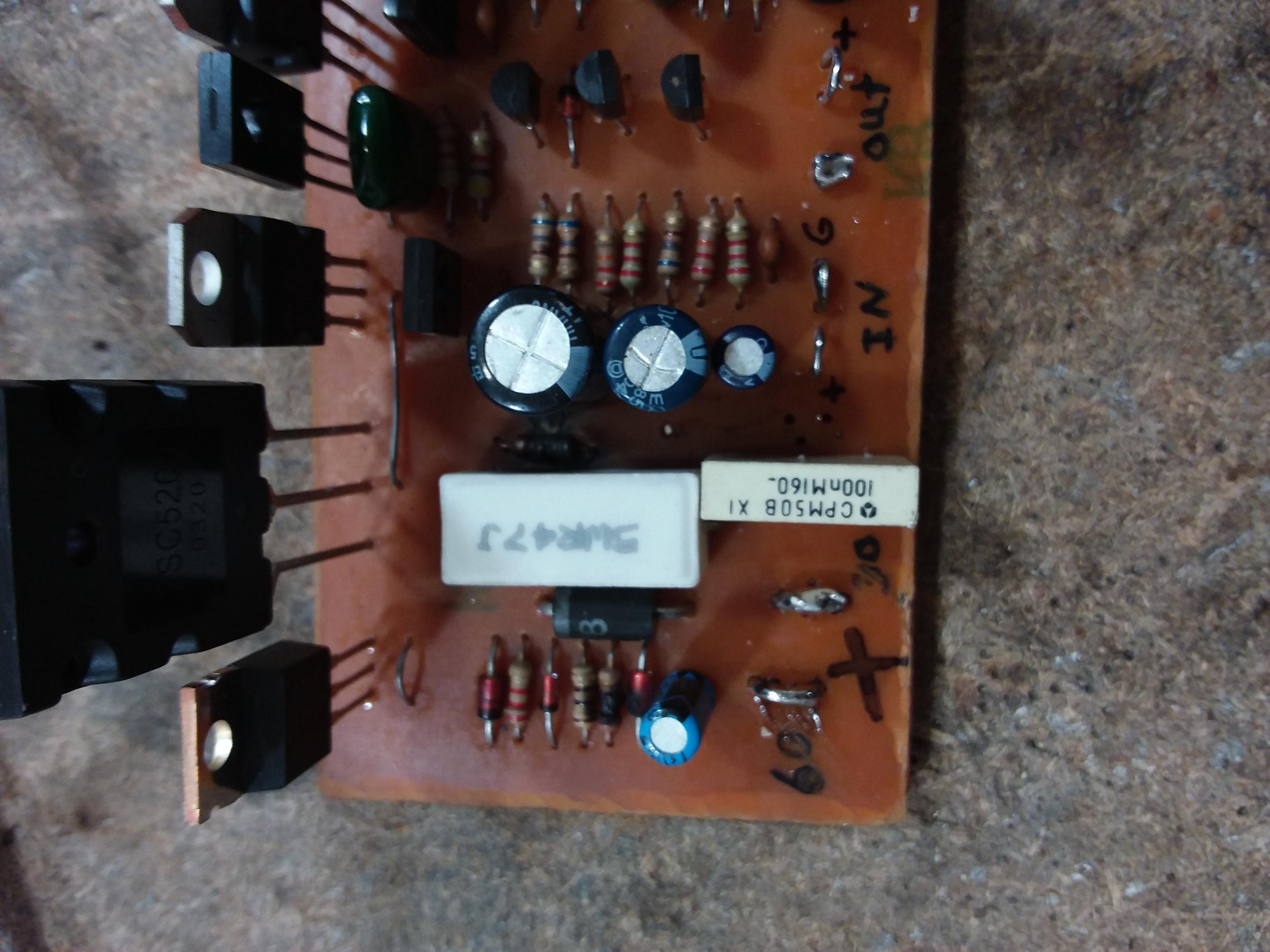

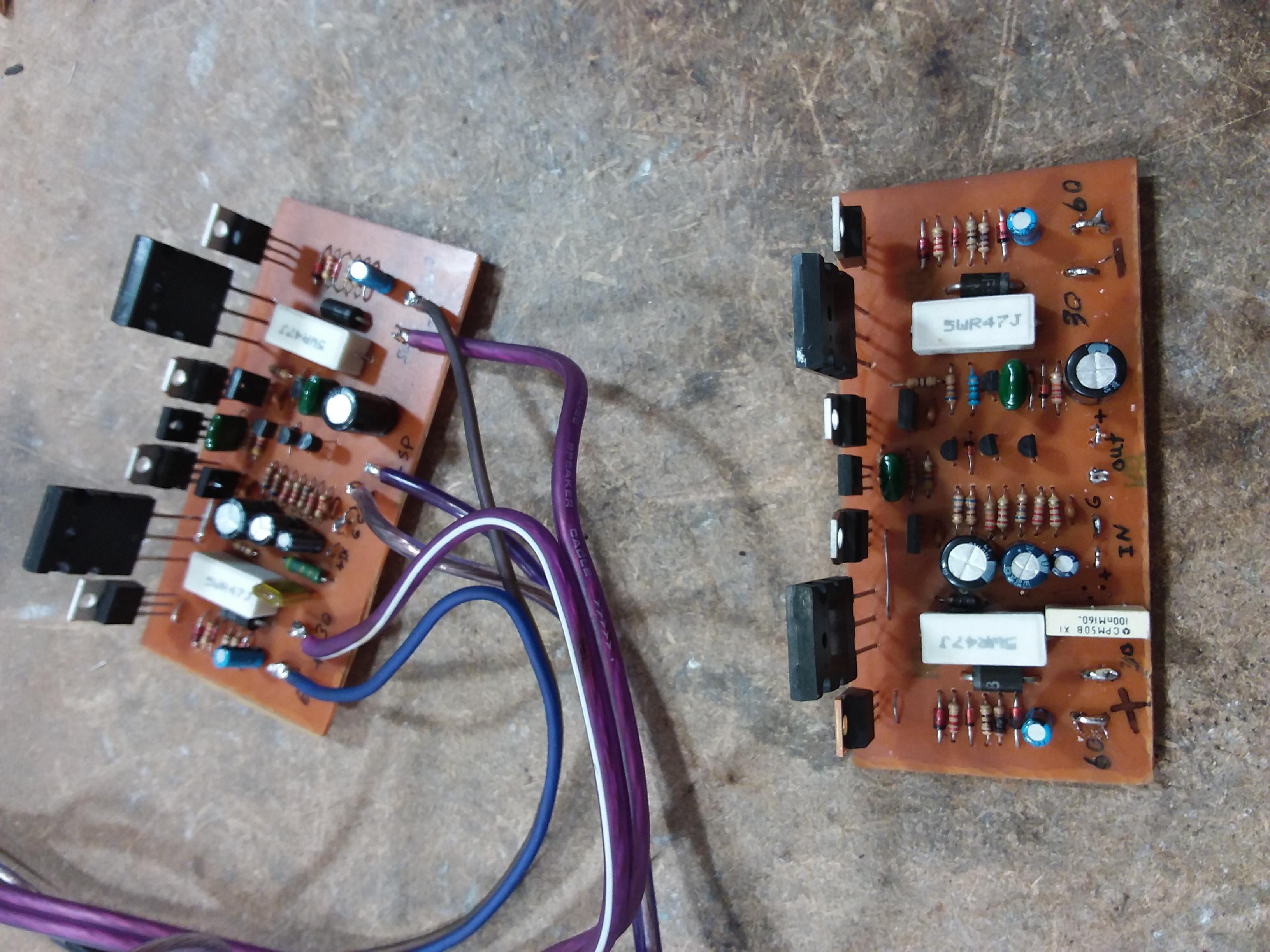

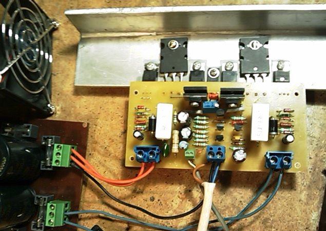

Why board not worked?
There is some mistake on your pcb... HX11 work.
This picture do not have good quality.There is some mistake on your pcb... HX11 work.
What is the mistake?

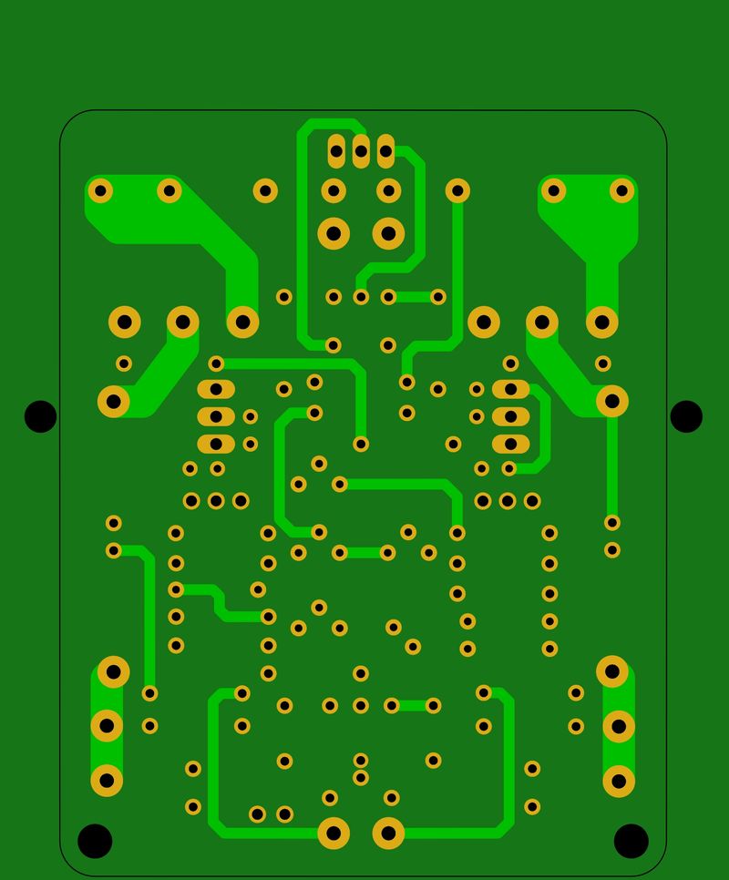

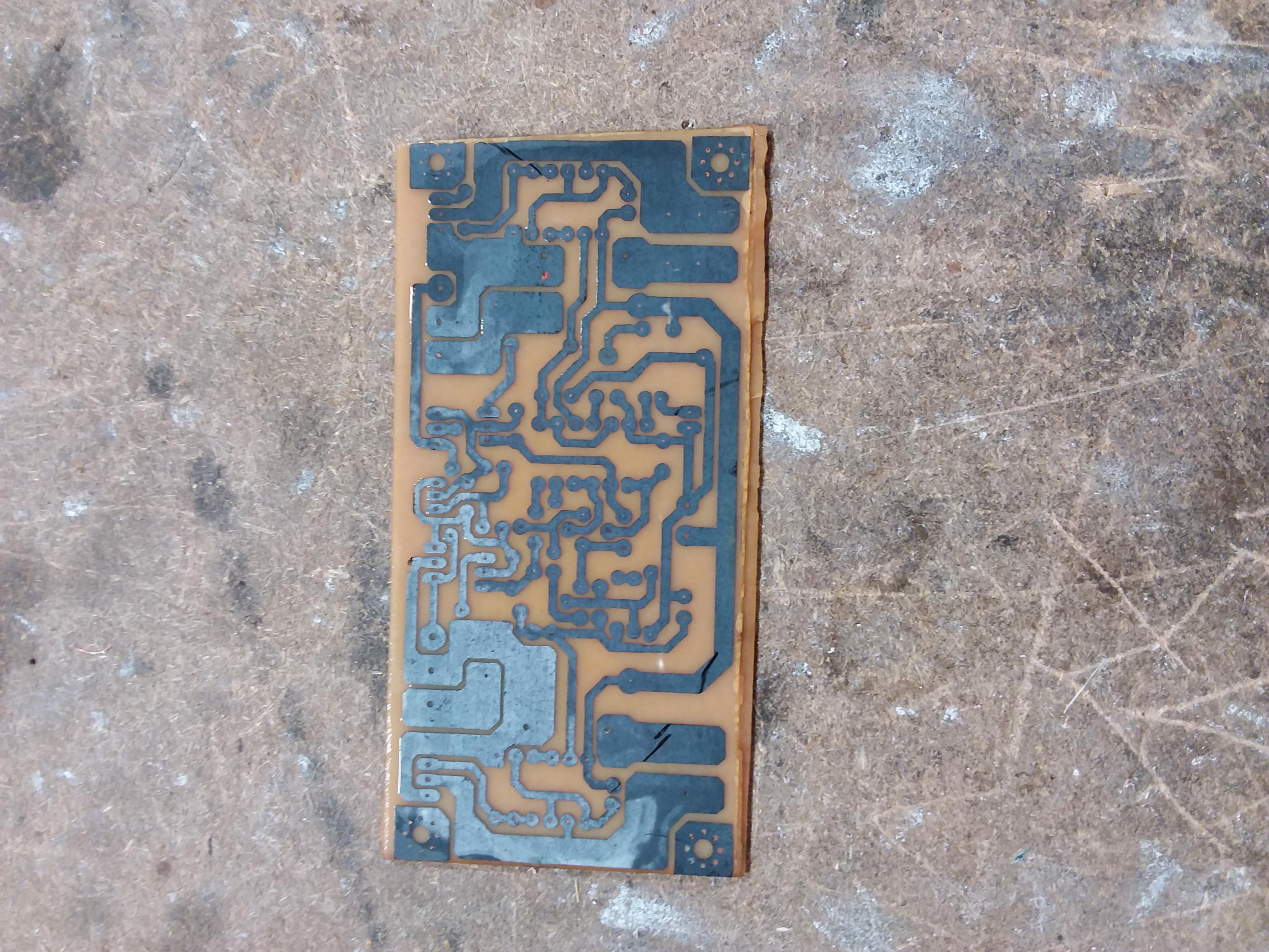

Please, Hadi, post some pictures of the bottom side of the PCB. 🙄
On the PCB with the wires (first image) the MPSA92 is reversed and all the 2N5551 are correct.
On the other PCB (second image) The MPSA92 is correct but all the 2n5551 are inverted.

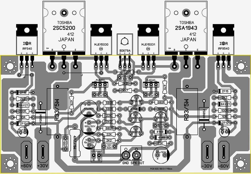

Are you sure that the two diodes above the capacitor of 47uF are indeed 1N4148 because I find them big!
it is this pcb
1. i test it in different condithion
2. i assembled mpsa92 like the pcb and 2n5551 in reversed the pcb file and all is correct.
3. yes. that is 4148
i do not undrestand what is the problem. 2sc5200 and irf540 and irf9540 after 1 second is very hot wen i conected power to the board.
No, post photography bottom side of your PCB!it is this pcb

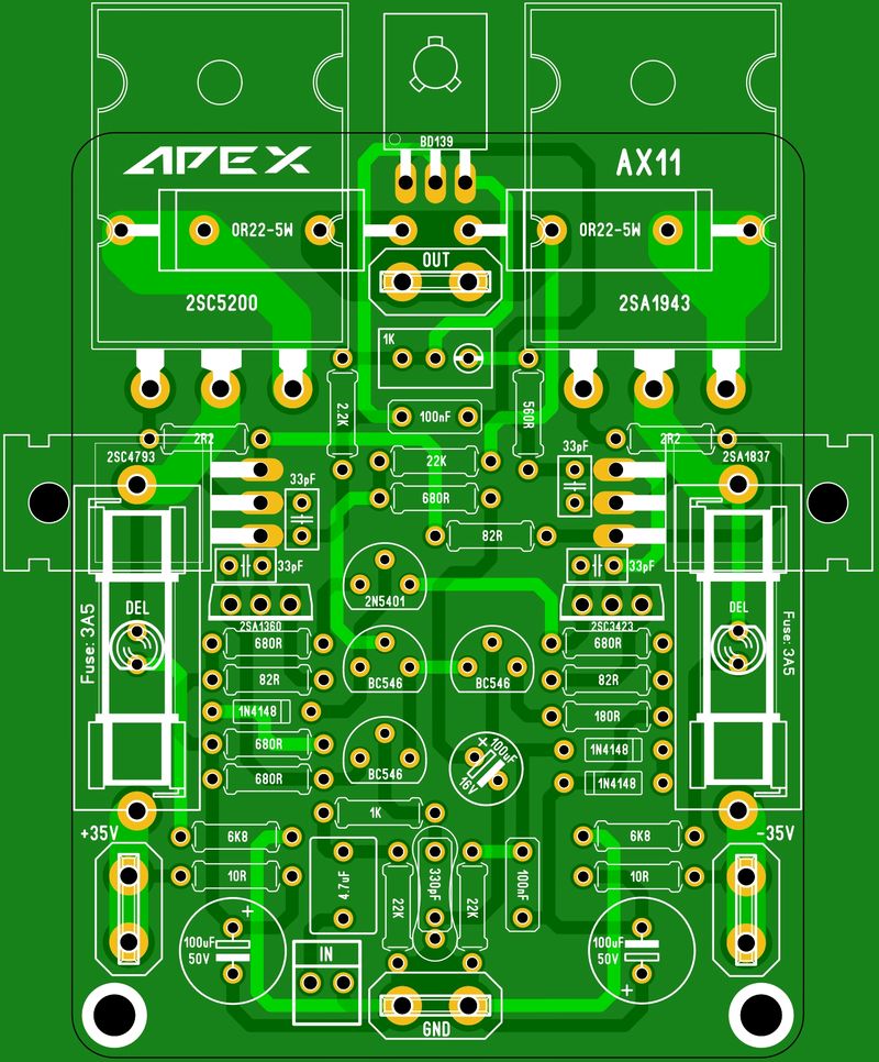

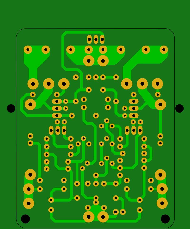

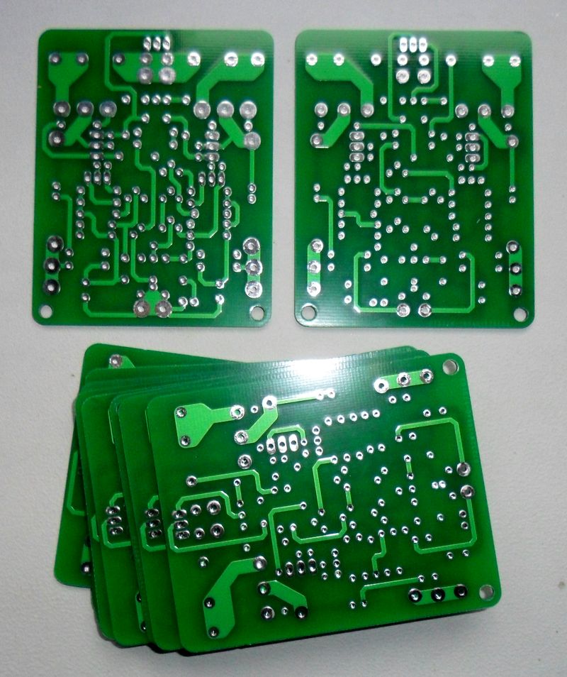

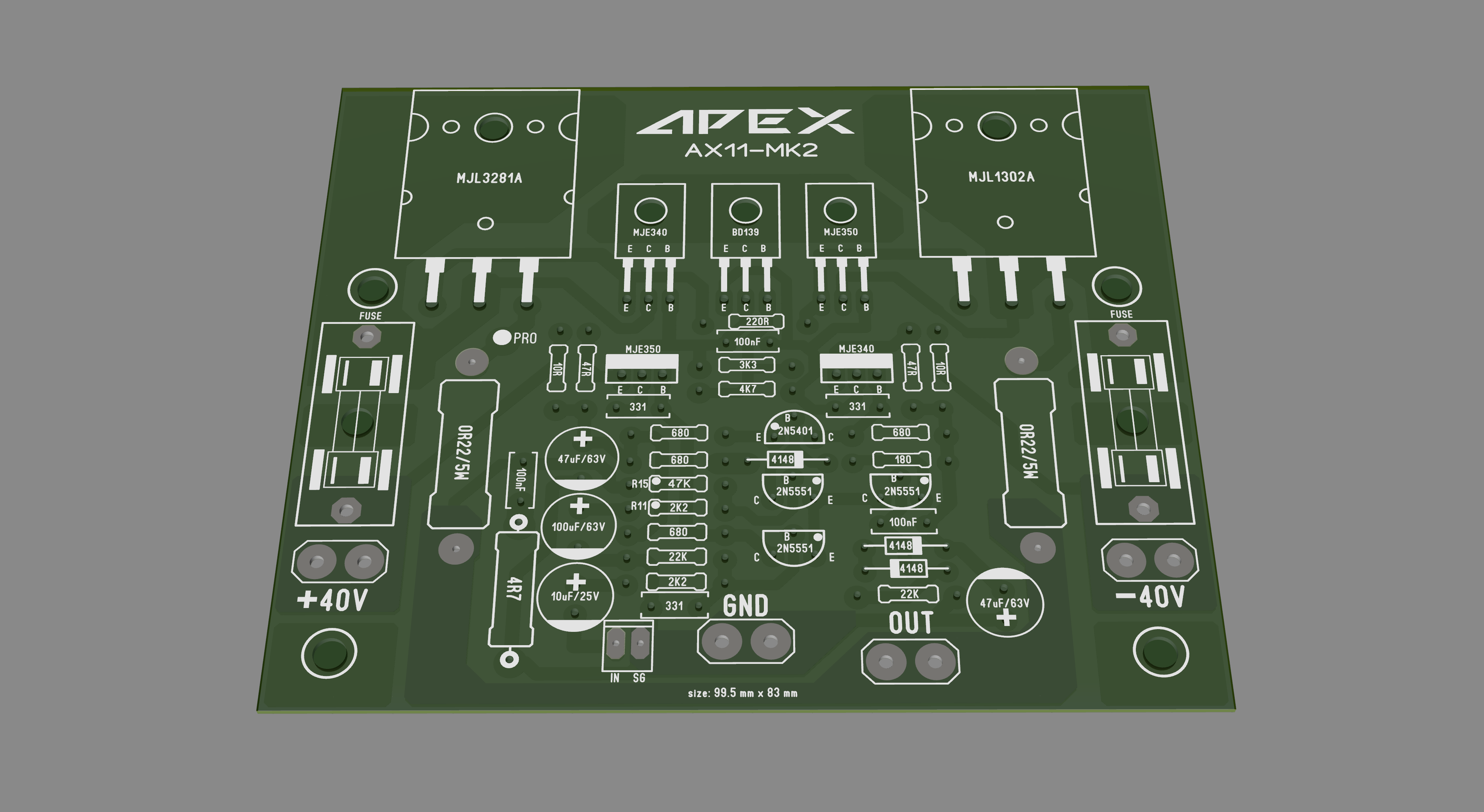

For fun I drew a layout of the AX11 amplifier based on the miniamp with some small modifications to facilitate setting up on the heatsink.
I checked the connections and there is no error but I do not know yet if I will make this amplifier.
If the gerber or .lay6 files are of interest to someone, I will make them available.
Finally I will make this amplifier. I received the PCBs but I forgot to give a color for the Silkscreen. 😀

Check this too pleae
What is that?
What is that?
It is input
If conect to groud we dont have out put sound
Why c5200 is hot?
This is the probleme
