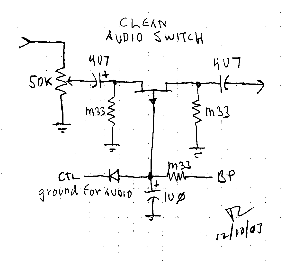

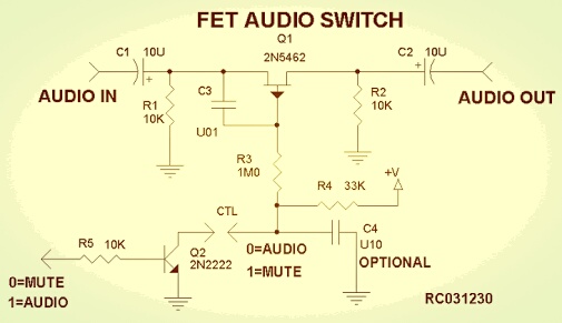

You may find that jFETs work better for switching duty.
There was a Thread some years ago in which was mentioned an alternative switching arrangement that eliminated the distortion due to any non linearities across the switch.

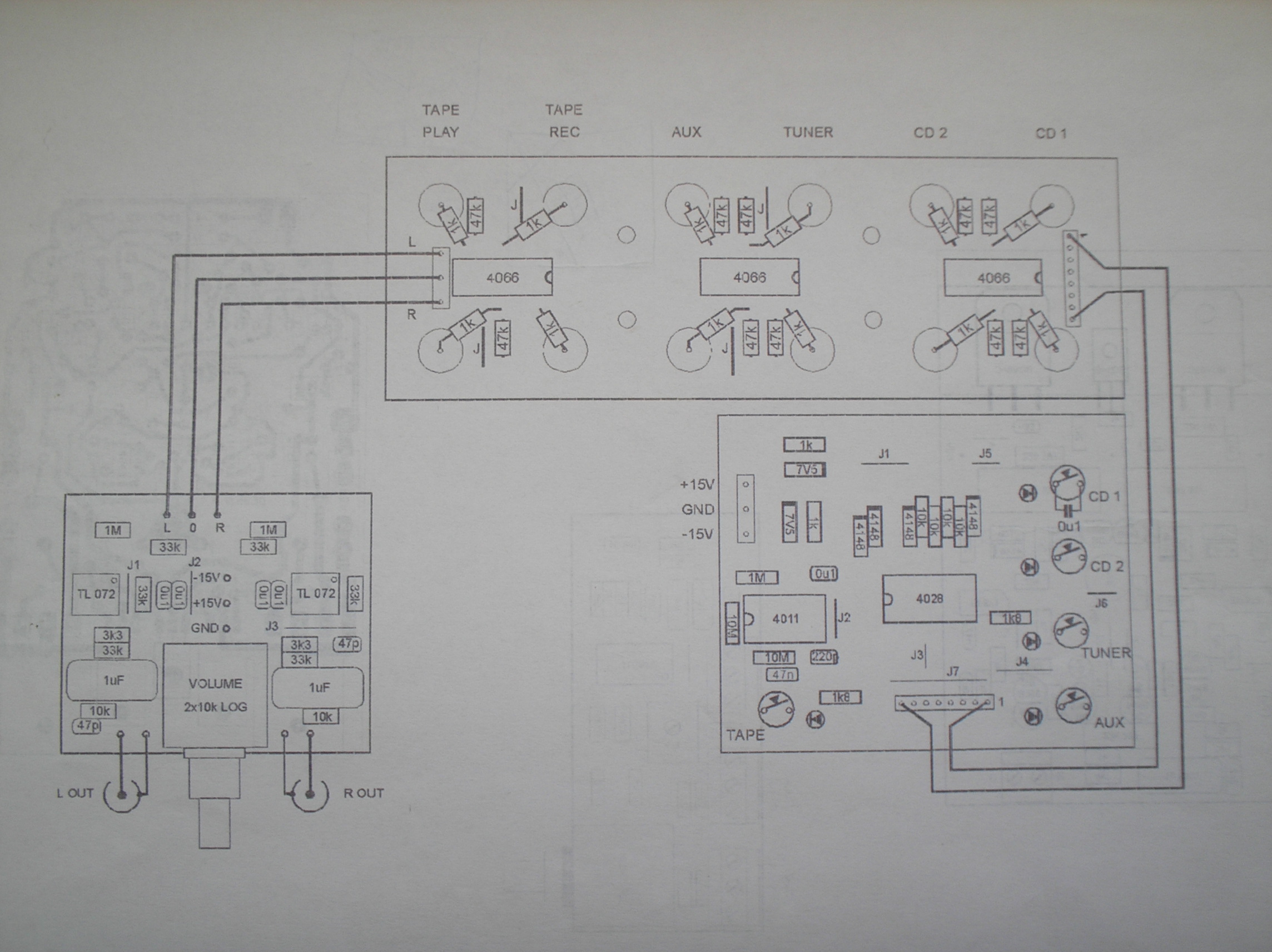

I have a bunch of J113's - could those work? I also have 2SK170's but saving them for a real input stage amp use. Could they be wired front to back in same way as the above circuit and driven in same way with gate voltages?
Why not use special IC for input selector?
http://www.diyaudio.com/forums/solid-state/97171-best-sounding-analog-switch-ic-input-source-selector.html

But I seem to think three or four Members were involved in the discussion and they seemed to agree that the alternative was a better solution for switching audio signals.

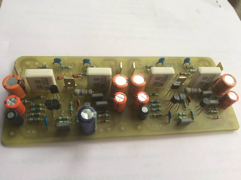

I agree that FH9 is an excellent choice for multi channel amp as it is easy to make, cost effective, and sounds great. What are you using for 900w sub channel AndrewLebon?
Dear Sir,
Thank you so much for the support extended so far..
I wish to do FH9 after a long break...Can you tell me the post with latest layout?
Can I use irf2520s also?
Sumesh
Here are Gerbers I used:
http://www.diyaudio.com/forums/soli...imate-fidelity-amplifier-746.html#post4718255
Change drivers to ksa1381/ksc3503 and power rail caps to 63v and run at 53 rails for FH9HV. Sounds even better.
