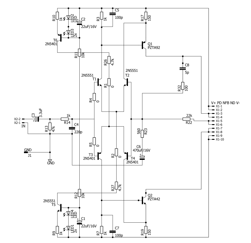

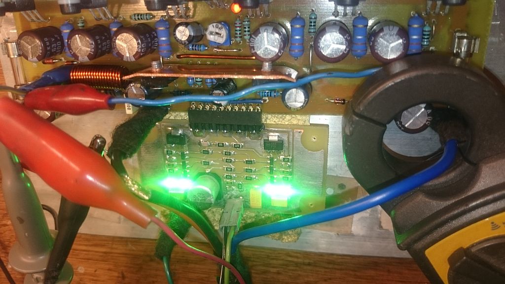

100W Ultimate Fidelity Amplifier

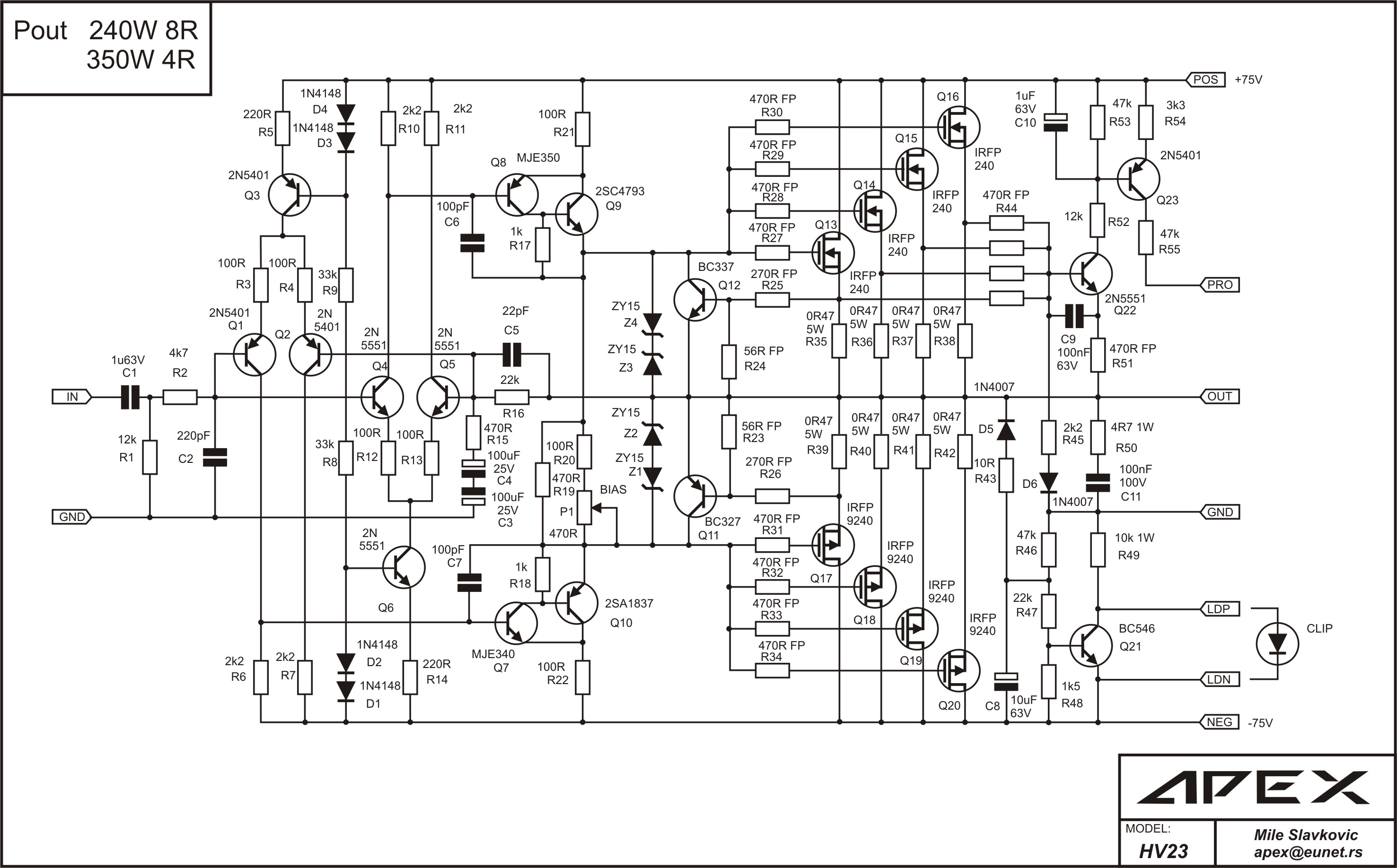

Hey, I just built this - it's like the FH9 on steroids. Have not powered up yet - don't have a wide enough heatsink. Needs to be 180mm wide and I am only at 150mm right now with my standard heat sinks. Maybe a angle strip adapter might work?

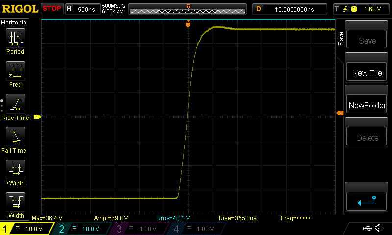

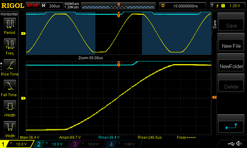

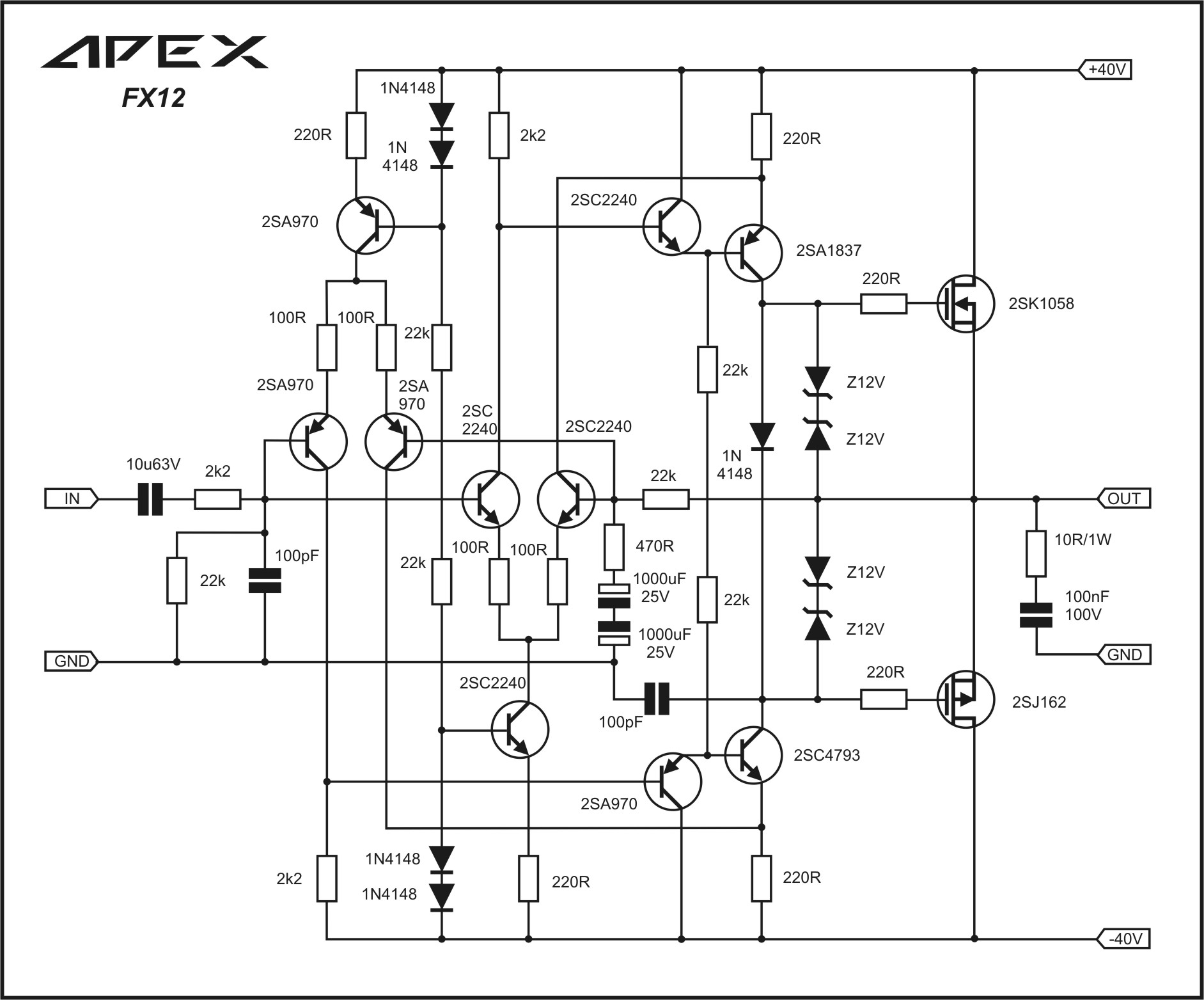

The FX12 look very similar too to my last year Tailgate project, scary fast with mosfets (not finished since).
It should perform very good, with mosfets it would be very easy to bootstrap it to get most out of the PSU rails to the big bass speakers.
For latfets I would advice to add one to92 transistor and compensate diivers temperature. If you will putt amp into the enclosure the bias will drift for sure.

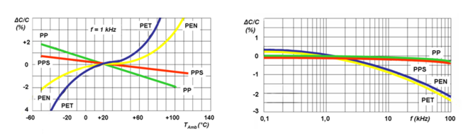

Easy way to find out the type of cap is to measure capacitance at room temperature and after dipping it in very hot water for a few minutes. PP caps will have reduced capacitance . Most others rise in value.
Look at the chart on the following page..scroll down .There is a colour chart of caps temp sensitivity and one vs Frequency.
https://en.wikipedia.org/wiki/Film_capacitor

There is no bias drift with 1N4148, Vbe multiplier with TO92 transistor instead variable resistor is better to use if you want set bias.

Very nice IPS. I see you are using 2 green LEDs for the CCS transistor bases. Is that to get a higher voltage drop vs a single red LED? I like your SMT implementation.
