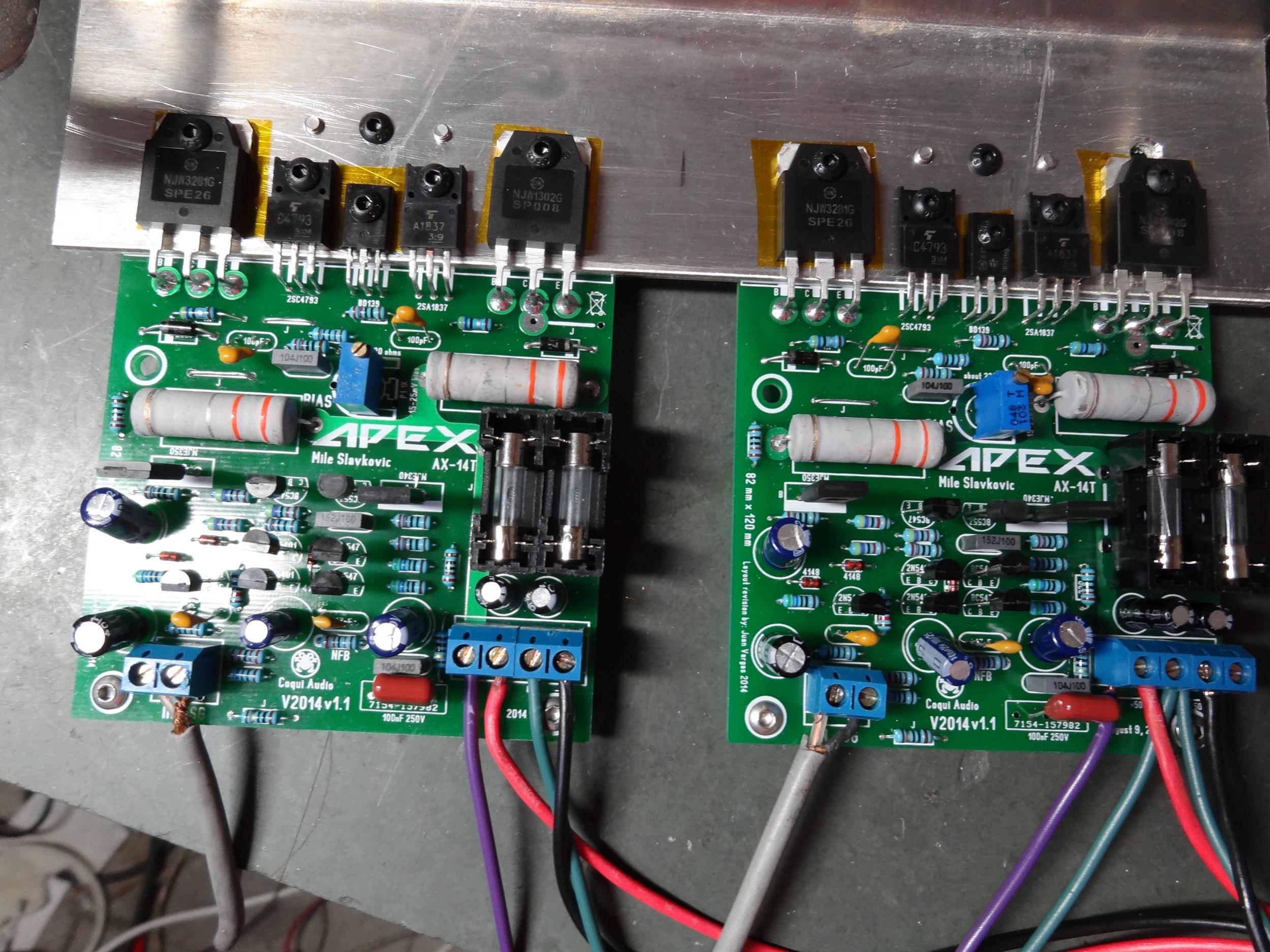

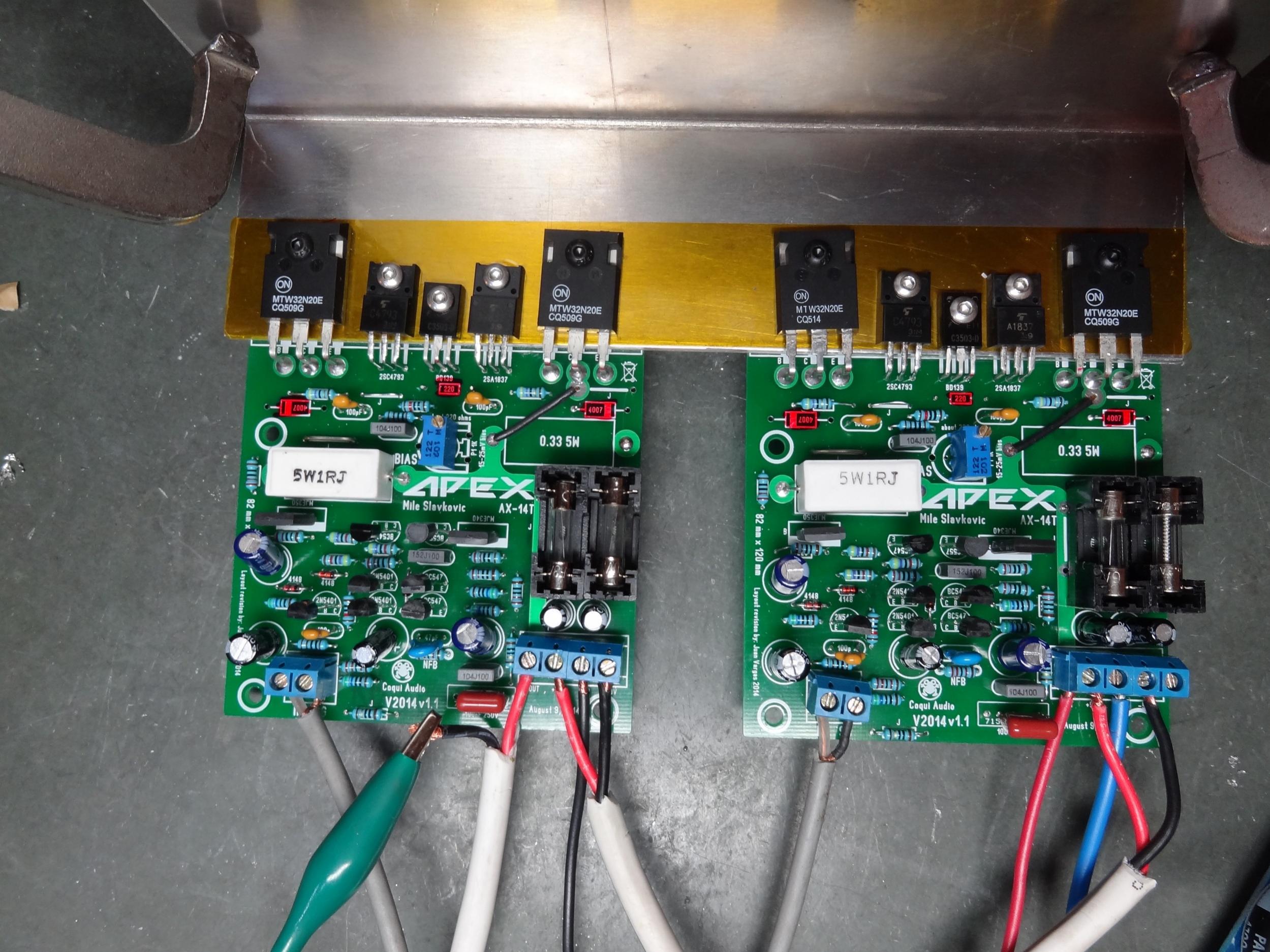

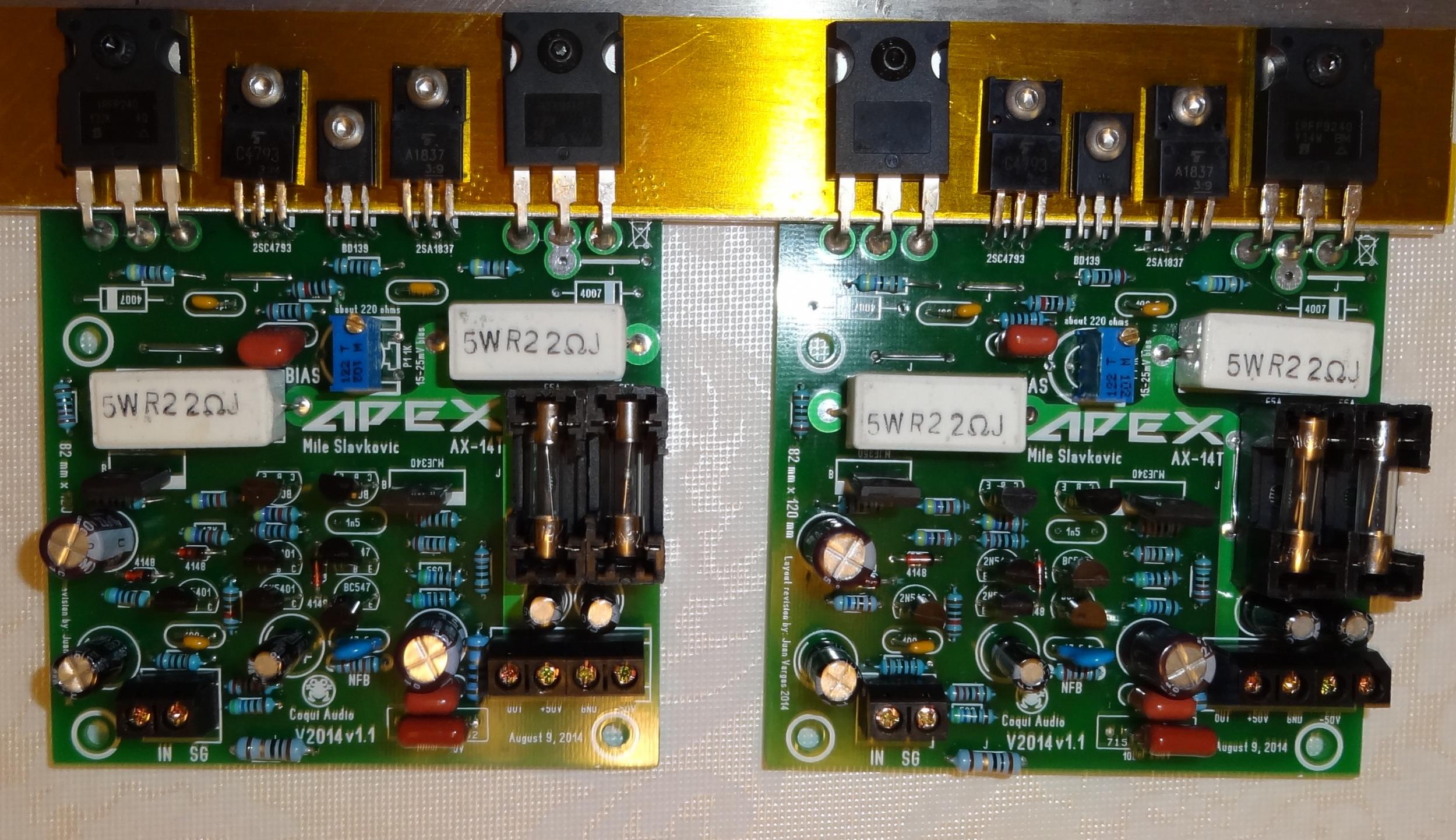

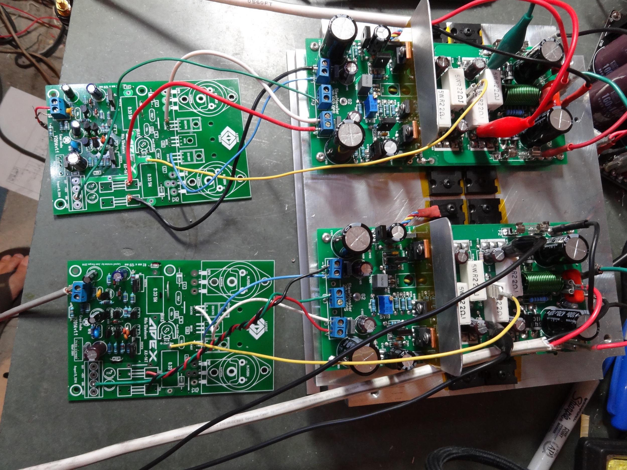

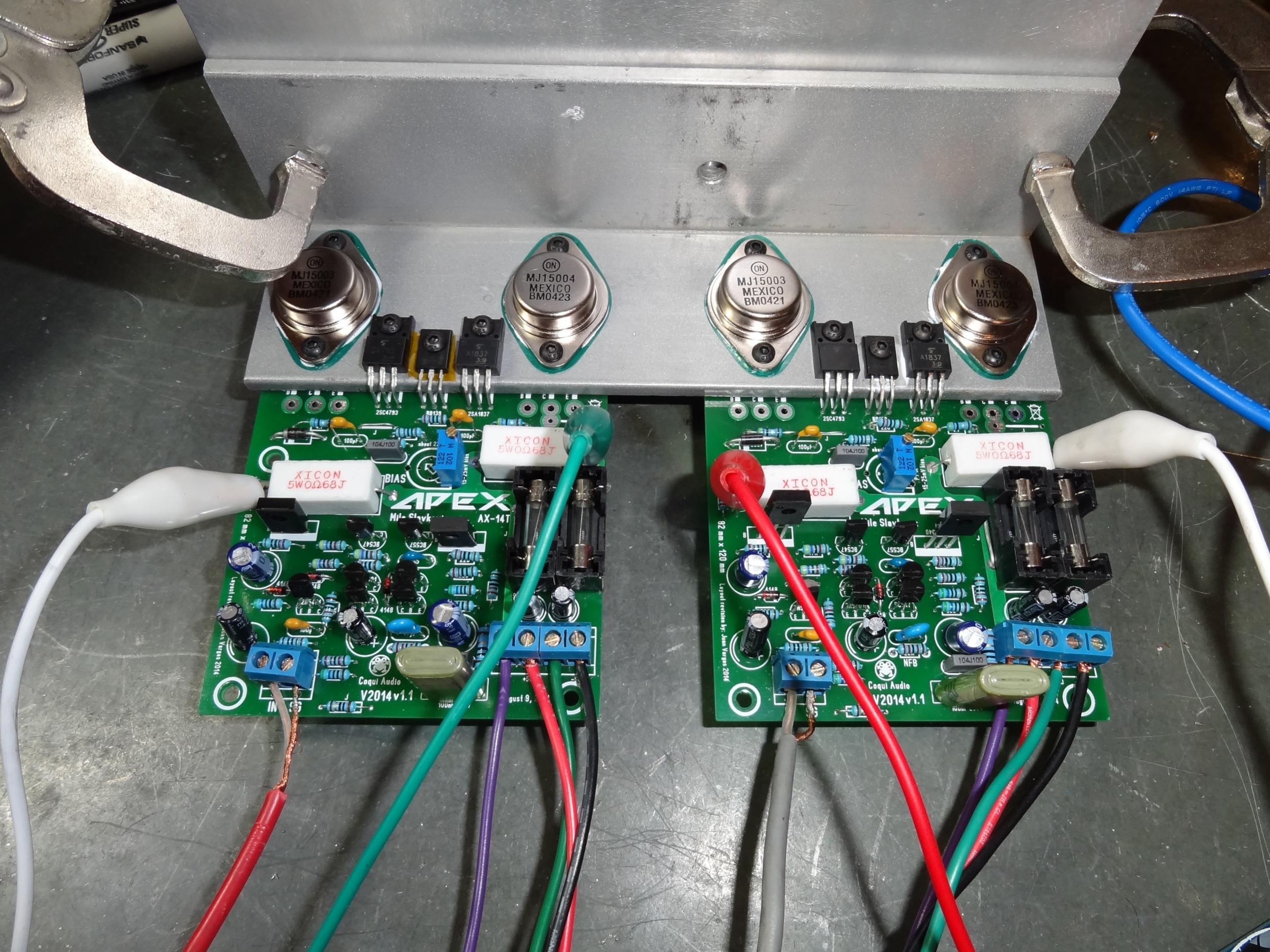

I just finished populating one more pair of the AX-14. This one uses NJW1381/1032 for the outputs. That makes 5 different versions. In order of build;
AX14 with MJ15003/15004
SX14 with IRFP240/9240
NX14 with MTW32N20E
AX14 IPS only for Slewmaster OPS
AX14 with NJW1381/1302
In an A/B blind test at probably 5W output they sound virtually identical. They may measure slightly different and the SX does clip earlier because it runs on much lower rails but that is louder than I would typically listen to music anyway.
Hope this helps.

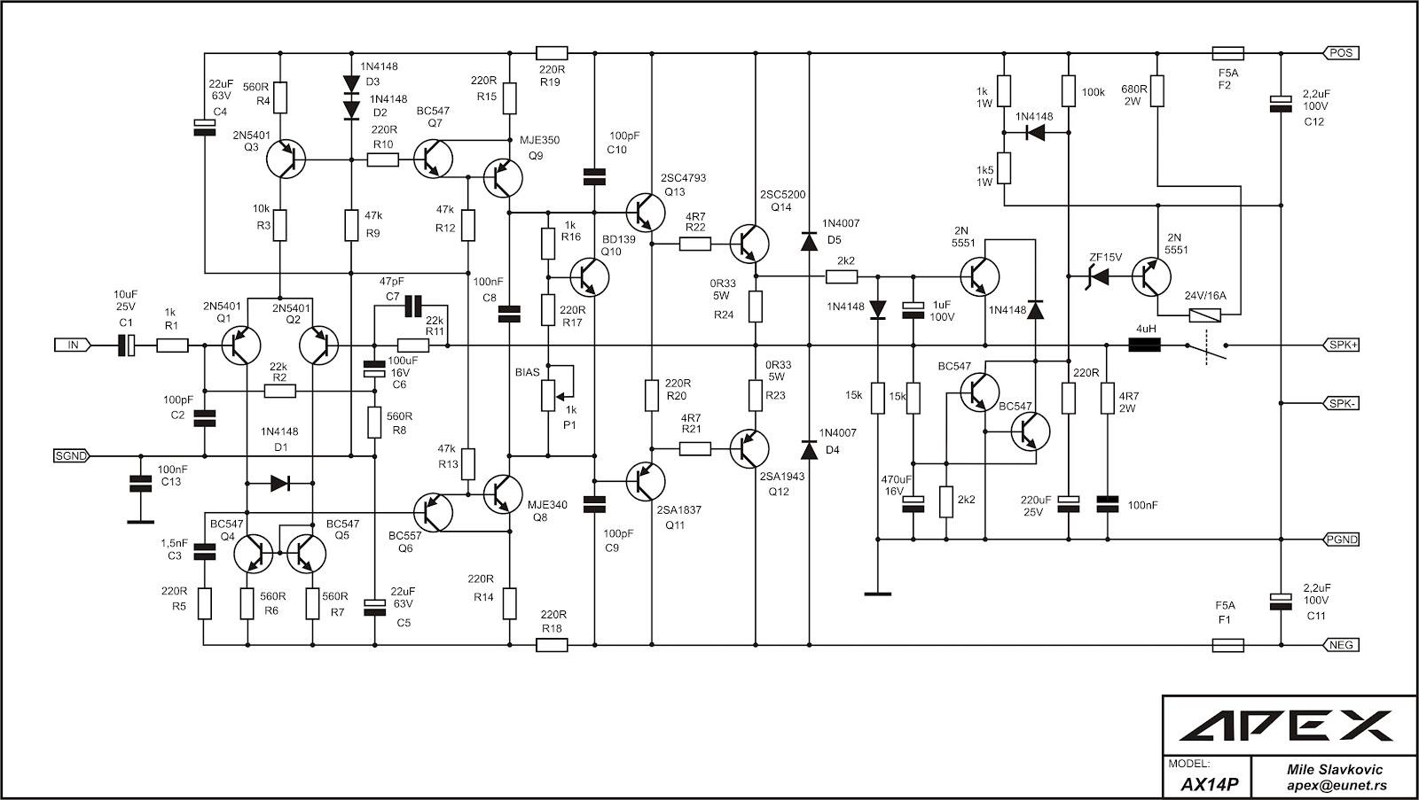

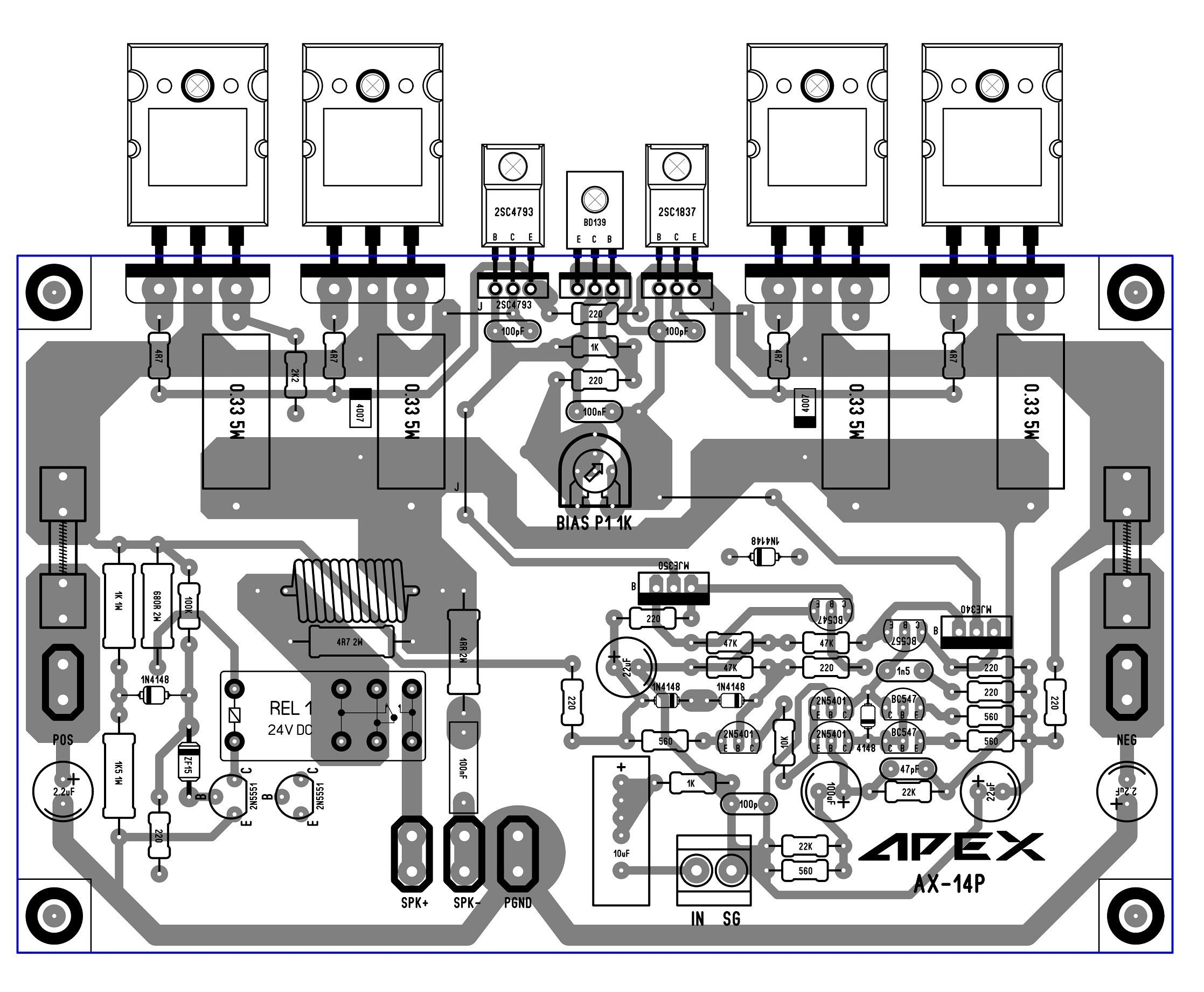

Is normal man, sometimes we don't see errors till we check many times, I keep working with layout and sometimes I made small mistakes it happens that is why I like it and it keep my mind occupied and learning more every day here is an example, I did this layout a few months ago and I still checking for erratas ones I see is all good then I saved it for later. 😉

sir juan,,
this PA protect for ax series sir..?
short circuit and dc protect on output, 🙂 I'll have to rebuild my ax14 on these PCB since I don't have short circuit protection on my amp, it's always bothered me.
I can't remember is that (DC plus short circuit) protection available n a separate PCB?
