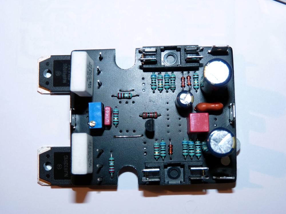

Some Progress on adapted Borys board : Input transistors, Vas and driver transistors are not yet soldered

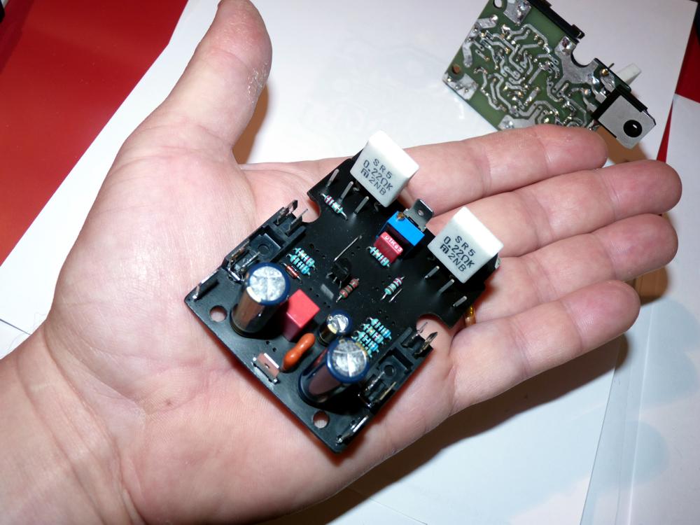

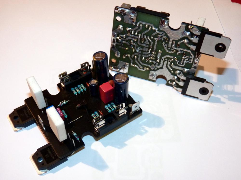

Boards are completed...
Marc

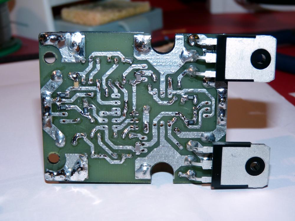

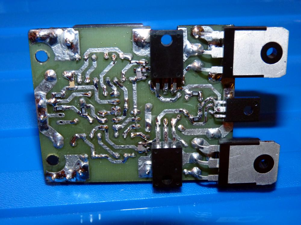

Nice work, do you use some extra tools for work with smd parts?
Regards
I am an old geezer and I used tweezers, that and a headset for the tough ones. If you use 1206/1210 it is real easy.but soldering them isn't for old folks!
Melt a small bit of 0.015" solder on one pad, place, re-heat solder/place,cool and you have one pad down..Then solder the other lead/pad fast and your done.
1206/1210 are bigger than 0805 so they do not tombstone as easy. You do not even have to press down in the middle
Better to have two irons to remove, it is a cinch, way easier than PTH
Regards
Not at all, only classical middle quality solder station with 0.8mm tips and a classical pliers
I dispose a little bit solder on one pad, maintain the smd part with the plier and solder first where i put solder on pad. Then i solder the other parts end. Really not a mess. Parts are 1206 type so really not the smaller.
Marc

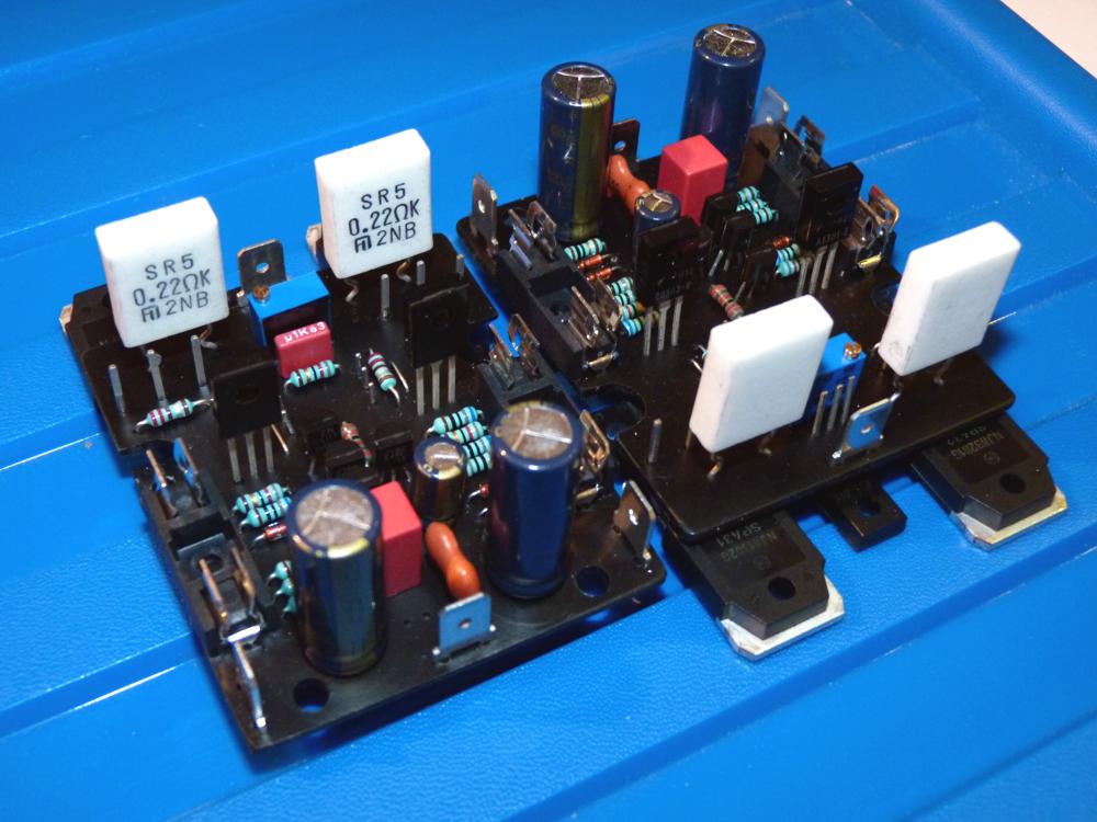

Marc
Idefixes how it is sounding and how much bias current did u adjusted
Up to time in didn't fire up the board. I will try this this weekend probably. The Bias will be set at around 40mA (between 8 and 9 mv across 0r22 emiter resistor) per NJW based on my latest experiences on BG1/VERSATIL.
Marc
