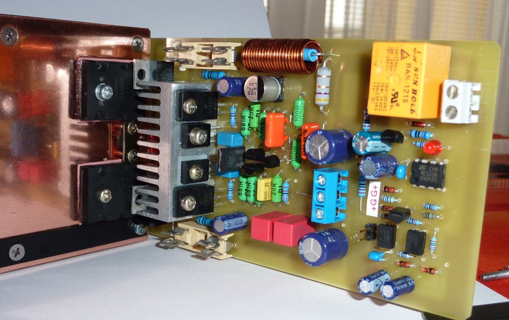

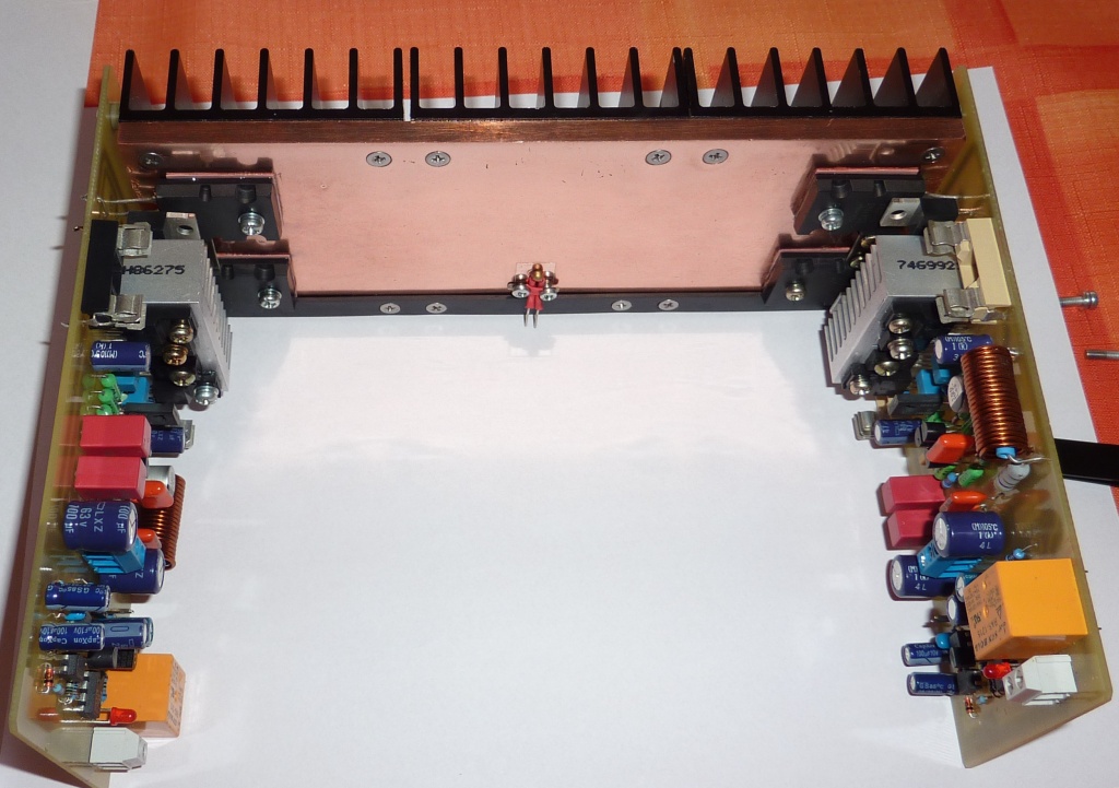

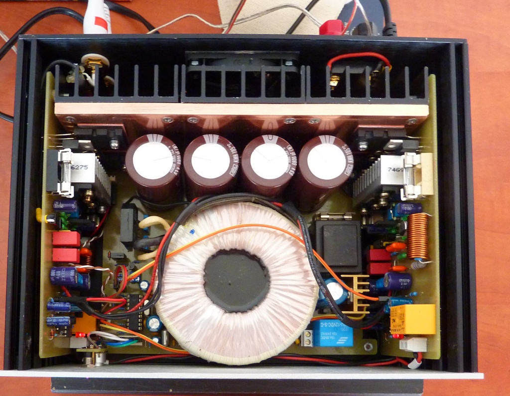

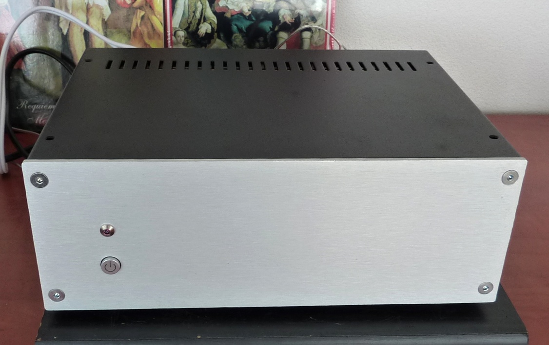

today I finished to build my AX11. At the start I have got a case and trafo and I thought about small, but very good amplifier. I decided to build AX11.
I never made so stuffed construction. But the result is here.
I used transistors: BC456, MJE 350 instead of MPSA92, MJE 340/350 instead of BC639/640, 2SC4793/2SA1837 instead of BD139/140 and 2SC5200/2SA1943.
I had some problems with stabilizing BIAS.
Controlling of AX11 ensures PIC16F84 (ON/OFF, LEDS, Relais), but small quiet fan to cool is driving by thermistor and two transistors (I didn't use PWM from PIC).
The sound is perfect!!!

A lot of thought went into packaging that lot. Superb.
Have another look at the way the fan cools the three heatsinks.
Have another look at using twisted pairs for the Flow and Return of every cable.

Which version pcb?
It's my own version of pcb, designed in Sprint-Layout. On the board are also components of speaker protection.
And by the way, the second step will be construction of processor controlled preamplifier. I can use the same case but with half height then my AX11 (only 40mm). It will be communicate with processor in AX11 (function master/slave only). I'm thinking about Wolfsons WM8816 or PGA2311 as volume control, four inputs (switching by signal relais). Or maybe I use Sanyo LC7537, obsolete but in my possession.
