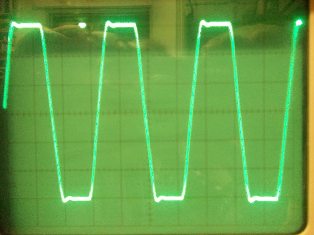

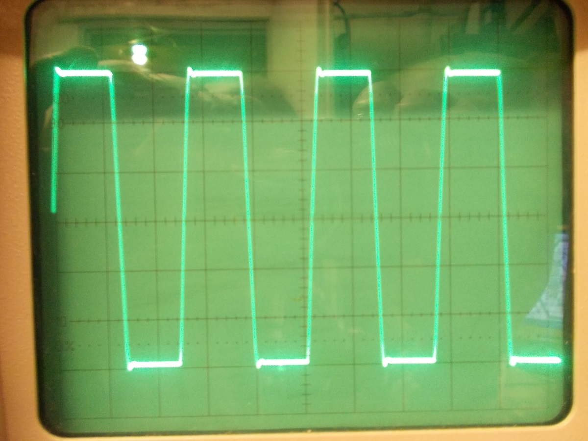

I do not know if I am asking for too much but can You repeat one square wave measurement on 8 r with small cap in parallel please ( someting like 0,47uf or similar)
Here are the pictures (1 - 5 - 10 - 15 - 20 kHz).
regards Olaf

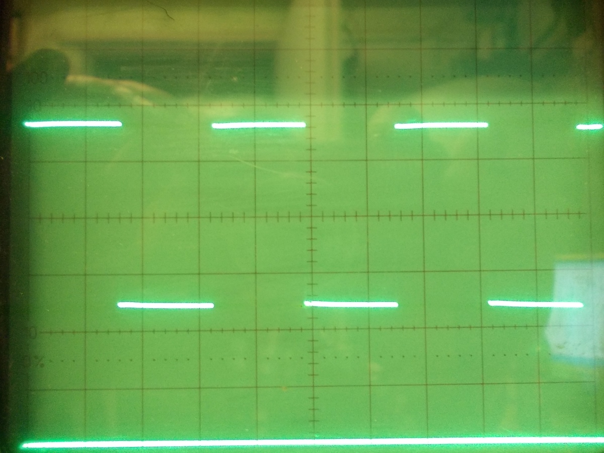

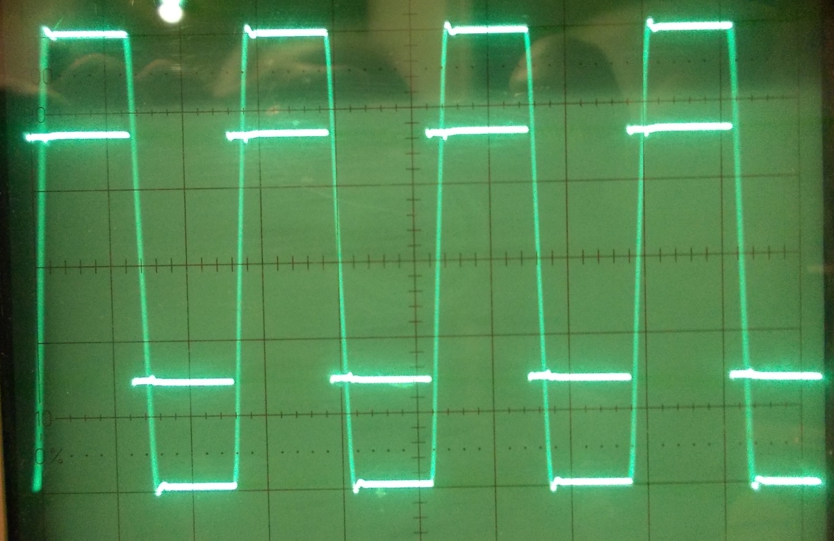

You really need to compare input signal to output signal using a dual beam or dual trace scope. (dual beam are quite rare).
The input signal is a pure exactly square wave with 0.8V approx. as shown in Fig. with 1kHz.

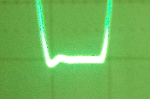

The differences in output are the slope with increasing frequency, and the small peaks at the corners (see picture).
What else can we see, phase shift?
I can do it again if required. The oscilloscop is for dual-measuring.
regards Olaf

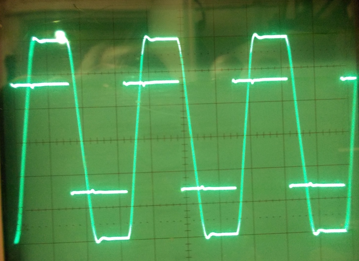

Yes, you and we need to see the input signal to allow comparison with the output signal.
If the input has overshoot and this is mimicked in the output, but you don't show us the input, we could be mislead into thinking the amplifier is adding the overshoot.
You must be unbiased in how you present the information.

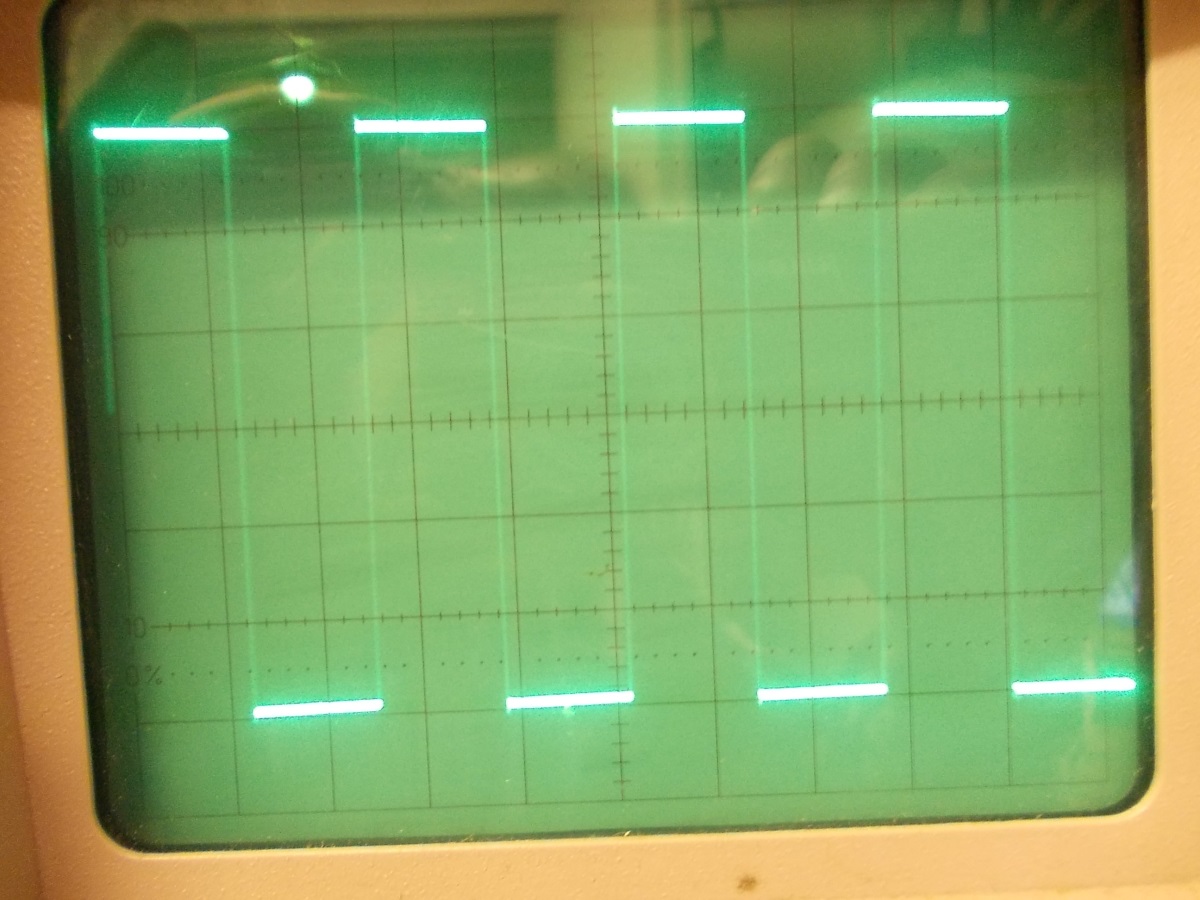

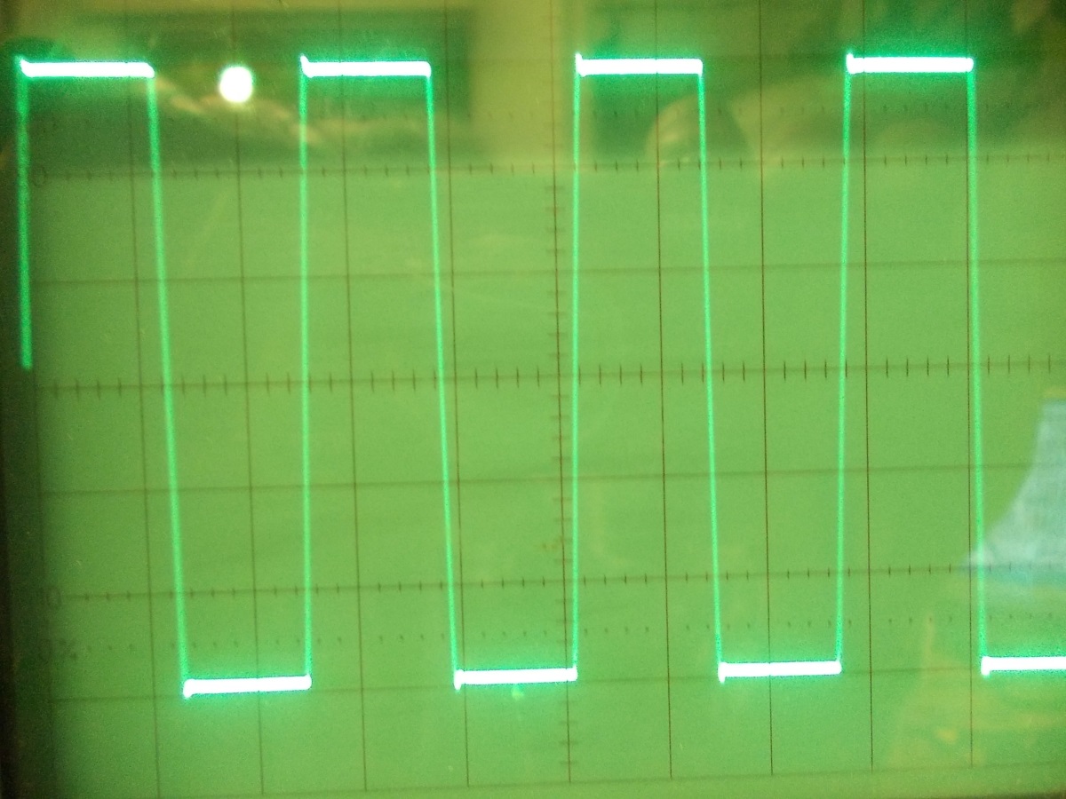

OK, here are the new images.
I hope someone will explain what can be seen in the pictures. I can measure again, today is holiday in Germany ;-)
Compared to the original circuit, I use 220R instead 180R in CCS.
regards Olaf

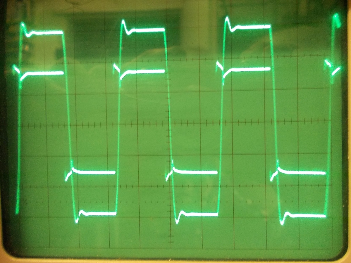

Now I changed all 330p to 100p. Slew rate is better as expected.
(10 + 20kHz). I hope, the probes are correct, but 20cm wire.
regards
