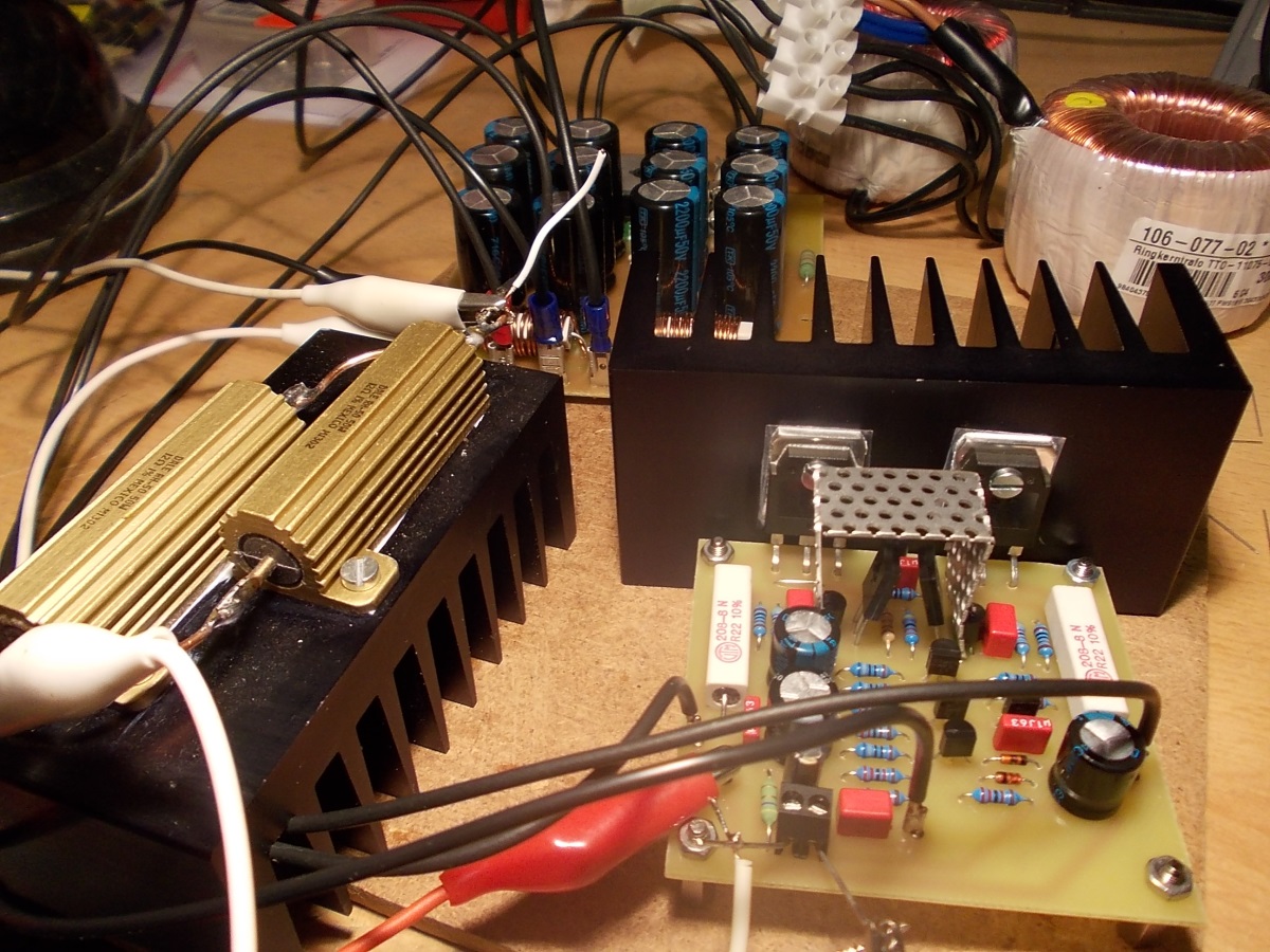

The amplifier operates from the very first moment. No offset, silent with open input. The sound (only basic car speakers for the test) is very clear and transparent and strong and fully in the basses. The amplifier is absolutly competitive with any commercial amplifiers of this class.

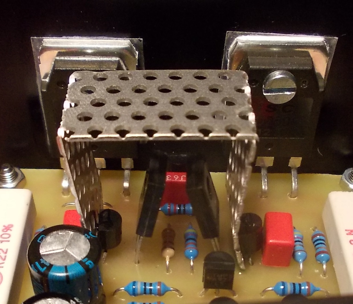

Good. Is it necessary to heat sink the drivers (BD139/40)? What about thermal touch sensation?

BD139/140 are warm but not to mutch. You can touch them without any problem. But BC639/640 are very hot. The amplifier runs with +-38V DC. And I have not tested yet with power.

Maybe testing with another pair BD139/140 replacing BC639/640. Same characteristics, better dissipation (to-126 x to-92).

BF471/472, BF871/872... many pairs can be use in this design, also CCS current and heat on VAS transistors can be reduce: just use 220R instead 180R in CCS. Gain can be increase: use 680R instead 2k2 in feedback... this amp is for fan.

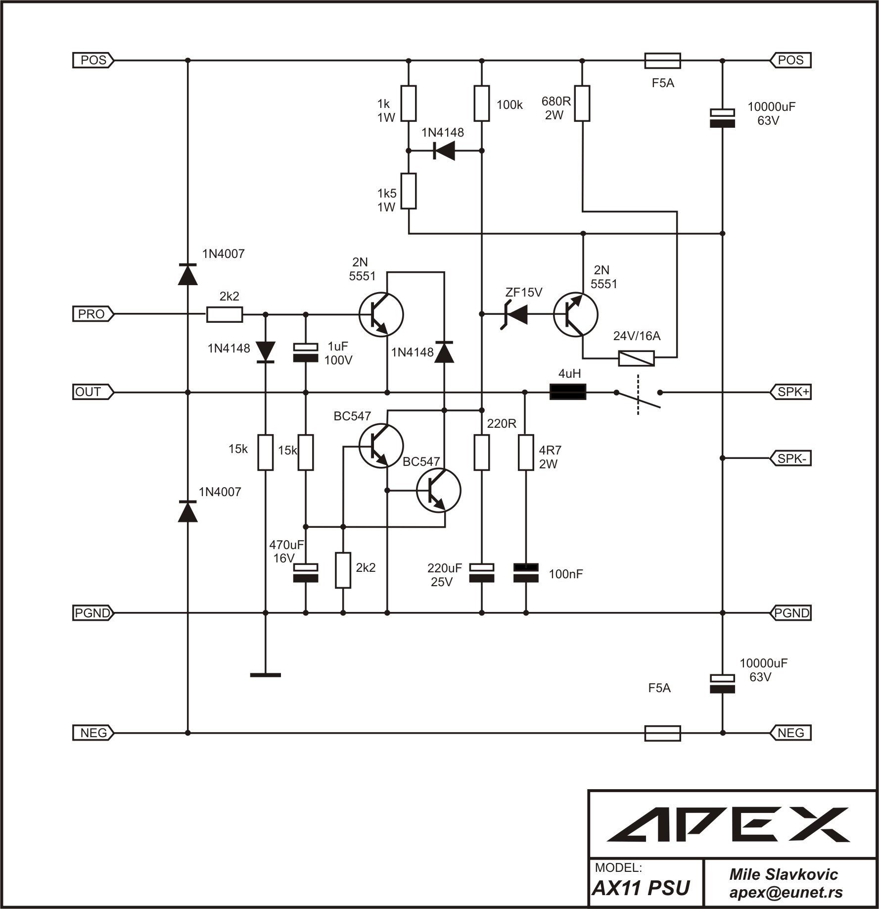

AX11 PSU with protect

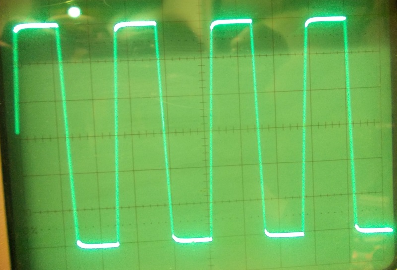

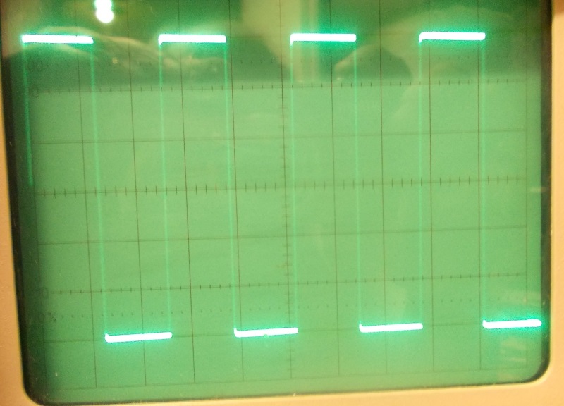

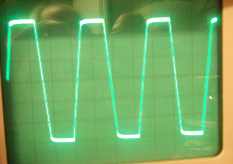

I've played a bit. A small heatsink connected with thermal adhesive (more for peace of mind;-). Some photos for 20kHz, 10kHz and 1 kHz with signal generator until 30V peak to peak at output. Load resistance and heatsink are good warm (too small).
In each perspective the amplifier operates stable and has a warm and transparent sound.
It is a very nice, cool amplifier - typical apex.
It's fun to build it and you get an impressive sound.
Thanks again to Apex.
regards

Nice, you can use 100pF instead 330pF if amplifier operates stable.

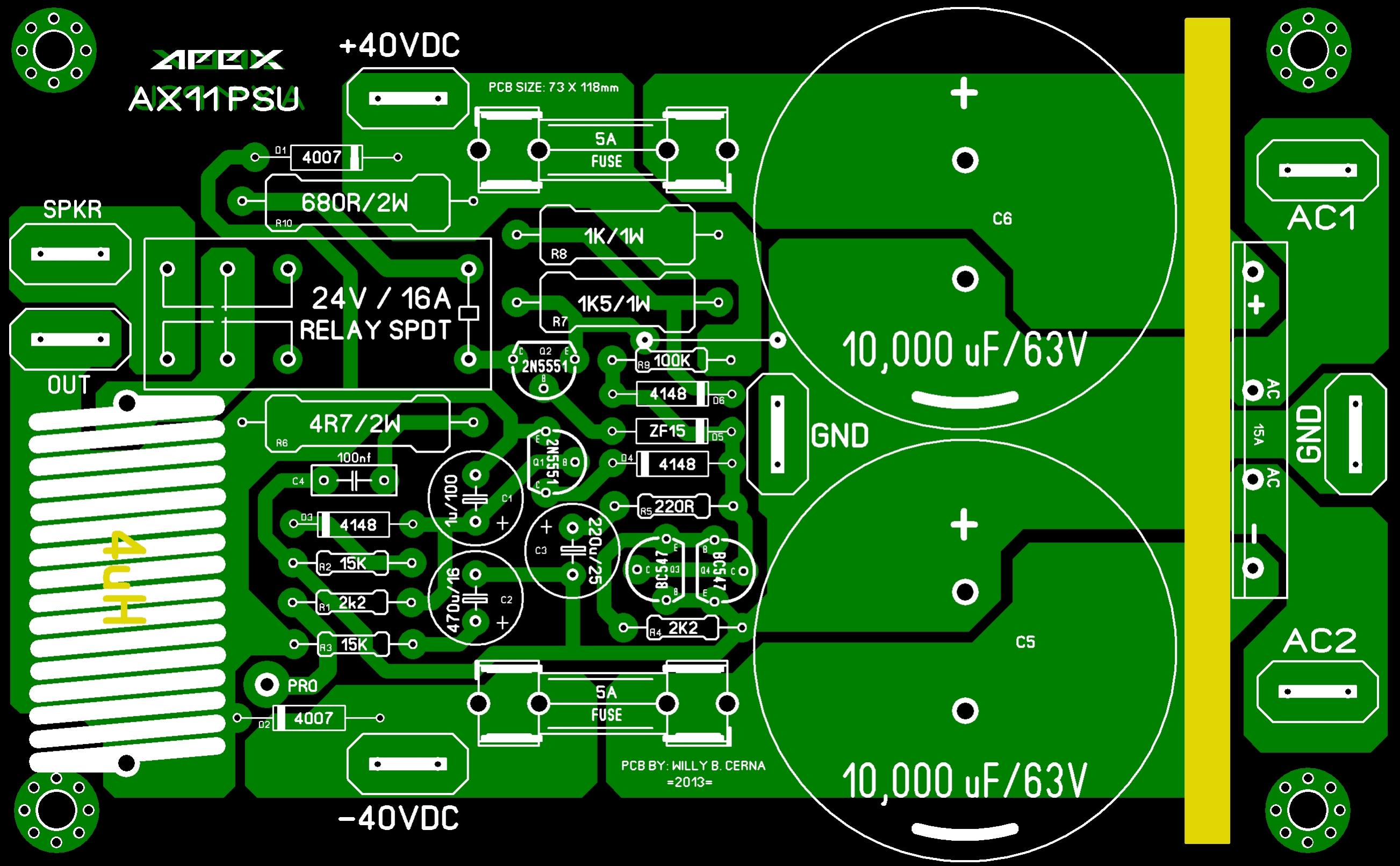

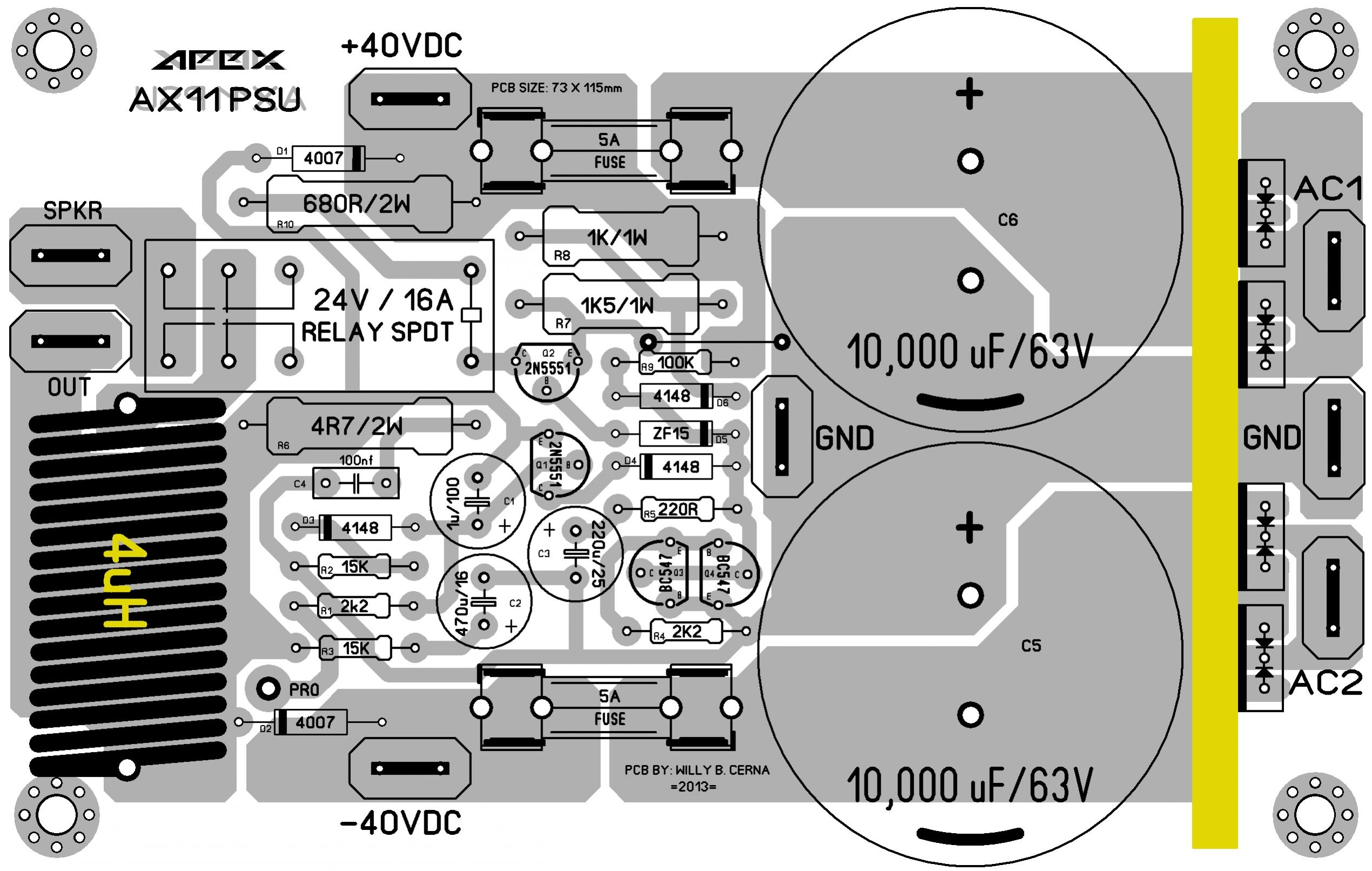

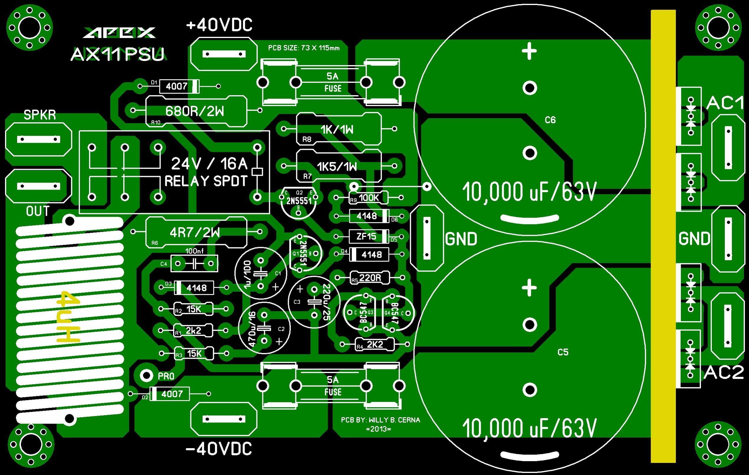

APEX AX11 PSU in Progress....
Let me know if anyone found mistake....
Just for fun..😉
