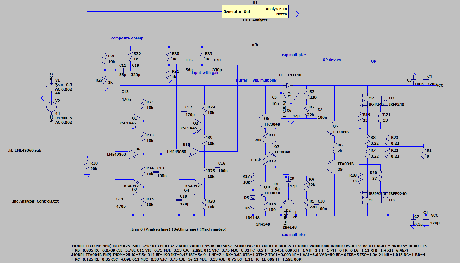

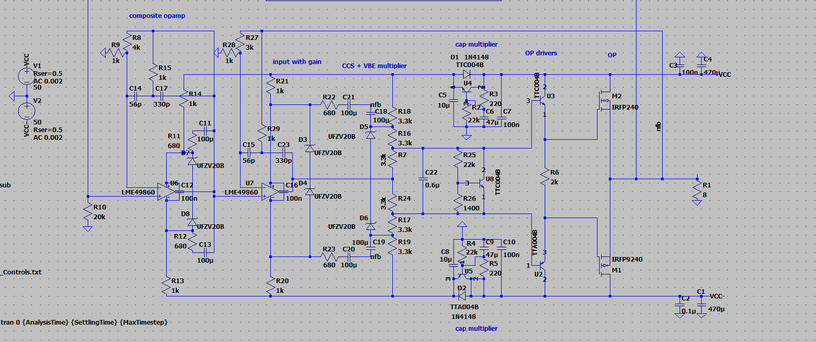

during the last few weeks i've been reading about discrete amplifier designs, for example Blameless and wolverine, and was looking for a challenge to design my own high end amplifier. but with a twist to make it challenging and unique. that's when i came to the following thread: https://www.diyaudio.com/community/threads/mosfet-audiophile-amplifier-with-opa-driver.341751/
I decided to take on the challenge to design an amplifier with an op amp input and gain stage while being high end.
the following limitations are put in to place to make the challenge of design more difficult:
  1. the input and voltage gain has to be done by op amps
  2. a minimum avg. power of 100W with an 8 ohm load.
  3. minimum gain of 20.
  4. "wolverine" like performance regarding THD.
  5. minimum of 2 mV ripple on PS rails.
  6. maximum of two output devices to keep the design tiny (optional if large improvements can be made).
i know discrete would be cheaper and no more or less total parts but that's not what DIY is about, aint it?
so you can find my concept in the attachments. you also can find the analyzer settings there.
i hope you all have some input to improve it even further or learn something from my concept.

Interesting - does performance degrade without follower U8? If you drive each driver base via a resistor || capacitor you'll have more symmetrical drive. And the caps act as a speed-up cap too. Might want a CCS at the +ve rail too though - perhaps your way is simpler.
Without bootstrapping the second opamp you'll probably have limited headroom due to the LME49860 not being rail-to-rail, and the drop in Q3 and Q4.
  • Thank You
Reactions: 1 user
have tried but with no success of working at all. the function of follower U8 is to lower the loading of the opamp, thus improving the performance. i also tried using diodes as biassing circuit and BJT output without buffer and CCS, but this would load up the opamp weirdly and causes more instability.
i'll try, which values should i start with?
do you mean like this?
Reactions: 1 user

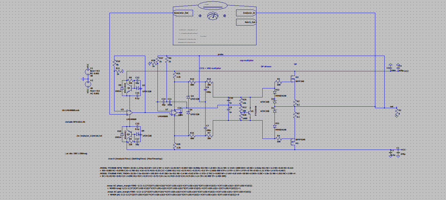

When opening the asc-file from the first post LTspce complains about missing symbols:
TTA004B
TTC004B
THD_Analyzer
The TTX004B are bjt which are not standard in LTspice. Search for them with "LTspice model" behind their name on Google and add them to the "standard bjt" file on the appdata folder of LTspice. Search for adding bjt to LTspice if you need more info.
The THD_analyzer is an addon. Search for it on this forum. Its useful for plotting thd graphs
I tried to fix simulation issues but the OP will have to provide the rest, including .lib LME49860.sub . The "analyzer" has a "Notch" pin, which I dunno what to do with so I just grounded it. I autogenerated the analyzer symbol??

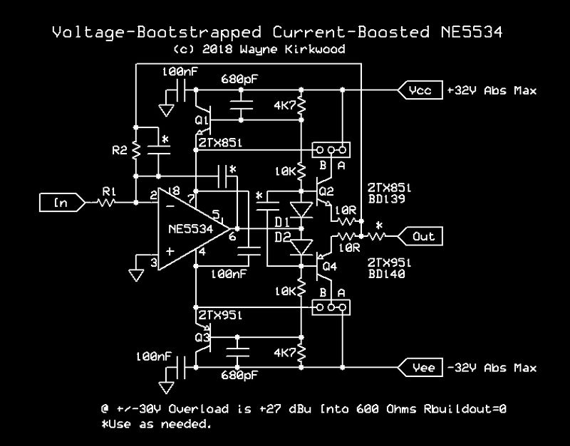

I see ~4 places where voltage swing is lost so it's going to clip way short of the rails. Bootstrapping an op-amp taxes the input common-mode range. LV has done a couple interesting designs that use positive feedback to reduce the input voltage range. It requires a defined impedance source, from a grounded stage. I favor a CFP output with gain that boosts the +/-15V range up to the power supply rails. The biggest issue using op-amp IPS is compensating ~two dominant poles.
  • opamp challenge v1.0x.asc
  • Thank You
Reactions: 1 user

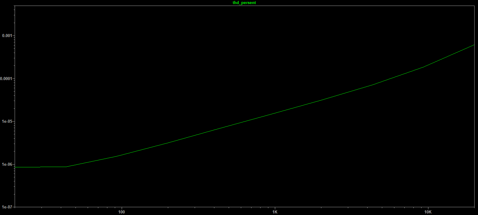

I have tested the bootstrapping of the opamp. It works pretty good in terms of stability and THD, but is limited to +-36V output voltage.
I don't know why it is limited, but i suspect it has something to do about the input common-mode range.
I'm going to try the CFP OP with gain and post an update when ready.
PS: thanks for all the replies, it helps a lot.

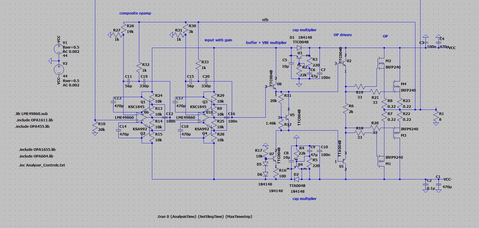

I tested the bootstrapping some more and found that the breakdown voltage of the zener diodes and the limited input common-mode range were limiting the voltage swing. By changing the breakdown voltage to 20V (LME49860 can handle +-22V) reaching 80V p-p (100W average power @ 8 ohm) was possible.
After testing with a single op amp to generate all of the gain, it already clipped at 64V p-p. when adding an opamp in front, which shares the total gain, the 80V is reached without clipping. this proves that the bootstrapping reduces maximum voltage swing by reducing input common-mode range.
this resulted in the following circuit:
feel free to roast my circuit!

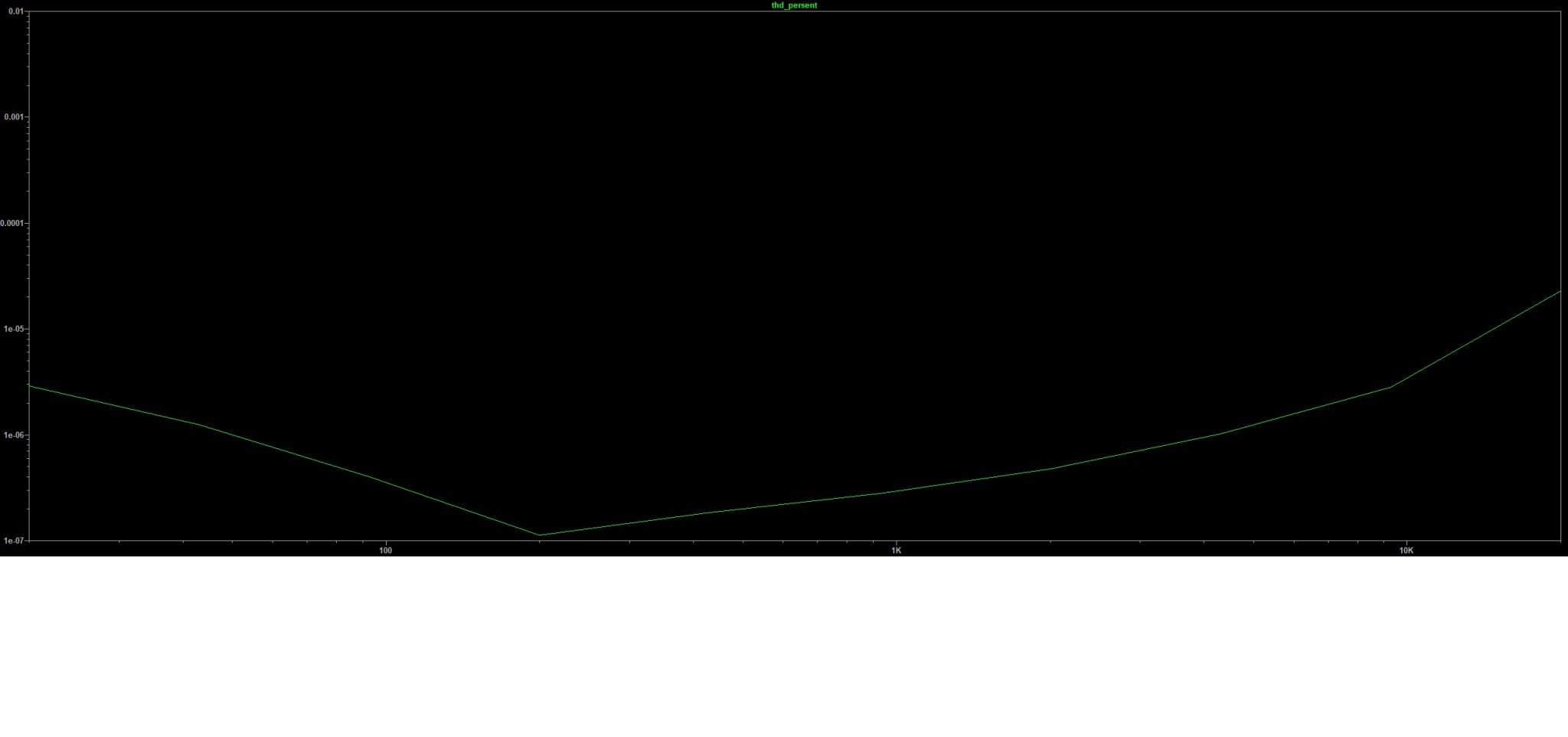

I have been working on the amplifier design.
The following changes have been made:
  • Removed the OP drivers
  • Simplified bootstrap and VBE circuit
  • Simplified supply for U2
  • Improved feedback ratio to improve clipping performance (U2 clips first)

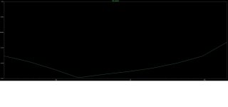

the 100W avg. power is reached just before clipping. i'm still looking to improve the THD.
what kind of improvements can be made to lower THD?
Bootstrapping an opamp always implies some change of latching when driven hard.
thank you for your reply!
Correct me if im wrong: latching is the phenomenon where the output devices keep conducting while this is not wanted and caused by input overload.
Then the following question arises: when U2 (referring to the schematic in my latest post) clips first, does is prevent U7 to get overloaded by the input signal thus prevents latching?
To stay within the scope of this challenge, when U2 does not prevent latching, how can we prevent it while using opamps for all of the gain?
