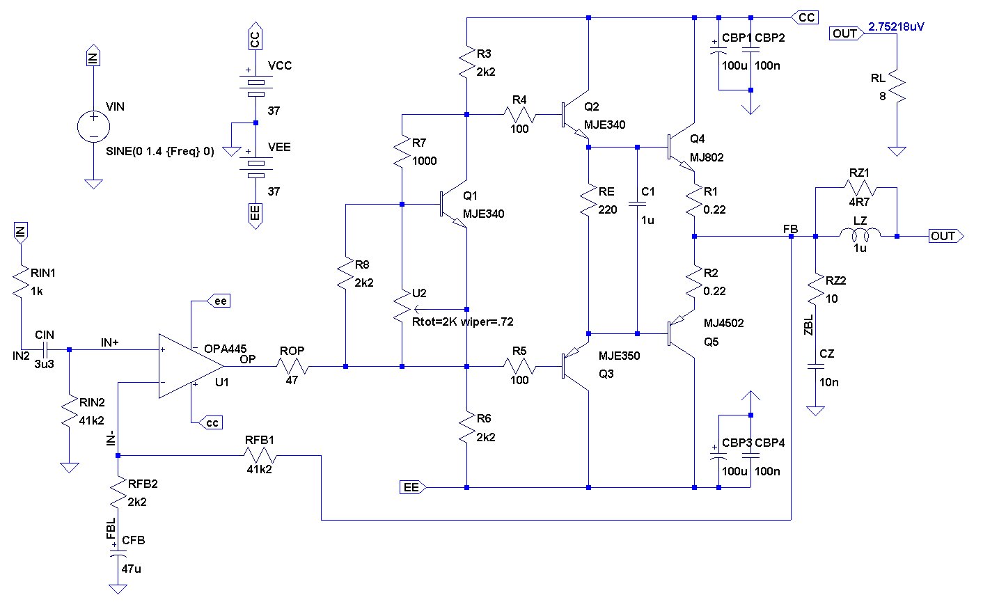

Here is new version with TO3 output devices. The fly in the ointment is the $10 OPA445 high voltage opamp, but it does allow the use of an emitter follower output stage.
The alternative $1 NE5532 opamp needs a complimentary feedback pair to work. This is not necessarily a bad thing, but is just a tad less stable. With careful design it would be OK.

"No Vbe multiplier? "
Not needed.
You can make diodes out of the same transistors used for Q1, Q2, and glue them to Q1, Q2 (CFP needs to have the bias track the drivers, not the outputs). Or do the same with Q5, Q6.
Careful. This is not a regular CFP because the output stage has gain. As a result the full current of the output transistors does not act on the emitter resistors of the 'drivers' so unlike CFP the ability to track output transistor temperature through the drivers is not total, rather (with the given resistors in the feedback network) about 1/4.
In these kinds of outputs it pays to have minimum gain that will get you full swing with what the OPamp can provide, as it improves thermal tracking. How well it will work at higher standing currents (fortunately CFP usually needs low standing current) and with particular cooling arrangements, is not always predictable, so a VBE multiplier, or fitting drivers and outputs on the same heatsink may indeed be necessary for thermal stability.

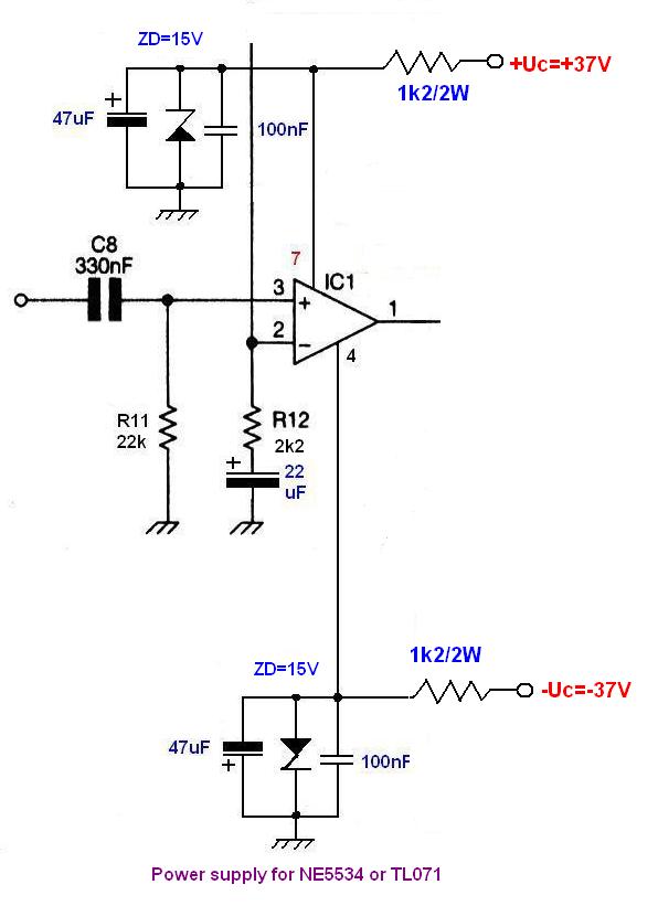

Hi Ingenieus!
I can not find the IC1=OPA445. For Power supply the IC1 = NE5532 or TL071 can I use this schematics? (see schematics)
Thanks for your help!

Hi Ingenieus!
While it will work, the output swing of the ampwill be limited to to +15V. To make full use of the+37V from the power supply, you need an output stage with voltage gain, i.e. a complimentary feedback pair with local feedback as already shown.
The emitter follower output stage in my previous posts will only work with a high voltage opamp. There are others available (see above) but if you can't get one of them, the only remaining alternative is a circuit with discrete components.
Hi djk,
Referring to the circuit in your post #22, I would like to have your opinion on
the following subjects:
1. Is it beneficial to feed the CCS's comprised of Q5, Q6 and their associated
components from the 15 V regulated supplies instead of the full supply
voltages? Afterall, the voltage swing at their collectors is in line with the
output of the opamp.
2. Is there any downside to dispense with the CCS's altogether and replace
them with bootstrapped or plain R's?
3. Is there an ideal value of R from the output of the opamp to the midpoint
of the bias chain? 100 ohms?
Thanks in advance
Selim
"1. Is it beneficial to feed the CCS's comprised of Q5, Q6 and their associated
output of the opamp."
I fed the CCS from the ±15V supplies.
"2. Is there any downside to dispense with the CCS's altogether and replace
them with bootstrapped or plain R's?"
I chose to use plain R's fed from the ±15V rails. Using an active CCS will improve measurements by a factor of 10x (20dB), but it does not sound any better. One could argue that the R's from the higher voltage from the output stage would result in a more constant current, but there is the power supply ripple as well. I was more interested in getting some bias in the diodes under small signal conditions, nothing more.
"3. Is there an ideal value of R from the output of the opamp to the midpoint
of the bias chain? 100 ohms?"
IIRC, I used 51Ω. A different opamp may work better with a different value.
I tried a few opamps, TL072, LF353. The TL072 sounded better than the LF353, but when driven into clipping it latched to the negative rail and sounded horrible (typical bi-FET behavior). The 5532 sounded better at any volume level, and did not misbehave even hard into clipping. We actually destroyed a transformer from driving into clipping for an extended period of time.

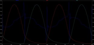

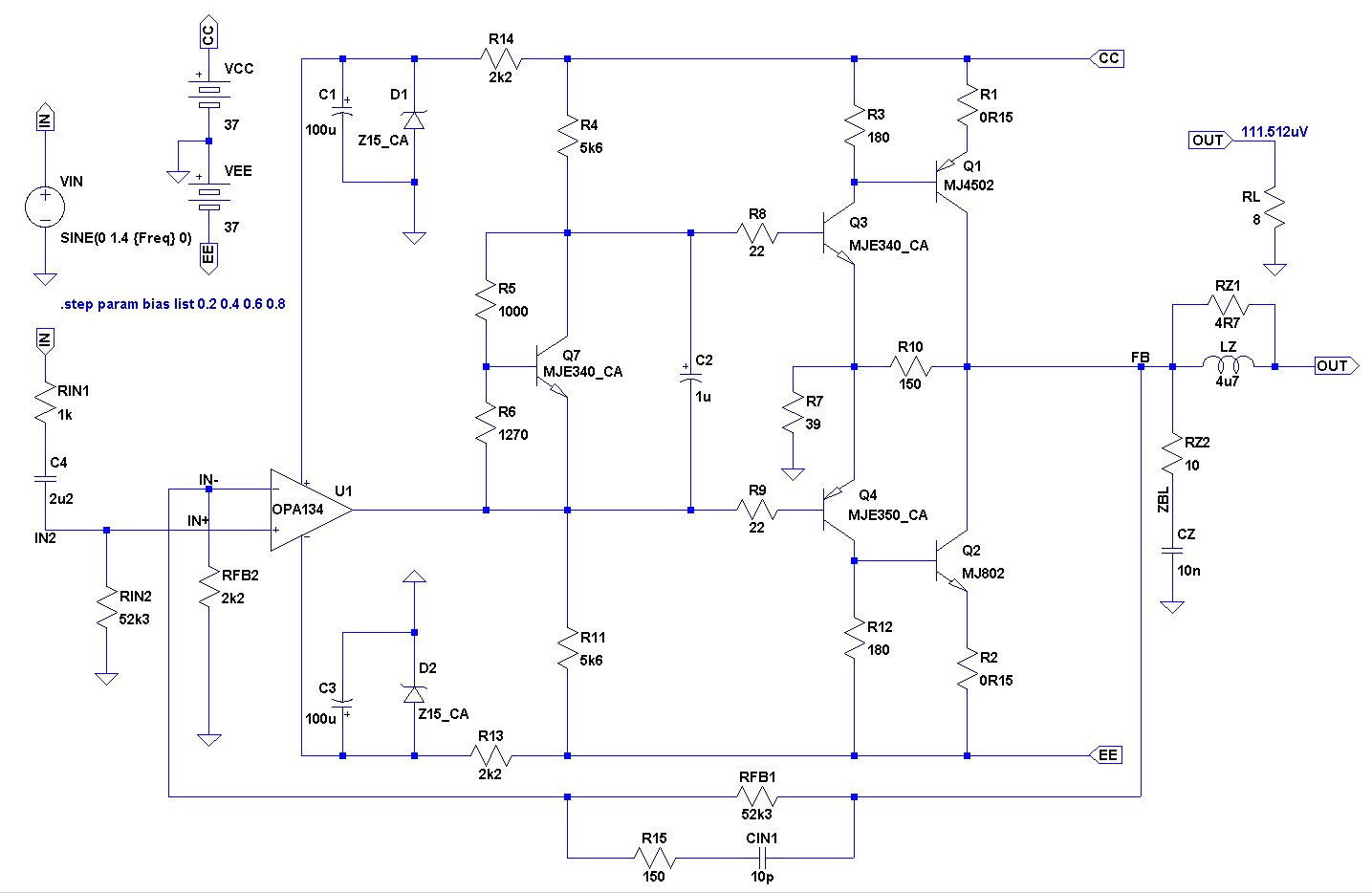

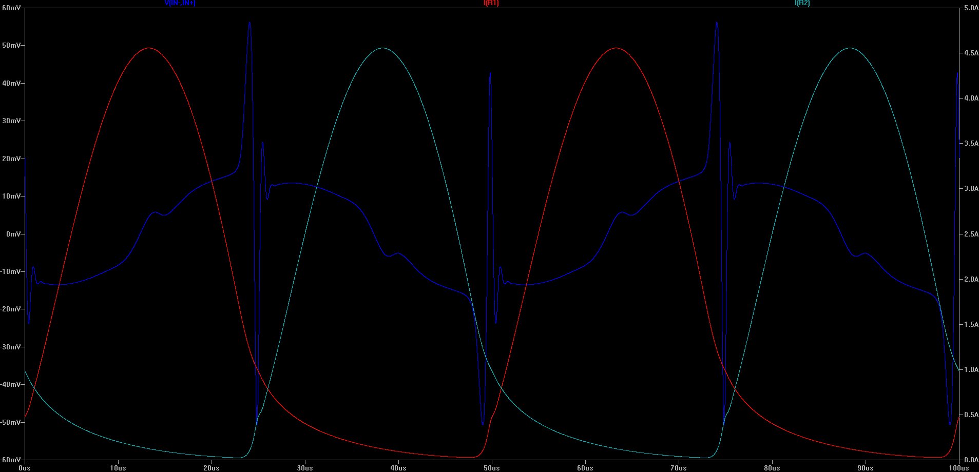

Here is a low voltage opamp driving a CFP output with voltage gain. It works (in a simulation at least) but performance is not the very best. It gives 70W into 8ohm. THD at 1kHz is a very nice 0.0068% but this shoots up to 0.27% at 20kHz. Also, setting the bias is still very tricky. I used the OPA134 (around $3 in my part of the world) because I couldn't get the NE5532 to work properly.
Those output transistors are very reluctant to switch off, as shown by the output currents and the distortion waveform.

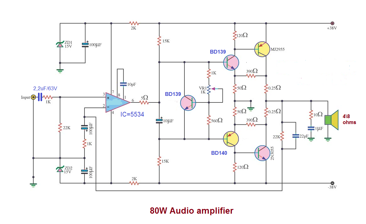

Amplifier with IC=Ne5534 and output with 2n3055/2n2955
Hi all!
Whether the schematic could be in place amps or some changes are needed?😕🙄
