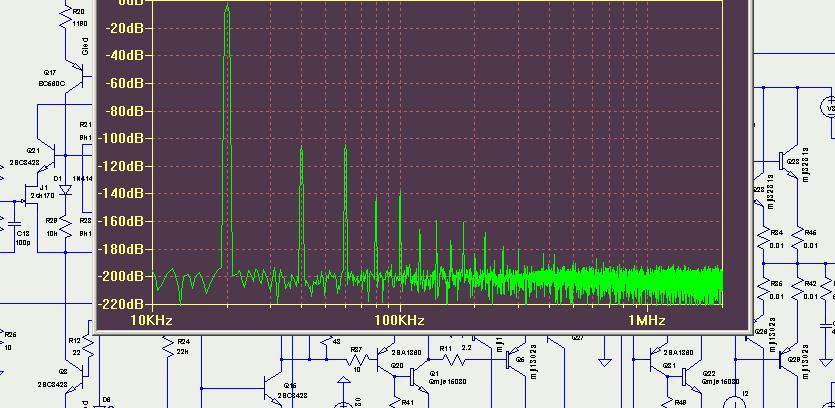

Sorry guys, the feedback is taken from the class A output stage ... my mistake.
Take a look at simulated THD20 for 50W pure class A output 😀
THD_20 (50W/8ohm) = 0.0012
