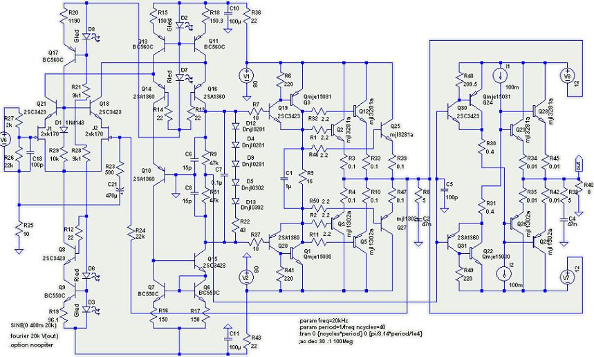

roender Member Joined 2006 2009-01-10 4:03 pm #21 2009-01-10 4:03 pm #21 Sorry guys, the feedback is taken from the class A output stage ... my mistake. Take a look at simulated THD20 for 50W pure class A output 😀 THD_20 (50W/8ohm) = 0.0012 Attachments thd20_2.jpg 68.2 KB · Views: 362 roender Member Joined 2006 2009-01-10 4:19 pm #22 2009-01-10 4:19 pm #22 Sorry guys, the feedback is taken from the class A output stage ... my mistake. Take a look at simulated THD20 for 50W pure class A output 😀 Prev 1 2 First Prev 2 of 2 Go to page Go Status Not open for further replies.
