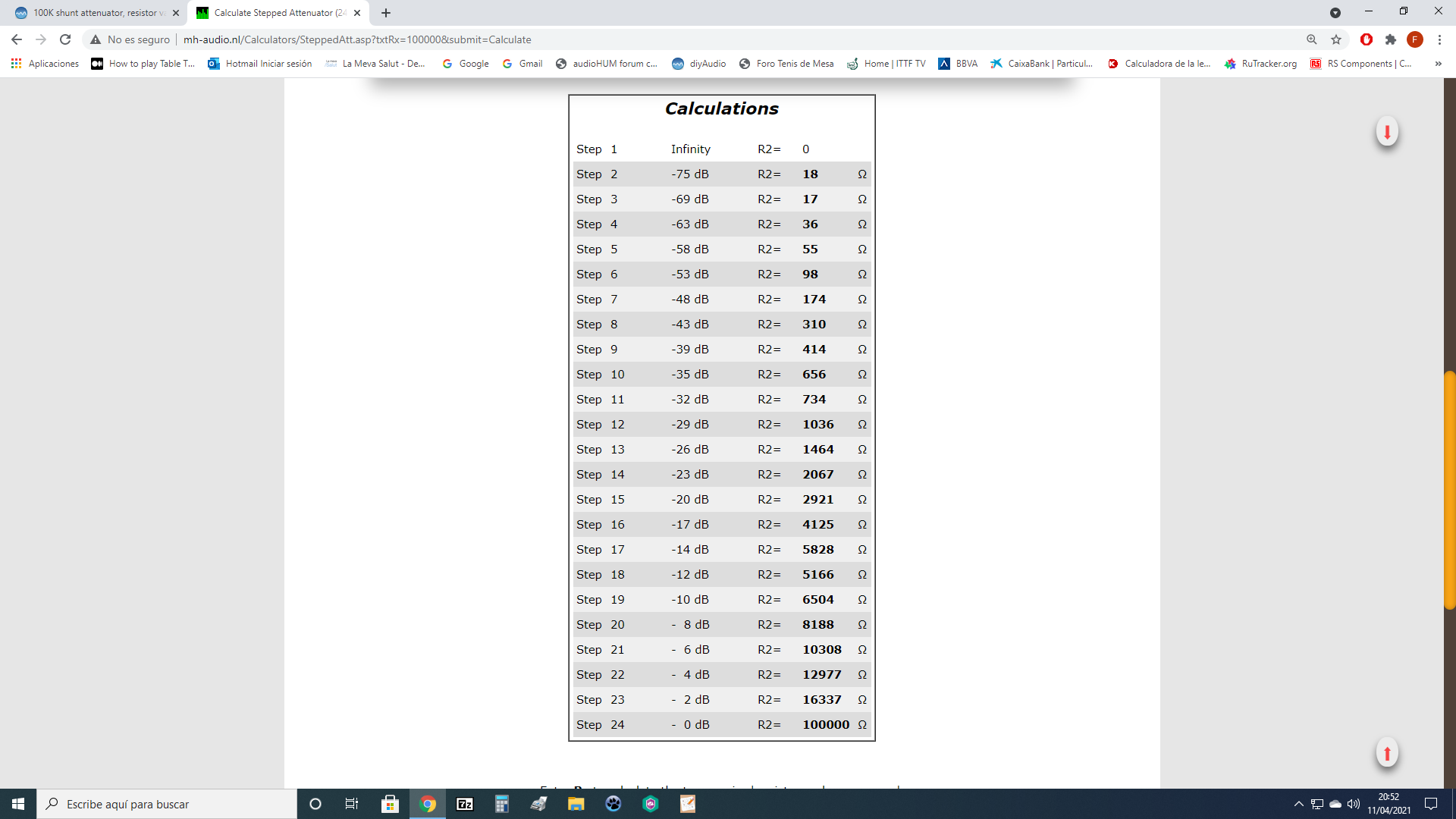

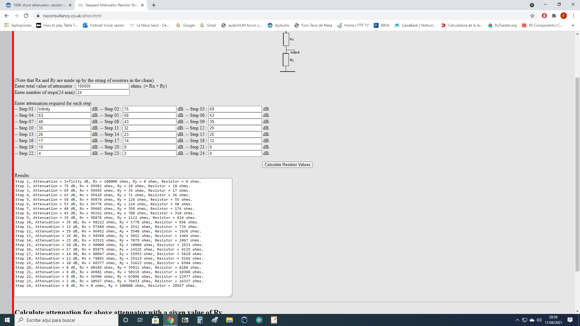

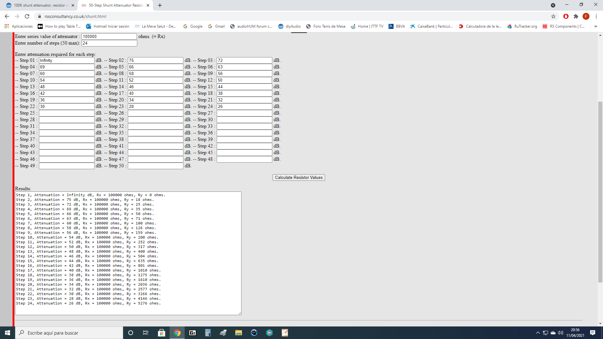

I want to construct a shunt stepped attenuator of 100K value. The series resistor will be fixed at 100K. I now need the resistor values to ground for a 24 step switch. I have conflicting values from a theoretical table and an actual Khozmo 48 step attenuator where I've used alternate steps. I also have a 22 step Alps attenuator. I've tried to average them out. (You could also read the values backwards)
Can you suggest a "best" solution?

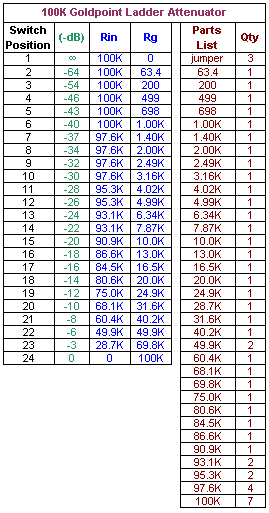

Few more attached, spreadsheet shows the Valab vs Goldpoint values. I always start with the Goldpoint values, then tailor them to my needs. Basically i work out the nominal range where the pot will live in circuit, then change the values around it for 1db steps.

Thanks mcandmar - useful data. The values are different from the Alps and Khozmo I posted. Here's the values for the 12th step:
Merlin's - 1036 (24 step)
Valab - 2100 (23 step)
Khozmo - 3600 (24 step)
Goldpoint - 4990 (24 step)
Alps - 11200 (22 step)
The Khozmo looks to be about the "middle" of the range.
This indeed comes before the grid of the input tube. Looks like the values are chosen for practical results rather than pure theory.
I do the math to work out the DB attenuation for each dividor, then tried to get as close to 1db for each step. However, the resistor values you have to play with are dictated by availability. Some manufacturers just stick to standard E24 resistor values.
When i built mine i used Dale RN60 series and used the Mouser parts system to see what values were available. This is where the spreadsheet was invaluable as i could key in the different resitor values and see what the DB attenuation was, and the total resistance across the dividor. The last pot i built (50k for 01A pre) i had hours of fun tweaking the resistor values to get each value as close to ideal as posible. But your level of OCDness may differ 🙂

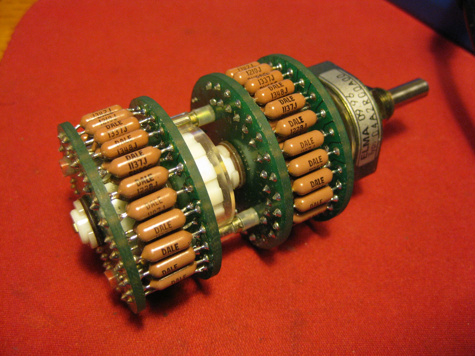

I always go for stepped ladder attenuators as there is less in the signal path. I just dont like the idea of shunt style where you would have a dozen or so resistors in series, i work on the basis the fewer components in the signal chain the better.
As for the units themselves (i probably shouldn’t say this) but my favorite by far are the original Goldpoint stepped ladder units. I just love how tactile they feel, and are very high quality switches. They stopped making them in the late 90's so i snap them up whenever i see them. It is rather tedious to build, working out all the resistor values, matching the physical resistors into pairs, then soldering all 96 of them into the switch unit. Many many hours....

Thanks for the input. By "shunt" I mean a single series resistor for the input, e.g. 100k. The "shunt" resistors are the 24 resistors to ground if I understand the terms correctly. A "ladder" as I understand it replaces the single series resistor with 24 resistors which more accurately maintain the 100k input resistance. A "series" attenuator has 24 resistors in series, so several are in play. this kind of mimics a conductive volume pot but with resistors.
