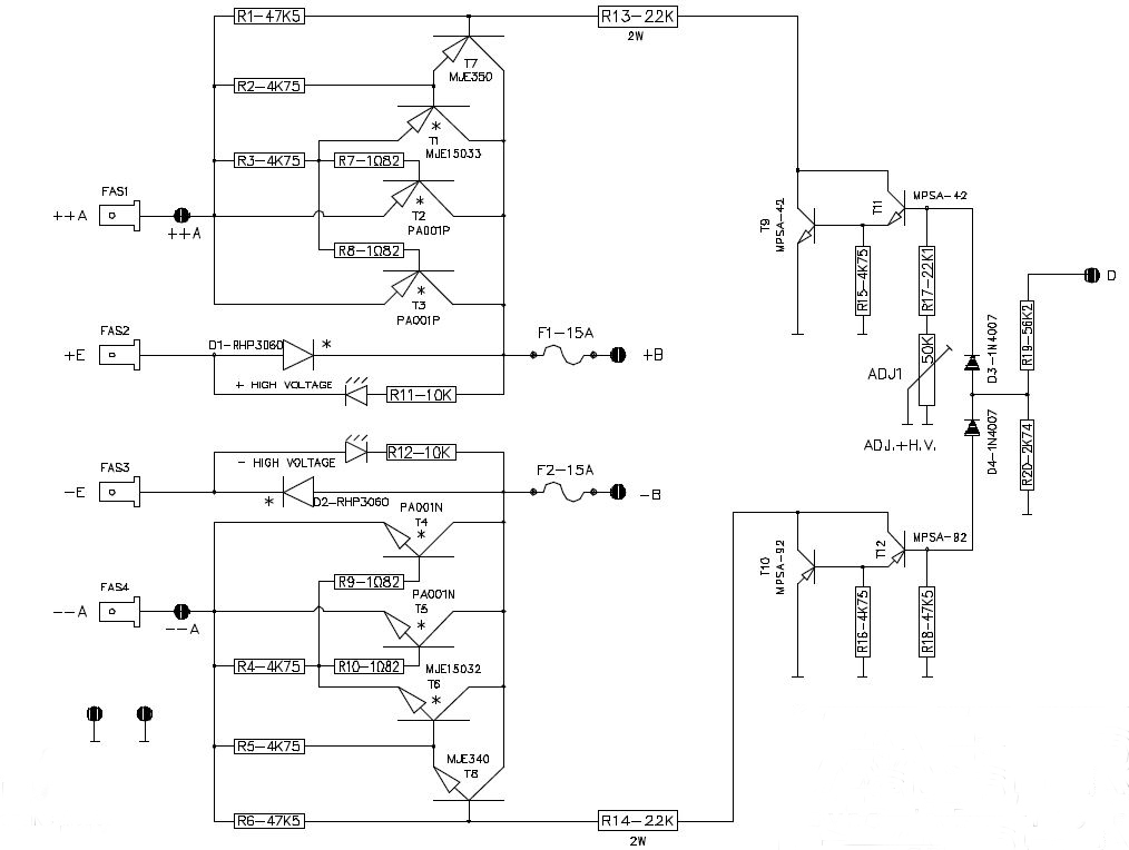

1000W PA Quasi NMOS Amp - Class H Stepdriver possibile ?
Does somebody have experience or ideas
I want add Class H Rail Step driver for quasicomplementary NMOS amp 60/110 V DC?
but I remember in the past some diy member told me quasicomplementary amp does not working with class H Stepdriver (amp will oscillating in negative rail and burn up) ....but I think this information is not true , because its working in commercial NAD 208 70 V / 120 V Rail
NAD 208 is commercial Class H quasicomplementary NMOS amp
I think it can work if add Class H Step driver from apex member (900 W PA amp with limiter thread )
ANY ideas to increase efficiency for NMOS amp ? I dont like BJT output stage

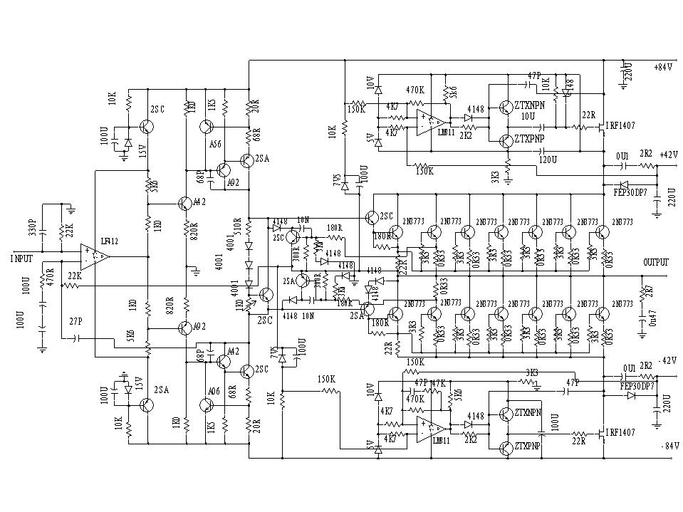

I am very satisfied with BJT sound in my amplifiers and I haven't had any secondary breakdown yet in any of my amps sold commercially.
I have a proto type Class H doing + 2kW peak i 2 ohms with "only" 4 pair BJT and 2 switch MOSFET also tested in reactive and capacitive loads - not problem. It beated 2 x 1000W Class D RCF it was AB tested against 😀
- so I think it's a matter of implementation 😉
Robert GS
Sat Shri Akal Paa Ji , As being a 2n3773 lover this circuit is delight for me .I will be gratefull if you can post full details ,part list, and p.c.b. design also of this circuit .I have around 500 pcs. of 2n3773 of different companies also have a good stock of mj3773 and mj15024 .
Sat Shri Akal Paaji Thank you for reply, Soon I will start work on this project at present I am busy repairing my BPL duel trace 20Mhz oscilloscope.Question again 1.what transistors can be used in place of Ztxnpn .2.which other I.C.s can be used in place of Lm311 and Lf412. for Outputs I will use 2n3773.Already have started sketching P.c.b. design.Waiting for your valuable reply.
How about this ?
look here......
Attachment: Quasi NMOS CLASS H PA and HI-FI amp
Class H Stepdriver without ICs... more cost effective design and devices easy to get.
Fort BJT lovers:
Mosfets can replace with 6 x 2 SC5200 but mosfets are more rugged and can driving harder compare to BJTs
Soundquality is proved from fuzzly diy Audio people and hard to beat from the deep lows to clear highs
Amp with N Mosfets or BJT Output stage in Class AB configuration is build, tested and proved for stable working with high qudio quality from hundreds DIYer

Class H Stepdrivers not tested will do it next weeks
